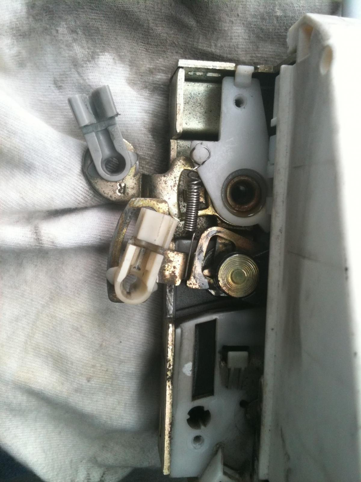

Other half's fiesta is playing silly buggers - I fitted a new cable in the drivers door, however a spring had also broken and dropped out of the mechanism. Result is I can no longer open the door from inside or outside.
I am mindful that damage may be caused getting the door open now.

Can't you get the door card off to gain access to the mech? Or failing that, cut it to gain access & then either bodge it back together or fit a new door card from a breakers? It must be worth a go if the option is to bridge the car anyway.

I need the door to be open to access the mech.

You should still be able to get the rear of the door card off enough to get a screw driver in and open it up. I'm not saying there won;t be a lot of swearing but I've seen the guys at the garage my lockup is at doing it a few times.
Scrapyard, new door card, then get hole cutter on old card to release the door. The question I would be asking would be what else can you foresee going wrong with it in near future? You could just chuck it in for the Test, if it wants tyres chuck some cheap part worns on, stick some radweld in the cooling system or hope no one notices it. If you can get it through test for minimum spend say less than £100 then run it into the ground. Don't waste a penny on it. Then that's bought you 12 months to find something better, then if in 6 months you get a better car just stick it on Bumtree for £350
A friend had a t plate fiesta 5 door that ended up with a huge dent in the back door and wouldn't open. We tried all sorts but seeing as the door needed to be replaced anyway but the door needed to be open to remove it,we got an angle grinder and cut a big square out the door,fiddled about a bit and opened it up. Door off,scrap yard door on and jobs a good un.

I managed to get the door open - I was prepared to sacrifice the new cable in order to get it open.
A lot of heaving on the handle ( was waiting for it to snap ) and the bastard popped open.
Stripped the whole lot down again in order to locate where the missing spring lived.
After establishing from the pic where it lived I tried to revive the old spring but with no joy - it had snapped and altering the length affected the tension. I had a box of springs that I got from aldi, a similar one was found and tweaked to fit.
All this drove home to me how shit haynes manuals are - as the car has central locking the electronic box screws to the mechanism - if you look inside it there are slots where everything must locate. Everything was put back together.
Success! It appears to be working. Some tiger seal on the membrane and everything has gone back together. Normal service resumed, question is for how long.

I am looking at that door mechanism and thinking that it could be a lot simpler than that. It looks like the design office weren't busy and the manager kept passing the drawings around the staff to see if they could add anything just to give them something to do.
so this pic is a bit premature then?
