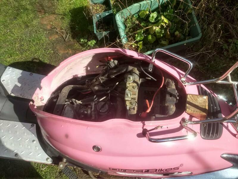

catsinthewelder Posted March 12, 2022 Posted March 12, 2022 In other scooter news I've managed to break into the pink one. Fortunately the battery cover was left off which reduced security to the catch enough to ping the spring off and wriggle it open. I've removed the cable from the lock so you can open it by hand. Six-cylinder and LightBulbFun 1 1

catsinthewelder Posted March 12, 2022 Posted March 12, 2022 The sun is shining and I'm too scared to take an angry grinder to the hopefully surface rust on the Focus so I'm still titting about with the scooter. It doesn't have a key so I've now bypassed the ignition and fuel cap locks. Currently you switch the ignition off by disconnecting the jump lead to the battery. I found some wires that had been cut under the seat so reconnected them and now the starter works. Still won't start though, plug looks good but isn't sparking and the fuel in the tank isn't coming through. On the plus side if those bits put it in the scrapyard then the engine might be ok. Six-cylinder 1

Zelandeth Posted March 12, 2022 Posted March 12, 2022 5 hours ago, catsinthewelder said: The sun is shining and I'm too scared to take an angry grinder to the hopefully surface rust on the Focus so I'm still titting about with the scooter. It doesn't have a key so I've now bypassed the ignition and fuel cap locks. Currently you switch the ignition off by disconnecting the jump lead to the battery. I found some wires that had been cut under the seat so reconnected them and now the starter works. Still won't start though, plug looks good but isn't sparking and the fuel in the tank isn't coming through. On the plus side if those bits put it in the scrapyard then the engine might be ok. It's not modern enough to have some immobiliser nonsense involved on the ignition side of things is it?
EightMegs Posted March 12, 2022 Posted March 12, 2022 If I can get enough jobs done on my Carina before I take it to Wales the weekend after the 26th and then Scotland the week after that, I might be up for going. Six-cylinder and LightBulbFun 2
catsinthewelder Posted March 12, 2022 Posted March 12, 2022 58 minutes ago, Zelandeth said: It's not modern enough to have some immobiliser nonsense involved on the ignition side of things is it? If it was Japanese it probably would but the security on Chinese stuff is that nobody wants to steal it. I've looked and can't see much, can't remember Chris' one having anything special on the key and there's nothing that looks like security behind the ignition switch.
Zelandeth Posted March 12, 2022 Posted March 12, 2022 17 minutes ago, catsinthewelder said: If it was Japanese it probably would but the security on Chinese stuff is that nobody wants to steal it. I've looked and can't see much, can't remember Chris' one having anything special on the key and there's nothing that looks like security behind the ignition switch. Fair enough. Assume these use CDI for spark rather than an old school magneto? If so and that appears to have both power and a ground that probably would be my first port of call. The no-name clone modules for Hondas (at least ten years ago!) were so flaky that a mate used to carry a spare in the luggage compartment - but they were like 20% the cost of the actual Honda part so changing it a couple of times a year still made sense. From memory some of them ground through the frame too, so that might be worth a look. Again I'm working from 10+ year old memory here as I've not touched anything like this in forever! catsinthewelder and LightBulbFun 1 1

catsinthewelder Posted March 12, 2022 Posted March 12, 2022 @Zelandeth I'm going to make a small fuel tank to gravity feed the carb between now and the FoD then see if it'll run with the CDi from the black one. It's lost all its lights for some reason so I was thinking of using the headlight switch as an ignition switch being as the scooters all go to bed before dark at the FoD for noise reasons. For that reason I was thinking of bringing the electric bike/scooter down as a silent bog run bike (once someone more talented than me has fixed it). Thanks @Six-cylinder Six-cylinder 1
