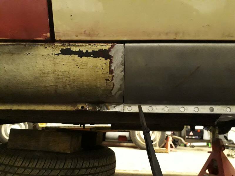

This area then, we last left it with a big chunk cut from the outter sill so i could see what lay beneath.
Unfortunately alot of grot and poor repairs.  I wanted a point of reference to build from so welded in the right angle part first to give me somewhere to start.

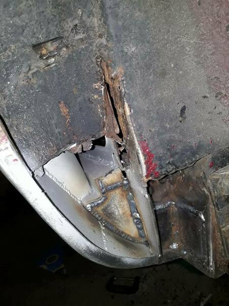

You can see in the pic above the axle mount its rotted through. This is 3 or so mm thick!, a rumage in the metal pile later i found a bit so it was time to chop the grot out and burn in some new bits.
Zap zap zap
With that zapped in  i moved onto making the arch lip.  I really need to get a shrinker stretcher tool, that would have made this easier.
Handily the wheel arches are the same profile front and rear so i was able to use the front drivers wing for reference.

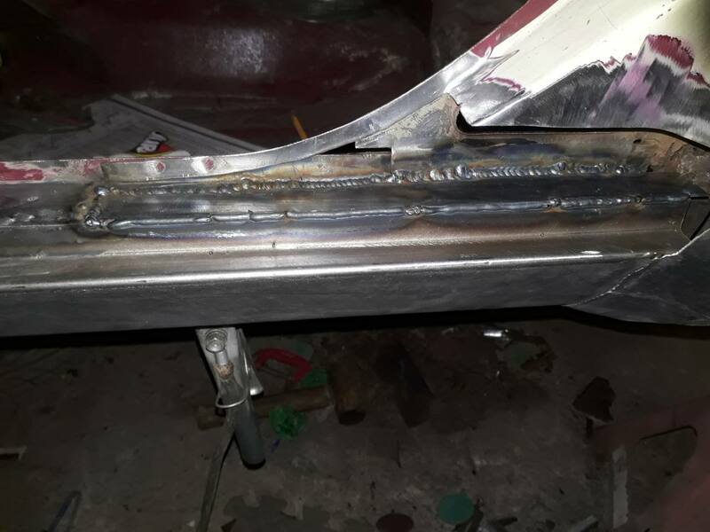

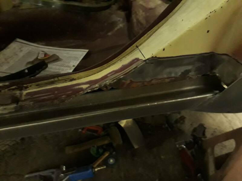

Some triming and fettling got the outter panel in a good place.
Time to zap it in, id made two infill panels for the arch area aswell so these went on.
With that now in place i could trim away the door shut / lower c pillar panel to weld in the top part of the outter sill that ties to the inner cill as the original part was rotted through.

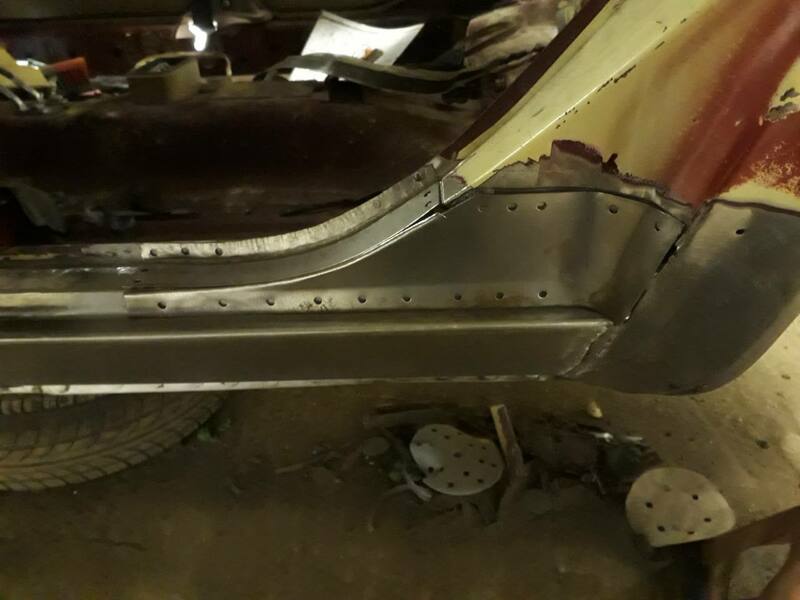

Some of that was ground back, then weld through zinc primed, with that done the other panels could be made. I joggled some joints aswell as plug welds.
Zapped in and welds ground back.
With the way ive made the repair sections, the folded up outter sill panel ties into the rear axle mount. So i made a plate that ties the lot together aswell as caps the end of the sill part. 20201213_150309.thumb.jpg.d21eae942bda3c53104568fca8b3cba6.jpg
Plugged to the thick steel of the mount, and ties into the seat box panel and sill.
Certainly not factory probably overkill, but im making this up as i go along due to the area having been bashed and welded in the past im trying to make it as strong as possible.
