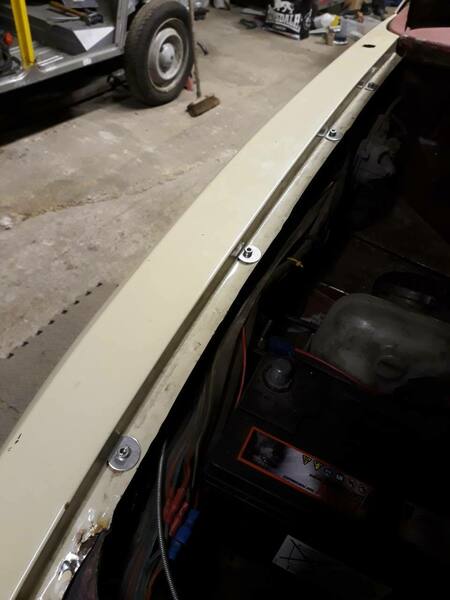

Andyrew Posted December 2, 2020 Posted December 2, 2020 Another quick job before leaving was to get the rather sorry looking and wobbly fibreglass wing off. Originally bolted and spot welded on, the glass wing was bolted and the occasional rivet. There was 4 crusty bolts that tied it to the front panel. I popped the lens off to look how the light retained. With the light unable to be removed due to crusty bolts the wing bolts were not easily accessed. So i opted to pry the wing away at the bottom and just cut them with a hacksaw blade. Of course it was a well worn blade just add to the joy! Wing off and the "new" wing was test fitted. Some hammer and dolly action is needed on joining faces and some minor repairs but should be fine. With the old wing off , i had a nosey at the side light. Im guessing the housing is some form of alloy as the bulb holder is single wire. I assume the steel of the bulb holder resulting in a disimilar metals corrosion. Having an ebay browse didnt bring any light units up except one thats was almost as bad so im guessing its a fairly common issue. Six-cylinder, LightBulbFun, Mrs6C and 3 others 4 2

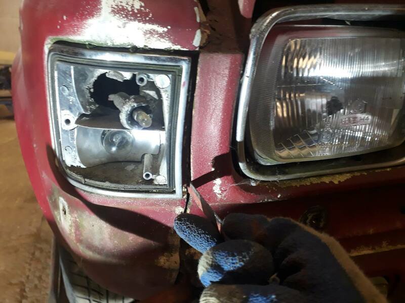

Andyrew Posted December 2, 2020 Posted December 2, 2020 @rusty998 any chance the indicator units on your new parts donor are any better? rusty998 1

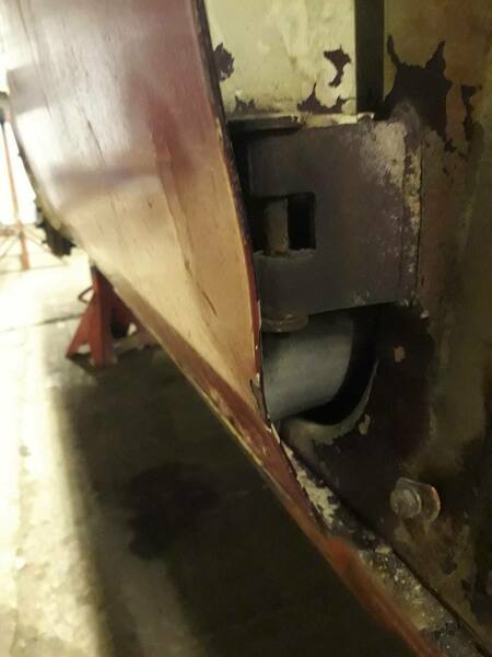

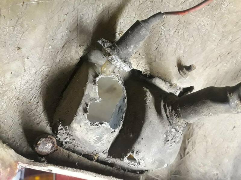

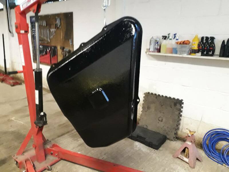

Six-cylinder Posted December 3, 2020 Author Posted December 3, 2020 12 hours ago, Andyrew said: Finally, VP progress. Unfortunately at work we had a covid problem, so some isolating was required. Anyway, today i dropped the tank out ready for the leaking sender replacement and for me to crack on with welding near the tank. Amazingly all the bolts came out lovely. Hmmmmm its very very crusty, but whilst its heavily pitted all over, the only leak was from the sender itself andd with the Fuel drained out into cans and a quick inspection inside suggests its nice and clean in there. I knocked the sender retaining ring out and removed the old sender. I then cut the top part off a spray can lid and made a blank to lob in the hole with the retaining ring to hold it in place, with that and the filler neck taped up i whipped over it with some 60 grit paper to knock the loose rust off, it was then brushed off and wiped down with brake cleaner Out with brush and the bonda primer. One light coat, once touch dry i gave it a heavier coat. Ill leave it to dry for few days as its rather cold in the workshop and once thats dry ill give it a quick key and slap on a couple of coats of some tractor enamel paint. With the tank's first coat drying i modded the MGB sender to match the VP one. As advised by the allegro club. An inch or so off the end and a slight bend on the float rod sorted. I can't help thinking you have bought on all this extra work yourself by your sissy attitude to welding by a leaking petrol tank! Thank you so much for just getting on with the VP what ever obstacles it presents you and now eliminating a future problem with minimal cost. Andyrew, richardmorris, mitsisigma01 and 1 other 3 1
rusty998 Posted December 3, 2020 Posted December 3, 2020 11 hours ago, Andyrew said: @rusty998 any chance the indicator units on your new parts donor are any better? No spare lights at all on the spares car as they were stolen years ago, they do come up on eBay but make sure you get the earlier type as on the series 3 they front side light and indicator unit has three wire's, sorry I couldn't be any help Six-cylinder and Andyrew 2

Mr_Bo11ox Posted December 3, 2020 Posted December 3, 2020 I remember 25 years ago trying to buy those in scrapyards and finding that they were all made of some weird white 'metal' that just turns to dust in your fingers!!!
Six-cylinder Posted December 3, 2020 Author Posted December 3, 2020 2 minutes ago, Mr_Bo11ox said: I remember 25 years ago trying to buy those in scrapyards and finding that they were all made of some weird white 'metal' that just turns to dust in your fingers!!! The light unit or the car? LightBulbFun 1
Mr_Bo11ox Posted December 3, 2020 Posted December 3, 2020 The light unit!!! (The cars were made of brown stuff that turned to dust in your fingers) Six-cylinder, BorniteIdentity, chaseracer and 5 others 2 6

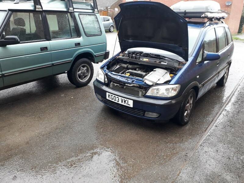

Andyrew Posted December 3, 2020 Posted December 3, 2020 Righto, lets have a day to just crack on with that rear welding then. *phone rings* one stressed sister in a fluster. Change of plans then, Good job its raining aswell. Handily being a vauxhall, the ability to self diagnose with the pedal test helped and a code for a misfire on cylinder 4 so coilpacks gone. A call to work for a new pack and plugs, sorted. Finally at the workshop, lets get that wing mounted. But first, a quick coat of enamel. With that done, its wing time. Top sections certainly a bit battered from numerous drilling over the years. I straightend it out a bit, wire wheeled it and splashed some hydrate 80 on, there is some grot that will need addressing at in the future. Much wing jiggling happend and i opted to fit nutserts in to hold the wing on. It was a bit of a faff but got there in the end. Before doing the final test fit, i straightened this bend in the lower of the front door whilst it is accessible. Bolted on, i only had cap heads to hand! The door gap is very wee , it doesnt touch but its mighty close. The wing is already slightly protruding at the front in comparison to the valance so theres no room to tweak it. There is however some epic door gap between the front and rear door tho! As the top of the door appears to have rubbed on the A pillar im thinking that some shims on the door hinge have been lost at some point in its life maybe? Either way, one sturdy wing! Yoss, Mr_Bo11ox, Floatylight and 12 others 12 3
Andyrew Posted December 3, 2020 Posted December 3, 2020 1 hour ago, Six-cylinder said: I am told the club shop is not taking fresh orders until they have caught up. I reckon ill be able to come up with a repair. Mrs6C 1
AnthonyG Posted December 3, 2020 Posted December 3, 2020 I imagine the back of the light units is some sort of crappy die cast alloy - the ‘corrosion’ looks similar to how very sickly Dinky toys could get. The word ‘mazak’ comes to mind, not sure if that was a company or the actual name of the alloy. Mrs6C and Talbot 2
wuvvum Posted December 3, 2020 Posted December 3, 2020 I have a feeling it was the name of the alloy, as the French call it Zamak. AnthonyG 1
PhilA Posted December 4, 2020 Posted December 4, 2020 Lead impurities start it off, then it'll either turn like flaky pastry, or go the other way and turn into powdery white dust. Either way it's down to the battery being connected and the exposed area the things sit in. Little wonder they went to chromed plastic later on. Phil

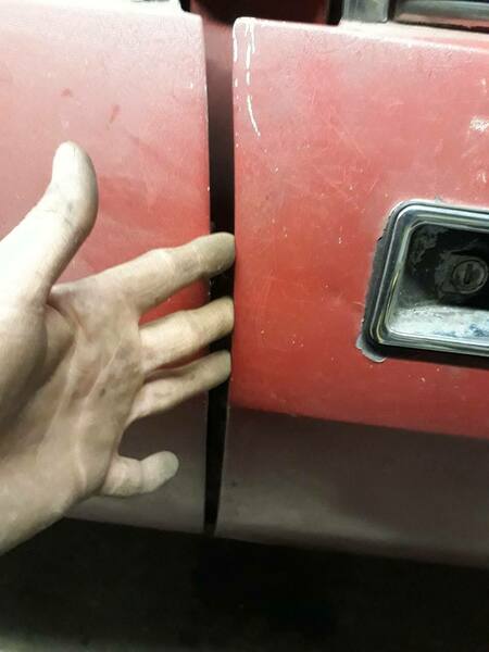

dollywobbler Posted December 4, 2020 Posted December 4, 2020 The door gaps remind me of a tale from a friend who worked at Longbridge in the 1970s. Apparently every Allegro bodyshell had to be 'dressed' (with Brummie screwdrivers) to make the doors fit properly...
Six-cylinder Posted December 4, 2020 Author Posted December 4, 2020 2 hours ago, dollywobbler said: The door gaps remind me of a tale from a friend who worked at Longbridge in the 1970s. Apparently every Allegro bodyshell had to be 'dressed' (with Brummie screwdrivers) to make the doors fit properly... Back when I worked for a Vauxhall dealer a customer came back with a new Cavalier hatch to complain the tailgate did not fit properly. The service manager took the car into the workshop slammed the tailgate with a piece of wood in one side, problem solved and the customer went away happy. I asked the service manager why he had not adjusted the tailgate properly on the hinges and he pointed out they were fixed welded hinges. AnthonyG, worldofceri and BorniteIdentity 2 1

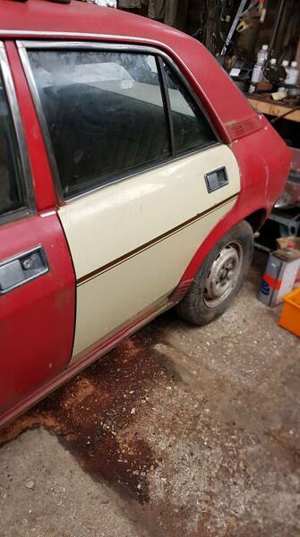

Andyrew Posted December 4, 2020 Posted December 4, 2020 2 hours ago, dollywobbler said: The door gaps remind me of a tale from a friend who worked at Longbridge in the 1970s. Apparently every Allegro bodyshell had to be 'dressed' (with Brummie screwdrivers) to make the doors fit properly... This could very well be how it left the factory, given the numerous coats of paint and overspray in the door shuts i honestly dont think the doors have been off before. With the hinges welded to the shell, the only room for adjustment would be a shim between the hinge mount to the door. I cant see any signs of a front end bump. My only other thinking is that the replacement wing is from a later era and maybe tooling wear or changes caused it to be fractionally larger. The Colour match is way off aswell . . . Six-cylinder and Mrs6C 2
Six-cylinder Posted December 4, 2020 Author Posted December 4, 2020 3 hours ago, Andyrew said: The Colour match is way off aswell . . . No, it matches the passenger rear door precisely! Mrs6C, Floatylight, Jifflemon and 6 others 2 7

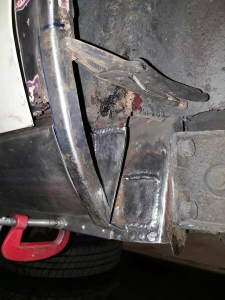

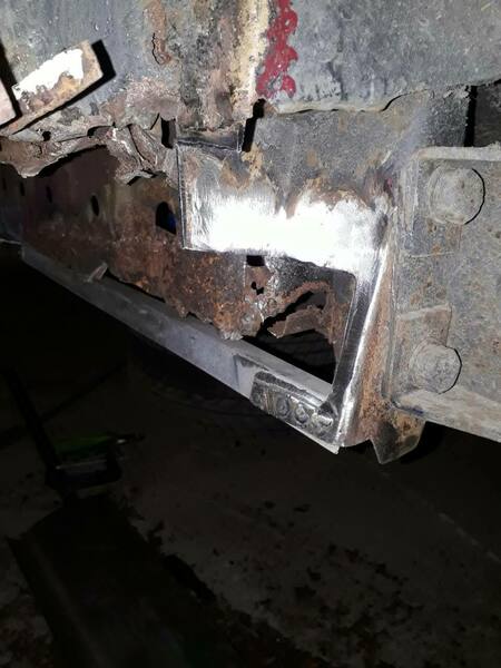

Andyrew Posted December 6, 2020 Posted December 6, 2020 A-mount of work This area then, we last left it with a big chunk cut from the outter sill so i could see what lay beneath. Unfortunately alot of grot and poor repairs. I wanted a point of reference to build from so welded in the right angle part first to give me somewhere to start. You can see in the pic above the axle mount its rotted through. This is 3 or so mm thick!, a rumage in the metal pile later i found a bit so it was time to chop the grot out and burn in some new bits. Zap zap zap With that zapped in i moved onto making the arch lip. I really need to get a shrinker stretcher tool, that would have made this easier. Handily the wheel arches are the same profile front and rear so i was able to use the front drivers wing for reference. Six-cylinder, BeEP, egg and 10 others 10 3
Six-cylinder Posted December 6, 2020 Author Posted December 6, 2020 33 minutes ago, Andyrew said: A-mount of work This area then we last left it with a big chunk cut from the out sill so i could see what lay beneath. Unfortunately alot of grot snd poor repairs. I wanted a point of reference to build from so welded in the right angle part first to give me somewhere to start. You can see in the pic above the axle mount its rotted through. This is 3 or so mm thick a rumage in metal pile later i found a bit so it was time to chop the grot out and burn in some new bits. Zap zap zap With that zapped in i moved onto making the arch lip. I really need to get a shrinker stretcher tool, that would have made this easier. Handily the wheel arches are the same profile front and rear so i was able to use the front drivers wing for reference. As you are constructing an Allegro from nothing can I have an Escort Mk1 instead please! BeEP, Andyrew, wuvvum and 7 others 10
