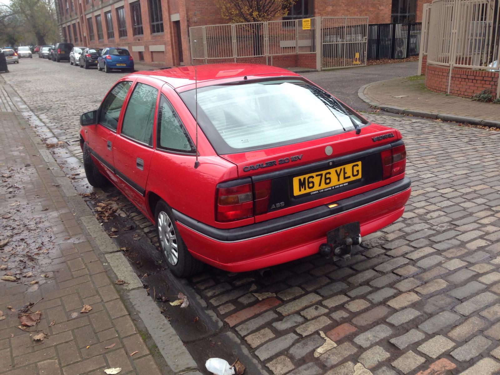

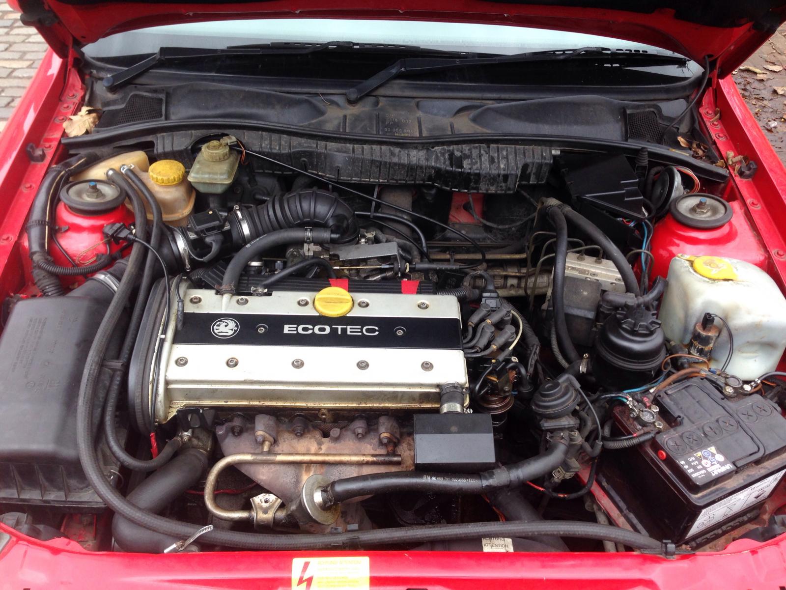

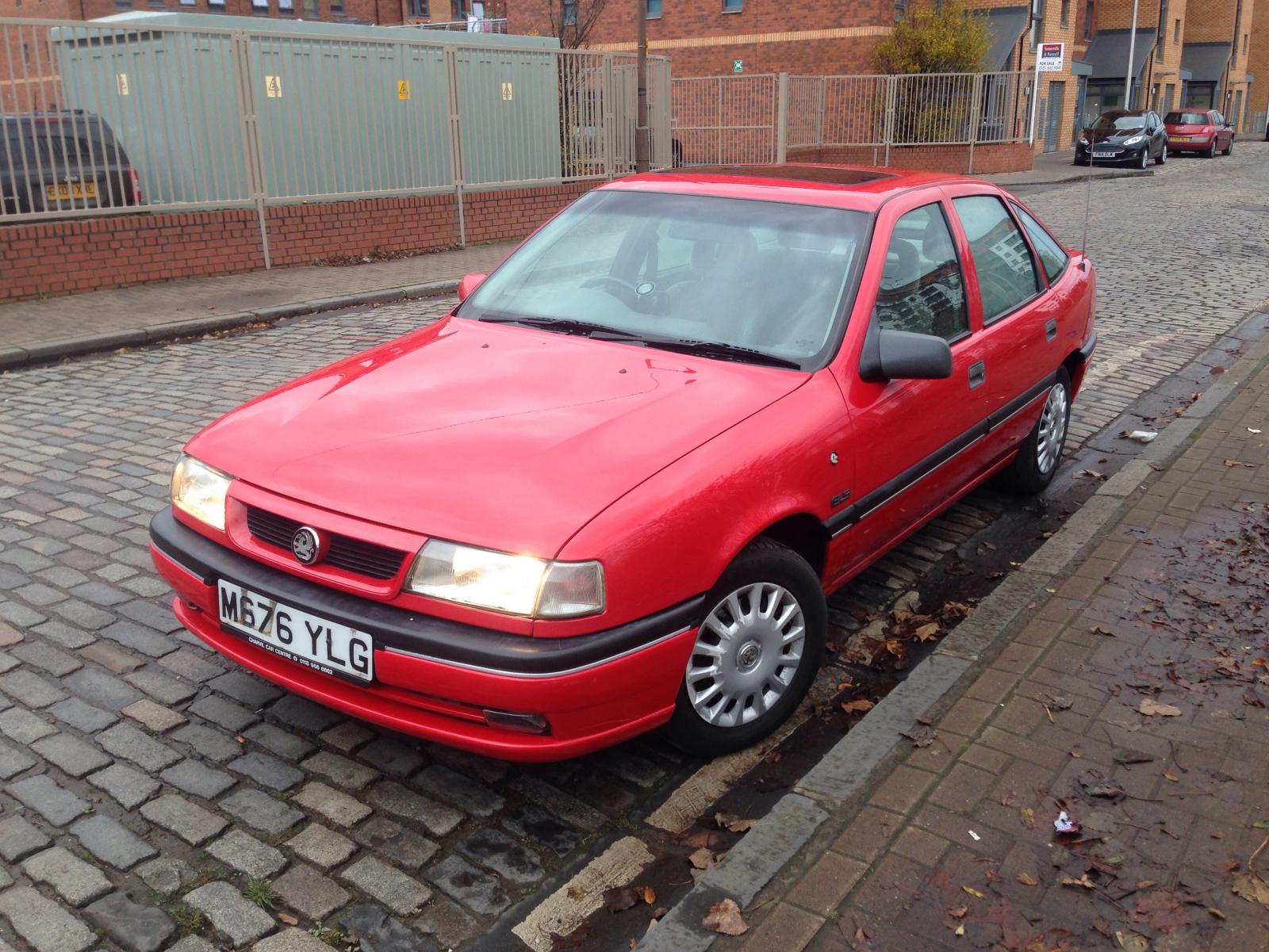

Now that it's been pressed into my daily 60 mile round trip commute and it's had a wash, here's the cavalier in all its glory:
post-212-0-47509600-1415799031_thumb.jpgpost-212-0-75150000-1415799006_thumb.jpgpost-212-0-54142300-1415799048_thumb.jpg
It's got a leaky rocker cover so new gasket going on, the handbrake needs adjusted and it could do with a new front plate but that's about it really. Drives brilliantly- I'd forgotten how capable these were.
Gonna fire it in to Barry Cade's garage next week for an MOT but I don't think there's anything too sinister beyond the bits above which I'll do before it goes in - other than that I just need to find some alloys and enjoy it.
