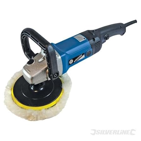

What you need is one of these.
http://www.amazon.co.uk/Silverline-Tools-264569-Sander-Polisher/dp/B002QS1LZ2/ref=sr_1_1?ie=UTF8&qid=1393520189&sr=8-1&keywords=silverline+polisher
with a decent mop head.

Just be careful how hard you press on the electric-polisher, it doesn't need much more than very light pressure, and keep moving it around in small, overlapping, circular motions. They can remove the polish you've applied and even the paint.

How do you apply with a mop? Should it be wet or dry?
I always use water, wet the mop head and panel with a spray bottle, it helps to stop the paintwork from getting to hot and burning through, it's bloody messy though!
