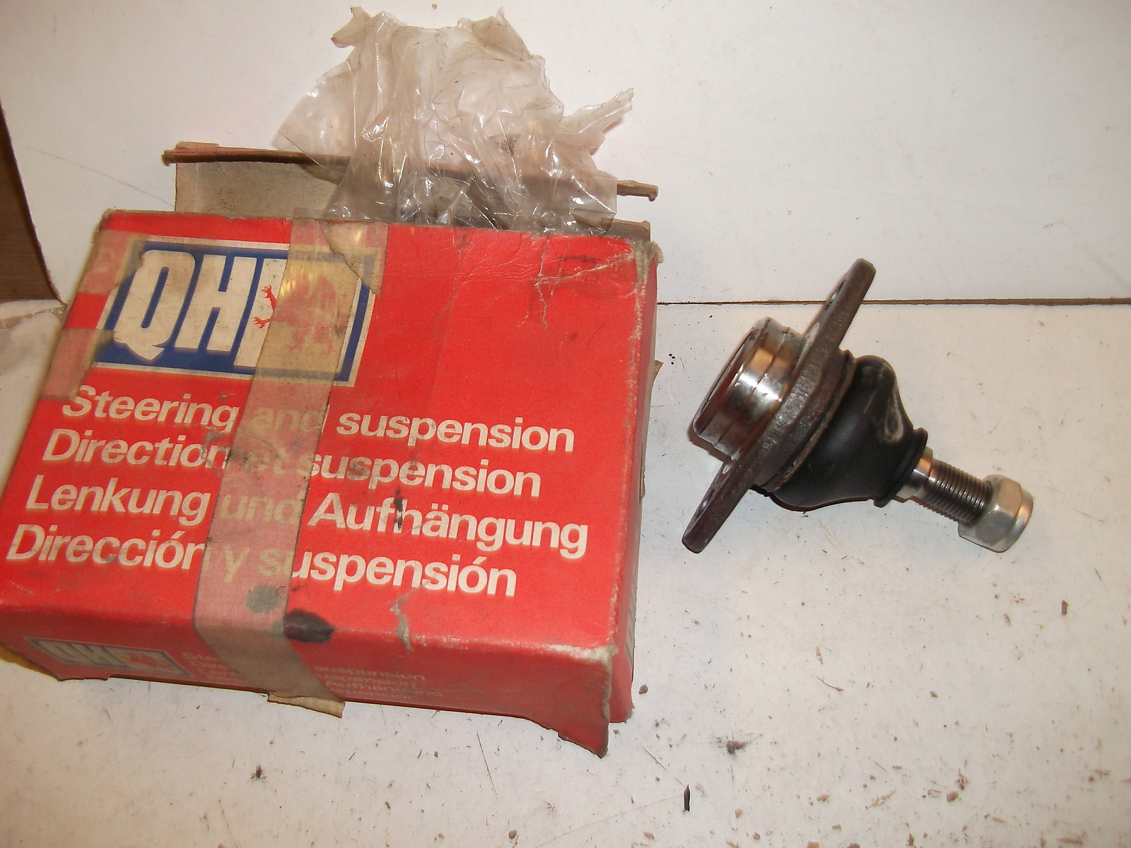

Upper ball joints for this car are proving particularly elusive.  The one set I did track down turned out not to exist so my money was refunded and apart from one listing in France, I've been unable to find another pair.

Same suspension as the Renault 4 isn't it? Some places might list 4 parts not realising they are interchangeable with the 6.
I could be utterly wrong of course
Seller certainly reckons so (ergo refund should be available if they aren't).  I've not looked closely enough at mine to be able to tell by sight.  I'd've thought worth a punt at less than 7 quid each delivered.

I just noticed those are Jolly Good Car Spares, one of my favourite eBay sellers for being brilliant.  I wonder why they didn't come up in my search?  I did hunt for R4 stuff as well as R6.

Well, that's the ball joints bought - confirmation from another forum on part numbers meant that the one Wuvvum suggested was correct, and cheap! - and a new clutch cable too.  Waiting on a bit more info with brake pads and larger belt before I pay for those.  The internet is ludicrously helpful with this endeavour.

Update time again.  The upper ball joints arrived and I collected some 6mm fuel hose and a pair of wiper blades the other day.  Today is not the day I fit those though.
