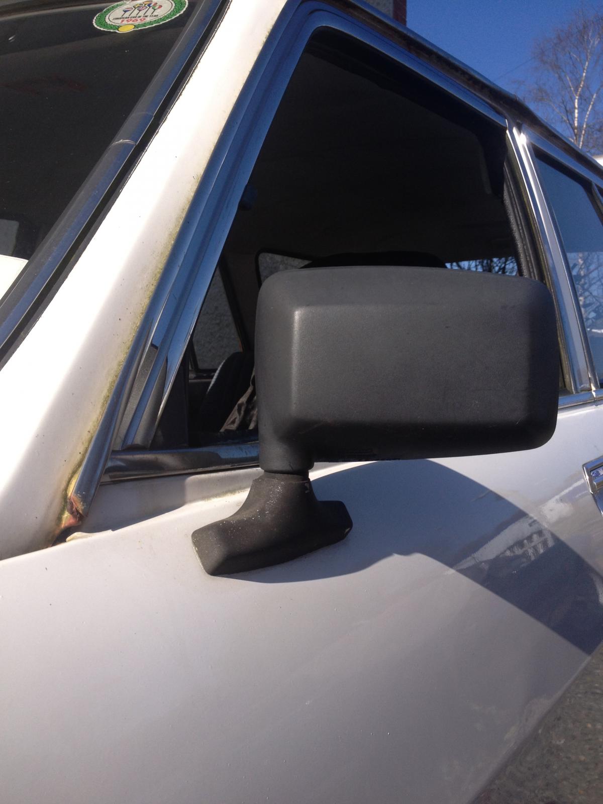

In other news I binned this aftermarket add on...
For this Retroviseur from french e bay...
Which matches the driver's mirror now. The french language makes even a wing mirror sound cool. The paint cleaned up well afterwards.

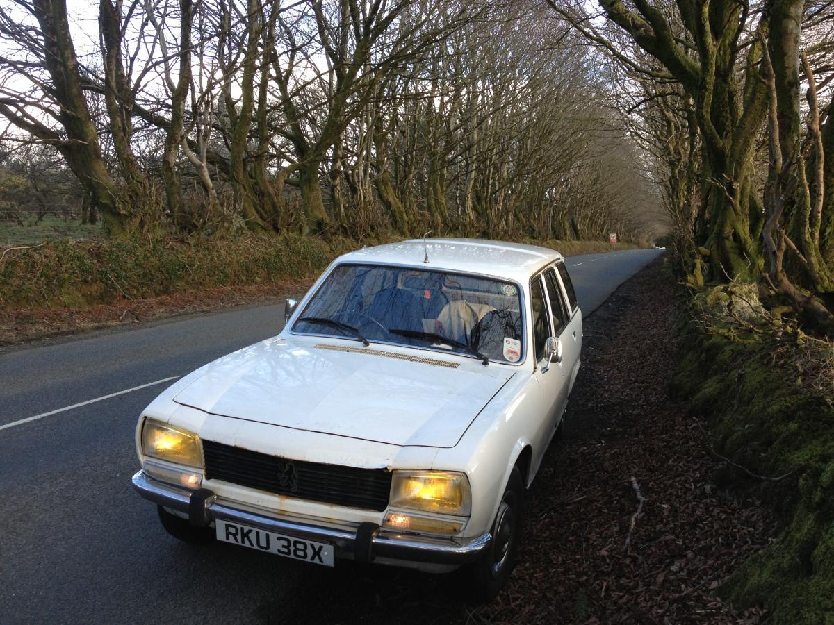

Its been used as a daily and apart from being a now common colour it tends to draw glances, probably not always for the best reasons. Most people ask what make it is.

 It. Is. Gorgeous.
Just lovely.
What is wrong with people? Peugeots looked like this for about 20 years. This looks more like a Peugeot than current Peugeots. What do (normal) people go around paying attention to?
Re the n/s mirror these were an optional extra and if ordered, on a PDI, you had to drill out the holes for the captive nuts.

^^agreed...most people seem to be staring at little screens these days.   Gurt big lion on grille not a giveaway then?   Then again I must keep reminding myself not everybody a/ cares about stuff that I do or b/ has stalked this land for half a century.   Rant over, more importantly those mirrors are frogtastic, just like the ones on my old R4.   Only a shiter would care about these details in the face of what would constitute bigger issues to some people (eg. shiny paint).

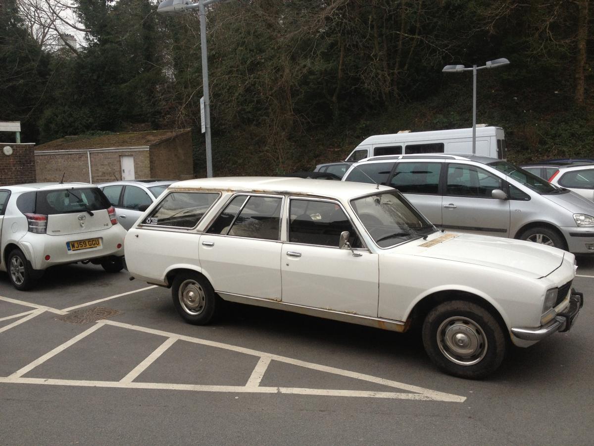

Took old smokey down the road to the River Tamar on the Devon/ Cornwall border, to see my trusted old car bodywork man. Steve, who ive had work on various old cars i've owned over the years; he did the whole sucking of air through teeth thing and eyed up the utterly ruined rain gutters of the 504. Quite why they've dissolved so spectacularly is a mystery- google images provided pics of countless scrap 504 estates with little metal elsewhere but competely intact rain gutters.  As suspected, to do the job properly will require headlining removal, rear 1/4 window removal, windscreen removal (some dubious looking bits extending to the drivers a pillar and scuttle) and many hours work. Depressing, but ive known about it the whole time so its not exactly news. Im going to pencil it in mid next year and plan to go ahead then assuming it continues to provide reliable and economical transport.

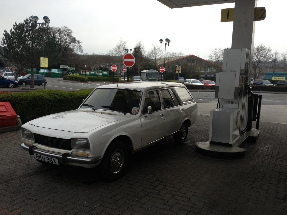

Economic yes, its no HDI or XUD but this smokey old indenor xd2 can deliver reasonable consumption figures for its era. Local pottering has given 41MPG. Im going with the traffic flow but doing the usual stuff to maximise the MPG. Its lack of 5th bites into overall economy on the motorway, but on the undulating lanes of Devon this softly sprung old 504 is right at home.

Could the gutter damage have been due to those clamp-on roof racks? Roof racks were a common sight on big estate cars, the clamps were pretty brutal.

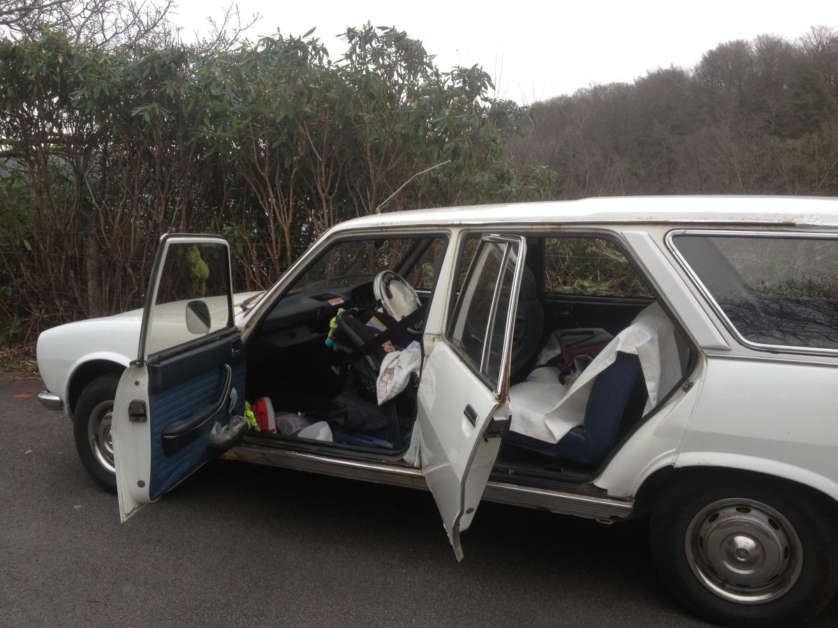

Great photo there, my son just turned 1 and my wife got a picture if him standing in the drivers seat holding the wheel!
