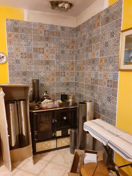

Here is a pic of my kitchen stufa, i wish the quality inside was anywhere near yours, also highlights the fact that it has taken me more than 6 months to re do the chimney,  and i have still not done it so missed all winter.

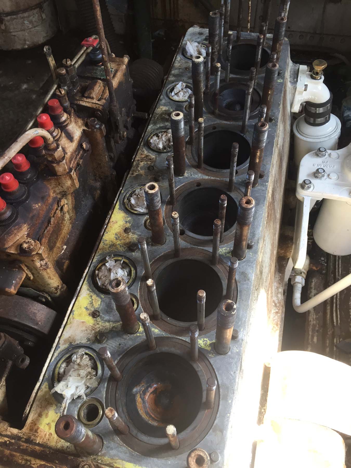

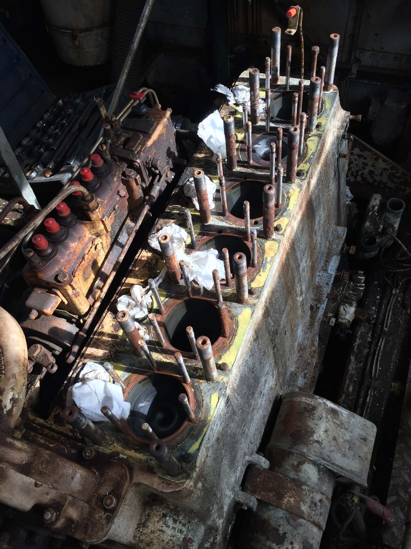

Heads all removed:

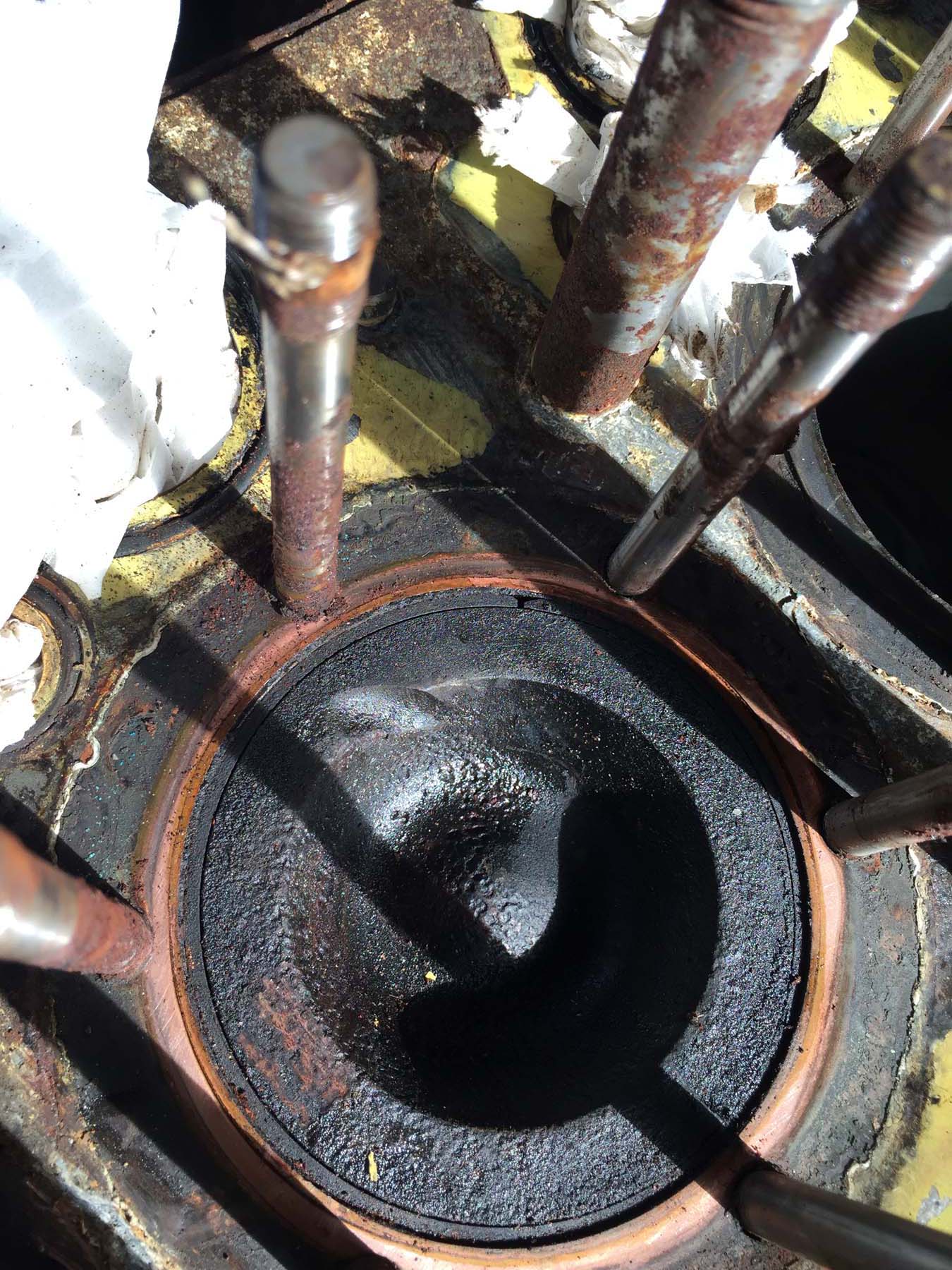

No2 piston crown looking rather manky and pitted:

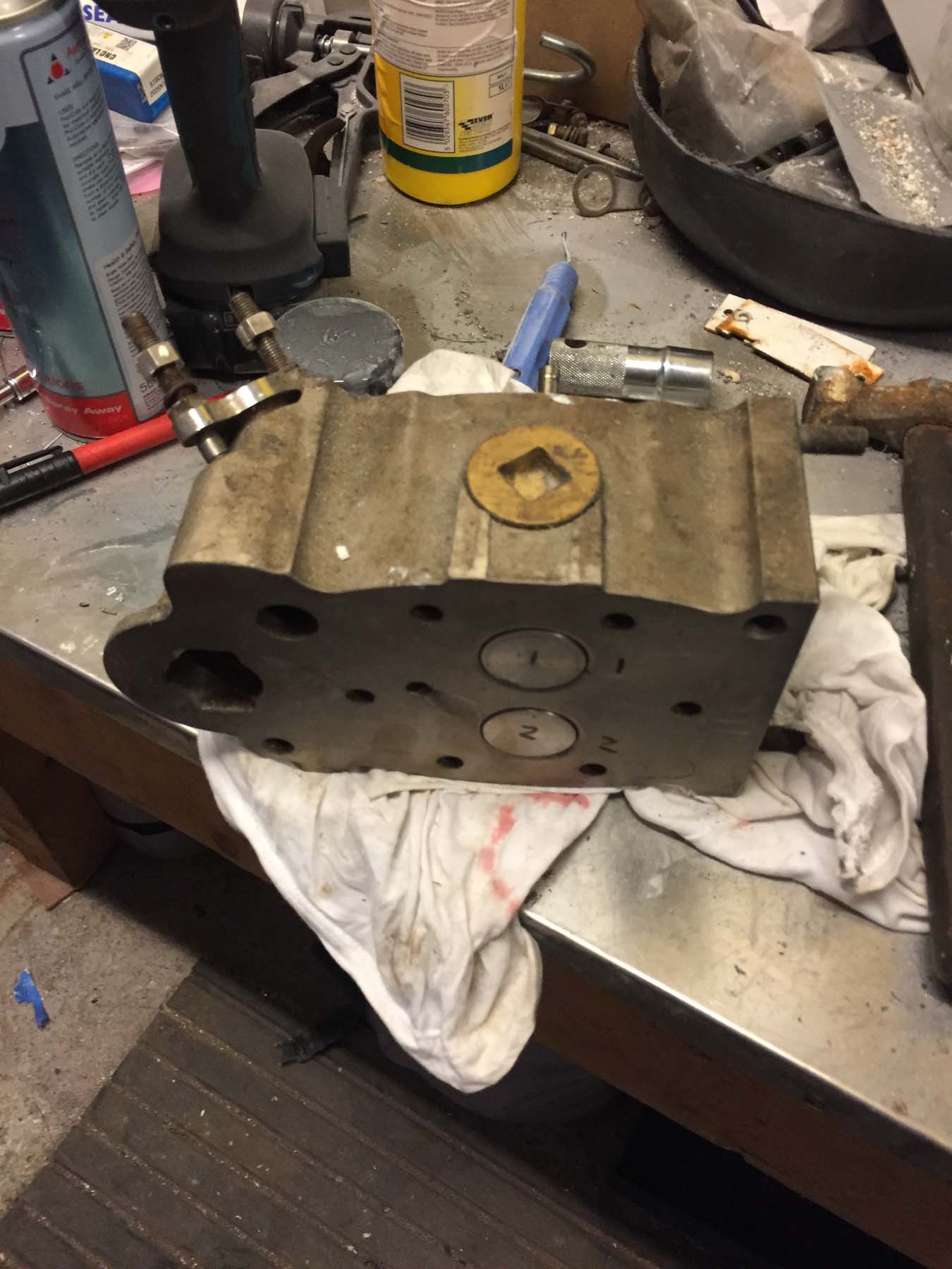

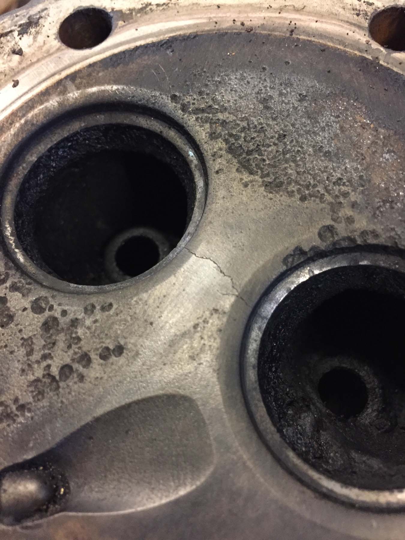

Lets have a look at the head off no2 cylinder:
Well that explains the pitting on the piston crown then! The crack between the exhaust valve seats goes through into the waterway - just as well I decided to pull them and that I bought all those spare heads eh?!

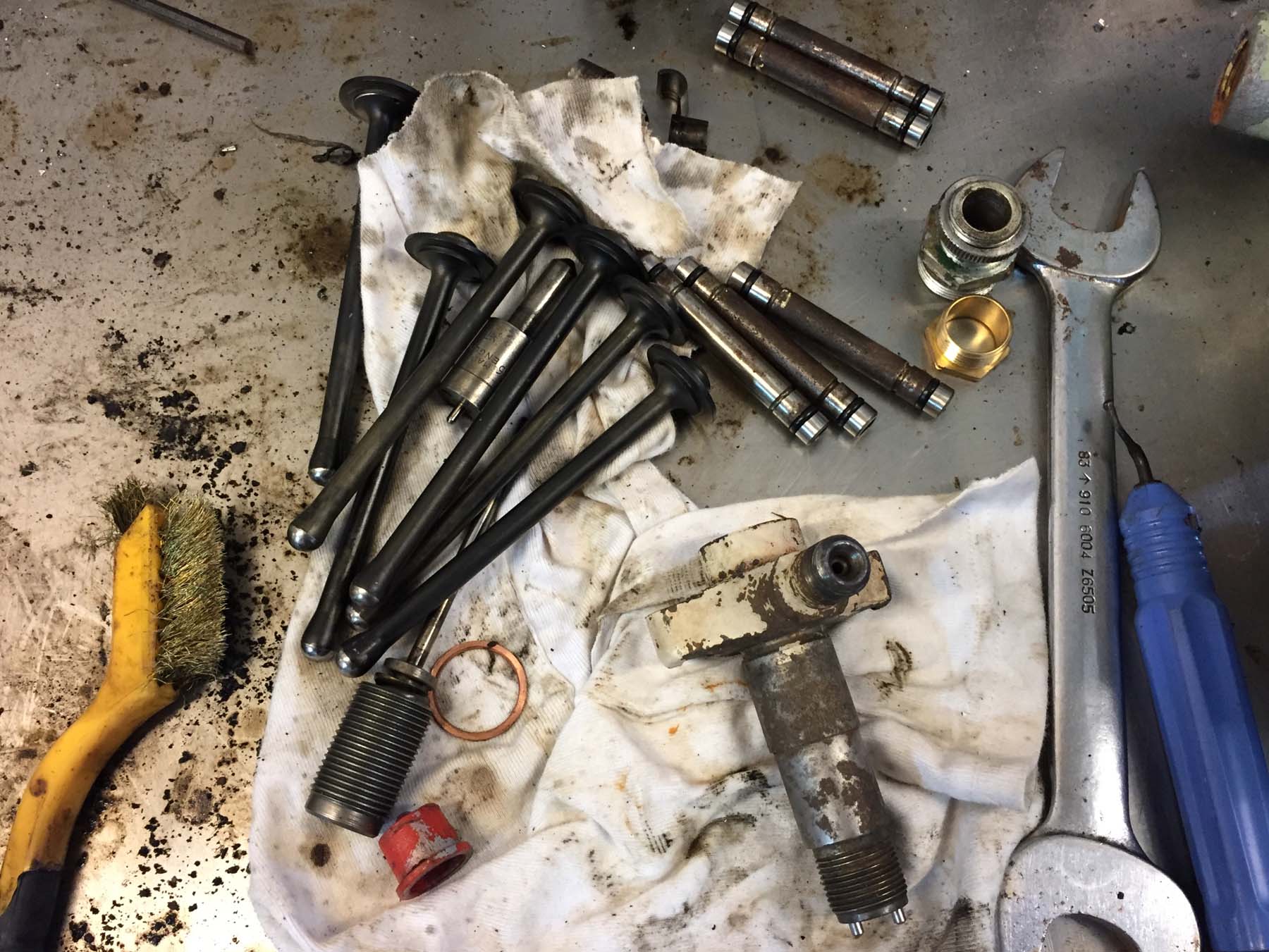

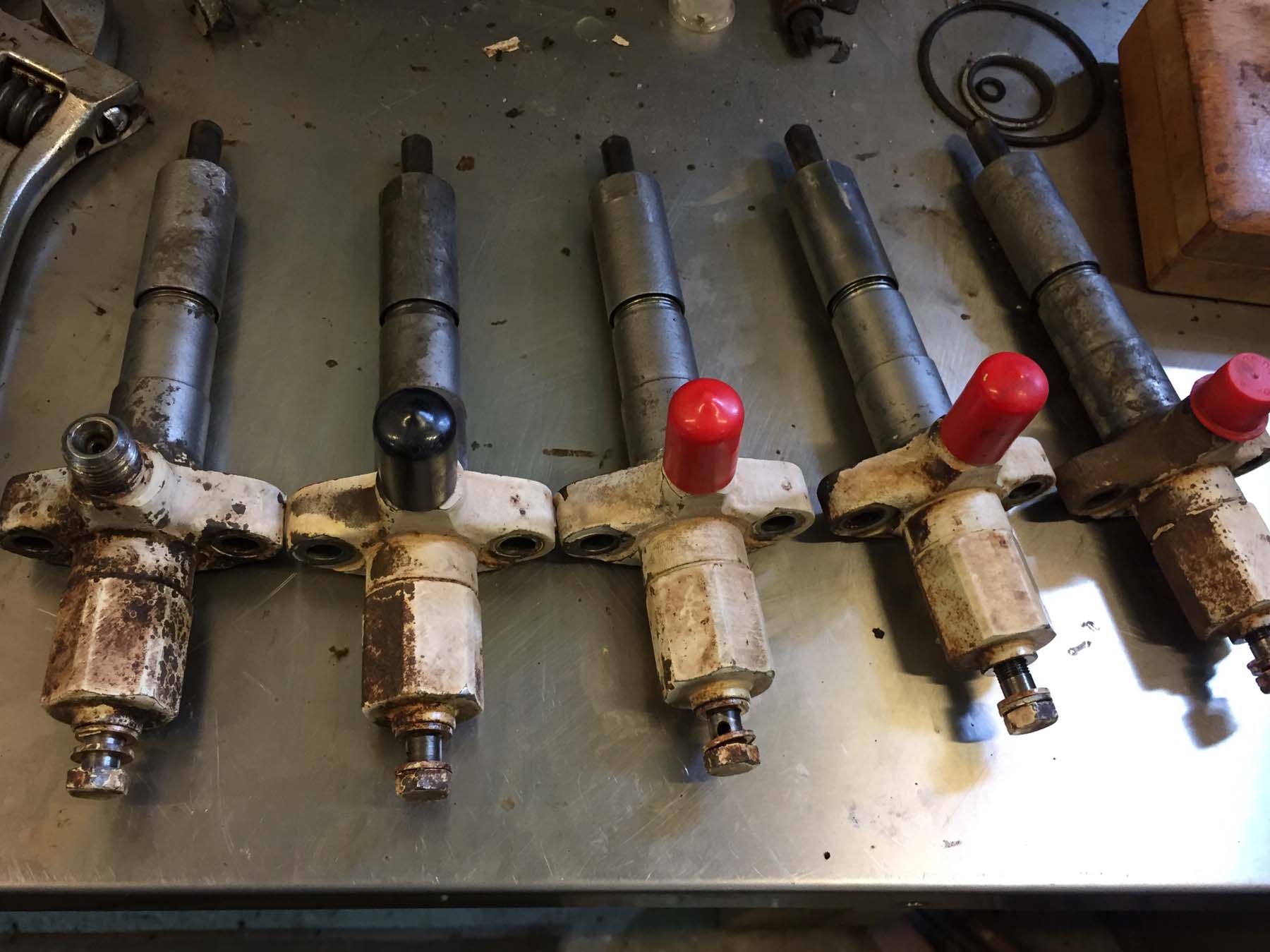

Injectors pulled from the heads:
Nozzle holders are showing some serious corrosion on a couple of the injectors too:

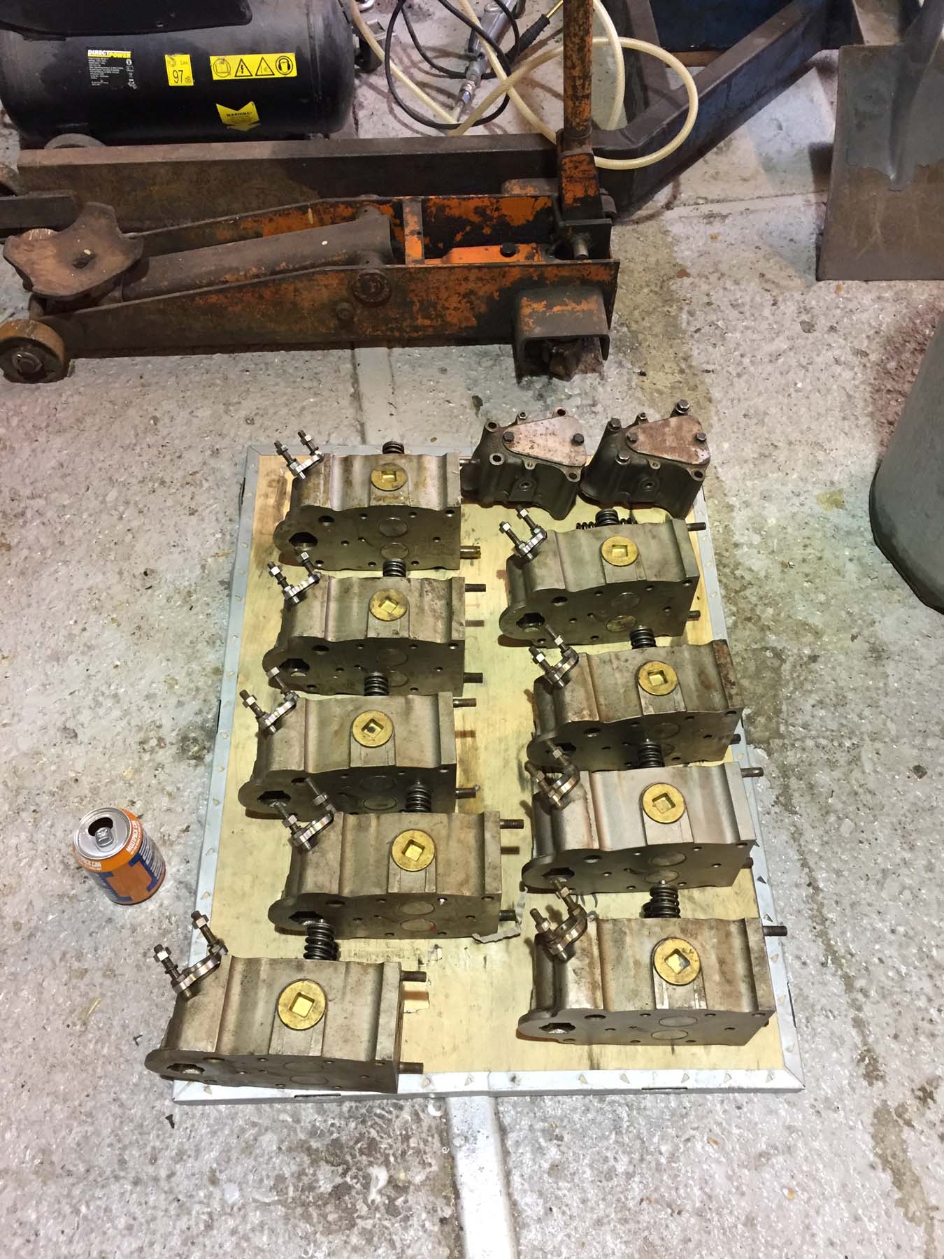

Some of the spare heads pulled out of a crate ready to clean up for use - These are some of the random ones I bought a year or two ago, there's also a set of six boxed ones complete with all the rocker gear etc but I've figured it makes sense to keep those in stock and use up the unboxed ones first.
If your thinking they look very shiny that's because they're some exciting variety of low magnetic stainless intended for use on minesweepers:

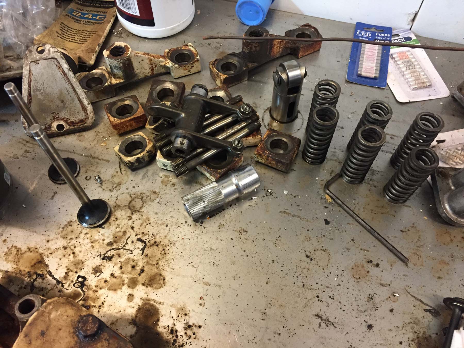

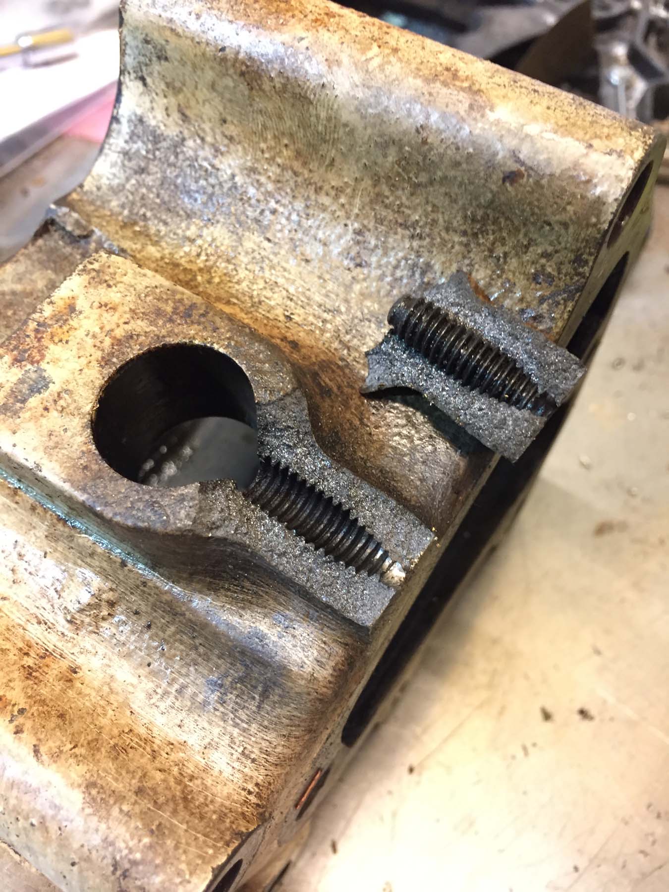

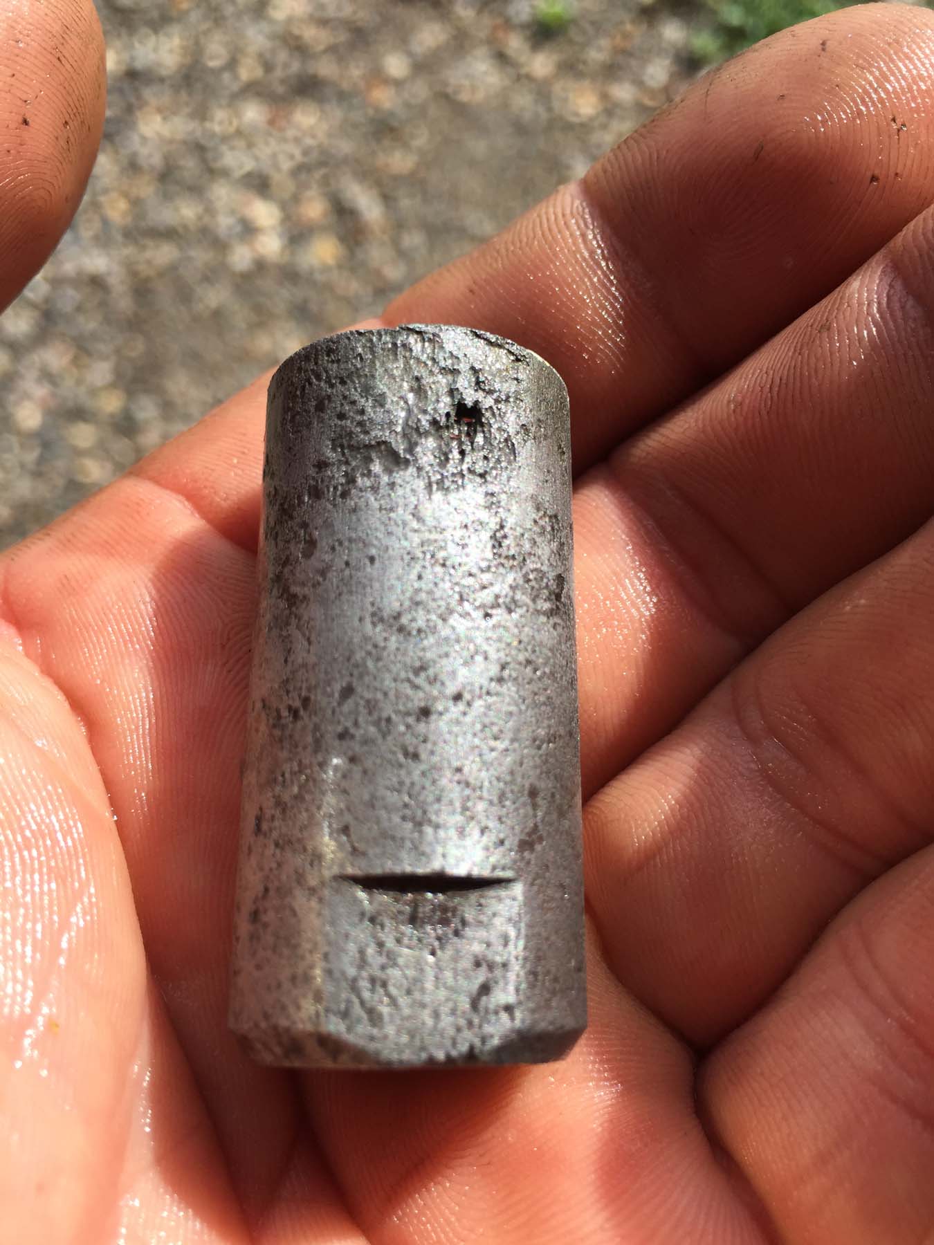

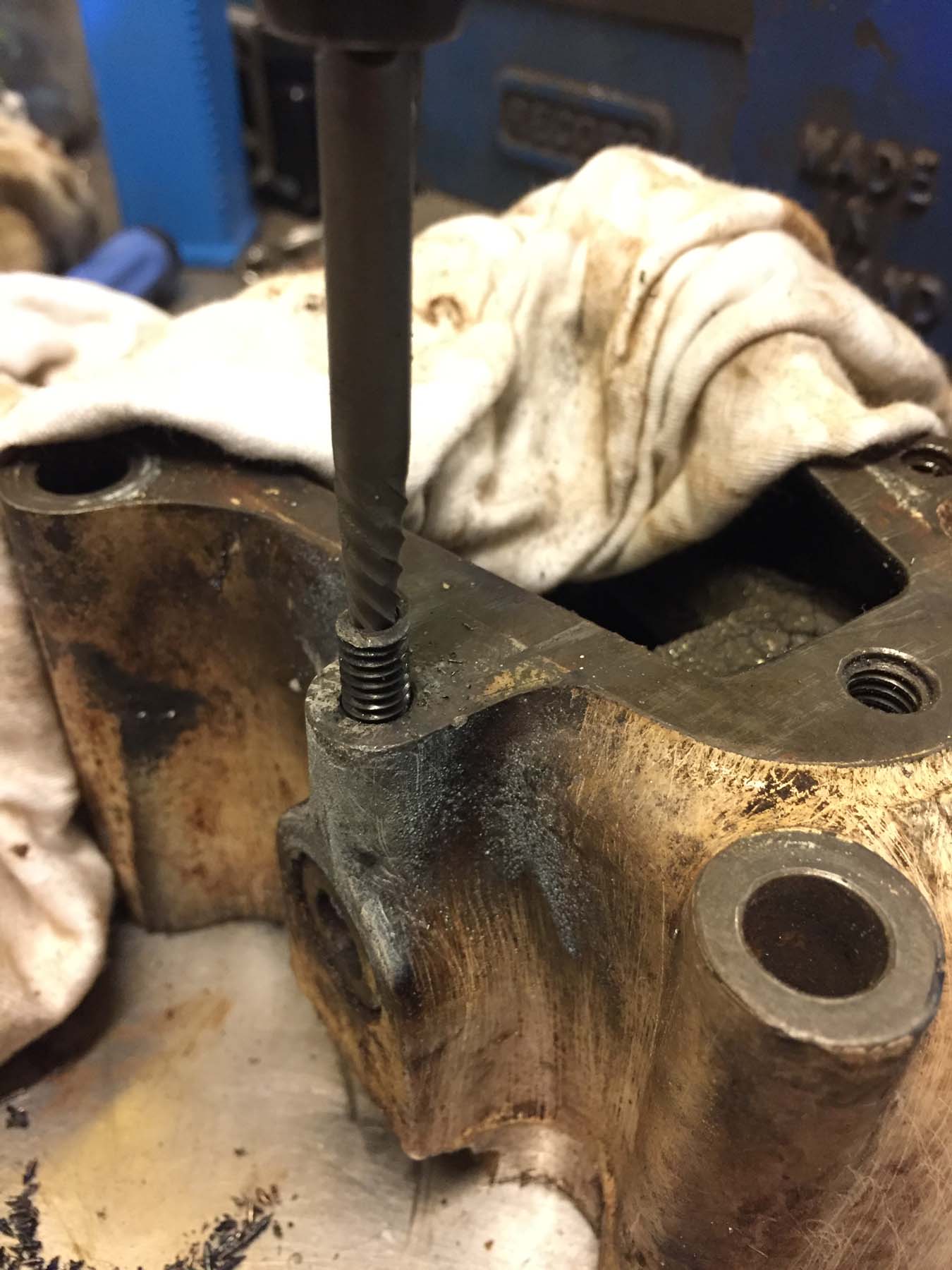

To get the rocker shafts out of the rocker cases theres a couple of allen headed grubscrews which unfortunately appear to have heads made out of brittle cheese - only one came out using an allen key and heat, the rest the allen sockets just cracked into six pieces leaving the rest of the grubscrew down the hole.
First four came out ok with some careful drilling:
Last one didn't ? Luckily I have two spare rocker housings so this i'snt the end of the world:
Rocker gear and other ancillary bits stripped off the heads awaiting cleanup:
New heads were marked up and the valves stripped out ready for putting it all through the parts washer:

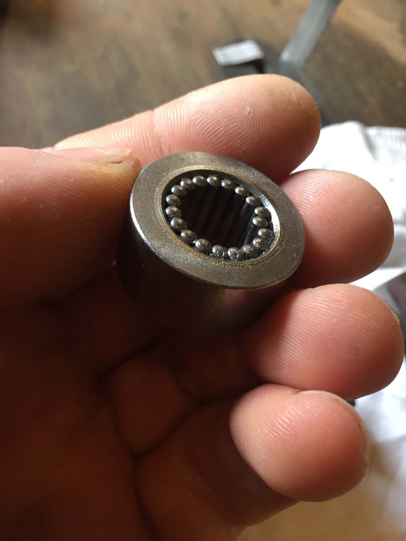

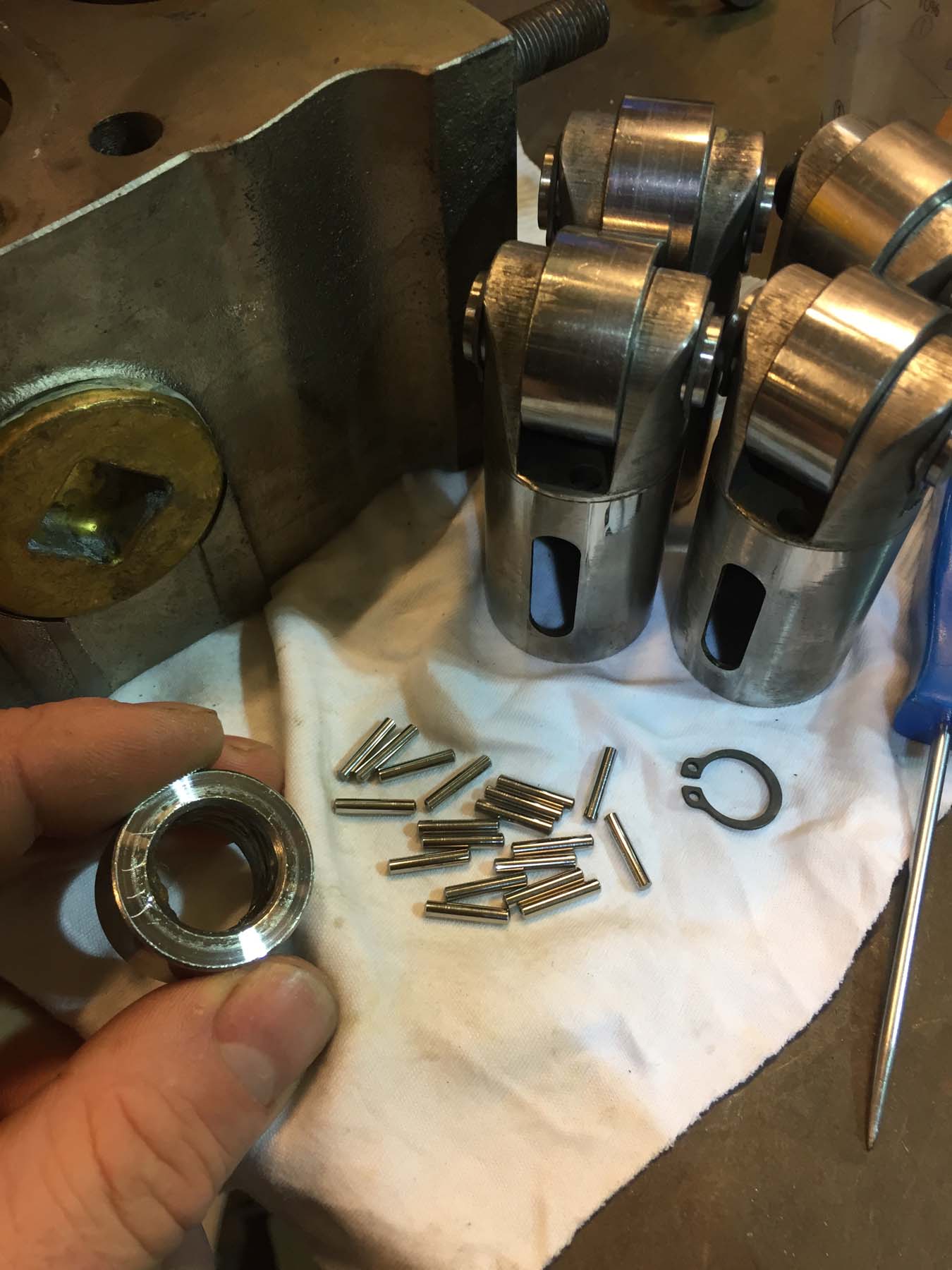

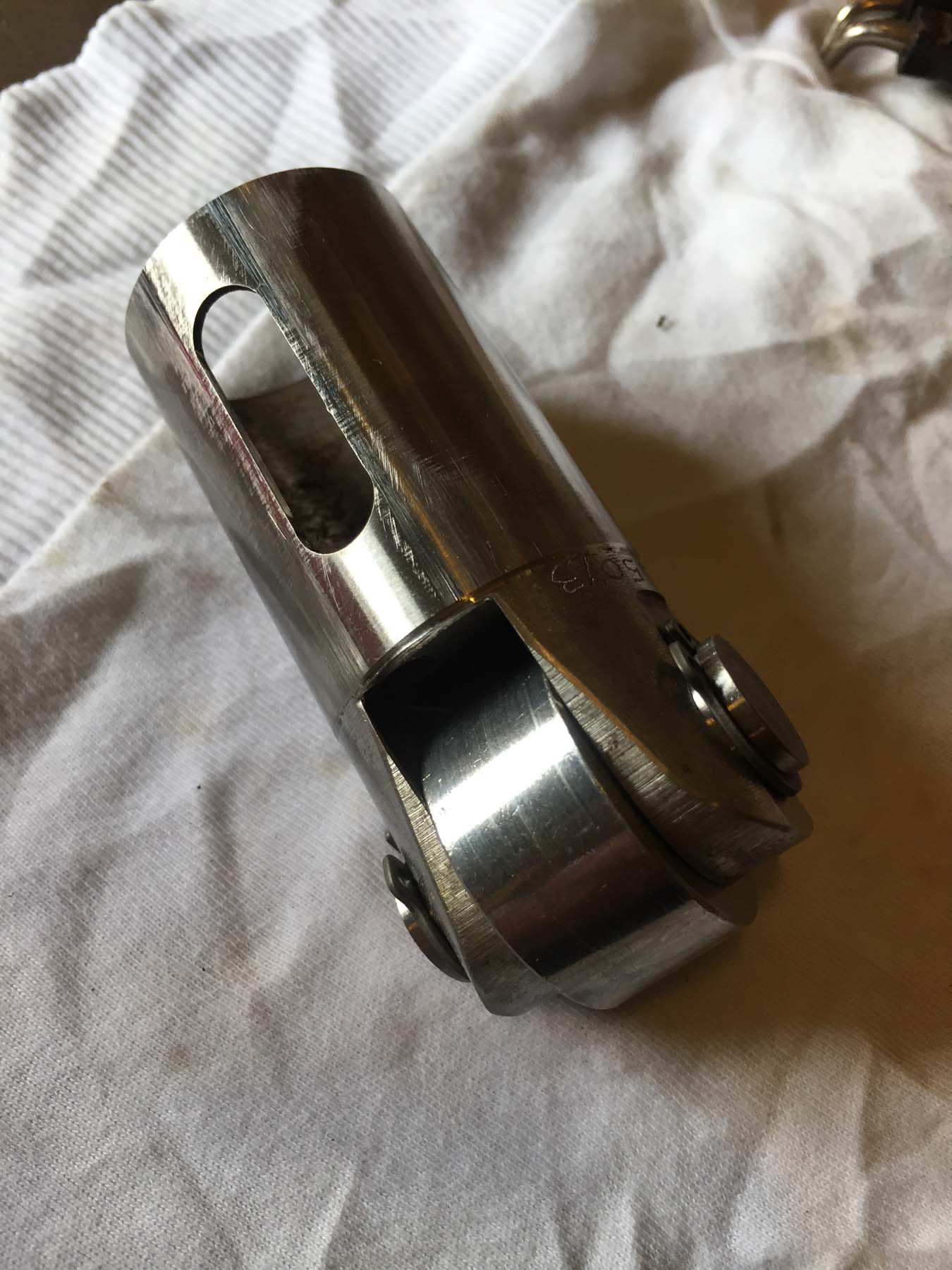

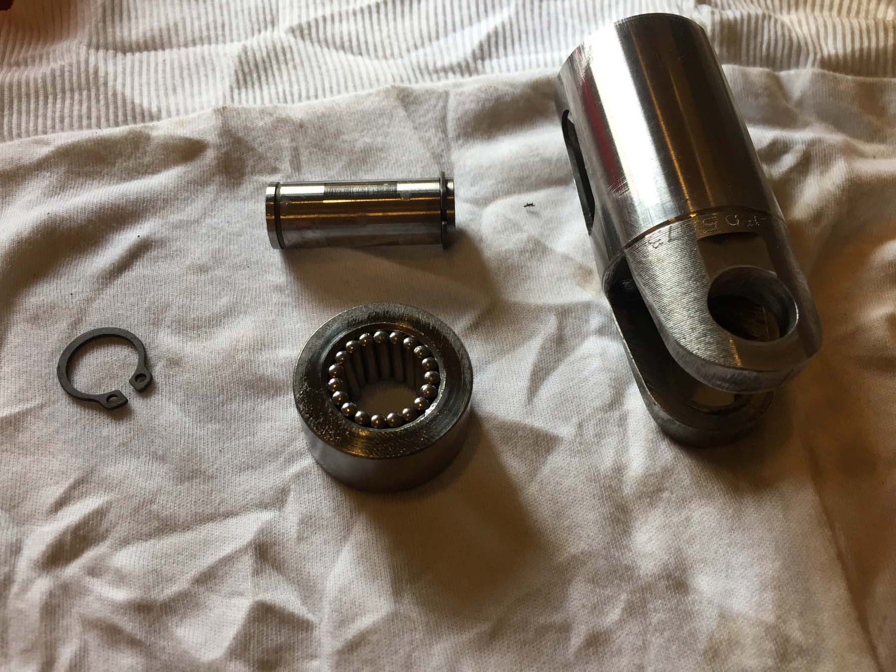

With the parts cleaned up it was time to reassemble the cam followers:
Bit of grease to hold the needle rollers in place during reassembly:

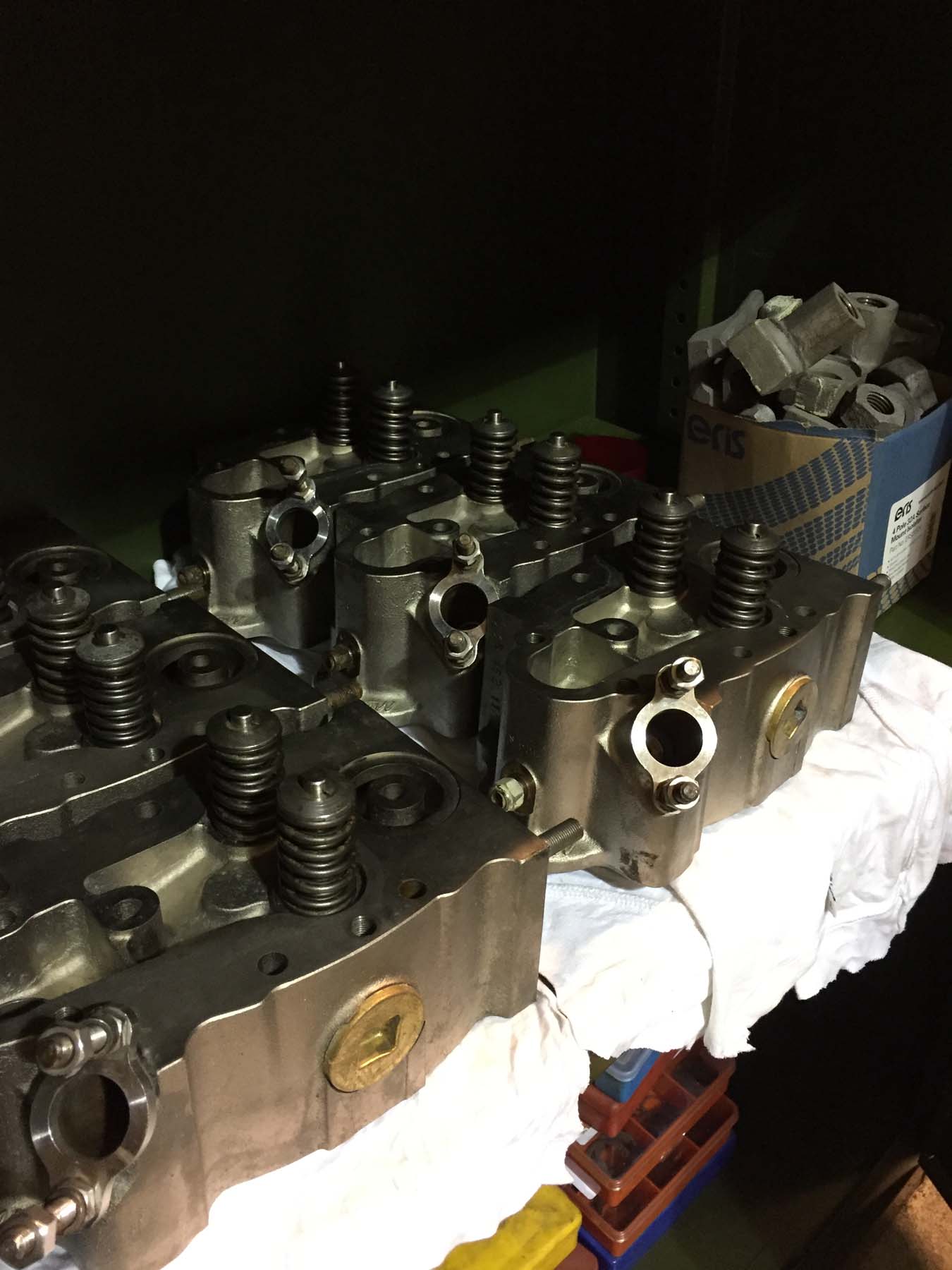

Reassembled heads stored ready to fit to the engine:

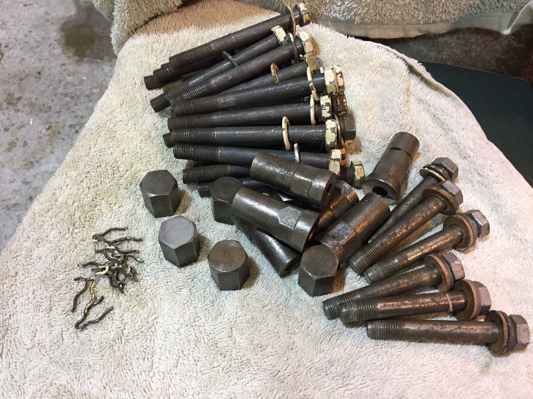

And assorted hardware cleaned up:
New head/liner nuts and washers:

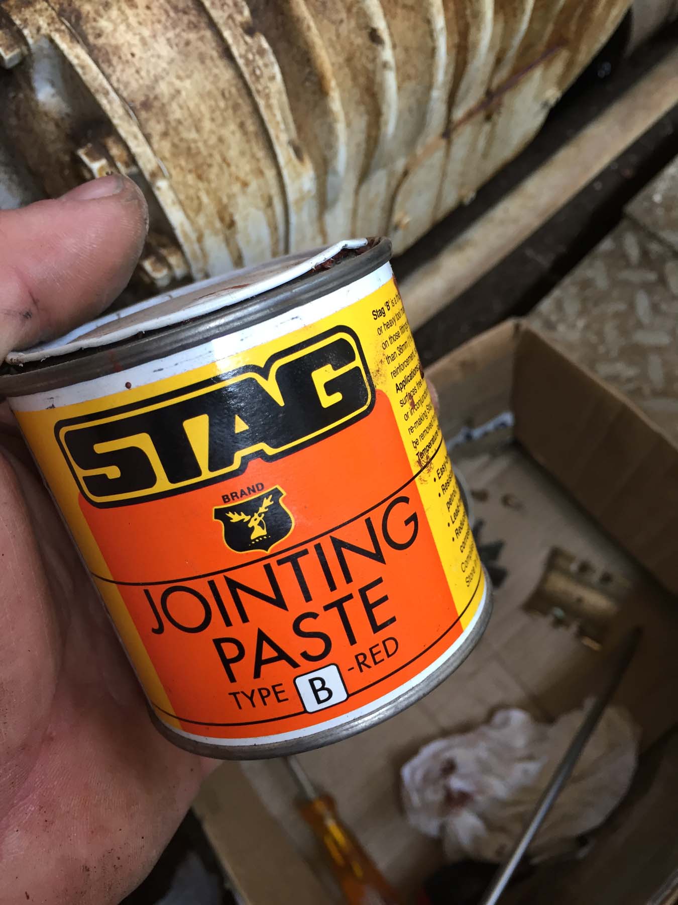

I've also finally got round to fitting the right cam plate to the raw waterpump, bedded in on a nice bit of Stag Red. Something about this stuff means no matter how hard I try it ends up everywhere and on everything:

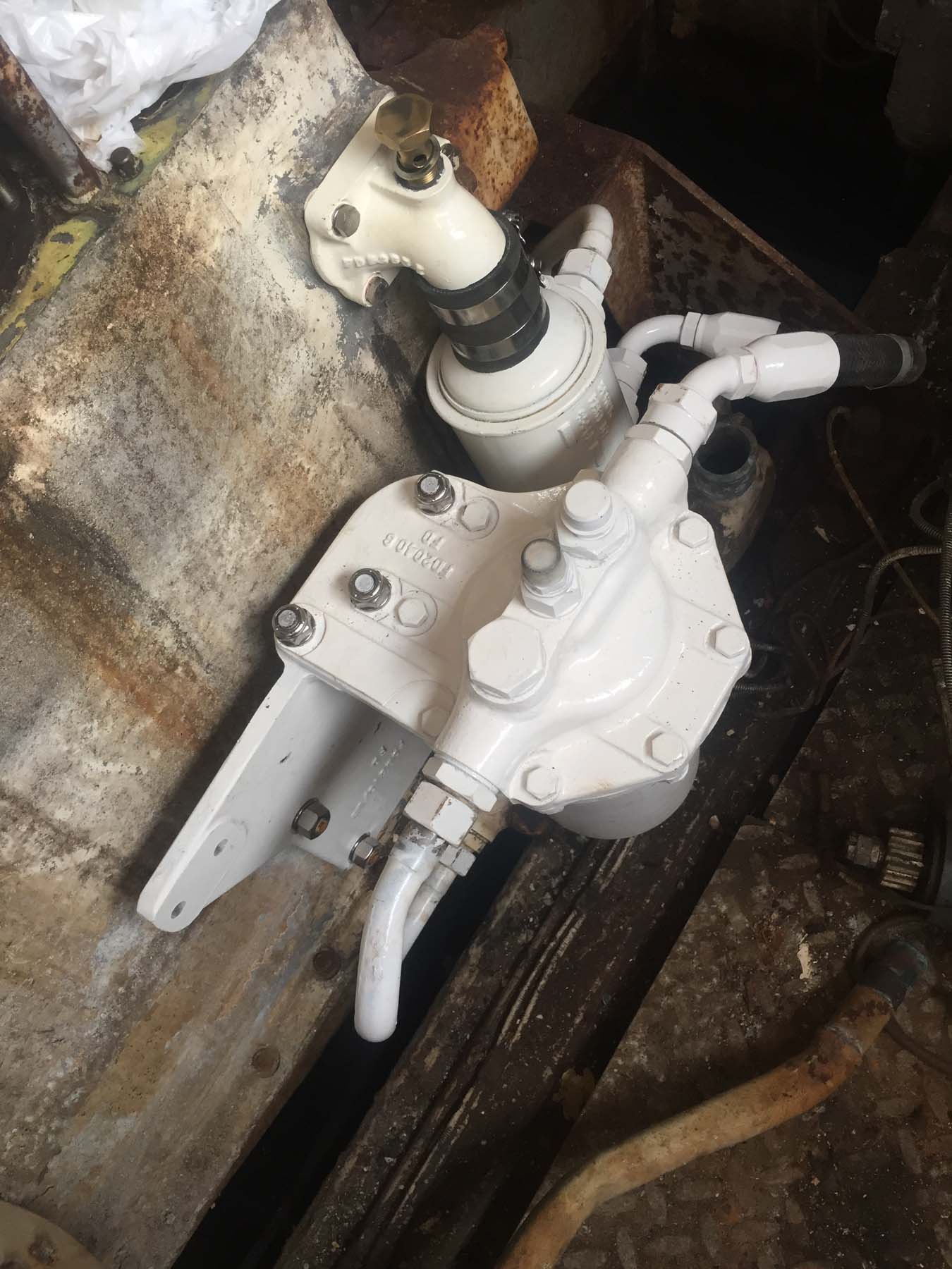

Oil Filter and Cooler finally refitted to the engine:

Getting parts has been a bit of a mission for some of this - Rather than resorting to ptfe I've had a company in the midlands make me up a batch of annealed copper washers in the correct thickness and diameter for the liner studs,  I managed to get Gatwick Distribution Services to track down a few sets of the later improved sealing rings for the head to block waterways, something that seems to have been developed so late in the day they don't actually appear in any of the parts lists. I've also got a new set of injection pipes somewhere en route as my original ones are a mismatched set fitted to an odd set of injector bodies and don't all fit my spare set of matching injectors!.

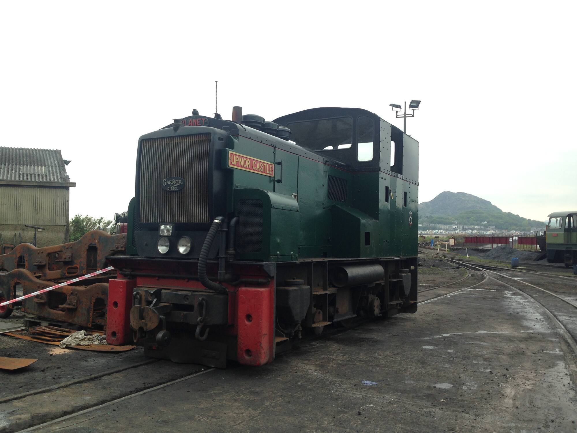

Originally had a similar Foden 105bhp FD6 - I’d have loved to have heard it run as built. In 1971 the Foden lump was pulled out and replaced with a Gardner 6LW (and later a 180bhp 6LXB). Unfortunately the one flaw with the Gardner lump is that it is very low-revving, and the loco is geared for the higher-revving FD6. It now does 18mph flat out and deafens you in the process as there is no silencer fitted. I suspect the Foden lump was gotten rid of mainly because of the problem with getting bits for them, the Gardner lumps were easier, cheaper and quicker to get bits for.
