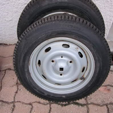

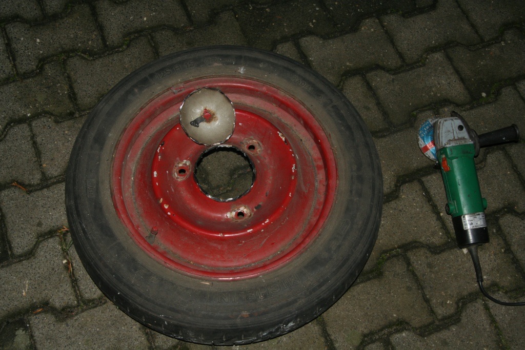

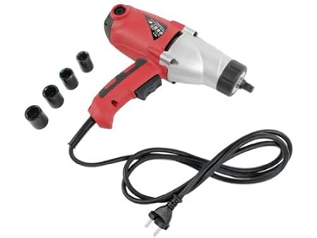

HillmanImp Posted March 16, 2015 Author Posted March 16, 2015 Is that an impact wrench Sigmund? How would I use that in this situation? Would I use it on the hub nut whilst someone else held onto the strongbar on the wheelnut hoping that it didn't flip'em over? I was going to suggest the car needs to be on the floor, with the wheel on, but doesn't this have wheels with covered centres? If so my suggestion is getting someone to stand on the brakes and use a big bar. Aye, no hole here: Most places cant even balance them. Did the brakes/big bar thing but to no avail. Obvs. it was a 7 month preggers Mrs Imp on the brakes so maybe not ideal and I did not want to stress her but I would've thought I might have budged it. That's always worked in the past on other cars. Great work on the welding!! I bet welding those strut mounts was tricky, but looks to have worked out really well. Was mega awkward. I cant see anywhere that this car has needed welding before but when its gone its made sure its in the most fucking difficult place possible. A couple of times I lost track of where I was going at on the welds on the top and just did a line for no reason only to look after and realise I had lost the line of the metal somewhere. My view was what you could see in the photos with any kind of head/face/eye protection on. I had lots of sparks flying down my sleeve which is okay, I am used to it as really can't do welding gloves and can put up with the odd pockmark, I can't feel what I am doing but one burn seemed to be warmer than usual so I looked and realised my jumper was on fire. Amazingly it didn't burn me, I just flailed around for 10 seconds and it went out.
Sigmund Fraud Posted March 16, 2015 Posted March 16, 2015 Is that an impact wrench Sigmund? How would I use that in this situation? Would I use it on the hub nut whilst someone else held onto the strongbar on the wheelnut hoping that it didn't flip'em over? A safer option would be to ask your glamorous assistant to step on the brakes while you use the wrench. Those wrenches probably don't generate much more torque than an angry Autoshitter hanging off a breaker bar, but they have a brilliant hammering action which seems to do the trick in most cases. HillmanImp 1
