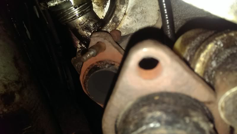

HillmanImp Posted November 5, 2013 Author Posted November 5, 2013 Well......progress on Meg has been slower than expected. It was kept in tax exile until the first of October as I was not going to tax it for just a few days and a new tax disc was picked up on Friday from the Dooovla offices. I knew the exhaust had a 'blow' but when I looked underneath the front pipe was pretty borked and covered in exhaust clag and also had a bad blow from the middle box too despite the rest of the centre section looking in quite good condition. I looked online managed to get hold of both sections for £60 which seemed reasonable enough for me to just buy them without looking around and got them delivered to work. Meg is currently sat in a garage about 7 miles away from my house so on Saturday morning, i gathered up all the tools that I needed and took them over. The exhaust came off easily with the exception of one nut that rounded but that even came off aster a short while with a little persuasion. It was at this point that I encountered my first problem. The flange on the pipe had no means to come off as there was some sort of brace on the pipe that was not going to move stopping the flange coming off. So I had to go home, pick up my angle grinder and come back. When I got back I realised I had forgotten my extension cable. Much cursing ensued mainly about why didn't I just take the pipe back and cut it at mine instead of bringing the ange grinder to me. Thinking this was a good idea I headed home and cut the pipe, sat down, had a beer and some super noodles and headed back over to Meg WITHOUT THE FUCKING FLANGE WHICH WAS THE ENTIRE REASON I WAS BACK AT MY HOUSE IN THE FUCKING FIRST PLACE! FUCK! Thankfully I was only about half way there when I realised which probably saved me having an aortic aneurysm and I simply headed back and picked it up taking a few deep breaths. Once back I managed to get all the exhaust together and hung properly ableit only provisionally with nothing tightened up. So i went to tighten up the front pipe. This is where I encountered my second problem. The old bolts that held the flanges in place were old and the thread had rusted. This meant that there was no way of tightening them back up. Not a big problem, I can get some new bolts from a motor factors and simply replace them and so packed up for the day and went out for a few beers. So yesterday I went and bought a new fitting kit from town. I headed over to Meg after work, pulled off the front pipe from where it was provisionally fitted ready to be tightened and removed one of the bolts. When I went to remove the other bolt this happened: That is as far that the bolt will go in any direction until it hits something. The flange it fits into will not budge. Therefore after a discussion with Volksy over the phone last night I think I am going to have to rethread it and try fitting a smaller bolt with a washer or something on it and hope that works before I dismantle the whole fucking car in order to remove this one sodding bolt. So basically I am still soley responsible for keeping the Grangemouth Refinery open as I am still using the Audi as a daily driver. I will hopefully have a slighty better update on Meg in the next few days. catsinthewelder, cobblers, Richard and 1 other 4

SambaS Posted November 5, 2013 Posted November 5, 2013 I greatly dislike any job that involves me doing it at the moment, but especially fitting exhausts onto these things!

HillmanImp Posted November 5, 2013 Author Posted November 5, 2013 I have the bolts thanks but think that I am going to try re-threading the one that's already there before I try and replace it as its going to be a right pig getting it out. I did not think that fitting an exhaust would be such a total pain in the arse. If I had known that I would probably have reclagged it. But I did say I wanted something small and French so I only have myself to blame and like I say, I am going to be using this as my daily so need to make sure its done right. Been out to the pub tonight so will dig out my tap and die set tomorrow and head back over and give it go before I consider sorting properly and rapping my knuckles on various bits of engine. SambaS, have you dealt with these before. Any tips on when the re thread inevitably goes wrong?

SambaS Posted November 6, 2013 Posted November 6, 2013 Don't remember having trouble getting the bolt out once undone... it kind of begs the question how did it get there in the first place? But the location of the manifold makes it a right fuck on to do.. and the bolt sits in a recess just enough to make getting a 10mm spanner on it nigh on impossible from most of the angles you have to work at. 2 fitting kits, hours scouring the web for a wire mesh gasket that it turns out DOS NOT EXIST, and my exhaust is still blowing from this join. HillmanImp 1
SambaS Posted November 6, 2013 Posted November 6, 2013 Here's my manifold with the engine out, this is the 1360cc suitcase. I wonder if you have a different manifold to mine.
alf892 Posted November 6, 2013 Posted November 6, 2013 Isn't just the heatshield stopping it going up and out? If not can't you cut the old bolt out and then fit new with bolts going up (nuts on top) instead of down? DeeJay and barefoot 2

HillmanImp Posted November 6, 2013 Author Posted November 6, 2013 Isn't just the heatshield stopping it going up and out? If not can't you cut the old bolt out and then fit new with bolts going up (nuts on top) instead of down? This might work....... However in order to keep the sleeved part of the bolt in the flanges I think I will have to put the springs on upside down assuming they fit that way round. What I can't figure out here is whether or not the spring will do what it's meant to the other way round as illustrated in this picture from the Haynes manual. i.e. give the pipe (illustrated in Pink) some flexibility. I really don't suppose it matters which side the spring is on does it? Or does it? I don't know? Its been a long day and other excuses for being dim. I will have a better look at mine when I am over there SambaS. TBH I am probably making a mountain out of a molehill here. I can bodge it well enough but for the first time in my life I thought I would try doing something properly but am quickly finding out that's for chumps and its almost always better to take the easy way out and fudge it together with elastic bands, chemical metal and sheer optimism. Ta for the help chaps and will give an update when i have made a decision how to bodge it or even do it properly. brickwall, KruJoe, Pillock and 1 other 4
alf892 Posted November 6, 2013 Posted November 6, 2013 I am guessing that the thick part of the bolt fits through manifold and flange? In which case assemble as your left pic above but with bolts other way up then nuts and flat washers on top. I reckon you will struggle to get the spring on top anyway....unless you know a pygmy with 6 foot arms and triple jointed fingers

catsinthewelder Posted November 6, 2013 Posted November 6, 2013 If it's any help the order on mine was bolthead-washer-spring-tailpipe flange-manifold flange-washer-nut. and all was well till the pipe rusted out.
HillmanImp Posted November 9, 2013 Author Posted November 9, 2013 Isn't just the heatshield stopping it going up and out? Yes it was. I took a lamp with me today rather than use the light from my phone and it was pretty obvious. Was still a pain in the arse but only took about 10 mins to get on after all that. I then took it for a spin but the exhaust was knocking against the bodywork at the back so adjusted the middle clamp/hanger and its bob on. Whoop. So all is good but once again I have made something simple very complicated. Its not just cars I do this on. At work I will make a simple bit of advice the most complicated convoluted slog of a piece of work and will go round the houses until I step back and realise there is a simple solution. Junkman and Twiggy 2
