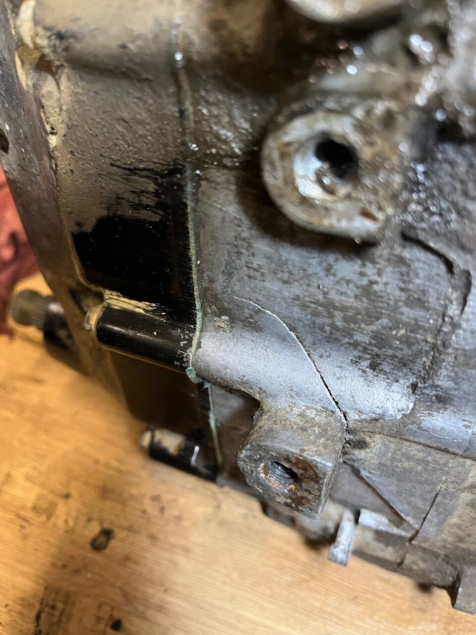

Right I think I've found it. Theres oil in the stator housing, which I assume is somewhere that should get oil in it? How involved is the repair likely to be? Engine out and split the casing? Or remove the flywheel(?) and replace a seal?
Hmm the more I think about it maybe there should be oil in there? The cover has a gasket/o ring after all...
The neutral switch wire seemed to be trapped by the cover when I took it apart. Maybe it's just that?
It should not have oil in there, the 0-ring on the cover is to stop you getting water in the electrics.
Sense says that if you remove the flywheel there should be a crank seal in there that will want replacing (i thnk, not familiar with this engine, but its most likely)
Is that the case on all bikes or are there some anomalies?
This video shows an XL engine being stripped, the magnet comes off between 20:45 and 22:45. There doesn't seem to be any oil seal on the crank, just an open bearing.
https://youtu.be/dYoAOA50xyw?si=iBcrkcvROkhMEBM5
Would it not have a bit sloshing about to feed the lower timing chain gear? The crank bearing could be fed from the other side and sealed though would make sense to me that the chain was serviceable from the outside without splitting the lump.
 Am just making this up mind. Ive worked on similar engines though honestly can't remember (much, about anything, ever).
I see what you mean, that vid doesn’t look like there is a seal. Which I’m surprised at
you could be right, been a long time since I stripped down any four stroke singles.
Seems the neutral switch and sprocket seal are in close proximity. I'll run it without the sprocket cover tomorrow and have a closer look.
Edit: I should add that the relevance of the xl125 video is that the manual covers both bikes. The engines must be the same.
