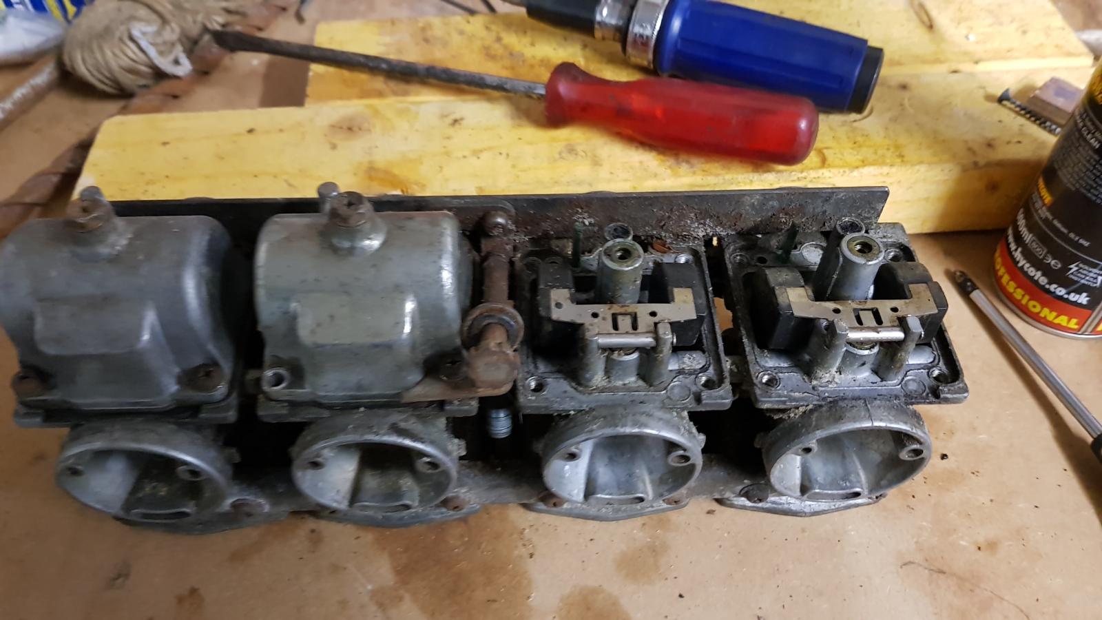

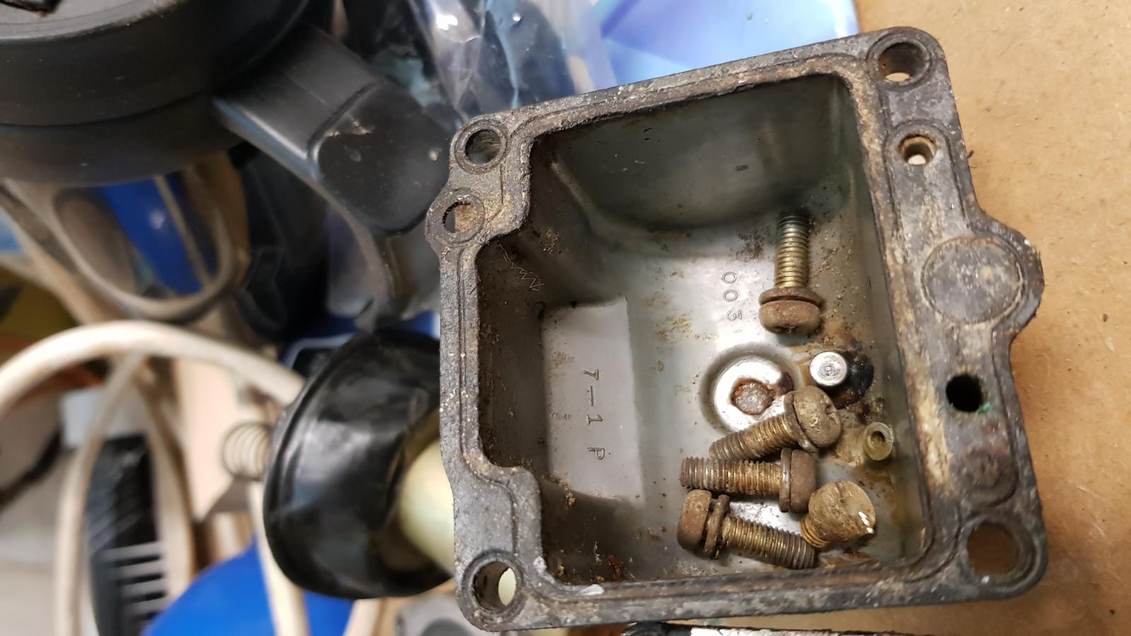

I stripped the carbs of the '83 GS650GT to clean them up.
The bike has been off the road since 1990 and the carbs were in a Lidl bag, so it shouldn't have come as a surprise to find someone had been in there before me.
A float bowl screw missing and a float needle valve gone.
One of the diaphragms has come away from the slide. Can that be repaired?
A replacement slide and diaphragm is £80!
Does anyone know if carbs off a different model would do? Maybe a katana?post-5582-0-28279100-1517338682_thumb.jpg
The only numbers I can see are cast on the inside of the float bowl and top cover.
They're Mikuni.

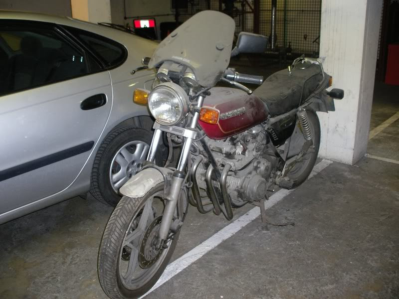

This was the GS650 that had been parked up in the basement of my office for years. A mate wanted one to do up as it was the bike he had when he first met the woman he was to marry (ah, bless). Hadn't been run for at least 20 years.
Managed to find out that it could be purchased for the price of a donation to charity (£50).
Mate restored it and it looked brand new. I'll try to find the after photos, but this is what it was like before I took it.

Kat carbs should fit, the engines are essentially identical apart from cams & an oil cooler.
