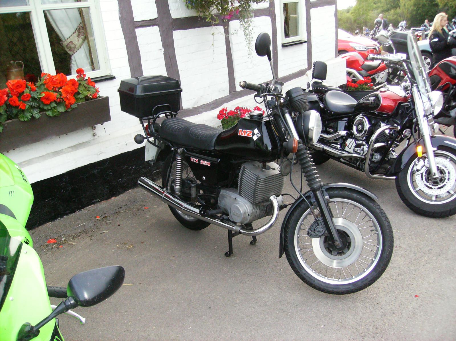

plasticvandan Posted September 9, 2016 Posted September 9, 2016 Just a thought for you vulg.I hate aerosols,and can't/afford spray jobs,so when I needed to paint my bike I brushed on tractor enamel (tough,quickish drying,hard wearing). And cheap (£10 a litre) anyway I thought I had arsed it up,as I misread the recoat time so my really nice first coat became rippled and lumpy on the second,after that I just thought fuck it and slapped 5 thick coats on.3 day s later with nothing to loose I had a go at flatting it back,from 600 to 1200 grit,then t cut,and its come up like glass,and you would never know it was brushed! Just thought as a cheap,durable decent fginisdh that you can do piecemeal, especially as you have unit,it might work for you? here's how the bike turned out worldofceri, Skizzer, mat_the_cat and 1 other 4
vulgalour Posted September 9, 2016 Author Posted September 9, 2016 I've used enamel before, it's nice stuff. I'm using Rustoleum tins to do it piecemeal as it's not too expensive and they're nice to work with, certainly quicker than using enamels. Very smart looking bike too

mat_the_cat Posted September 9, 2016 Posted September 9, 2016 Just a thought for you vulg.I hate aerosols,and can't/afford spray jobs,so when I needed to paint my bike I brushed on tractor enamel (tough,quickish drying,hard wearing). And cheap (£10 a litre) anyway I thought I had arsed it up,as I misread the recoat time so my really nice first coat became rippled and lumpy on the second,after that I just thought fuck it and slapped 5 thick coats on.3 day s later with nothing to loose I had a go at flatting it back,from 600 to 1200 grit,then t cut,and its come up like glass,and you would never know it was brushed! Just thought as a cheap,durable decent fginisdh that you can do piecemeal, especially as you have unit,it might work for you? here's how the bike turned outHPIM3030.JPG Nice MZ, I used to have an ETZ 125!

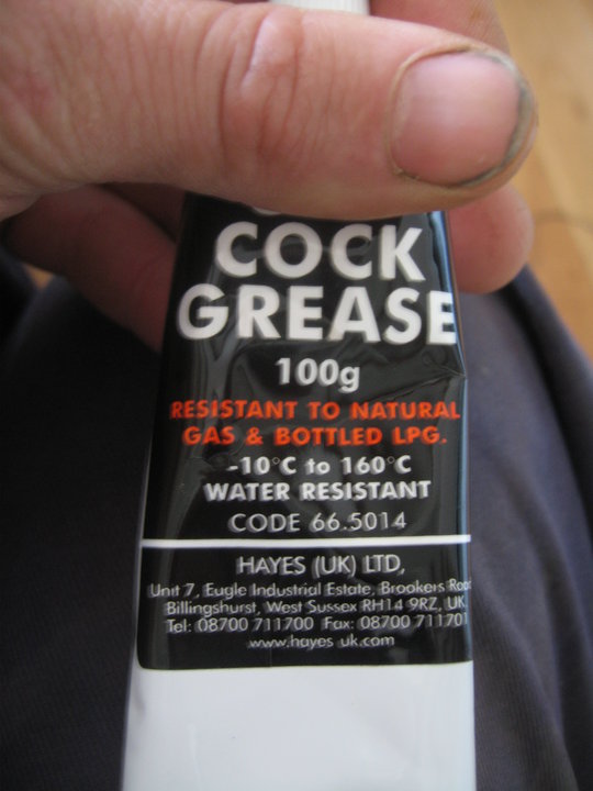

hairymel Posted September 10, 2016 Posted September 10, 2016 Des: It might be. I got linked to https://www.lasaero.com/site/products/article?id=N04HO75SL which seems a more sensible price for the required fitting. also try http://www.skygeek.com/ats-556.html about £31 delivered from us of a. would guess the lasaero will add vat and shipping, though the skygeek one may incur customs
PhilA Posted September 17, 2016 Posted September 17, 2016 also try http://www.skygeek.com/ats-556.html about £31 delivered from us of a. would guess the lasaero will add vat and shipping, though the skygeek one may incur customs Amazon also have them, GBP39.40 including shipping and import duty. The Amazon reviews are interesting, people say it has a copper sealing washer inside that does not seal well. Seeing the postman's face delivering a box with a CN22 form, and the description "High pressure cock" on it would be worth it --Phil anonymous user 1

mat_the_cat Posted September 17, 2016 Posted September 17, 2016 Seeing the postman's face delivering a box with a CN22 form, and the description "High pressure cock" on it would be worth it And if you need lubrication...
