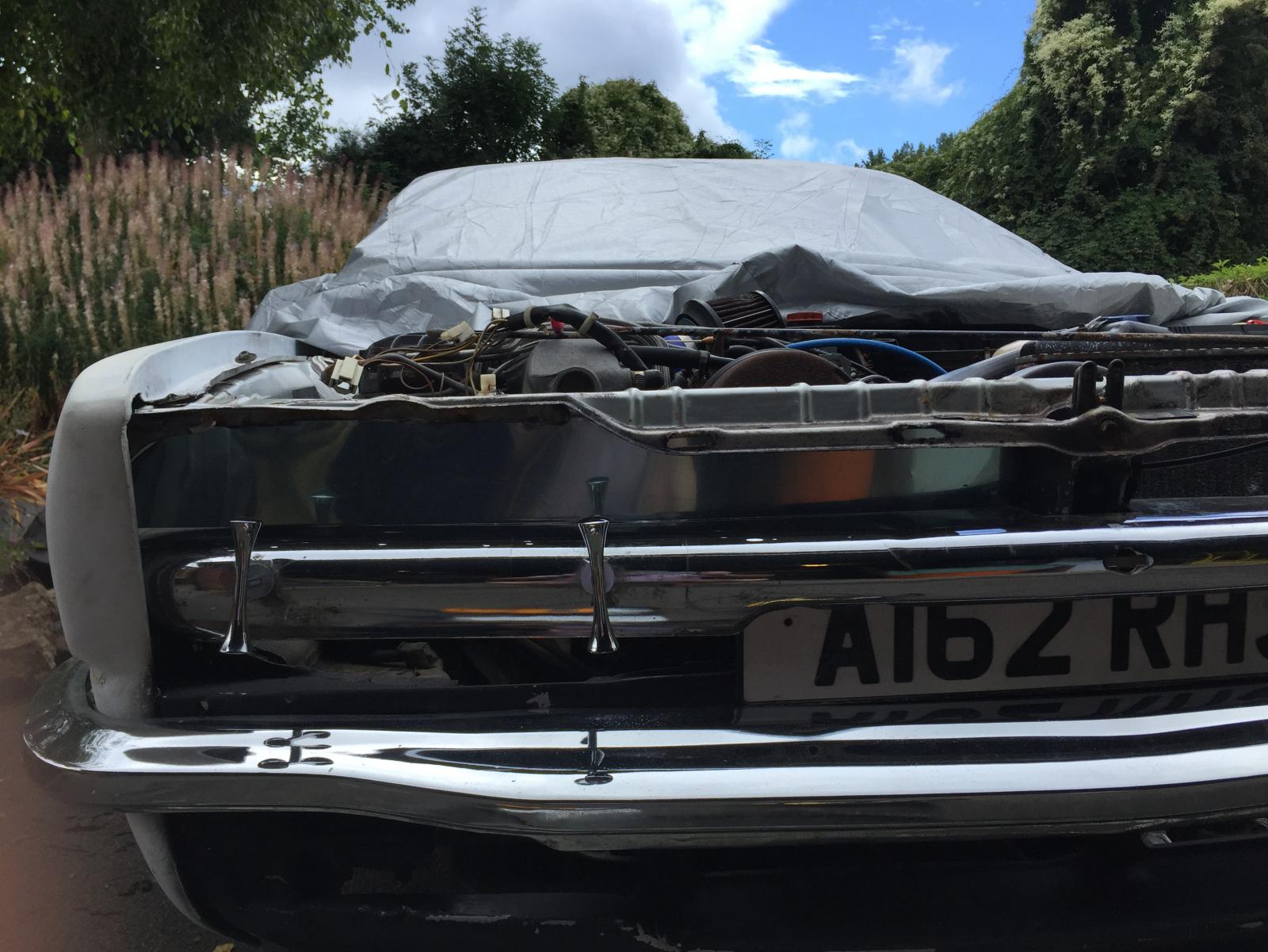

vulgalour Posted September 6, 2016 Author Posted September 6, 2016 Wow I would have bet £50 that a jubilee clip pipe repair would have popped straight off. Now I would be £50 worse off!! I bet it would if I hit a pothole at more than 5mph, so that's why it's temporary. We were surprised it didn't even balloon the pipe. JeeExEll, anonymous user and Banger Kenny 3

The Reverend Bluejeans Posted September 7, 2016 Posted September 7, 2016 And here, for those of you that love accidents looking for a place to happen, is the pipe bodge that shouldn't work but does. You've connected Hydragas pipes with rubber hose and jubilee clips!?

vulgalour Posted September 7, 2016 Author Posted September 7, 2016 Made use of my free time again today. I'd worked out the theory for building the number plate box and today set about making one up in cardboard before transferring that to metal. I checked out inside the tool compartment too since I've got good access for that at the moment and now I finally understand how water was getting in here. The whole compartment runs right to the edges of the car so any holes in the inner or outer wing where the wheels throw up spray allows the water to get straight in. Trouble is, there's no much in the way of drainage so the water can't get back out! Luckily it's in reasonable enough shape to not need me to really do anything in here so I'll leave it alone and treat it as a useless void when everything is welded up. You can make out where the valance has been repaired previously, at least they bothered to cut the rust and/or damage out when they did this. Looking right. Looking left. Before I could actually get the new box made up I wanted to clean the area I was going to be welding it to first. That took rather longer than I'd anticipated so the orange piece on the floor is the flat-pack piece of metal I need to clean, fold and weld into a new number plate box. I ended up chasing out the paint and old filler on the back valance, scrubbing off some underseal and then chased filler and old paint out all the way along the rear wing. I found two little holes under the filler flap that have been filled with fibreglass. This is a common rot spot on Princesses, I'm not entirely sure why. Shan't be fun to weld as it's so close to the filler neck so I'll likely leave this until I drop the tank to do the boot floor. Rediscovered the first patch I welded onto the car three years ago. Still attached just as it was back then, a hasty job that was done deliberately badly to remind me I needed to do it properly. You can see just how much the rot has started to creep up this panel. Again this is common on Princesses, the other side has had several substantial pieces let in badly in this area and ideally wants redoing to look better. I'm undecided about leaving this bit for now, it definitely needs doing but it's not urgent for MoT. There's quite a few dents on the back valance, they look like the sort of dents you get from hitching a trailer up badly so it's likely my car had a tow bar once upon a time, many of them did. I'd been told that to remove underseal the best way is to use a brush dipped in thinners and then a rag to wipe it off. After doing this for the bits of the valance I need to I'm unconvinced it's the best method, it takes a long time and I'm not convinced it's the way anyone really wants to do it. I'd like to get all the old underseal off because I found a large area that had no paint at all underneath it and I don't know what else is being hidden that could really do with some paint putting on. We'll have to see how I'm fixed for spare time tomorrow, I might get that box made up and welded in so that I can crack on with filler work and then paint. If I can keep on at this pace for the rest of the week it should be weatherproof enough to go outdoors again by the end of the week. Banger Kenny, Jim Bergerac, danthecapriman and 2 others 5
