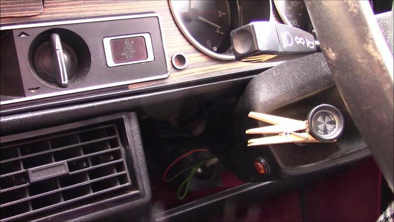

The fog light switch decided to stop working almost entirely. Annoyingly, even though I have a spare of every dashboard switch, a fog light switch isn't one I do have. Gave things a wiggle and almost got reliability out of it, and then the switch stopped working again. Bulb, connectors, and fuse are all good, it's the connection at/in the switch at fault. That's probably going to be an issue at MoT since I believe the car is just new enough that a fog light is legally required. I'm just going to hope it works on MoT day.
Side repeater I couldn't get to work and I can't find my spares, that's a corrosion issue since the inside of the bulb holder refuses to turn into shiny metal and remains steadfastly crusty brown. Fortunately being pre-85 side repeaters aren't legally required so I've unplugged them (which doesn't alter the flash rate of the indicators, probably because of the digital flasher can I've got fitted instead of the old bimetallic type) and taped over the holes which is legal as far as I'm aware. It's a fix, just not a proper fix, when I find the spare side repeaters I know I have I'll refit good ones.
I also don't have a spare speedo cable in stock so I'll have to order a pair so I've got one to fit and one in stock again. TomTom to the rescue in the meantime so I don't accidentally speed.
Should be dismantleable and sorted. Is speeding a terrific risk?

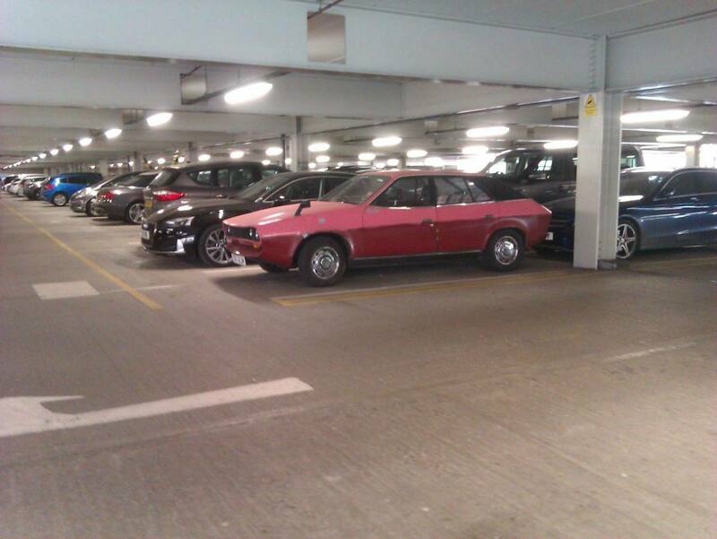

Maidstone multistorey today, not somewhere I have a need to go very often.  Princess looked even weirder than usual in this setting.

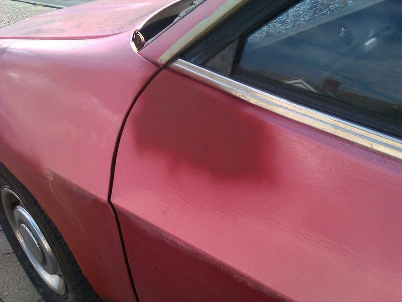

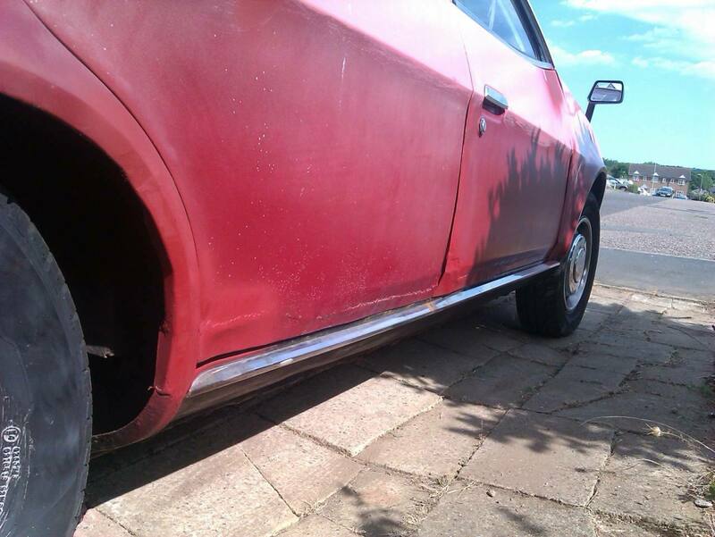

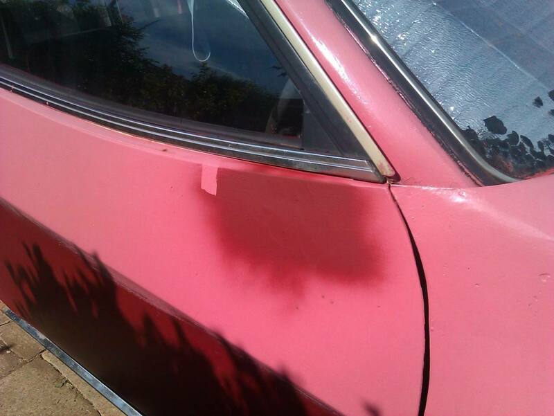

Another Princess update. I had planned to do some more paint and got sidetracked by doing a 'quick bit of welding'. Namely, I wanted to weld up all the trim holes I'm not using, and the mirror holes in the front doors.

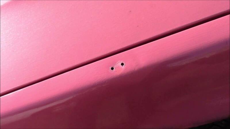

Got rid of the wrong set of holes for the spoiler - by which I mean I kept the holes that should be there for the spoiler, and welded up the holes I'd drilled in the wrong place previously - in the boot lid, and welded up the original badge holes. Bit of bodywork still to go here, it's just flatted back welds and primer, no filler or top coat yet.
Same deal with the front doors, all of the various holes for the various mirrors the car has worn are now welded up, bit of primer, no filler. This went a lot easier than I was expecting, but will need filler before top coat.

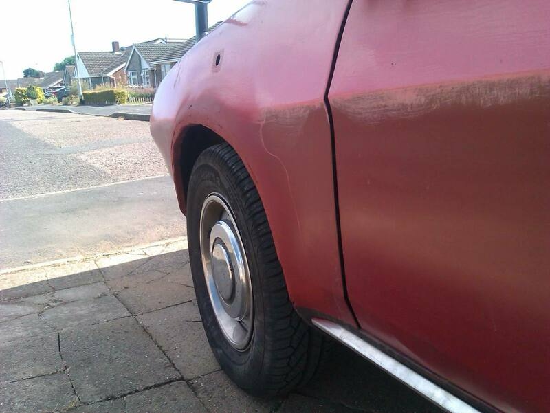

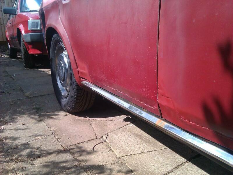

Had another go at the door bottoms on the drivers side to get the shape a bit better. Ideally, they need someone with better skills and tools than me to do them properly, they've never been entirely the right profile even before the rot was chopped out, so it's all guess work really. Still, they'll take filler much better now and perfect panels gaps look weird on BL stuff anyway. Again, no filler, just welded repairs (from ages ago) and paint here because I never actually got chance to do this job properly.
Finally, I poked at the 'little rust hole' in the front passenger wing on the arch lip and ended up rebuilding pretty much the entire lip. Weirdly, the return was in pretty good shape, it was just the vertical face that was shot so I carefully snipped out the vertical face, cut some sections to suit, and welded those in. This wing has already been repaired by me before some years ago and that was on top of repairs it had come to me with even further in its past. Ideally, it could do with a new wing on this side but they're very, very hard to find now. Fortunately I do have a new wing to go on the other side which currently sports a wing made up of at least three different wings and is predictably starting to bubble anew. As with the other jobs, no filler here, just welding and primer.
It's too hot to do any more on this today. I've done my penance, drank enough water to launch a cruise ship, and got sunburn on the only bit of my neck my PPE didn't cover. I've got some repairs to do on the driver's side rear arch, the lower edge of the drivers side sill, and one small hole in the very bottom of the passenger side front wing. Then it should all be finished (for now) on the welding front bar fitting that new wing I need to get in paint before it can go on the car.
When it's a bit cooler I'll tackle the filler work and sanding prep for top coat. I did learn that when I was moving the car about there's a knocking noise coming from a the rear passenger side which I suspect is something brake related. It's too hot to investigate now, but the knocking gets faster when you go faster and stops completely when you press the foot brake, so I'm thinking it's something in the drum that's out of adjustment or broken. I'll investigate when it's a bit cooler outside.

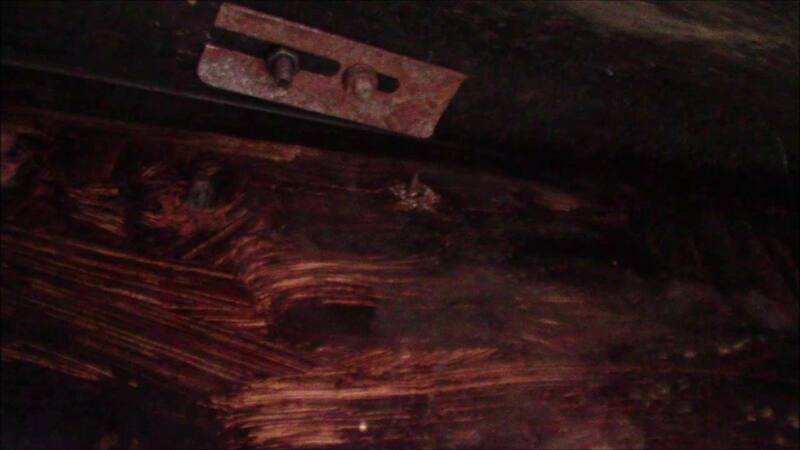

The rubber part of the rear axle/crosstube mounting bracket has basically worn out.  The nut you see there should sit in the middle of that circular hole but the rubber has got tired so it can move about more than it should.  Replacement is necessary.  If you have a spare bracket, or know the part number, or anyone that's selling a good bracket (or even better, a pair), please let me know.  I'm coming up blank on this one and haven't been able to find replacements yet.

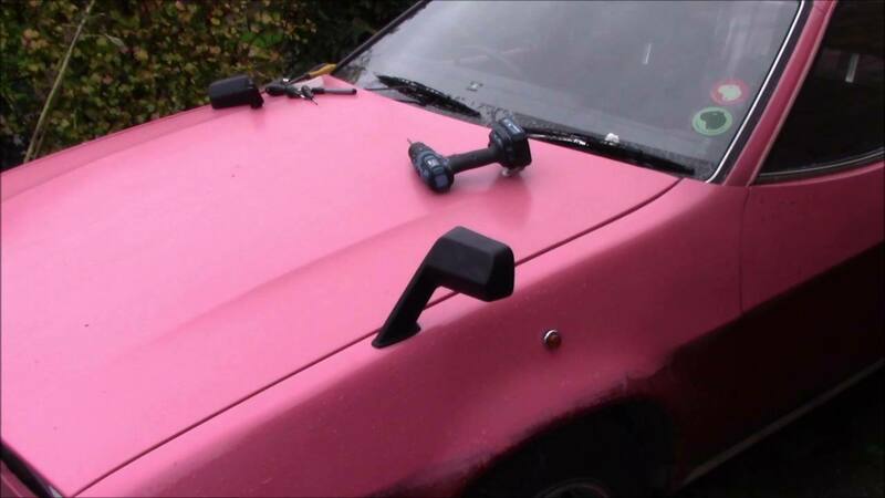

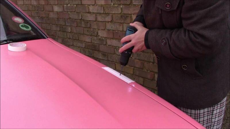

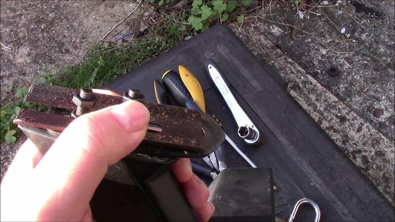

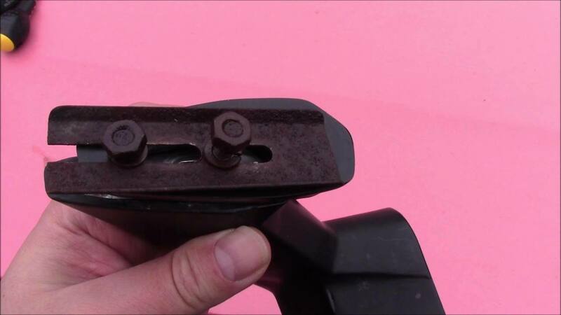

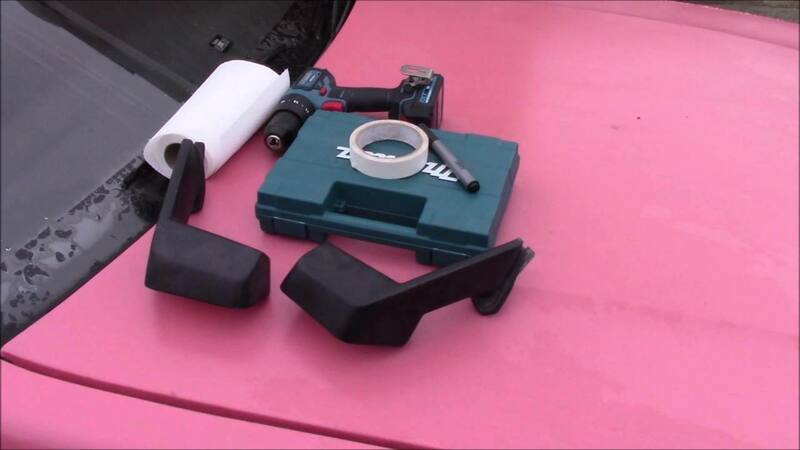

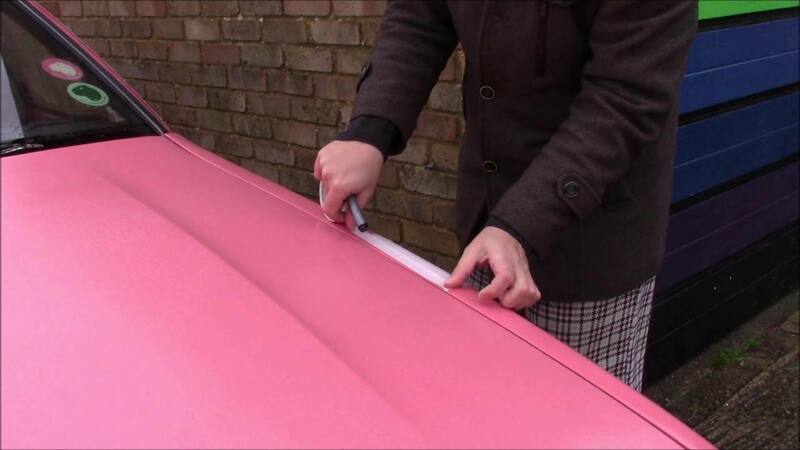

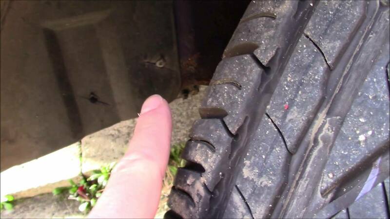

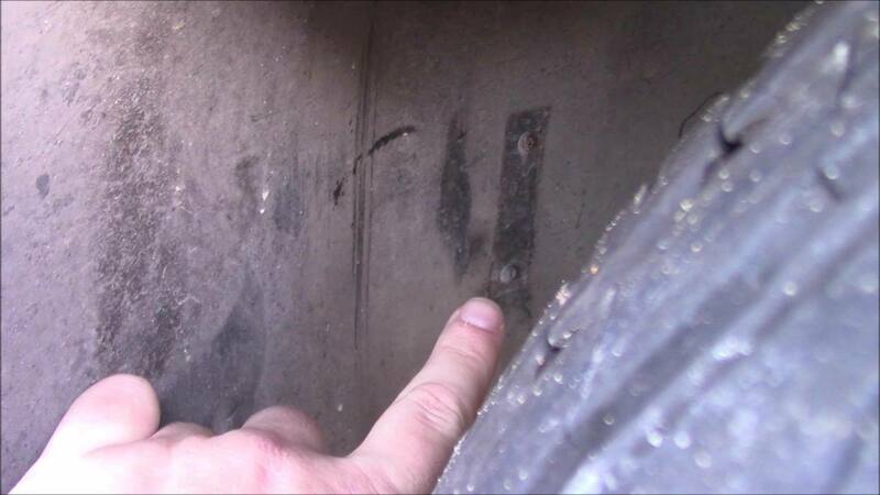

Fitting wing mirrors to the Princess.  I've had various mirrors on this car as long term viewers will know and of all of them, these black aftermarket wing mirrors have been the best of the lot in terms of visibility and aesthetics as a combination.  The Honda Acty mirrors were easily both the best to see with and the ugliest on the car, while the original Tex branded mirrors were perhaps the most well suited cosmetically while also being the most useless mirrors I've ever had on a car.
When I started this job it was pretty cold and wet, there's never really good weather to do this sort of thing in so I just got on with it.

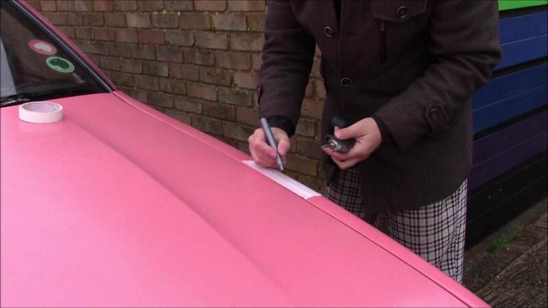

Gather my tools up which comprised a cordless drill, some masking tape, a pen, and some sockets for the mirror's fixings.
On the passenger side wing there were still the nubbins from where I'd ground back but not filled the welded up holes from when the wing mirrors were previously on the car.  The driver's side didn't have this guide to help me since that wing was replaced with a Frankenstein's monster of a thing made up of several wings.  Masking tape deployed to give me something to write on and to prevent the drill bit from skipping since I still don't have a centre punch for marking drill holes.
Start drilling and think the drill bit is blunt, check the battery and find out that actually it's got nearly no charge in it.  Recharge the battery and try again.
Then inspect the mirrors and find a couple of the nuts are rust-welded onto the bolt threads so spend some time cutting through the bolt threads after trying every other method, and then install new fixings.
Dry fit the mirror into the wing and decide I'm happy to once again have these back on the car.  I should never have second-guessed myself with these, they fit in with what I'm doing really well and I like using them, so I should have more faith in my own vision.

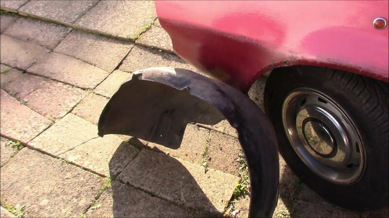

Next job is to remove the arch liners. These things are a pain.  If you leave them in they do protect the nose end of the wing from stuff building up, but they do nothing to protect the other end of the wing.  They also destroy the arch lip whenever you try and remove them.  They're held in with several screws.
Once the liner has been fought out, access to put the nuts onto the floating captive bolts in the mirrors is possible.  These mirrors aren't sprung loaded and you adjust them by pushing on the glass which is mounted on a ball socket inside the mirror housing.  Usefully, they don't stick out further than the car's widest point which you'd think would be a problem for seeing behind you, but with them so far down the wing it's really not an issue.  They're also pretty large for wing mirrors, so the field of vision is surprisingly good in them.
Looking up inside the wing you can see the spreader plate that's used to keep the mirrors from jiggling - they really don't vibrate at all, surprisingly - and I gave all this a coat of paint to protect it from rusting, I just didn't record that bit.

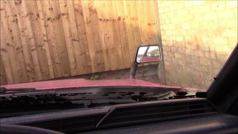

It's not really that easy to show what it's like to use them when you're in the car, the camera isn't really looking at the mirrors the same way you do when you're driving, but they really are great.  The big advantage is I can make a quick glance at either mirror and see what's going on behind me without really taking my eyes off the road in front, unless I'm doing over-the-shoulder checks of course because it always pays to be vigilant.  The one thing these mirrors do best of all out of all the mirrors I've had on this car is almost totally elimate the C pillar blind spot which is massive due to the 70s styling.
With both mirrors fitted it felt a bit more like my car again.  These definitely aren't to everyone's taste, and that's okay, I'm not building this car for anyone but me so I'm the only person I need to satisfy with it.

This was a know problem with these. I worked on them when they were new and this was something we did regularly under warrantee.

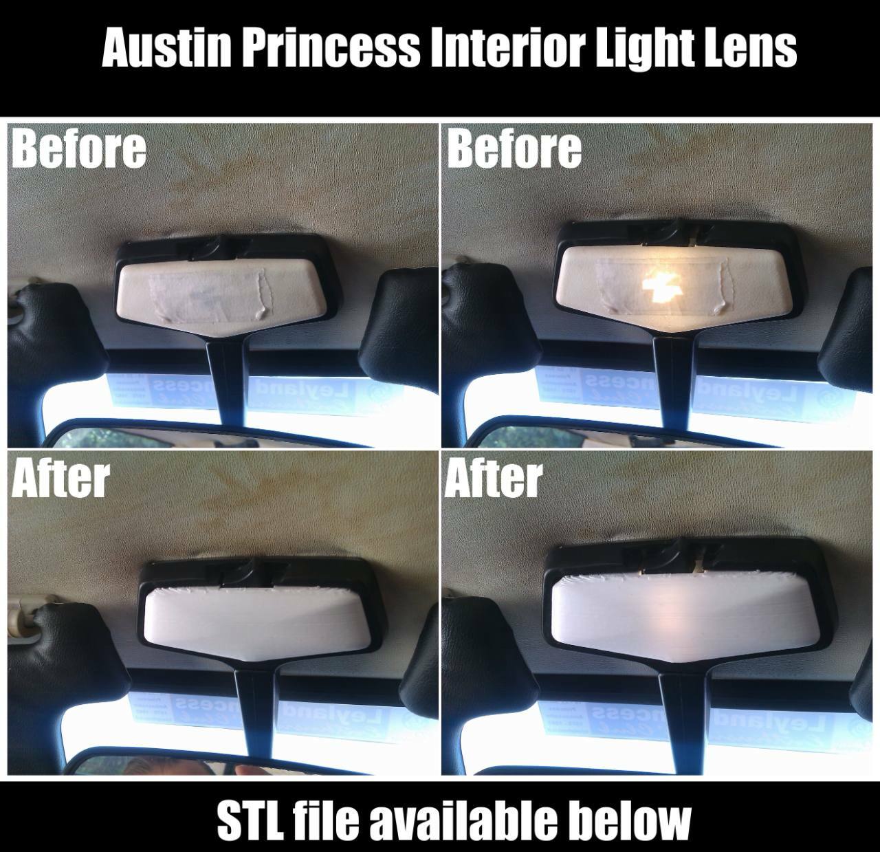

https://www.printables.com/model/258068-austin-princess-interior-light-cover
The before is my literally crumbling original lens.  The after is a raw print, no sanding or finishing.  This is a direct replacement part and, because it's a thing you can 3d print to demand, you can make them any colour you can get the materials you use in.  As far as I'm aware, this is the only replacement part out there and this is a part that's been unavailable for quite a long time.  Best of all, the download is FREE, so as long as you have access to a 3D printer this part shouldn't cost you a great deal to create.
