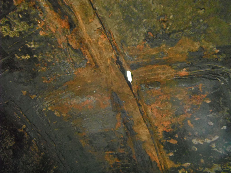

SiC Posted December 9, 2018 Posted December 9, 2018 Is there a bit of surface rust to the right of the lower circle?
vulgalour Posted December 9, 2018 Author Posted December 9, 2018 There is, I gave it a stabby-scrape with the screwdriver and it's very minor surface corrosion. Nothing is crunchy, thankfully, it seems to be fairly localised corrosion so shouldn't be too difficult to deal with. With the rear wheel removed I should have lots of space to do the repair somewhat comfortably. Of course, I won't know how good or bad it really is until I get in there with power tools and cleaners, so here's hoping it's not an iceberg tip.
vulgalour Posted December 10, 2018 Author Posted December 10, 2018 Today I got the Princess over to the unit so I could fix the inner arch holes I uncovered. I also removed the cold air intake pipe to the air filter box and that improved the cold running considerably. It took me longer to clean off the underseal than it did to do the actual repair. Happily, the damage wasn't much worse than what was visible and was an easy fix as a result. With the rear seat removed it was easier to see just how the rust had occured. There's a seam hidden under some goop under the rear seat and this had blown. The inner arch side of it was rotten, the bodyshell side was still solid enough to weld to, so the repair wasn't too bad. I also found a small hole on the seam of the inner arch tub while cleaning off the underseal. It's a little awkward to repair since I can't get many tools in at it and will require a patch about the size of a pound coin. After a little bit of time I got some new steel let in where required and seam welded. Since I'm still running the experiment, I'm avoiding taking the car off the road and doing these repairs piecemeal. The bulk of the time today was really stripping everything back to see what I had to repair. Now that I've done that, getting everything cleaned back and freshly painted and undersealed will be much easier and something I shall be making time to do over the course of this week. RayMK, Scruffy Bodger, LightBulbFun and 4 others 7
