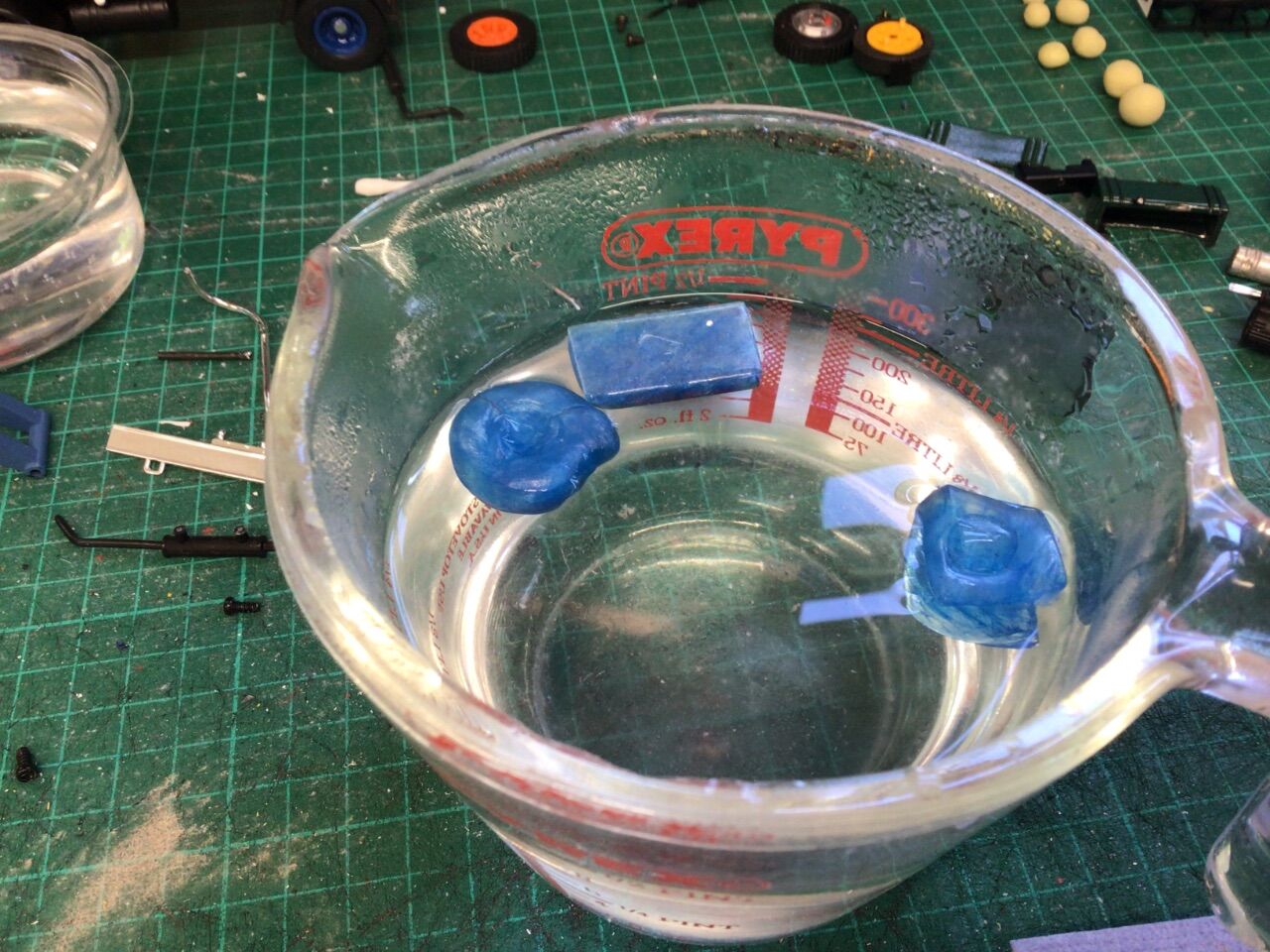

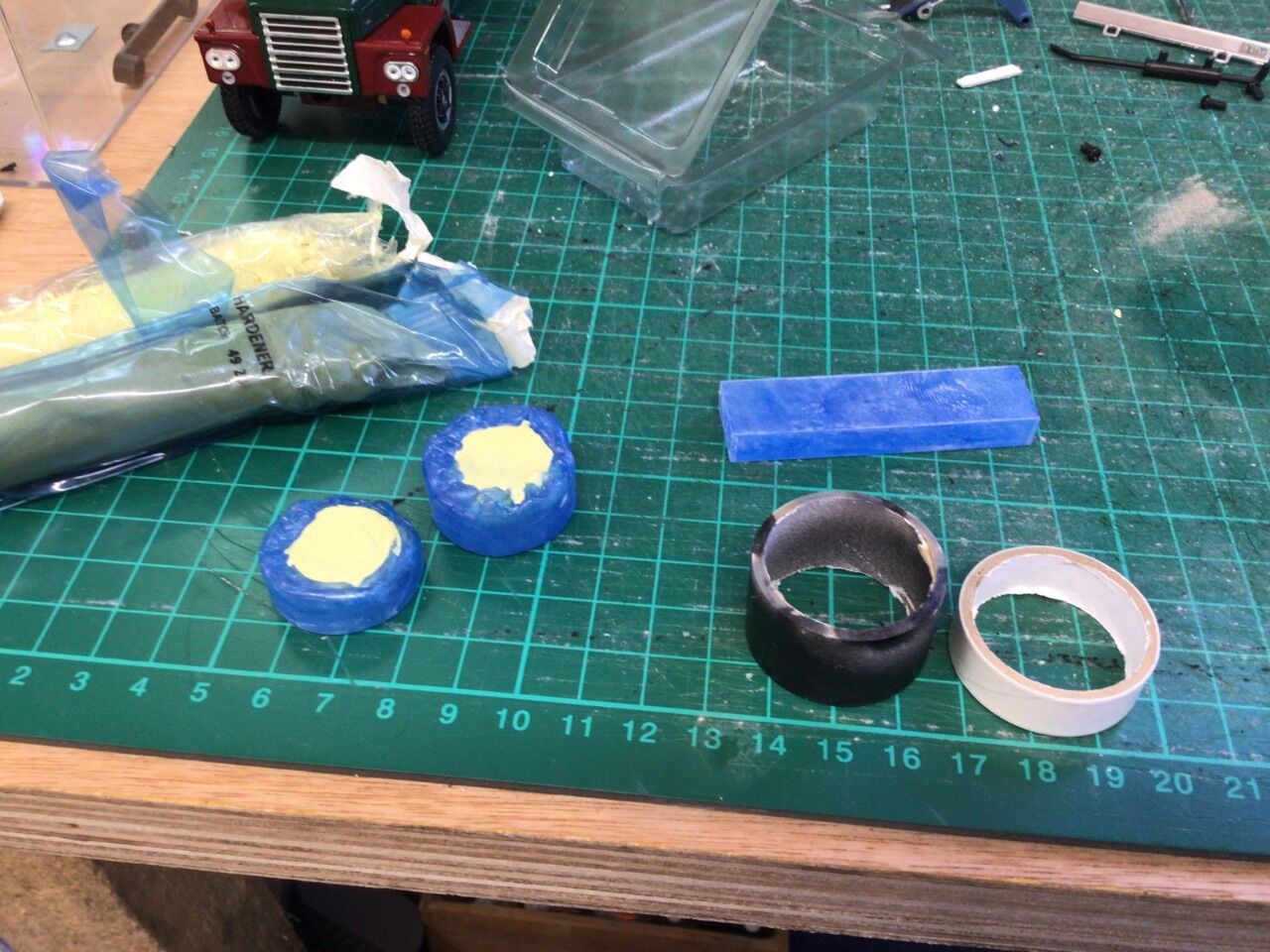

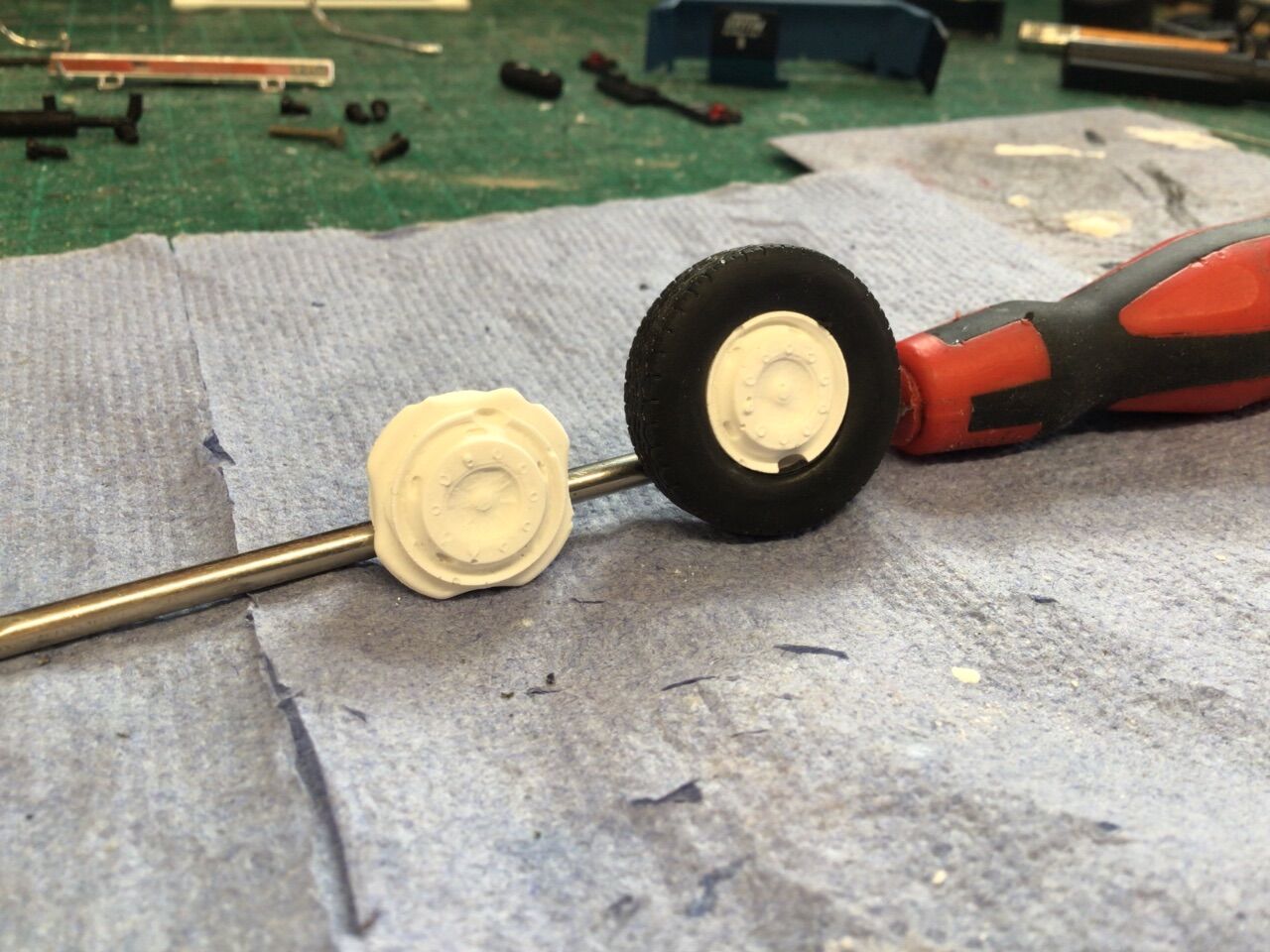

Casting wheels experiments continue, if anyone’s interested!
Today I’m trying the GreenStuffWorld Blue stuff mould making material.
A bit different to the silicone stuff. It comes as a slightly transparent blue bar which you dunk into hot water for 3 mins to soften.
You can cut it into chunks and join the bars together to form a lump as big as you need it. Cutting it down helps soften it quicker.
Once it’s soft enough it becomes very squishy and pliable. I found it best to find or make something to hold it in that’s slightly bigger than the part you want to cast. I’ve seen people use Lego bricks and flat sections to do this which lets you build it to a shape too. I used two old masking tape cardboard centre rolls. It’s just to stop the blue stuff squeezing out away from the thing your moulding as you push it in. Also don’t push it so hard it goes right through the blue stuff!
Ive made two pairs of different wheels just to experiment a bit. The first two I’ve filled with Milliput epoxy putty, mixed up then gently squashed into the new moulds a bit at a time to try to avoid air pockets.
The second pair I’ve filled with very thin resin, poured in slowly then gently poked and patted with a blunt pencil to try to dislodge any air bubbles.
I’ve also filled yesterday’s silicone moulds with thin resin to both use up the excess resin and compare how they come out.
It might take overnight for the resin to harden as it is very thin. Almost like the consistency of milk!
It’s easy to use although I would say ‘hot water’ isn’t good enough in my (limited) experience. It needs to be boiling water straight out the kettle to get the blue stuff soft enough to squash and pick up the detail of the master. The silicone picks up the detail much easier in this respect.
Im pretty sure this basic mould making will work to do what I want, I think it’s just a bit of playing around and finding what works best.

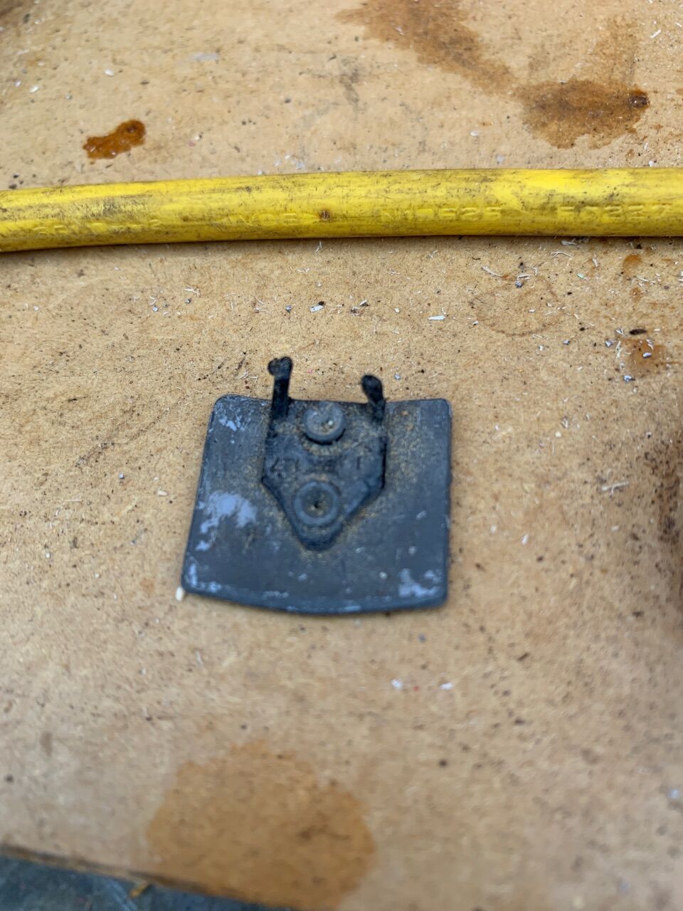

Has anyone got a donor bonnet for this? Was it plastic?
I have! Let me look for it mind!
Don’t mind all the crap/filth in the background it’s on my work bench. Yours for postage! Hinge a bit mangled but I’d just glue it in place.

40 minutes ago, morrisoxide said:
Thanks for the info.
The Milliput is something I haven't though of and the cardboard centre rolls is a very good idea.
Milliput is actually very good for making castings. It sets rock hard and can still be sanded, drilled and painted. I have pulled one of the wheels out of the mould already and it’s worked well. The Milliput seems to cope with small details really well. Pics tomorrow once I’ve emptied all the moulds, but I actually think the Milliput is better than the resin.
Another thing that can work well for forming the mould inside of is the plastic caps from deodorant cans or even small paint cans.

Opened up the moulds this morning.
White is the resin. Beige is Milliput.
The resin seems to work much better with the silicone moulds. The resin taken out of the blue stuff moulds was very poor.  I think it was a combination of thin resin mix and it crumbled when removed from the much harder blue stuff moulds.
The Milliput was very good though. The left hand Milliput wasn’t pushed into the mould as hard and has come out rock hard but with quite poor detail. The right hand Milliput mould though was pushed into quite tightly in small pieces then fully filled once the details were all covered. This one is by far the best imho.
Here it is with a tyre fitted next to an original.
It’s not as good as the original but it’s not that far off. Obviously the holes through the wheel aren’t there but they could easily be drilled out or just a bit of black paint in.
I had some leftover resin so I cast a new grill for that Triang Jumbo FFK truck. I made a mould from the original grill before refitting it.
Needs a bit of tidying around the edges but it’s not half bad.
