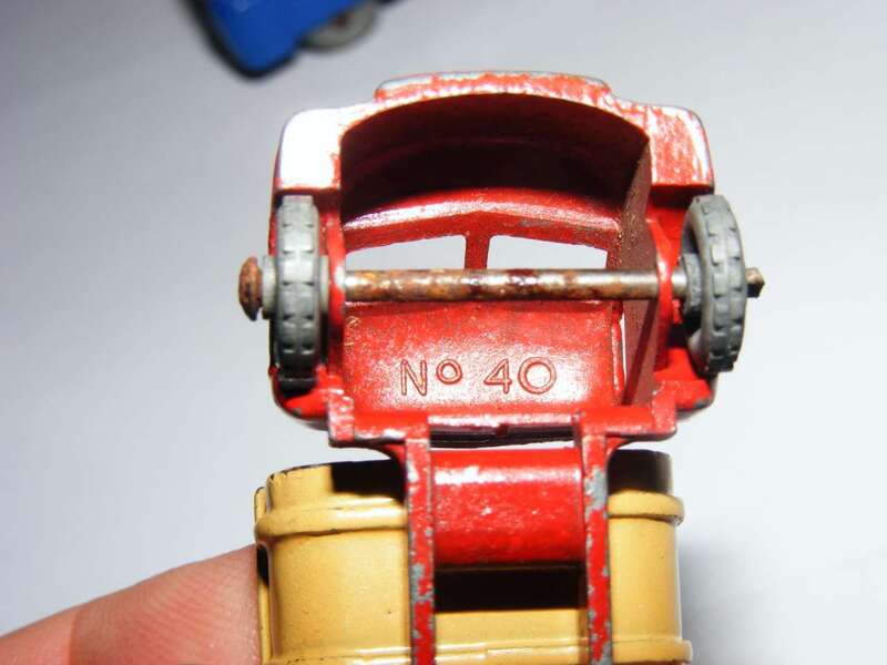

Next is the Bedford tipper, No. 40. The joined the Matchbox range in 1957.
Again in good condition for something so old.
Number cast into the underside of roof

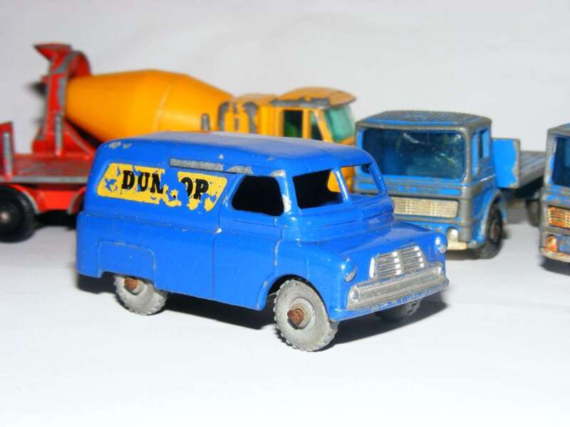

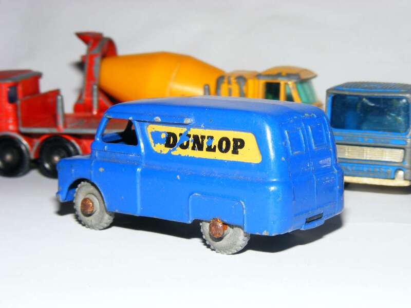

Next is the Dunlop Van No. 25. Looking at the size you would have thought this was introduced a bit later than the previous two, but no, it joined the range also in 1956.
Shame the decals are so bad and the axles are rusty.
This was one of the first to have a separate base casting.

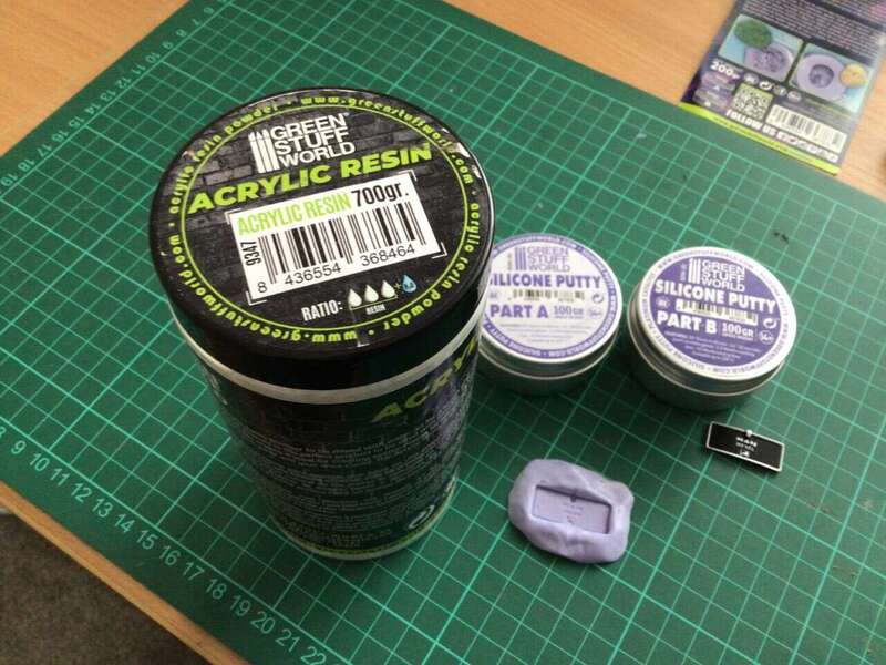

Experiment’s today, possibly of interest to @bunglebus
I was looking for something else and happened to find that, and the IXO MAN truck I needed to steal the grill off to make a mould from.
Stripped it down, carefully, to liberate the grill.
It’s got quite intricate little details and the badges so I opted to get the silicone putty to make the mould from. You can get a much harder material that’s like a block of blue plastic which you immerse in hot water to make it soft, then press around whatever your copying and let it cool & harden. But I’m not sure how well that would cope with fine detail like the grill.
The silicone putty comes in two parts which you simply pull a lump out equal sizes of each then knead and mix between your fingers until it’s a consistent even colour throughout with no ‘marbling’ of each colour.
Once it’s mixed you get a few minutes of working time with it so you really need everything to hand ready to go.
I’ve smeared my blob onto  flat surface just to keep the back of the mould against something I can push against to get the details well into the silicone. Obviously you just need to not press it in so hard it goes right through… yes, I did the first attempt! It’s extremely soft stuff.
Then you need to let it set for 10 minutes without disturbing it.
Which is the point I’m at now, so after lunch I’ll see how it’s worked…

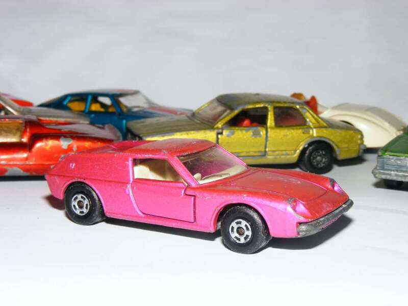

Next up are the Superfast cars.
First is a cleanish wide wheel Europa.
Looks like it has been down the road on its roof as it is scratched quite badly.
Porsche 910 has experimental 4-wheel steering system.
Very nice SM
Tampo prints are good.
Tow hook present and correct.
Poor Cougar Villager has surface corrosion on grille
and no rear door.
Red Golf is clean.
Missing the surf boards
The painted base is good.

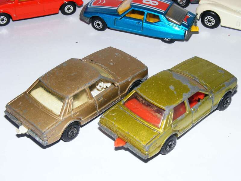

A pair of Mk IV Cortinas that have had a hard life on the Mini-Cab circuit.
The lime green one has a slight squished roof.
Gold shell is OK.
Amazingly both still have their tow hooks.

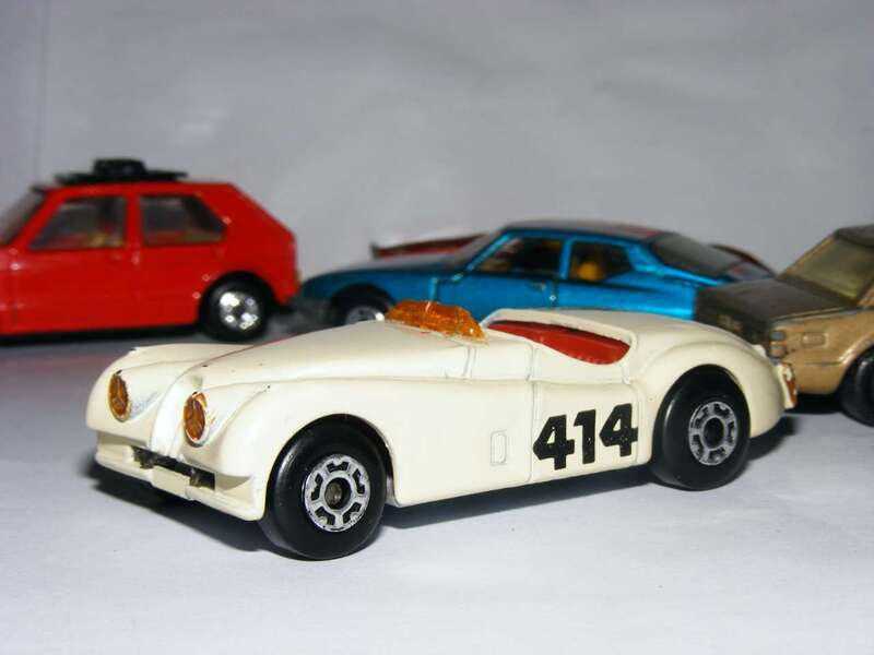

Finally we have a late issue Jag XK120.
Missing grille and broken screen

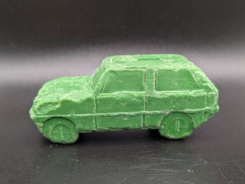

Well it’s set.
Feels a bit like normal silicone really… funnily enough! Soft/squashy but not wet.
And this is exactly why I chose to use the silicone putty! Look at that detail!!
I think there’s a couple of faint air bubble imprints but they only show up close so I think one the casting gets cleaned up and painted you won’t see them. Something to be aware of though.
And this is what I’ll try making the casting out of.
Seemingly you just mix with water and pour it in. I’ve never used this either so all this is a learning experience for me.
I do know you can also use filler like car body resin type fillers, special model products like Milliput or Tamiya model paste etc etc to make your casting from but they can be a bit brittle. I did wonder about using chemical metal epoxy - the runny two part stuff not the clay like stuff. Maybe I’ll try that later?
The mould certainly seems good though and I’m sure you can reuse it indefinitely as the silicone is flexible enough to just pop out the casting once it’s dry.
In theory you could make multiple moulds from a bigger lump of the silicone if you have multiple items to cast from but I’ve only got one of these grills.

Sorry about the multiple posts, I’m just posting up as I’m going during the curing time.
Resin is mixed 3 parts resin - 1 part water.
It’s very thin stuff once mixed but that makes it perfect for pouring and also ideal to flow into fine detail. Tub says it’s dry in 30 minutes, fully hardened after 24 hrs so it’s just a waiting game now.
After it’s fully hardened I’ll need to thin the casting with some sand paper as the original part is quite thin and has a very slight curve, but it says it’s fully sandable on the tub.
The resin powder actually looks like something else, but I can’t quite put my finger on what. Flour? No, not flour…😄

Great success!
Resin has cured enough to be popped out of the mould.
It still needs to cure fully for 24 hours yet before working it with sandpaper etc but it’s pretty strong already. It will definitely need some sanding to shape to get rid of the excess around the edge and thinning down but for a first try it’s pretty good!
Here’s a cruel closeup.
Theres a tiny bit of the lettering on ‘diesel’ that’s missing and a few marks, presumably from air bubbles getting trapped, but I’m pretty sure that could be reduced by thinning the resin a bit more and pouring it in slower, maybe giving the mould a bit of a gentle shake to free the bubbles as I do it.
But, I’d quite happily use that grill!
And the good thing is, the mould is in pristine condition ready to be used over and over.
I might have another go with it using thinner resin and maybe some different material too just to see how it works more than anything.
Im impressed with it though.

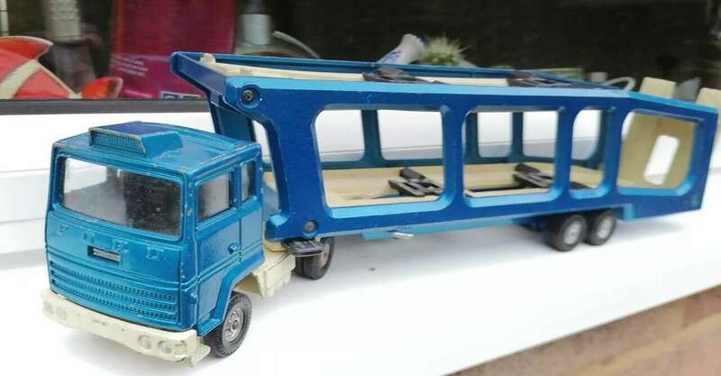

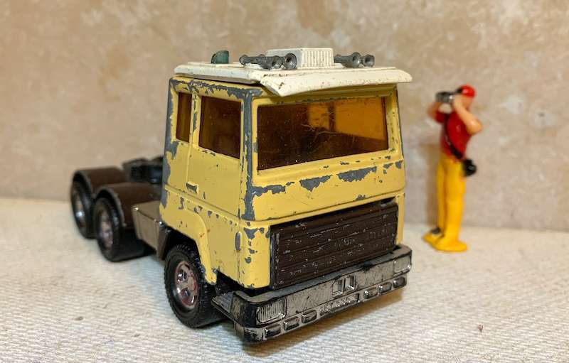

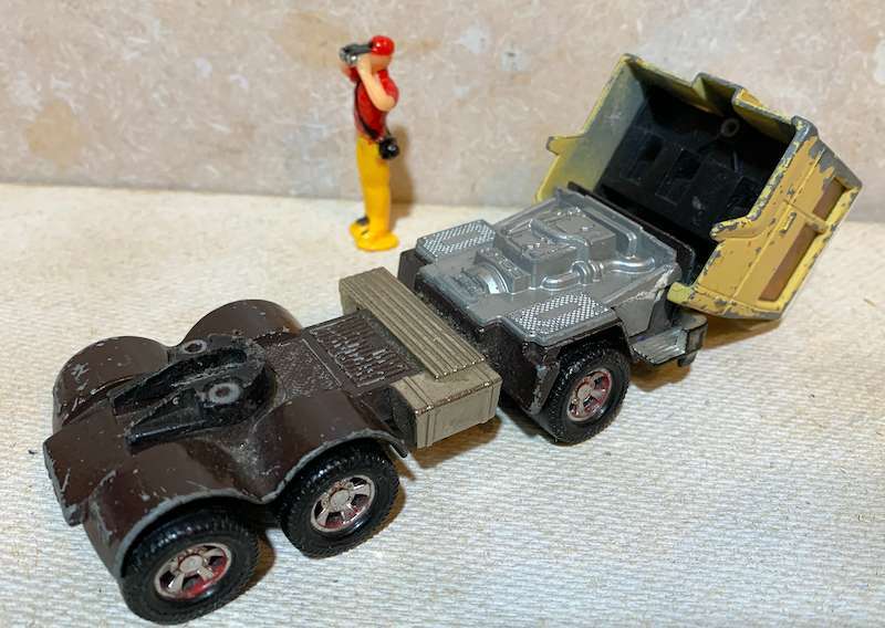

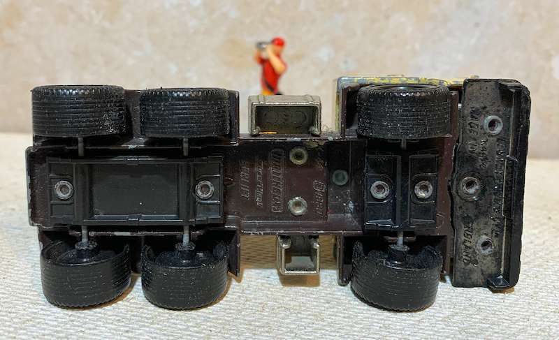

Did anyone get this K-44 Bridge Transporter set?  I bet it wasn't cheap as it's quite extensive.   That was the sole outing for an articulated fifth-wheel coupling use of that cab casting? ....and as a Berliet GR, not the Ford that made use of the cab.  Only found this out recently.
This is the Berliet cab variation on the cab.  Grille and bumper are plastic
Grille has V8 and TURBO badges in same placing as this BOOBY BROCHURE shot
Ford effort has cast grille and bumper, not plastic.  Fixed long chassis.  Same plastic roof piece with HORNS
Engine casting same as the Ford, as is main cab hinged casting
With the twin-axle shorter chassis clearly marked Berliet.  Also dated 1980 ....the same year Renault R rebranding of the Berliets were launched after the take-over
So we could* possibly* have seen a Matchbox SuperKings Ford Transcontinental Car Transporter to rival the Corgi Ford Transcontinental Transporter.  Not sure why they did not.  WHICH MEANS with some grille swappage and a grinding-off of the word Berliet you could have one...
Or call the whole thing off and enjoy the Corgi effort even more instead
