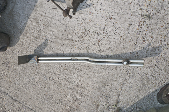

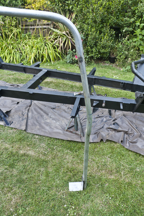

We found the lack of roof stiffening rather worrying so decided to fabricate a bonded in roll-bar hidden inside the B-posts - this is made using the same method and materials as reliant used in the Scimitar.

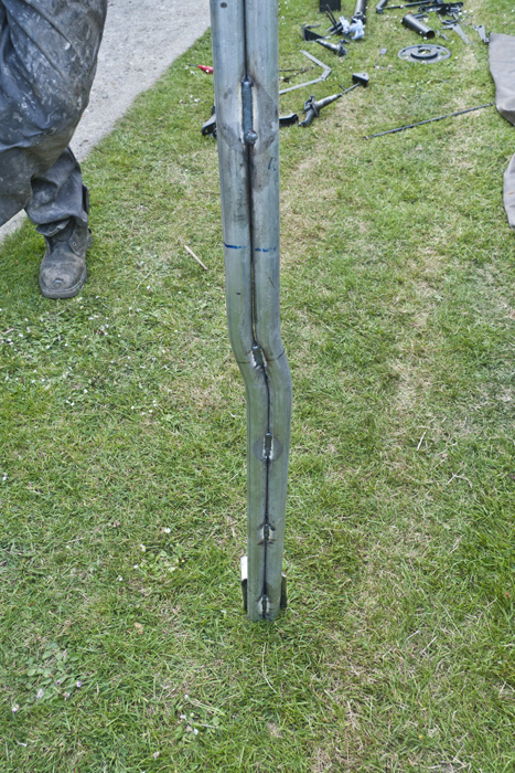

Bending 1" Tube for Rollbar
Roof section of rollbar being test fitted
These were then clamped and tacked together with the mig.
Drivers side lower rollbar section after bending
Preparing to pot-weld the joining pegs into the roof section, The pegs are made from 8" lengths of thick-wall pipe.
The fully assembled rollbar section prior to space welding the tubes together
Passenger side view - the offset is to give clearance around the recessed section of the B post where the doorlock mounts.
Front on view.
Test fitting prior to adding seatbelt mount Points.

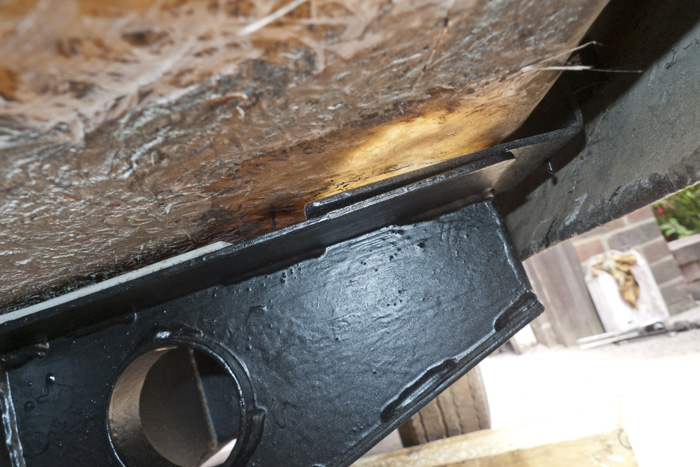

We've also made a start on cutting out some of the corroded sections of chassis and fitting the new outriggers:
New section let into rear chassis section - whilst this section was cut out i took the opportunity to weld up a crack alongside the spring mounting bush.
Patched up the rear crossbrace.
new rear outrigger tacked in place
rear outrigger - note wider top section which will take the lower mounting for the rollbar and also the seatbelt reels.
front outrigger also tacked in situ.

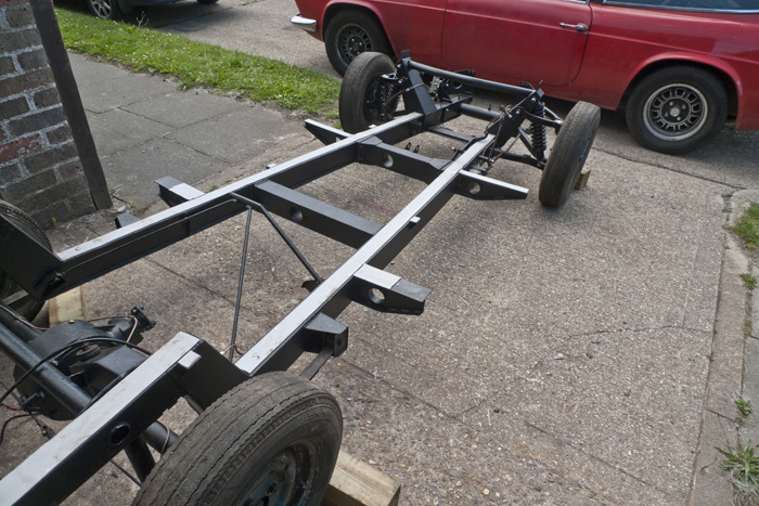

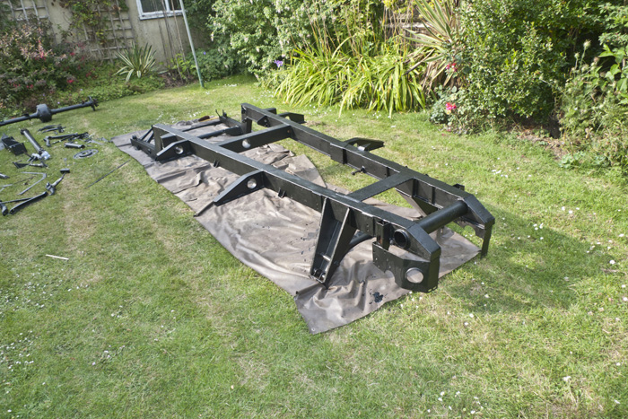

Spent today continuing with the chassis repairs, which are now done! we then painted the chassis and suspension components which had been cleaned up over the last few days.

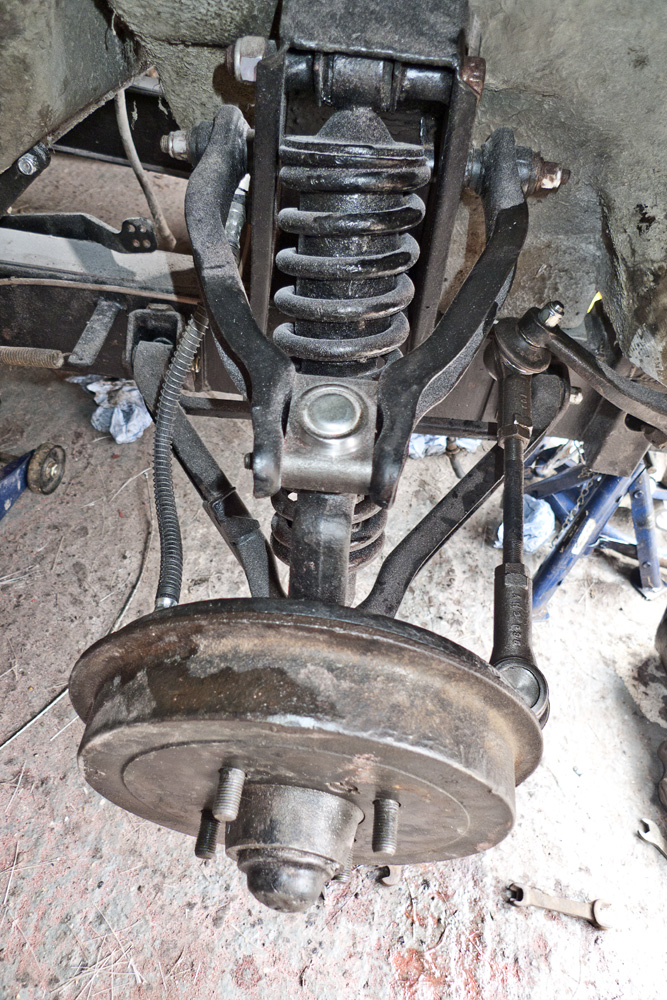

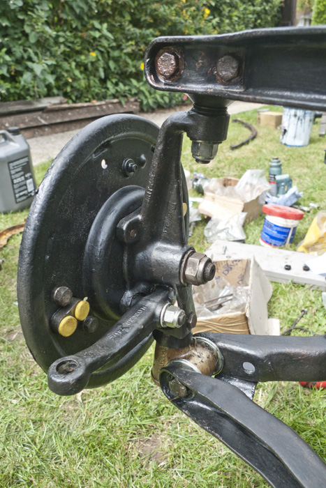

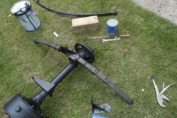

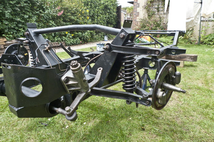

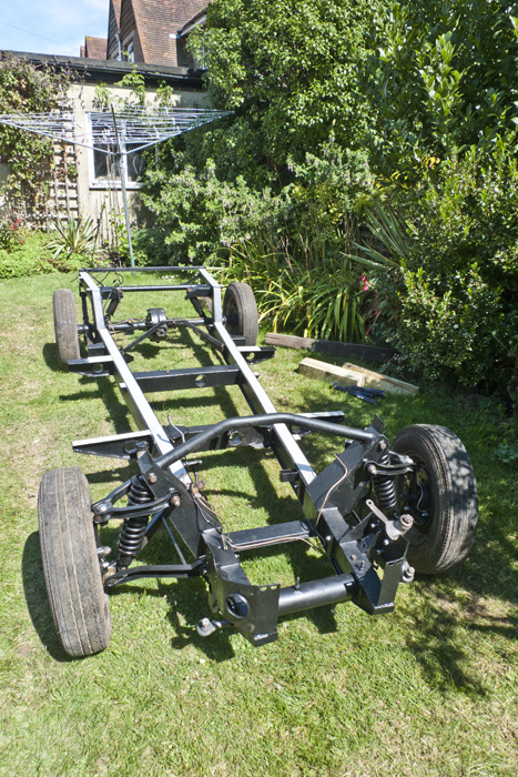

These photos show some of the recent progress building up the chassis suspension and braking components.
Bare chassis (upside down :P)
Finished lower roll bar section - note mount point for seatbelt.
Rollbar sections test assembled
Detail view of "B" post section of rollbar
Leaf springs going back on

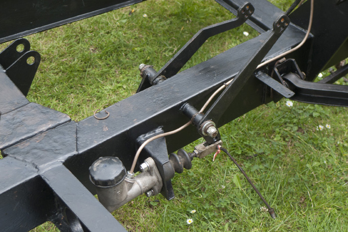

New master cylinder

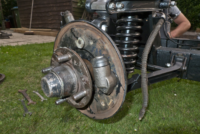

new wheel cylinders, ball joints and trunnion bushes
General overview of front suspension going back together

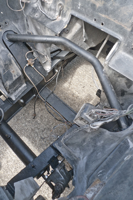

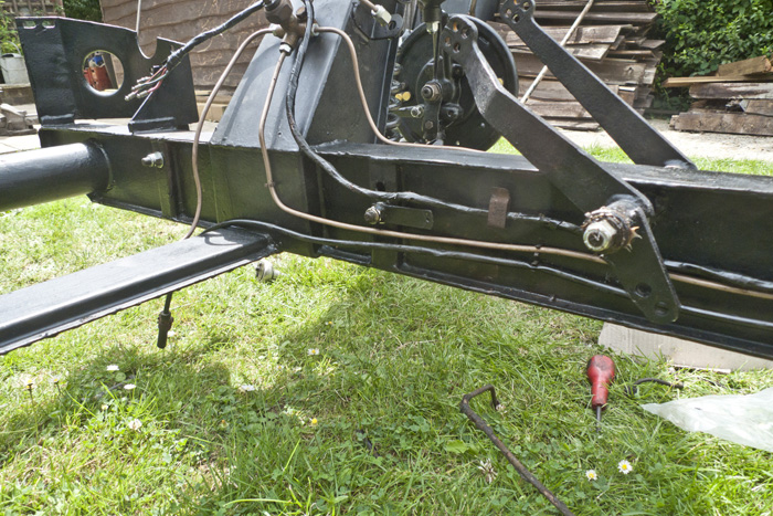

new brake pipes and wiring loom going back on
new rear cylinders
front hubs refitted
starting to look like part of a car again!
Rear view

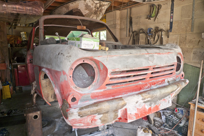

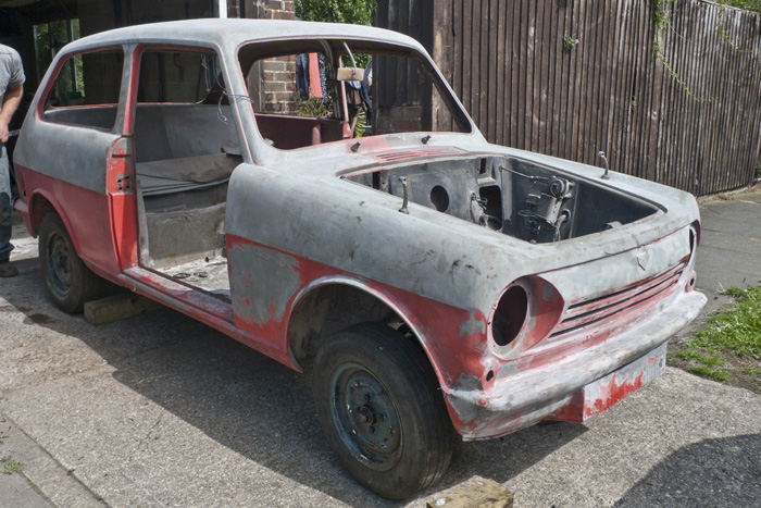

Some photos showing progress on the bodyshell:

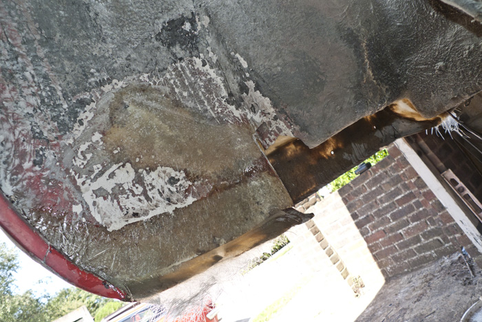

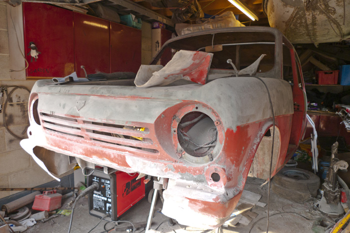

Whilst picking at a small crack a large section of the front skirt/bumper moulding dropped off!. poorly repaired accident damage which was held together with body filler!

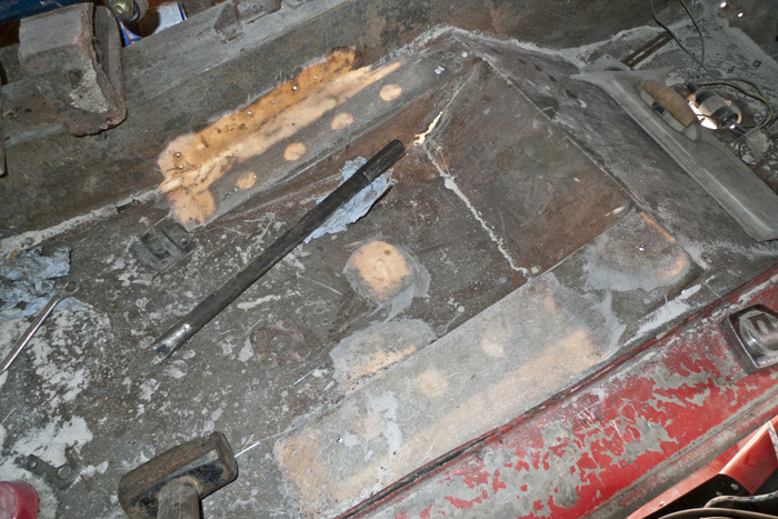

Photo showing floor repairs
replacement stiffening plates under the seats ready to be glassed in.
front end jigsaw being reassembled
small repairs were needed to both wheel arches where previous accident damage had caused delamination

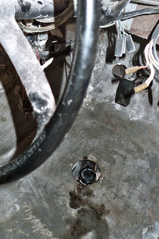

passenger side footwell - had a hole, the old front chassis outrigger on this side was also badly bent so someone must have driven over something f**kin hard!
view behind front bumper showing various repairs

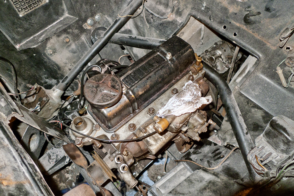

rear of engine bay
forward view of engine bay

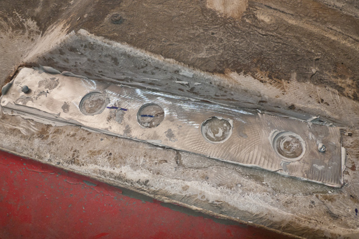

Boot strap supports being glassed in:
Rollbar padded out to remove the dent in the roof and prepped for fibreglass.
Rollbar getting first fibreglass layer

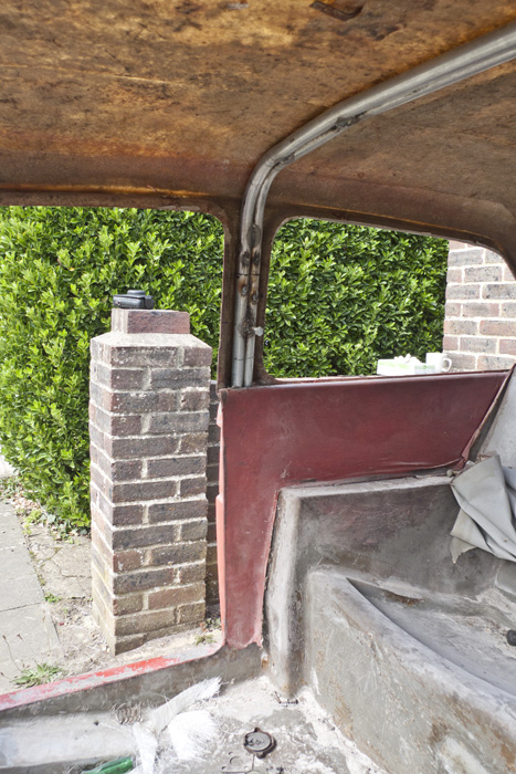

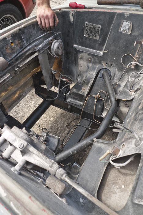

Continuing the replacement of the chassis steelwork we cut out the corroded metal in A pillars. To do this we removed the inner roof moulding.
Extra view, this moulding will be replaced once we have glassed in new steel supports.
Channel that contained steelwork
Corroded section of steel support after removal
Drivers side Steelwork position shown on the outside of the car.
Passenger side being removed
Outside comparison, note hole blown in the wing by the steel expanding.
The rotten steel will be replaced soon and hopefully we can start looking at the engine and interior!

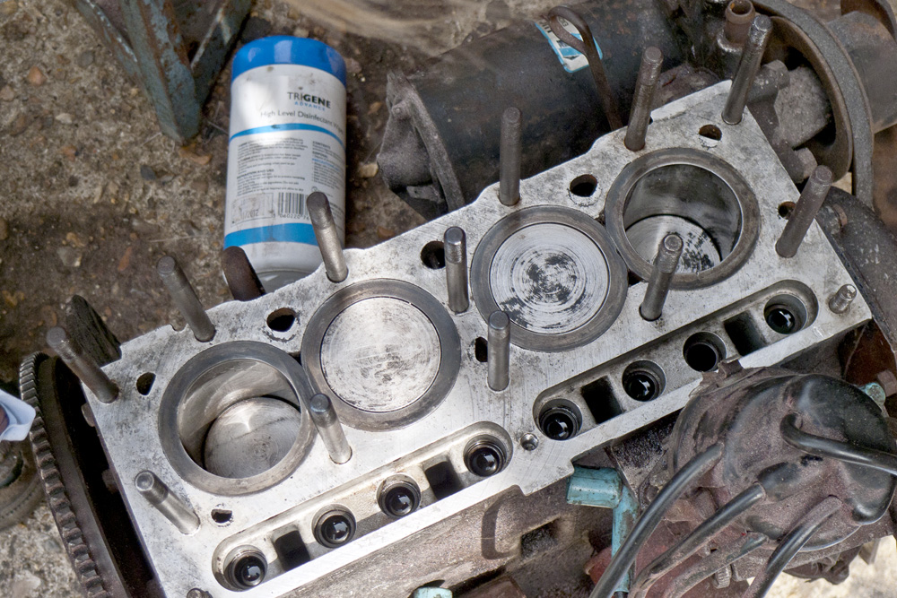

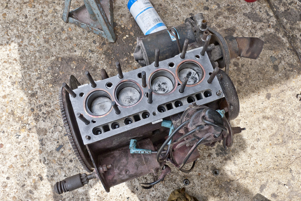

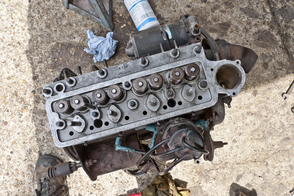

Our first attempt to run the best of our engines resulted in a blowing headgasket so we sent the head off for a skim and it came back nice and smooth:
Block awaiting a skimmed head (pedantic Relaint purists will be pleased to know this is a 598cc engine! as per original spec)
Now with added gasket!
Head goes on:

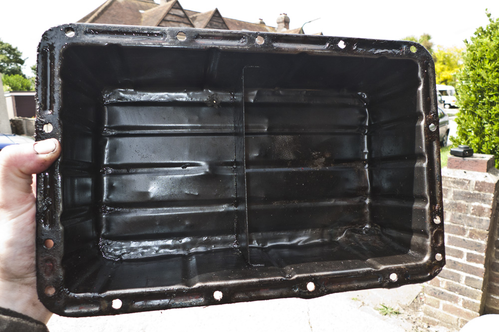

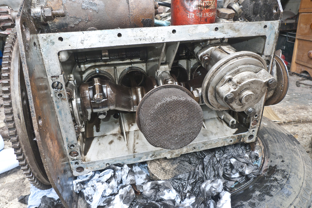

With the head fitted we decided to inspect the bottom end and discovered a holed sump!
Fortunately the bottom end looked pretty good.

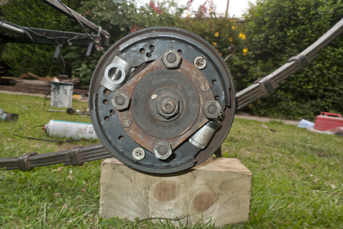

New brake shoes have been fitted all round as well as new brake pipes, This meant the brakes could now be bled!
