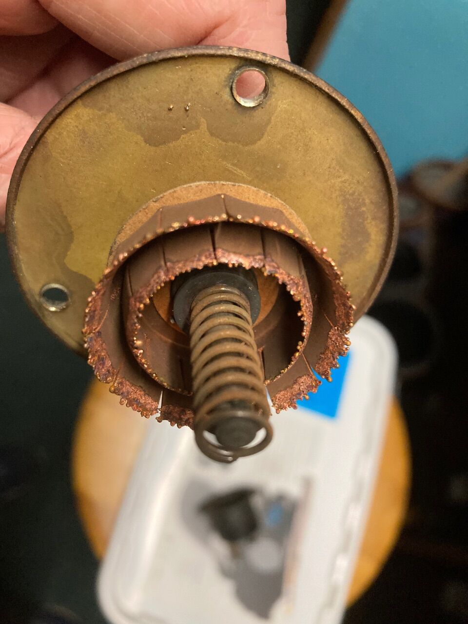

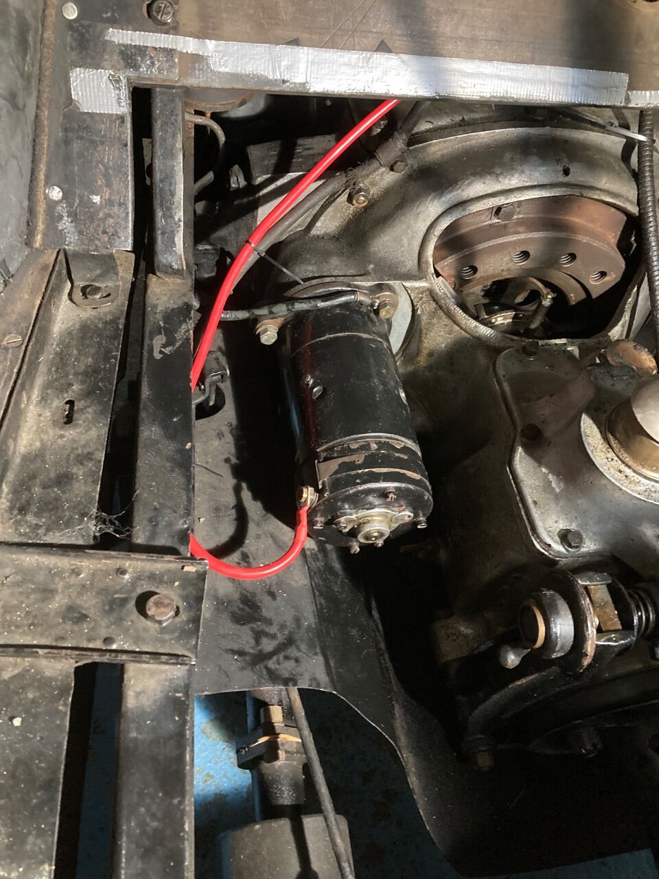

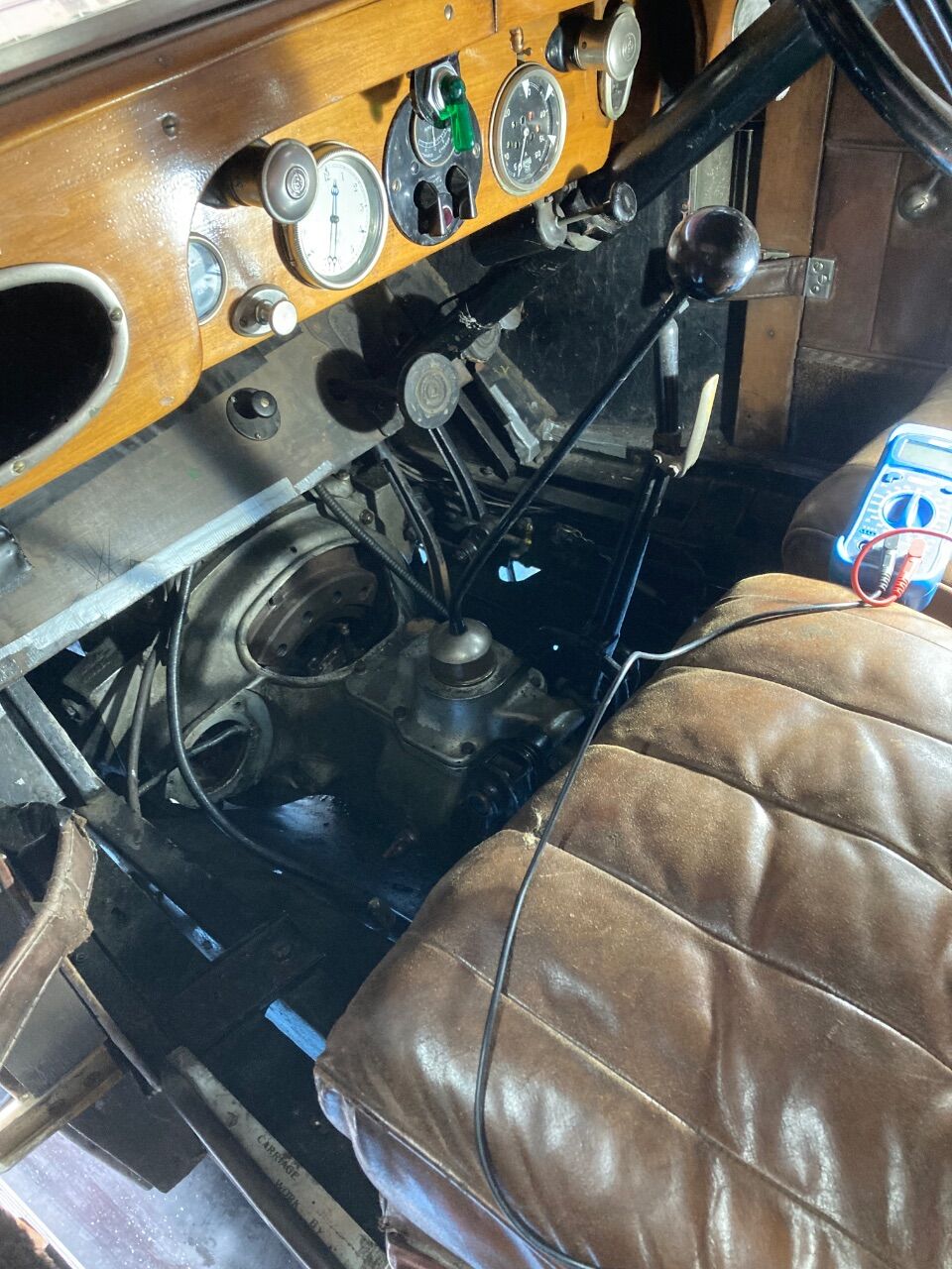

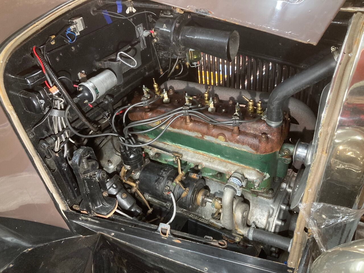

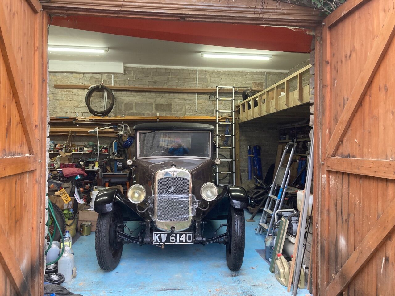

Popular Post Paul-l Posted January 3 Popular Post Posted January 3 As I mentioned in the news thread I bought an old Austin. It’s a 1929 16/6 burnham saloon with a 2.25l straight six. it did turn up about a week earlier than I expected which resulted in a frantic tidy of the garage and construction of a storage mezzanine. anyway went out for a little run in it on New Year’s Eve, which was cold and foggy, and got excited about taking it to a local car meet on New Year’s Day… turns out the car wasn’t so keen on going back out in the cold, which meant I got to take it apart within 24 hours of arriving. so out with the spanners and got the starter out to check that. All looked good , but I did rotate the end cap 90 degrees as the wire connection was about 2mm away from the steel gearbox undertray. Continuity check on the starter switch said that’s where the problem was. Removed and stripped the starter switch and gave it a good clean, quite easy really, just waiting on new rivets, with the switch bolted together for testing and it works fine. Then as I put the starter back in the terminal fell off the wire! That’ll be the fault then - off to Halfords for a cheep battery cable to get her up and running . I’m going to renew the battery cables as they’ve been extended in the past when it was converted to run from one 12V battery - it used to have 2 6V ones in series. auntiemaryscanary, Mally, davehedgehog31 and 80 others 83

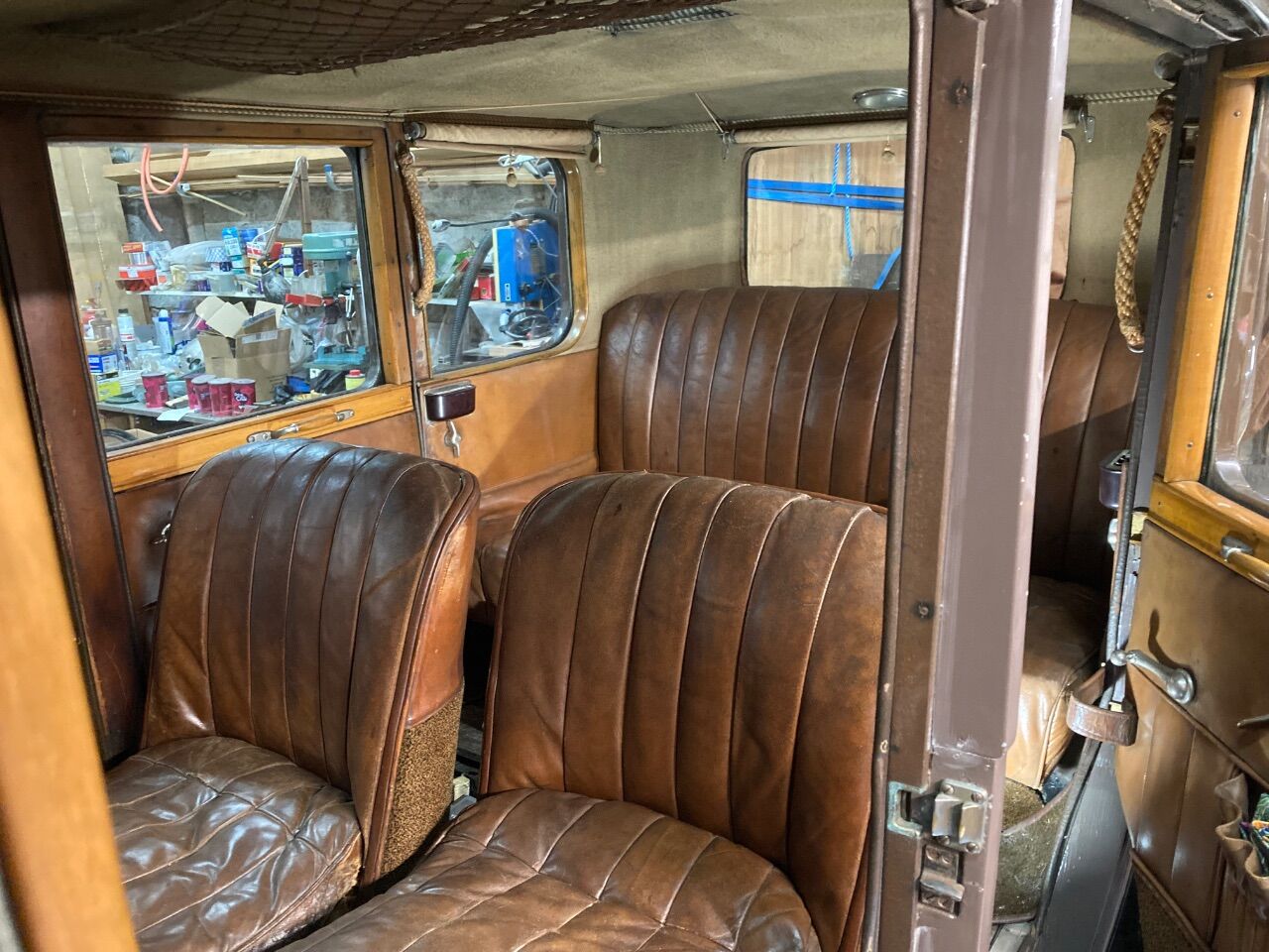

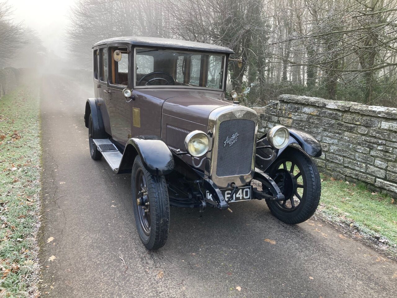

Paul-l Posted January 3 Author Posted January 3 Inside it’s quite a nice place to be - comfy seats, springs that work, doors that seal fairly well and windows that mostly stay up. Even though it doesn’t have a heater there is som heat coming through from the engine, and enough drafts to keep the windows clear ( unless driving in freezing fog, that required stops to clean the windows inside and out). while I was waiting to get the battery cable I had a quick poke around the electrics - I don’t really like finding an un-fused wire rammed into the battery clamp with three joints covered in insulation tape in a 6 inch length, so I replaced it with a fuse holder. Had to get the large soldering iron out for that, don’t look for the woodworm holes in the handle though. yes oui si, sdkrc, Dick Cheeseburger and 29 others 32

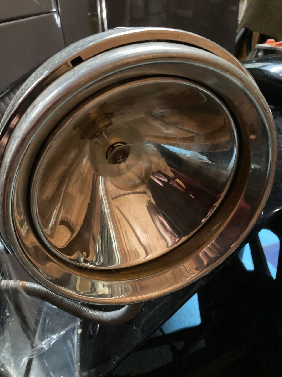

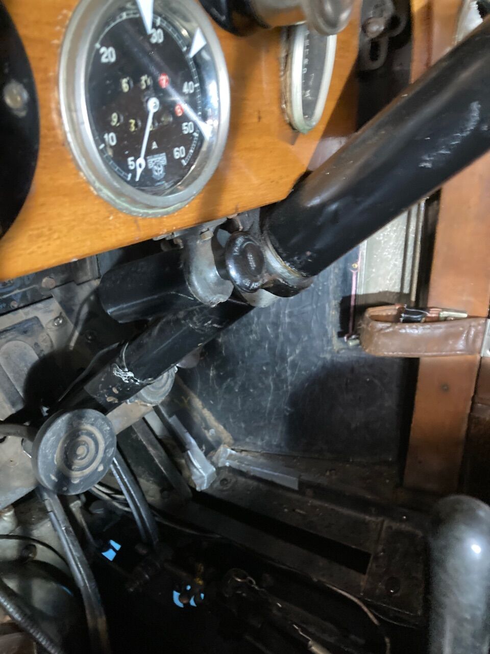

Paul-l Posted January 3 Author Posted January 3 Here’s one of the things that was done differently in the 20’s headlamp dipping. theres a plunger attached to the steering column, which moves the reflector on the near side headlamp to dip and offset the beam. the offside headlamp however isn’t connected to this system and is also switched completely separately from the all the other lights junkyarddog, Surface Rust, Joey spud and 30 others 33

captain_70s Posted January 3 Posted January 3 40 minutes ago, Paul-l said: Here’s one of the things that was done differently in the 20’s headlamp dipping. theres a plunger attached to the steering column, which moves the reflector on the near side headlamp to dip and offset the beam. the offside headlamp however isn’t connected to this system and is also switched completely separately from the all the other lights I was reading a brochure for a 30s Vauxhall over the new year, as one does. That mentioned the N/S lamp would dip and the O/S lamp goes off entirely when the button was pushed. myglaren and N Dentressangle 2

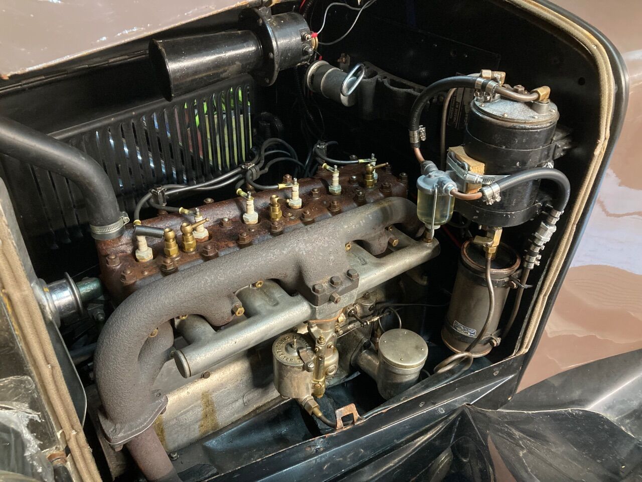

tooSavvy Posted January 4 Posted January 4 Timing chain at the *rear of the block.... How trendy 😉 Looking at that.... it says 'car!' 👍 🚙💨 Paul-l 1

Paul-l Posted January 4 Author Posted January 4 4 hours ago, tooSavvy said: Timing chain at the *rear of the block.... How trendy and so easy* to access for tightening / adjustment! tooSavvy 1
