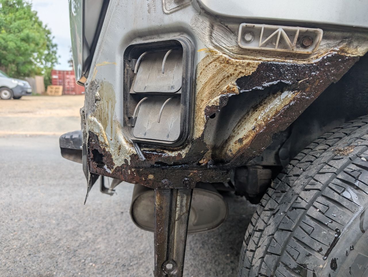

Beyond economical repair at normal welding rates. Most cars of that age are probably going to be similar under splash panels and plastic trims.
The easiest fix to keep water out would be to plastic sheeting over it inside and out...
You could get a plate of 0.8mm steel and adhesive/rivet it over the holes.
I wouldn't bother with fibreglass. It's horrible stuff and to bridge those gaps you'll need some mesh or something to give it support.
I've got a local friend who says he'll help, he even has Fibreglass sheets and has done boats in the past. No idea how successful those endeavors were but the car doesn't have to float!
Mesh is a fair idea, would be easier to mould to the curved shape too I guess and make the inside passable at a glance (I might get some cheap cans of the body colour and spray the inside once done so it doesn't look a different colour or etc. Then maybe hide it more with cheap dynamat in those corners and across the boot floor to pretend I'm dampening down noise 🤔

If you've got a welder and some sheet metal,welding is quicker and cleaner than fibreglassing.I hate the stuff, especially the smell and the cleaning up.Used to do some body "repairs" with that thin aluminium sheet that used to be used behind gas fires.You could cut it with scissors and shape it easily.Think if I wasn't welding,I'd perhaps try that and stick it into place.
But he hasn’t got a welder…
But if he had, the job would be done,seamsealed,painted, rustproofed and reassembled,without fearing the MOT testers gaze.And beko could get on with worrying about his head unit,his clutch and all the other delights of keeping an old car alive.He likes the car and has spent a lot of time and money on it already.It's probably at a bit of a sweet spot parts wise,with stuff cheaply and easily available,new and used.Worth looking after, I'd say.
I would weld it but I’ve got a welder, if you haven’t got one or cba with learning it or whatever then it’s Hobson’s Choice. Either live with the hole or rivet a bit of tin over it or fibreglass it.
  • Agree 1
Tbh the metal is going to be too thin to learn how to weld with.
The easily formed mesh and rivets,with some sealing fibreglass would be my choice if the cars not a keeper.

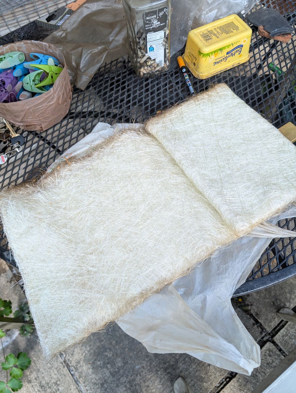

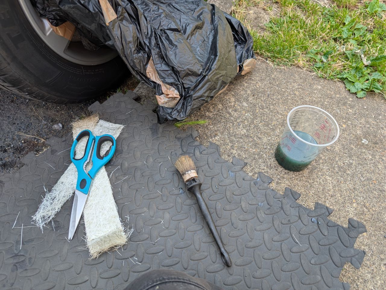

It’s pretty straightforward to be honest, forget any notion of cleaning the brush out. Layer it up with plenty of coarse sheets bonded onto clean metal.

We're due a thunderstorm overnight but dry again tomorrow. So I pulled the car round, pulled it's arse off and spent half an hour with a wire brush and the rust converter, then gave that an hour to dry.
My mate who is coming to help me tomorrow said to mix up some resin and paint a thin layer of that all over it so it helps it stick tomorrow, so I've just basted the turkey
I'll need to find a sheet to cover the rear wheels tomorrow, loads of resin dropped down the drivers side one.
  • beko1987 changed the title to 2009 CashCow - Wobmas eve
Covered it from the rain thats coming. I don't think I used enough hardener as it's still tacky but equally it's got until mid morning tomorrow so 🤷
Part of me did wonder if I could just layer up bin bags and resin but I'll try it properly once first...
Personally,I'd have used an angle grinder with a grinding disc or flap wheel and got the metal a lot cleaner than that.But best of luck and be interesting to see how it turns out.It is evil stuff to use though.The smell alone makes me feel ill.And if you get it on your hands,you end up with sticky paw prints everywhere!Bfg is our resident GRP genius.He seems able to make and repair anything with the stuff.He'd probably make a complete bodyshell to convert a rusty Quashquai into a two seat sports car!
2 hours ago, Dobloseven said:
Perhaps drill some small holes in the metal to help the fibreglass key into it.
There's tons of those already 🤣
I don't have an angle grinder either. I could have drill brushed it a bit, I've got a tiny wire wheel for that but the metal is so thin around the edges I'll loose tons of material and make the hole even bigger. It's reasonably clean, I chiseled all the loose and flakey bits off with a screwdriver, it'll be fine*! I probably should have cleaned it all down, that black shite is the rust converter where I painted it over the paint and scrubbed it into every rust pore there was
I think I fucked up mixing the epoxy though, because I didn't make a batch that's marked on my measuring cup thing (that came with the rust converter) and just sloshed a tiny bit in a Butter pot I didn't add enough hardener and it's still mildly tacky this morning 😬
Hoping once we mix a properly ratio'd batch up it'll sort everything out 🤞 Not getting cracking until later this morning, my mate's out until later.
I got some in my hair too, that wasn't fun to pull out. I did buy gloves though 👌
It’ll be fine, if it lasts a few years who gives a shit, it’s better than a big hole there.

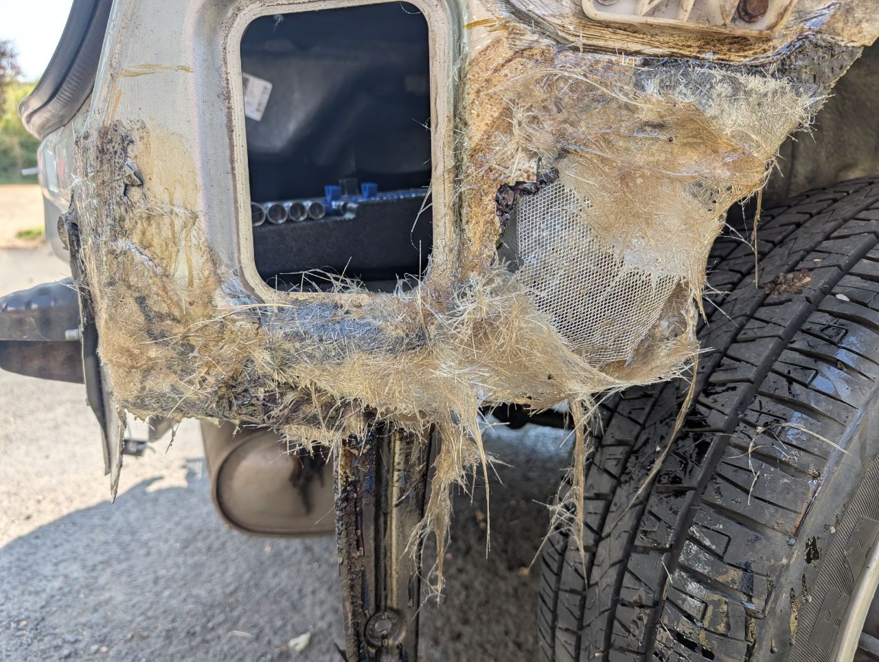

Turns out my friend couldn't stay and help today, so I went in blind-ish 😬
This stuff falls apart as soon as it's touched 😡
This resin is a twat toi
And my first attempt was woeful and fell off.  I cut most of it off and had another think.

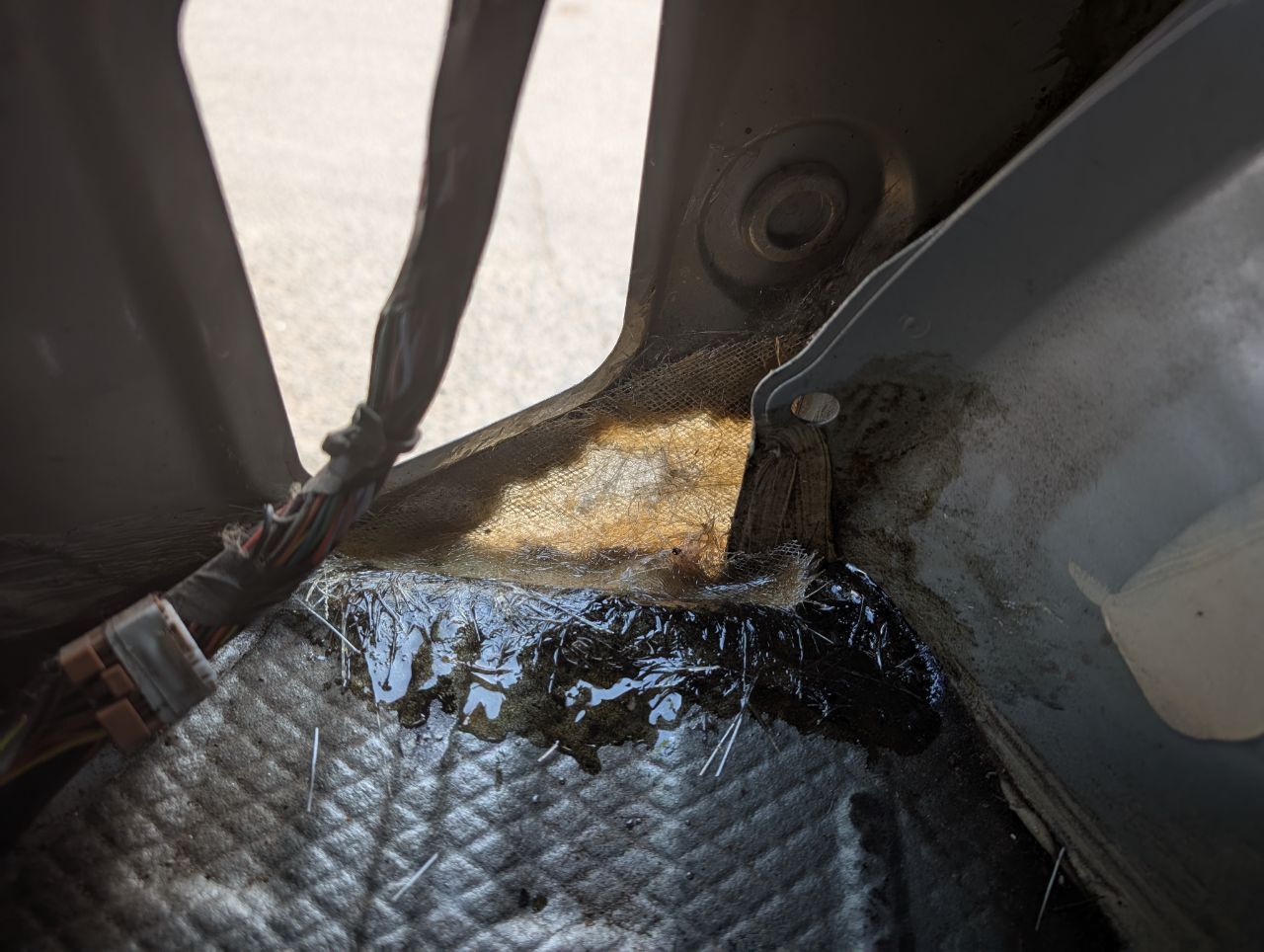

I re did my mesh from the inside and fibreglassed that down
This made the outside far nicer so I started layering up the drivers side a bit
It won't fold and stay around the edge it needs to so it's got clothes pegs holding it now
I'm giving it an hour to cure, and I have an hour to find more brushes 😡 Gone through half a tub of the resin too, I'm not doing it right, but I'm hoping I'm doing it right enough.
The gloves I bought are fucking shit too, the resin eats them. I'm wearing them now whilst having a coffee and typing thisas my fingers stick to everything 🙄

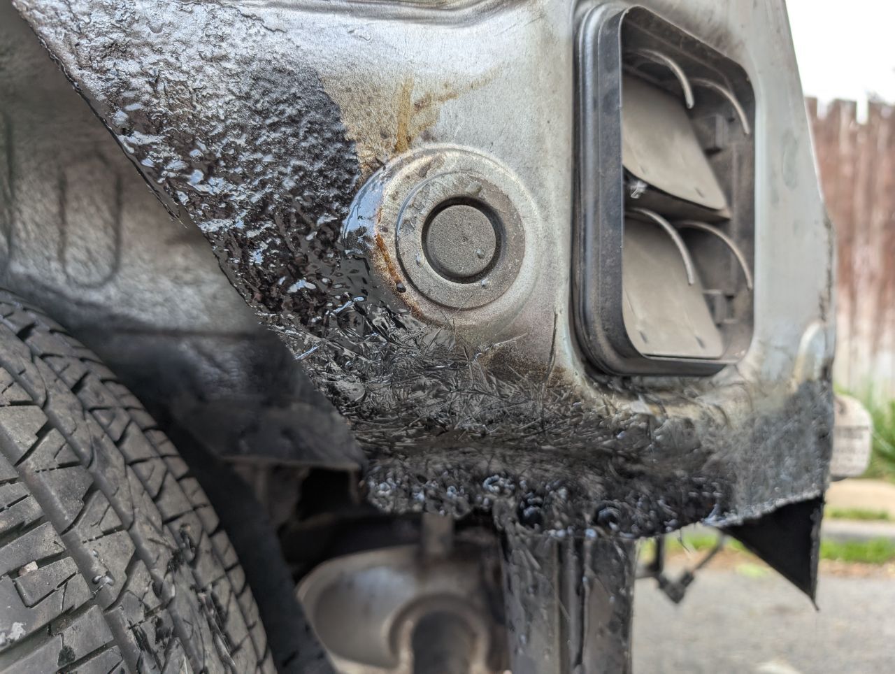

Once it set off, it's gone rock solid! I tidied the edges with a little hacksaw blade and sharp knife, then did a waft of black around the inside of the arches to knock the edge off it all
Same on the passenger side, I used that tin of silver I bought for the xsara on a few spots just to hide the rust/make sure if you peek between the bumper edge you don't see nuffink.
Some war plane then did a few laps which was nice
PXL_20250614_130433796.jpg.dfc30d00a9a33a33bdfbdd633b2ba508.jpginside I sprayed more black paint. This stopped one being able to see light through the repair from right under the bumper with your head in the right place. It worked.
I've got the car back together now (going out tomorrow). The interior of the boot is better than I was before as I've made bloody sure every carpet fixing hole has a fixing in, there's no having a peek behind there now 👌
I think another day I'm going to get some thick black underseal and do some thick coats over it all so it vanishes from underneath. That's easy to do without taking the whole bumper off tbh.
It should be watertight now, once the first bit set as I ran out of epoxy each time I poured it onto everything from the top so it crept into everywhere. Wether it's worthy of an mot pass, we'll find out in August 🤷

That's done exactly what you needed it to, it's water tight and isn't going to be visible, nothing wrong with that
Thanks! Hopefully it's done the job! It's tempting to leave it a few weeks now then go back over with a thick layer of epoxy from the bit I've got left to fill any voids that are left, then some nice gloopy underseal so if the tester does stick his hand up there it'll feel smooth-ish

Looks very good indeed.Horrible stuff to work with though, isn't it? I'd spray some of that textured stone chip stuff, followed by some silver paint for an authentic factory finish.
Top tier giffer bodging in the finest tradition and you've probably done more to stop it rusting than Nissan ever did.

Spoke to my mate again later on Saturday when I dropped his bits back and he suggested we buzz it mildly flat with his grinder and a wheel, then do another layer of very fine Fibreglass, then underseal it smooth. That sounds like a decent idea. Will get more supplies on payday, although I won't need the big tub of epoxy this time.
