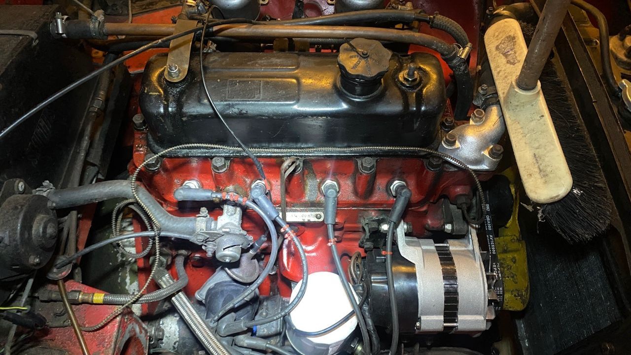

I’m not sure how it’s plumbed together on the B, but is there any rubber fuel pipe at the back near the tank?
Just a thought, but could a filer be fitted in at the tank end anywhere as then it’ll filter fuel directly out of the tank and help stop dirt getting into the pump as well as the carbs. Might not be possible though.
It could but you'd be scrabbling around on the ground to check or change it.
It's bad enough hitting the pump with a hammer when the points stick, which I once had to do on the Tinsley Viaduct with HGVs storming past a few inches from me, fortunately in daylight.
I change that awful braided hose a lot at work.  It will leak underneath the braid sooner or later and ruin your day.  It's also totally pointless and cuts your fingers when it starts to fray.
Replace everything with Gates Barricade, nothing else is good enough, and I usually put a clear plastic filter on the bulkhead at the top where the hard line comes up.
That small black thing that caused the running issues is almost always a bit of rubber hose, that's been shaved off the internal diameter when you fit the hose to the float chamber.  It then gets stuck in the needle valve and causes mayhem.
Once I've fitted new hoses and a fresh filter, I leave well alone and then the system is much more reliable.  An upgrade to a pair of HiF carbs would make it better still, but they're very expensive now!
Is Gates Barricade the marine grade stuff?
Ive been using marine hose on my cars. There’s a certain standard it’s got to meet or exceed with regard to ethanol so if it’s good enough for boats! So far I’ve not found any of it cracking, hardening or degrading. The cheap crap hose I got from a car spares place didn’t even last a year before it started perishing.

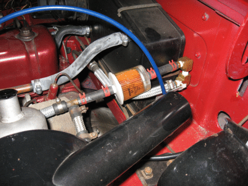

Found this image as a suggestion for possible routing of the new pipes and filter.
That's where I fitted the filter on mine.

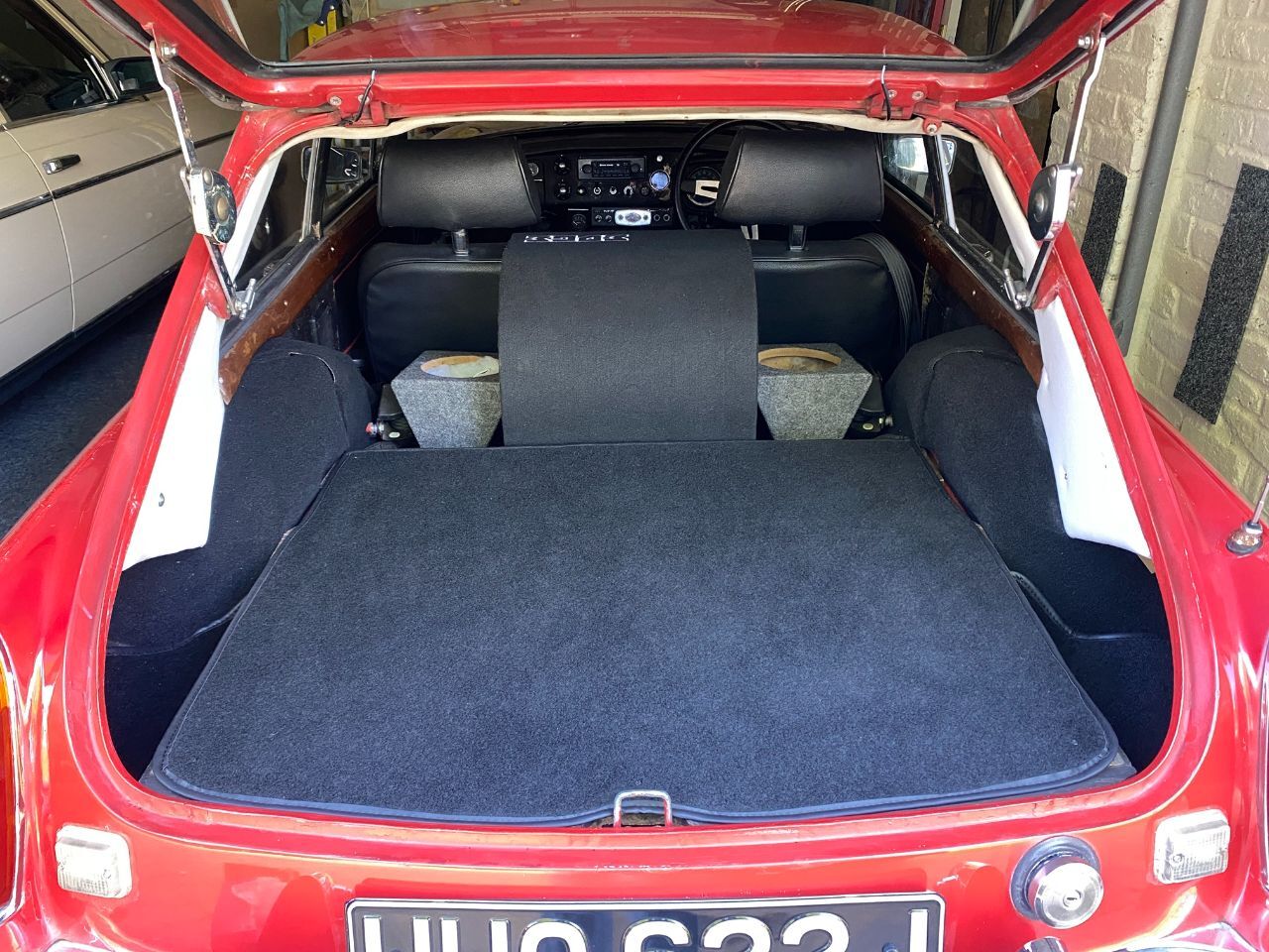

For sometime now I wanted to fit an amplifier to power the MGB’s speakers.
This is because:
  • Of all the tinkering jobs that I do on my cars, installing ICE is my favourite.
  • I've had upgraded ICE in dozens of cars over the years but I've never had an external amplifier powering the speakers (just subs).
  • I had everything I needed in the garage.

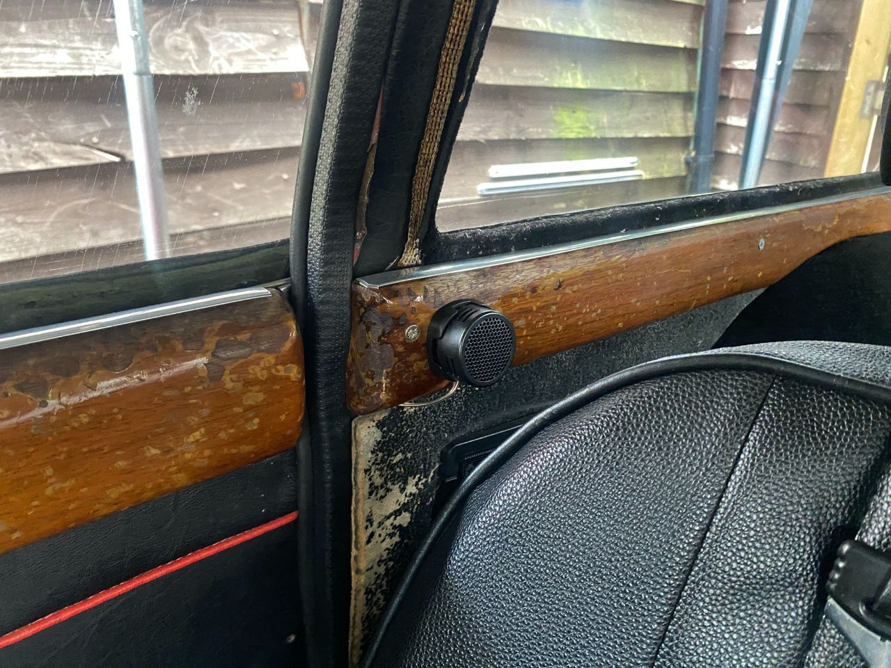

I started by re-wiring the six speakers - two tweeters on the A posts, two speakers in the front doors, two speakers in the rear 3/4 panels. I extended new cables towards the footwell behind the passenger seat.
I connected a new +12V supply to the battery and a new earth connection for the amplifier.
I connected the new cables to the amplifier and extended the RCA and remote cables alongside the passenger seat, to where the head unit is perched.
So far so good.

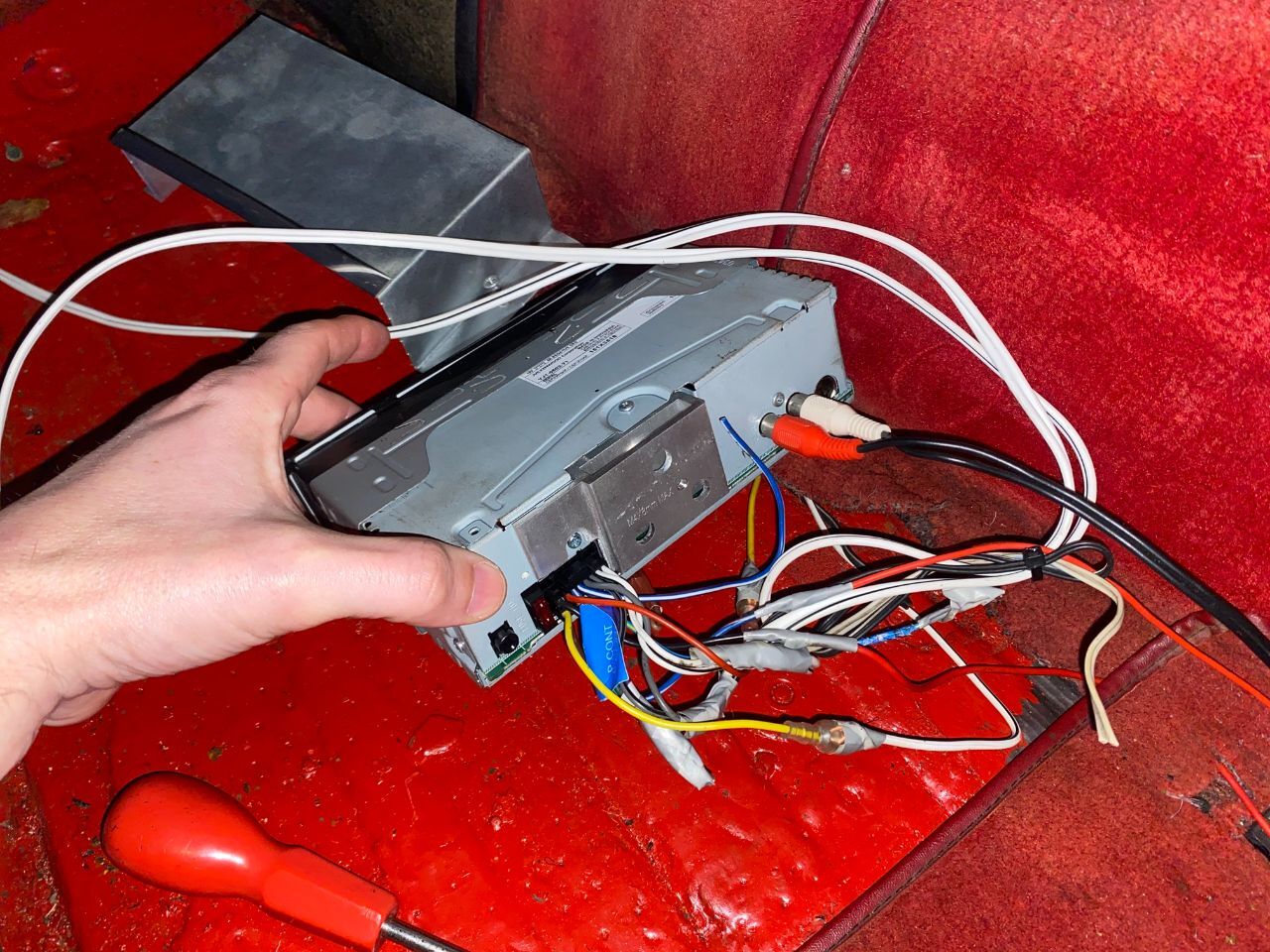

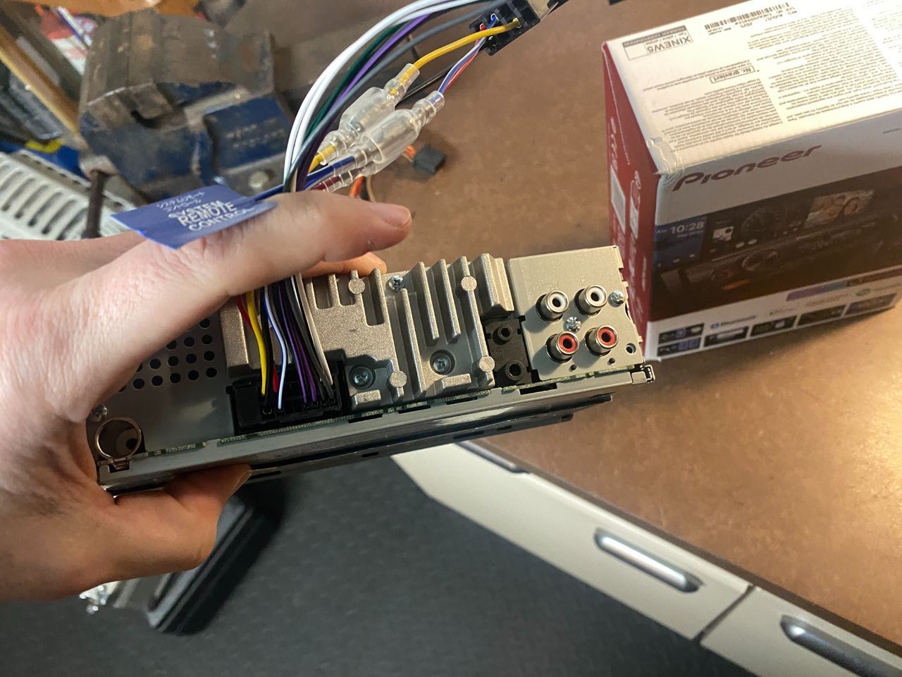

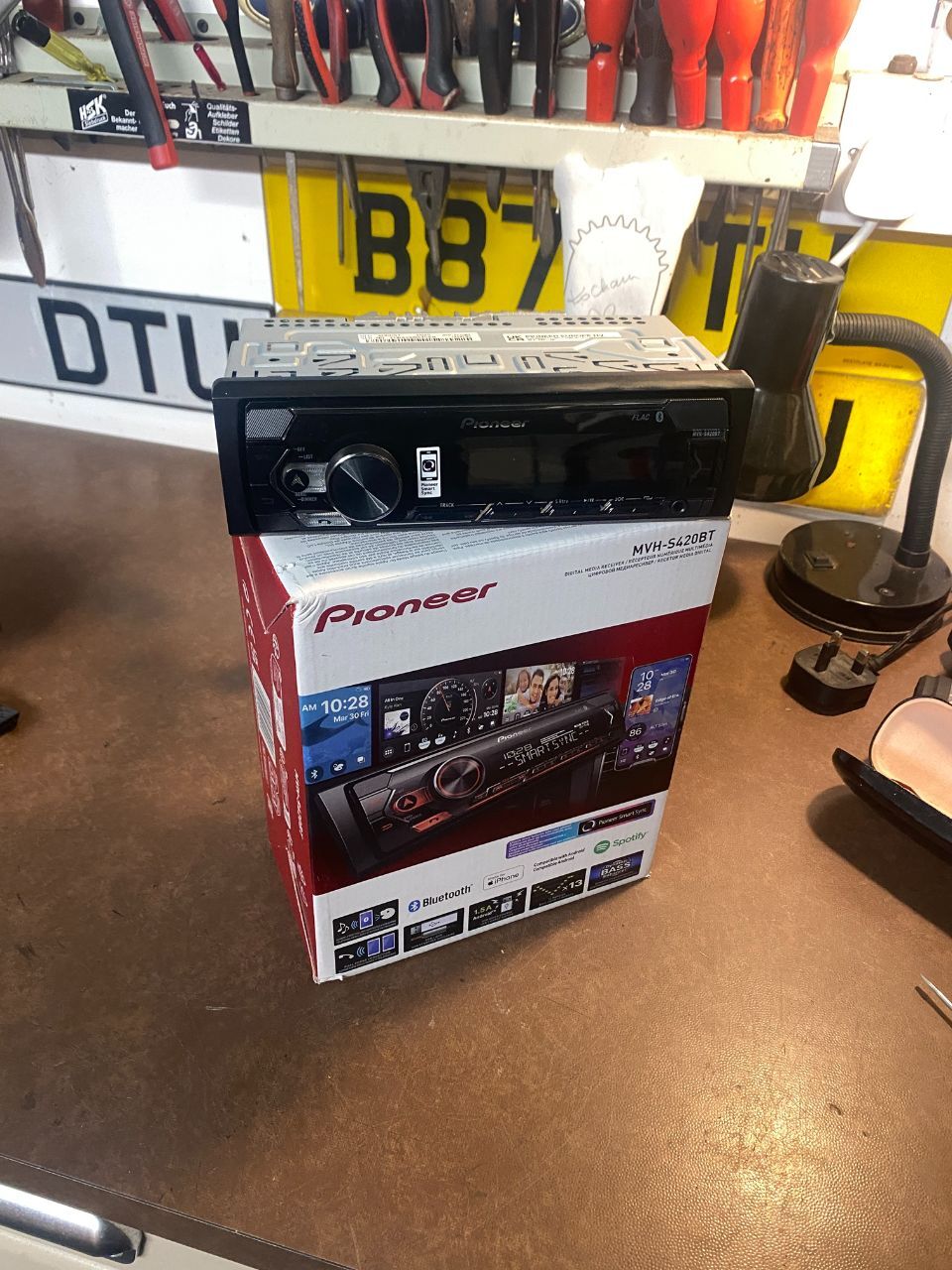

I removed the head unit and at that point I hit a big stumbling block - the head unit only had one pre amp output. The head unit has front and rear high pass filters and on that basis, I could have sworn that it also had two pre amp outputs. This was a significant issue because the amp's high pass filter allows too much bass to the speakers, which means that I needed the input signal into the amp to provide just high and mid tones. However, as I also need the head unit to provide a through (full range) signal to the subwoofer's amplifier, which has a built in low pass filter, I couldn't split the head unit's single output.
Bugger.
I ended up buying a replacement head unit. So much for having everything I needed in the garage.
The spec of this unit is identical to the one I had, other than it has the all essential two pre amp outputs.
Fitting the new unit was a doddle.
The sound quality with the Sony amp powering the six speakers is great. I still have to fiddle with the gain settings as at the moment I can crank the volume up on the head unit to around 50 (62 being max - why not 60 or 100?), which is a bit high. The gain setting on the Sony amp is at approx 30% and 50% on the sub's amplifier. I can't crank the gain setting on the Sony amp too high as it is a bit too powerful for the speakers, although if I understand matters correctly, bass tones do most damage to speakers and my speakers only produce mid and high tones.
I really like the idea of a ridiculous sound system in an MGB and I still have a very nice Alpine amp in the garage, which could easily power four more speakers. By removing the passenger side map pocket, I can make space for a speaker that could be fitted to point towards the cabin. There is already space on the driver side for installation of a matching speaker. I just need to figure out where to put the other two speakers.
If anyone is interested, I am roffling the old head unit:
More soon.

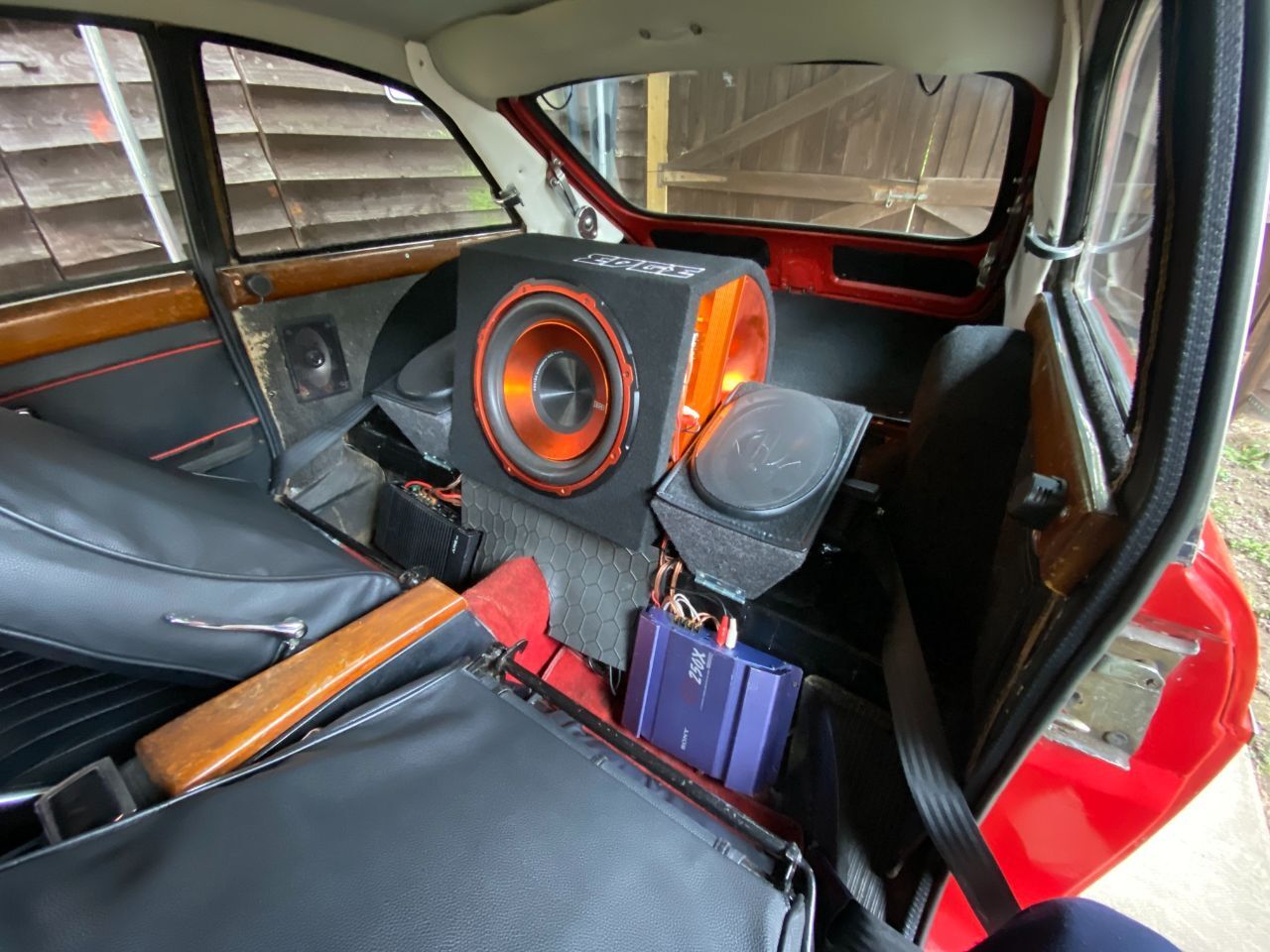

Due to a nasty sinus infection I've stayed away from the garage for a few weeks. I'm feeling better, well enough to spend a day in the garage installing more ICE into the MGB.

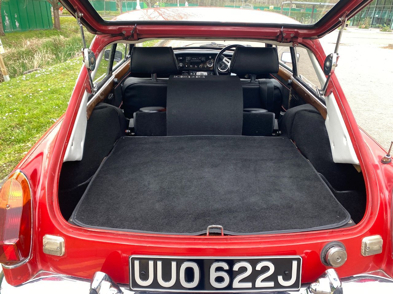

I had a nice Alpine 3523 amp that needed a home as well as a couple of MDF enclosures ready to receive some 6x9 speakers.
The plan was to fit the additional speakers behind the front seats, alongside the subwoofer.
Before buying the speakers, I did a bit of research and settled on these Pioneers. They have a relatively small magnet, which means that they would fit into the enclosures ok and they mostly have good reviews. The positive reviews referred to crisp mid and high tones whilst the less favourable comments referred to insufficient amounts of bass. My plan was to run these speakers off the same signal as the Sony amp and speakers, which is set to only produce mid and high tones, so I wasn't fussed about the quality and quantity of bass tones.

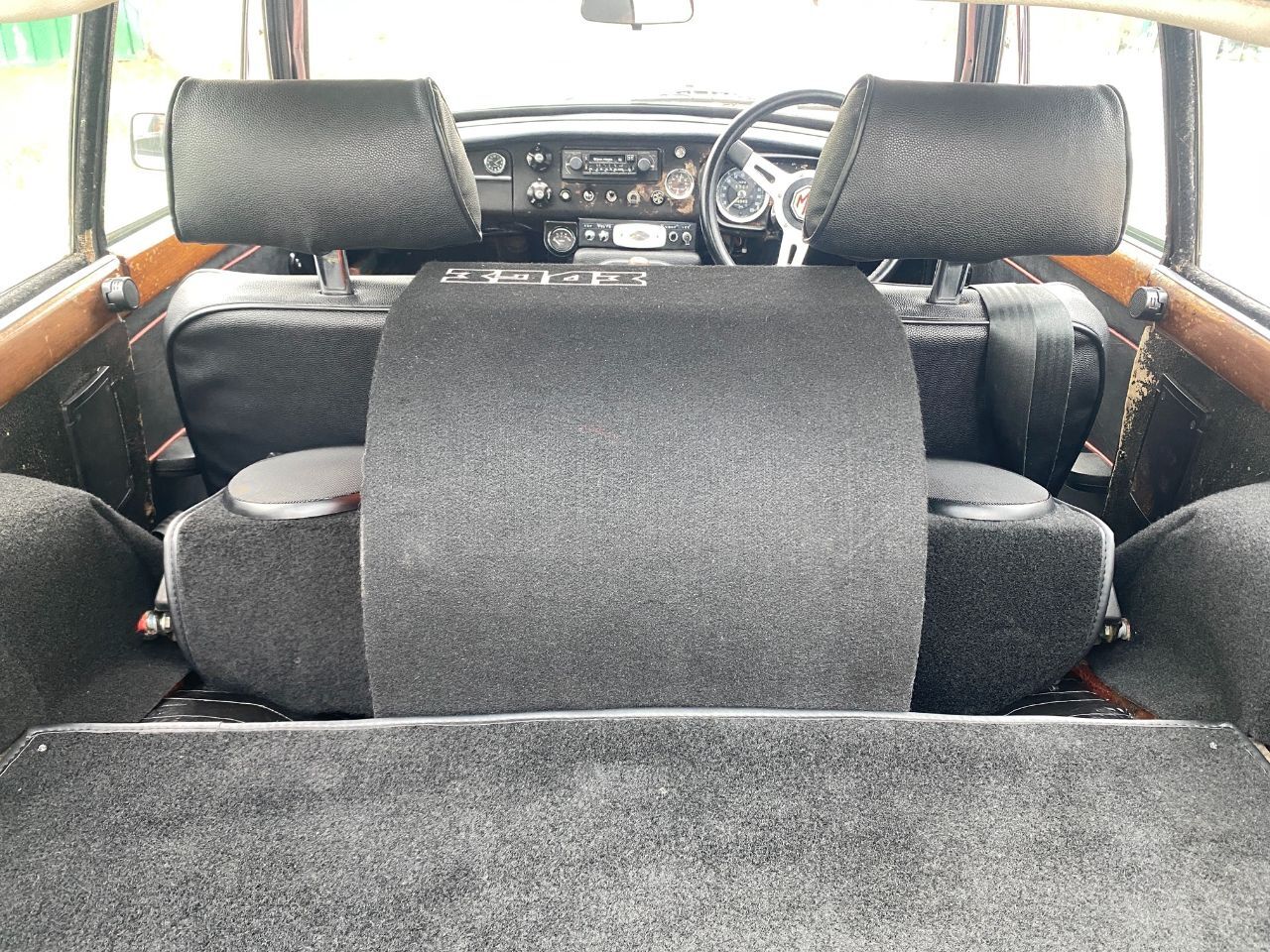

I mounted the Alpine amp behind the driver's seat. As before, I connected the +12V supply directly to the battery (fused at the battery end). I made use of the same earthing connection and I connected the remote cable to the Sony amp's remote terminal. As the head unit only has two sets of pre-amp outputs, one of which is for the subwoofer amp, I had to split the other output with adaptors that I had from a previous project.
The 6x9 speakers fitted just fine. The enclosures are mounted on hinges, which allow the enclosures to tilt forward, the same as the subwoofer enclosure, which is necessary to enable access to the battery.
With the front seats in reclined position, the amps and wiring are fully concealed.

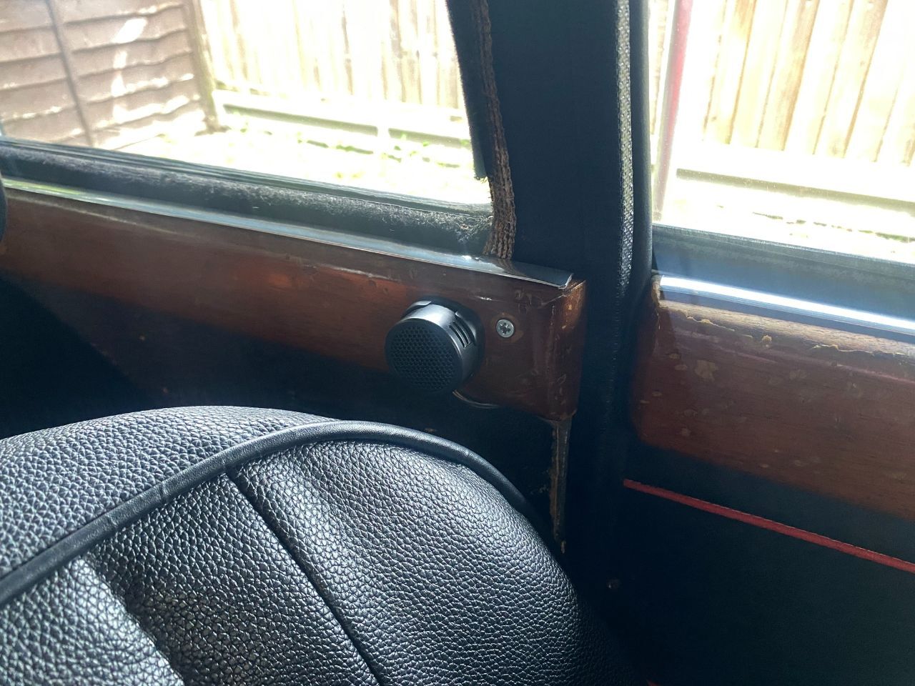

I also fitted a pair of tweeters on the B posts, which are positioned high enough to be heard up front.
The luggage compartment carpet set that I bought at Beaulieu last year contained a piece of material destined for the back of the rear seat. It was surplus to requirements so I cut it in half and lined the tops of the speaker enclosures with it. It works well as the carpet and vinyl edgings match the rest of the interior.
I am pleased with the way the installation turned out. I only had to pay for the speakers and they weren't particularly expensive. The enclosures fill the two voids that didn't serve any purpose and don't impede on luggage space.
So, how does the system sound? Nice! You can definitely hear the extra sound coming from the rear. I still need to balance the amps to ensure that each amp and associated speakers are performing at their optimum but I will leave that for another day.

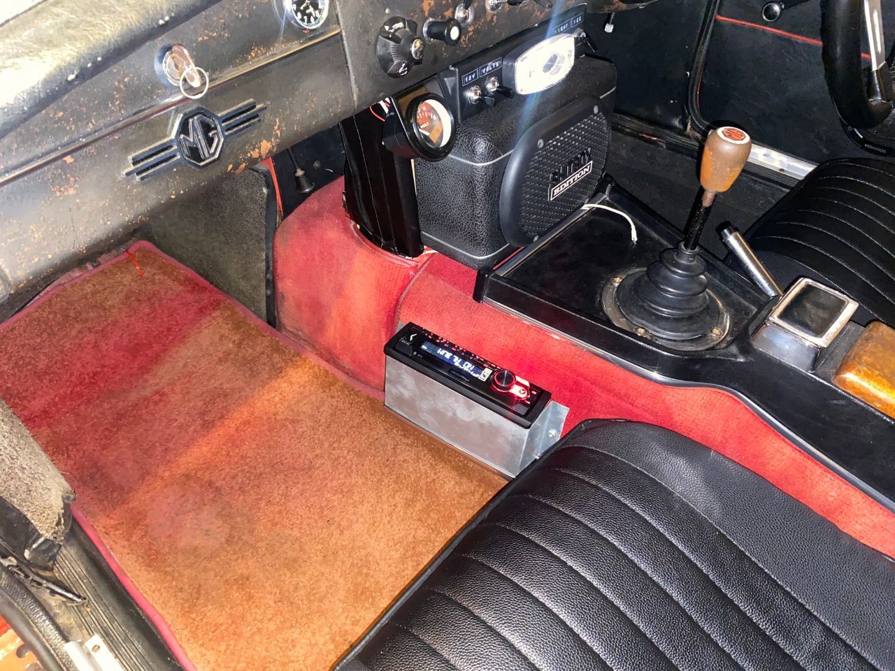

As matters stand, the new Pioneer head unit is located in the passenger footwell, the Sony amp is powering a pair of tweeters fixed to the A posts, a pair of Pioneer 4 inch speakers in the front doors and a pair of Alpine 4x6 speakers located in the rear quarter panels, the Alpine amp is powering the new 6x9s and the tweeters fixed to the B posts and the integral amp is powering the subwoofer. In total, that's 11 speakers. Not bad, if you consider that the original MGB had just the one.

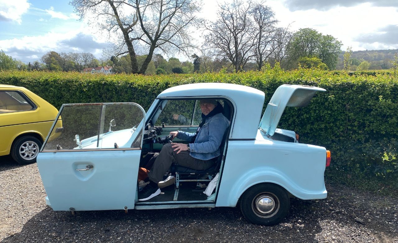

Finally, huge thank you to @LightBulbFun for letting me sit in his incredible AC Invacar.
Proof that you don't need a sexy red sports car to look cool.

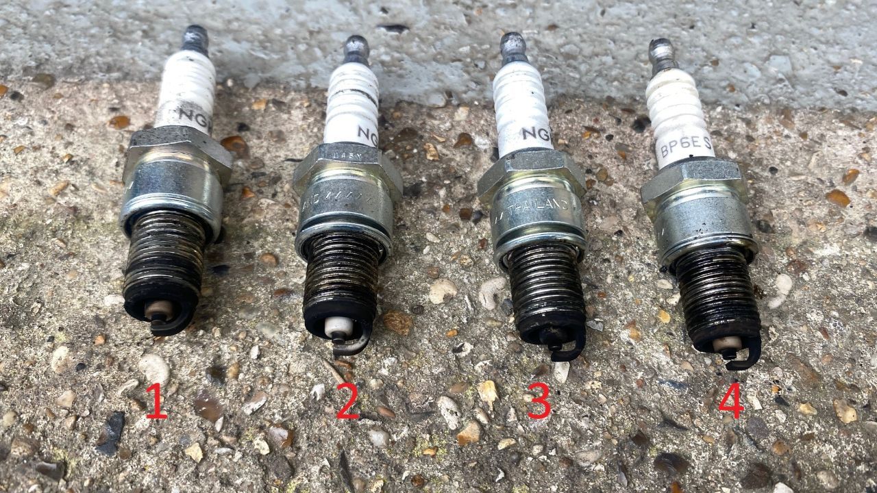

I got home without any issues, however the fuel gauge reading caught my attention.
I brimmed the tank shortly after I left home and my return journey to Silverstone via the A413 was about a 100 miles.
I paid £45 for fuel, at £1.80/litre of super unleaded means that I filled the tank with 25 litres, which equates to 5.5 gallons.
When I got home, the fuel gauge was showing just over half a tank, the same as before I got fuel.
100 miles divided by 5.5 gallons = 18MPG!
Fuck that, that's insane. I took it so easy all the way, never went past 3,000 revs and there was virtually no traffic on route.

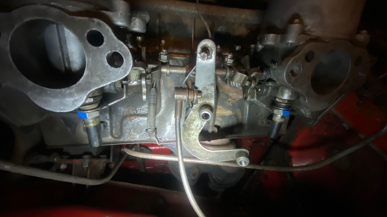

There are no fuel leaks that I am aware of. When I had an issue with a sticky carburettor float valve and fuel was pissing out, you could smell it from a mile off. I'm not getting any nasty whiffs now.
I knew that the engine was running rich because it would start with the choke briefly pulled out and then it would idle and run ok with the choke immediately pushed back, rain or shine, hot or cold. And you could hear the powerful idle when standing by the tailpipe.
I'm going to have a fiddle with the carburettors and lean out the mixture bit by bit. I would be happy with 30MPG.

I wouldn't rely too much on the fuel gauge, they are not super accurate - maybe brim the tank again and see how much it takes?
I hear what you’re saying but I know that the ‘B is running rich.

Any indications last week on the run to and from Godstone that the mpg was that bad ? That day out must have been a similar journey length. I would certainly do another brim fill-up before fiddling with the carbs.
Those B series engines always sounds to me as though they are hunting a bit, so I wasn't surprised when yours did when you were manoeuvring into place to take the pictures at the end. I would also whip out all 4 plugs and see if any are sooty. Maybe the carbs are out of balance, but that would lead to more general bad running.

So, update.
I decided to whip out the plugs. It's a difficult job on an MGB but I managed.
Access to the plugs is impossible.
Plugs removed and it looks like cylinders 3 and 4 are running richer than 1 and 2, although all four plugs looked sooty.
I cleaned up the plugs and put them back in - another horrendous job.
I marked up the carburettor mixture adjustment nuts with blue paint, so that I know what point I am starting from.
I adjusted the front carburettor (clockwise - from underneath) to make the mixture leaner by 3/4 turn. Based on my inspection of the plugs, I did the same on the rear carburettor but by one full turn. That sounds a lot but I must confess that I turned them the other way a similar amount when I fiddled with the mixtures last year.
I started the engine, which ran fine, at much lower RPMs and without chugging, which it did before. Sounded ok and it idled better than before.
The plan is to take it for a long drive as soon as possible and see how it's running.
More soon.
Glad to see you got round the access problems!
Clockwise sounds right to me, to raise the base part that the needle slides in/out, but it has been 40 years since I messed with SU's. Gunsons still make a Colortune to help set the correct mixture, but they are about £100 the last time I looked. Maybe someone local on the forum has one you could borrow, if you dont have one.
I can dig out my old Gunsons Carbalancer, and drop it off next time I'm passing your way if it helps in the future, although a piece of tube is just as good.
