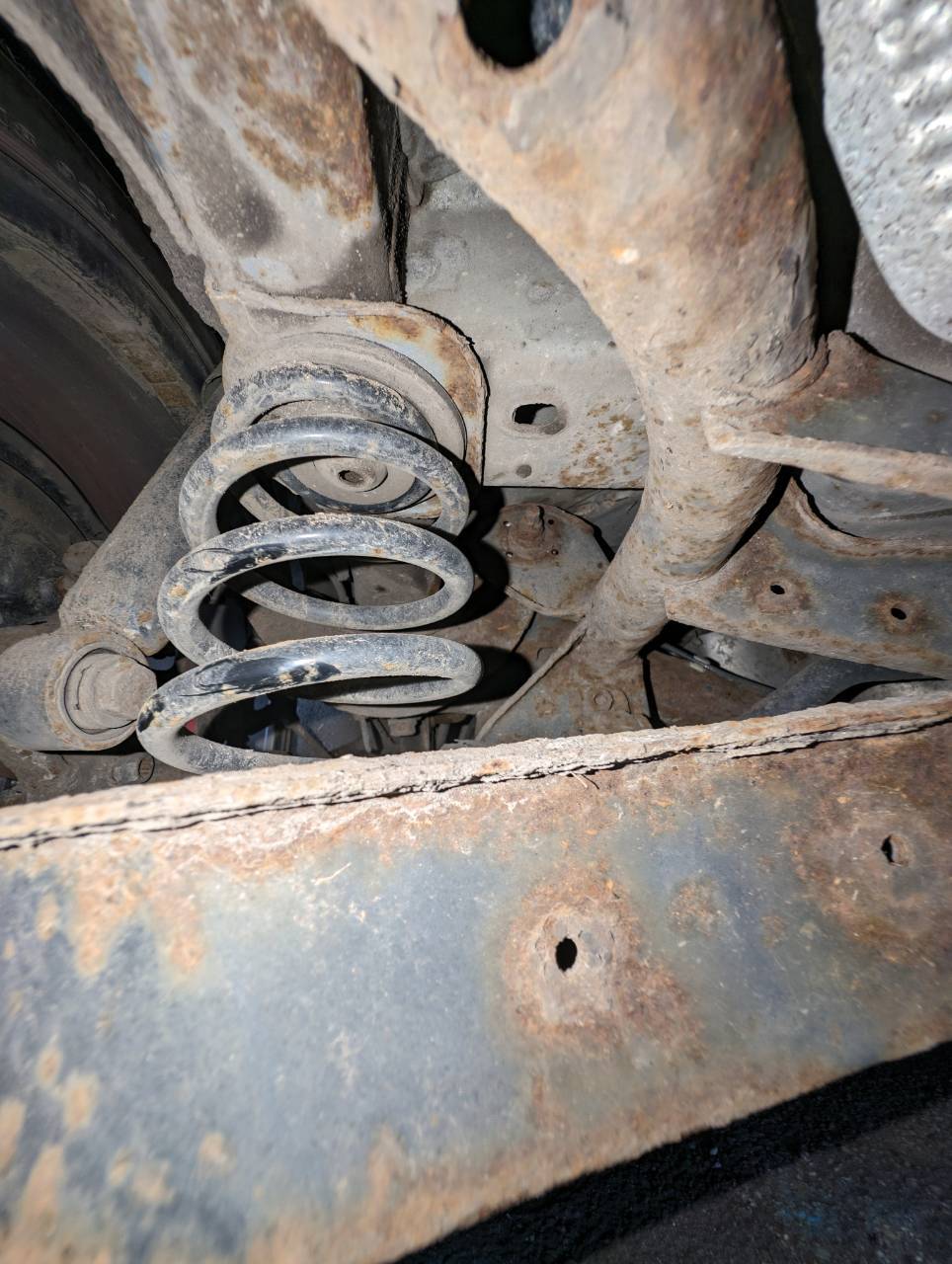

SiC Posted March 26, 2024 Author Posted March 26, 2024 Went for an alignment check at lunchtime. Way out. However it wasn't adjusted as they reckoned the tie rods are seized solid and likewise the rear arm bolts are too. TBF the rear arm bolts are steel bolt into aluminium bushing so that's completely fair. Question is what do I do? They did quote for them to do but as this is a project car and I want to learn (I've never done tie-rods), I'll DIY. Front: a. Leave the front as is and just live with wonky steering wheel. b. Replace just the front outer tie rods but might be a fight. (£25 for both Febi) c. Replace the complete inner and outer tie rods on both sides (£50 for Febi on both sides with boots) Rear: a. Leave as is b. Replace just the bolt and maybe the bush. I have a press but the arms are crusty. (£25 in bolts) c. Replace the complete rear arms and bolts on both sides (£80 for both arms+bolts as NAPA) d. While the arms are off, replace the springs (£40 for pair as NAPA) e. Hell, replace the dampers while there too (£40 for pair as NAPA) Going all the most above I'm looking at £202 in parts. I also need a inner tie-rod tool too and possibly a tie-rod splitter (no idea where mine is). I probably need to check the condition of the springs+dampers to see if they've been done or if OEM and likely original. Problem is where do you stop? After all it's a 200k welded up Golf mk5 with a slight chain rattle. Popsicle, FakeConcern and Tickman 3
Popsicle Posted March 26, 2024 Posted March 26, 2024 Therein lies madness. 56 minutes ago, SiC said: Problem is where do you stop? After all it's a 200k welded up Golf mk5 with a slight chain rattle. Either leave well alone and class it as 'charm/character' or replace the lot. You'll not be happy with a halfway job and mission creep will always rear its head, 'I'm changing the bush, might as well change the spring while I'm there'. SiC, purplebargeken and Wgl2019 2 1
dome Posted March 26, 2024 Posted March 26, 2024 I'd get the plugas/MAPP gas out and see if you can free off things yourself before throwing cash at it. I've no idea of the setup on the rear of these and the chances of shearing off something expensive but the tierods are worth a try. loserone and SiC 2
SiC Posted March 26, 2024 Author Posted March 26, 2024 26 minutes ago, Popsicle said: Therein lies madness. Either leave well alone and class it as 'charm/character' or replace the lot. You'll not be happy with a halfway job and mission creep will always rear its head, 'I'm changing the bush, might as well change the spring while I'm there'. Steering wheel is at about the 10 to 15 degrees point when driving straight. I definitely need to do something. 12 minutes ago, dome said: I'd get the plugas/MAPP gas out and see if you can free off things yourself before throwing cash at it. I've no idea of the setup on the rear of these and the chances of shearing off something expensive but the tierods are worth a try. Independent rear suspension on these. The rear bush is aluminium with a steel bolt. Hence the two usually become one. This still from the Autodoc video makes it look so easy when it's not rusted to bits. 🤣 I suspect the camber adjustment bolt is probably not in that fit a health either. dome, Coprolalia, Popsicle and 1 other 4
beko1987 Posted March 26, 2024 Posted March 26, 2024 If the access to the inner tie rod joint is good around the subframe, do the lot! The main reason my Xsara mot fail turned into the job it did was I thought I'd be able to get the track rod end off the tie rod with no proper clampy tools... Was seized together as one. Changing the inner rod was really easy, doubly so as I've got the fancy tool from doing it on last cars, although waterpump pliers work too. But my access is very good, if it wasn't it might be less fun, but once you've removed the gaitor removing a nice clean machine thread over a rusted to fuck outer one is more fun. If I'd just done that to begin with it'd have been a quick job. The alignment cost dwarfed the parts cost though SiC 1
SiC Posted March 26, 2024 Author Posted March 26, 2024 Rear springs definitely are not what you'd call pretty. Definitely not touching that camber bolt either without a replacement to hand. 🤣 I am thinking maybe leave the rear end for now. But then new springs/dampers/arm bushes would really tighten things up in the rear end. Also that toe is way off. Camber I'm less bothered about as that's still in spec and it really only buggers up tyre wear on the back if out.
RayMK Posted March 26, 2024 Posted March 26, 2024 If it requires steering input to actually run straight, I'd at least do the tie rods. If it's just the steering wheel being a few degrees off whilst running straight, the tyres are not shredding themselves and the car handles ok, I would leave as is. It depends whether you want to go ahead with significant expenditure for 'training' purposes, at the expense of using valuable time which could be spent on your other projects. SiC 1
SiC Posted March 26, 2024 Author Posted March 26, 2024 1 minute ago, RayMK said: If it requires steering input to actually run straight, I'd at least do the tie rods. If it's just the steering wheel being a few degrees off whilst running straight, the tyres are not shredding themselves and the car handles ok, I would leave as is. It depends whether you want to go ahead with significant expenditure for 'training' purposes, at the expense of using valuable time which could be spent on your other projects. It definitely is a bit squirrelly on the road. While the car feels tight and lively, it requires constant correction to keep it straight. Now some of that is likely my head trying to straighten the steering wheel when going straight. But also it's definitely not missile locked on straight. Its a combination of learning how to do it but also I want to track day this at some point. So I would like it reasonably well put together. I'm unlikely to notice the difference between bang on new and worn but still in spec as I'm not an advanced performance car driver. However right now I definitely can feel it could be a lot better. RayMK 1

SiC Posted March 26, 2024 Author Posted March 26, 2024 I should point out that it's this rear lower arm that's hanging in this picture that I'm thinking of replacing. There are other bushed bits on the rear that could do with a refresh but I'm going to say they're fine for now. But it's whether I spend the extra £80 doing the springs and dampers while I'm there... The wheel alignment is a £75 job for both axles or £35 for front. So I don't really want to be doing it twice.

Dave_Q Posted March 26, 2024 Posted March 26, 2024 I'd concur with @dome that it's got to be worth an hour or 2 with some plusgas and fire trying to see what you can get moving. Certainly on the tie rods, they always look bad but I'd say you have a decent chance. The garage may have a very low tolerance on what looks "siezed" as it's got to be better to take the money for the alignment and send the customer for some suspension bits elsewhere than it is to risk even a slightly dodgy looking bolt/arm and end up with a customer's car stuck on the ramp for potentially days. dome, Coprolalia, CGSB and 1 other 4

purplebargeken Posted March 26, 2024 Posted March 26, 2024 Do the bits. You know it will drive you nuts if you don’t. Soak everything in a mix of diesel and ATF for at least a week then have the heat to hand. You can do it. Popsicle and SiC 2
RoverFolkUs Posted March 26, 2024 Posted March 26, 2024 The tie rods might free off with plenty of heat, in which case you'd save yourself the cost of the parts. Strictly speaking it could be classed as excessive use of heat on highly stressed components but in my opinion that's a moot point! Just be sensible with it. Those rear arms will not come undone under any circumstances! You'll have to cut the bolt and replace the bush at the very least. If it was me, I'd cut them out and replace the complete arms. I would say leave the upper camber arms well enough alone! I would imagine the rear toe being out is being caused by worn bushes on that arm anyway, so no harm done by destroying it. Personally I would reuse the springs and shocks if they are intact and show good dampening properties respectively. At least if you replace the arms you can grease the bolts so they won't be seized next time around. If you mark the position of the eccentric bolts with new arms, you can easily get away without doing an alignment afterwards if you have to undo them again in the future. If the front lower arm bushes are worn then I would recommend doing those as well before the final wheel alignment because they will affect dynamic toe (not always picked up on a static check) - if the alignment is adjusted with worn bushes then it will be even further out if you replace the bushes in future. I'd wager that the steering wheel "calibration" (!) expertly carried out in the past was a lazy solution to the seized adjusters SiC 1
SiC Posted March 26, 2024 Author Posted March 26, 2024 Yeah I strongly suspected too that the wheel might have been moved to correct any misalignment. Interesting that you say knackered bushes can affect alignment when moving too. Makes sense. You've got me pricing up bottom arms now too. 🤣 If the ball joints look fresh then I can just do the lower arm bush. They may well do considering its had new (Sachs) shocks and springs on the front. But I suspect I should do the whole arm as they might be original... RoverFolkUs and CGSB 2
RoverFolkUs Posted March 26, 2024 Posted March 26, 2024 8 minutes ago, SiC said: Yeah I strongly suspected too that the wheel might have been moved to correct any misalignment. Interesting that you say knackered bushes can affect alignment when moving too. Makes sense. You've got me pricing up bottom arms now too. 🤣 If the ball joints look fresh then I can just do the lower arm bush. They may well do considering its had new (Sachs) shocks and springs on the front. But I suspect I should do the whole arm as they might be original... Ha, didn't mean to put a worm in your ear over it 😅 I'm sure you can imagine if that rearmost bush is worn and allowing movement then the wheel will "throw out" as the suspension squats under acceleration which can contribute to inner edge tyre wear Definitely just do the rearmost bushes unless the arms or frontmost bushes, or ball joints are knackered. They're really quick and easy to replace. I've found with them it's always worth choosing a quality brand one as the cheap ones don't seem to last 5 minutes Obviously if it's not worn then leave it alone but if it's showing signs of seperating (normal light perishing is ok) then it's a good idea to catch them early before they chew up the tyres or cause a wasted wheel alignment SiC 1
SiC Posted March 26, 2024 Author Posted March 26, 2024 Ha, didn't mean to put a worm in your ear over it I'm sure you can imagine if that rearmost bush is worn and allowing movement then the wheel will "throw out" as the suspension squats under acceleration which can contribute to inner edge tyre wear Definitely just do the rearmost bushes unless the arms or frontmost bushes, or ball joints are knackered. They're really quick and easy to replace. I've found with them it's always worth choosing a quality brand one as the cheap ones don't seem to last 5 minutes Obviously if it's not worn then leave it alone but if it's showing signs of seperating (normal light perishing is ok) then it's a good idea to catch them early before they chew up the tyres or cause a wasted wheel alignment What would you class as a quality brand?I'm currently looking at parts in motion as they're on the eBay 15% code.Febi, blueprint, Napa, Apec, Kyb seem to be the major brands they stock in suspension parts.If I go elsewhere I could pay more without the code to get Meyle or Lemsford (or however you spell it).
RoverFolkUs Posted March 26, 2024 Posted March 26, 2024 Just now, SiC said: What would you class as a quality brand? I'm currently looking at parts in motion as they're on the eBay 15% code. Febi, blueprint, Napa, Apec, Kyb seem to be the major brands they stock in suspension parts. If I go elsewhere I could pay more without the code to get Meyle or Lemsford (or however you spell it). Meyle, Lemforder (😅) , Optimal or Delphi would be my first choices I like some Febi/blueprint parts but quality can sometimes be questionable so I prefer to choose other brands where possible. KYB would probably be most preferable out of that list. Napa is usually just cheap, poor quality rebranded stuff. To be fair Apec is probably ok as well SiC 1

SiC Posted March 26, 2024 Author Posted March 26, 2024 Nearside Nearside bush Offside Offside bush To me those inner tie rods don't look disastrous. Threads might be a bit of a pain. A fight maybe but possibly movable? That said I can't really see the outer tie rod boots nor have I given it a wiggle. On my high res version the boots on them look starting to split. However those bottom arm bushes are definitely perishing and splitting to my eyes. But worthy enough of a replacement? Going on the ball joints bolts, I think that may not have been disturbed in a while. Question is, should I just go balls deep and replace that complete arm with balljoint and both bushes or just that big bush?
RoverFolkUs Posted March 26, 2024 Posted March 26, 2024 4 minutes ago, SiC said: Nearside Nearside bush Offside Offside bush To me those inner tie rods don't look disastrous. A fight maybe but possibly movable? That said I can't really see the outer tie rod boots nor have I given it a wiggle. However those bottom arm bushes are definitely perishing and splitting to my eyes. But worthy enough of a replacement? Going on the ball joints bolts, I think that may not have been disturbed in a while. Question is, should I just go balls deep and replace that complete arm with balljoint and both bushes or just that big bush? Hmm, those certainly look passable, I've seen much worse. The minor perish cracks are ok but the large split forming that I have circled appears to be the bush starting to unbond/tear away from the centre so they are definitely not in their finest flush of youth. Typically with modern parts, it wouldn't surprise me if whatever replacement you may fit ends up looking similar in no time sadly! Looks like they've tried playing with that nearside track rod adjuster without even cleaning up the threads.. FFS 🤣 I would recommend you clean up the threads, soak it in plus gas or ATF or whatever, and then smack the lock nut with 2 big hammers towards each other to give it a nice shock, that might be enough to free the lock nuts off. Once they're slackened off, you may find the track rod end is seized onto the track rod as well. In which case its probably easier to replace the lot, or try heating them up to see if they will free off. I have had many in the past which seemingly weld themselves together with internal corrosion that no amount of heat could free off, so the only option to adjust the tracking would be to replace the entire inner tie rod and track rod end assembly Those lower ball joint bolts are prone to snapping but I usually have quite good luck by cleaning up the threads as much as possible and spraying with wd-40 or whatever. Personally I would say don't replace them unless they are worn, same goes for the rest of the arm - so unless the front bush looks worn as well and/or the arm looks corroded, it would only be a waste. The bushes are probably £20-30 each, the arms are probably £80 or so at a guess? So that could be the best part of £100 saved there. Although what I will say is that those lower ball joints can be incredibly difficult to check for play, I think it's due to the angle that VAG designed them at. I've seen them fail an MOT only because the shaker plates have revealed play that was otherwise impossible to find with a lever bar. Especially when the wear is only slight. So you might just want to replace them anyway! 😅 SiC 1
