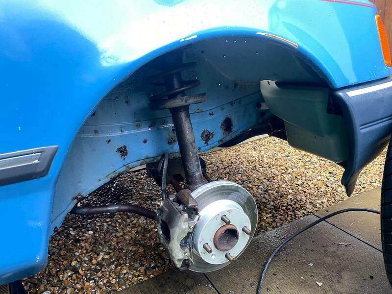

The plan was to pressure wash the underside and arches before doing any remedial work to the bodywork. I started by removing the battery and covering up the complicated* electronics and the carburettor.
I put the wheels back on, dropped and pushed the car out onto the driveway. Once there, I jacked it up again and took the wheels off.

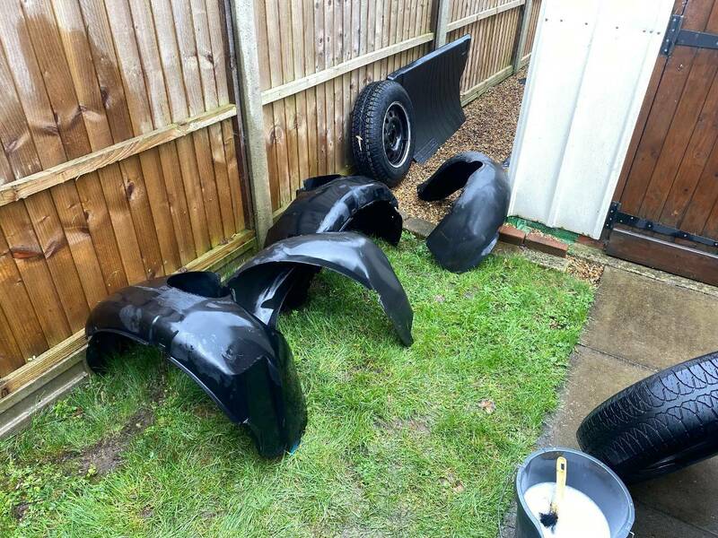

All five wheels and the arch mouldings were also due a good scrub.

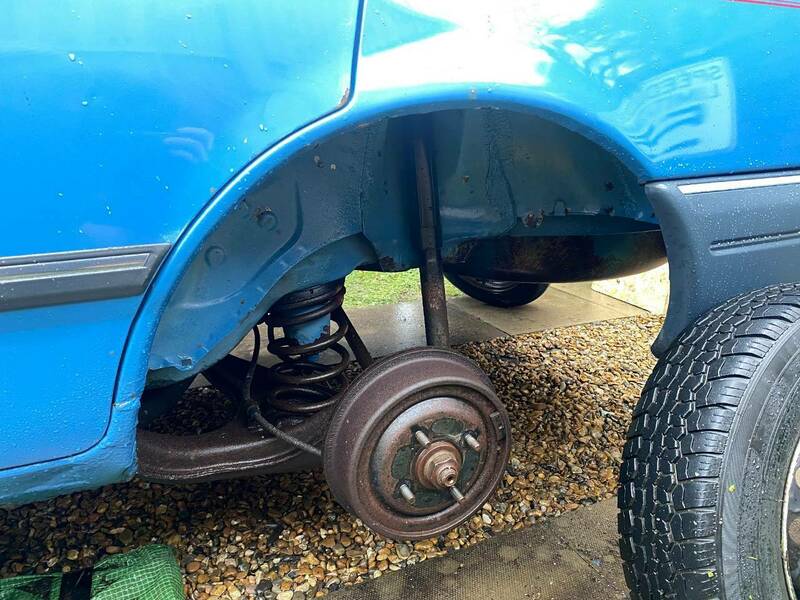

An hour later, the underside was clean. Surprisingly little crud came off, the underside was cleaner than I expected and much cleaner compared with all the other cars that I treated to the same process in the past.
Bits of flaky paint came off but what is left now is not just solid but also clean.
The plastics responded well to the pressure cleaning and a fair bit of the blue overspray also came off in the process. The road wheels will need a lick of paint, however the spare looks great. It's also fitted with an unused Good Year tyre.
I let the underside dry for a while before I put the wheels back on again. I pushed the car back into the garage, where I jacked it up AGAIN and took the wheels off AGAIN!
I didn't have time for a proper inspection but first impressions are good, everything looks a lot cleaner.

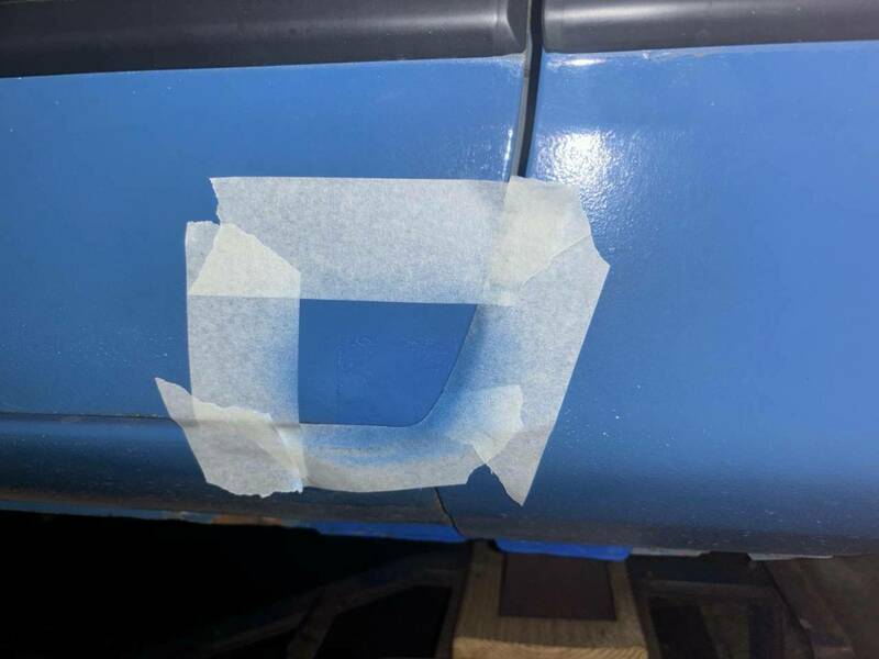

I spent half my Sunday (yesterday) stripping flaking paint and underseal and preparing surface corrosion for undersealing and painting. I used a circular wire brush attachment fixed to the end of a drill, which made the process a lot easier and a LOT more messy. Good news is that I did not uncover anything nasty. I didn't take any photographs as you have all seen the affected areas before.
The idea was to paint over the underside and low level exposed areas with the matched blue Rust-Oleum paint. I painted a bottom corner of a door and this morning, once the paint had dried, I found it to be a completely different  shade of blue.
I then sprayed over the same patch with the matched aerosol and...
Just about a perfect match. Not bad for a colour that is a bitch to match.
I popped back to the paint shop today, showed the man who mixed the paint for me the above photos and he added some grey and yellow to the mix, to make the colour brighter. When I got home, I applied some of the newly mixed paint and it looks a better match but I won't know how much better until the paint dries. The plan is to use the brush on stuff for the areas that aren't so visible and use the aerosol to repair the damaged paint higher up along the flanks, then cut and polish the lot.
