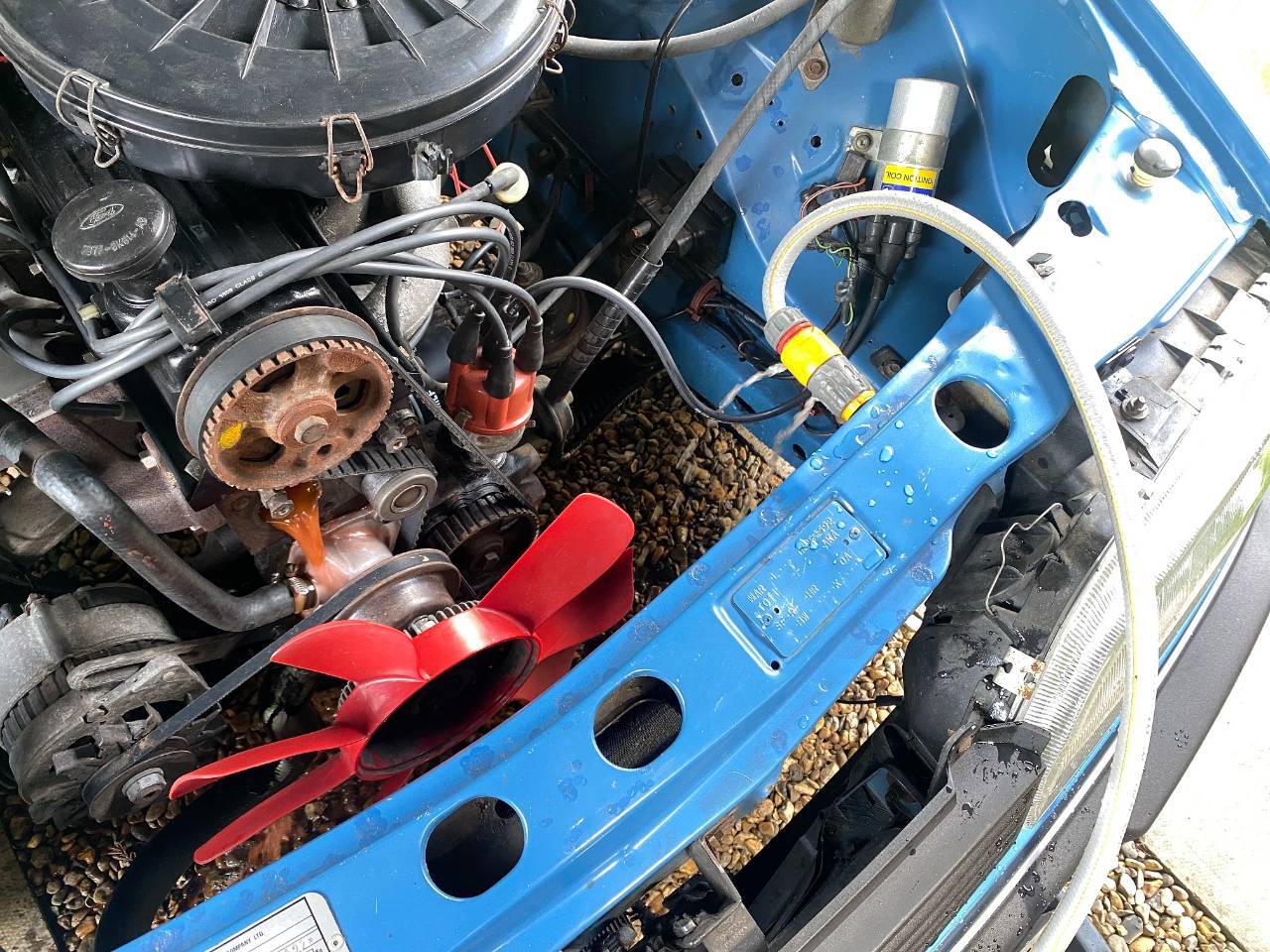

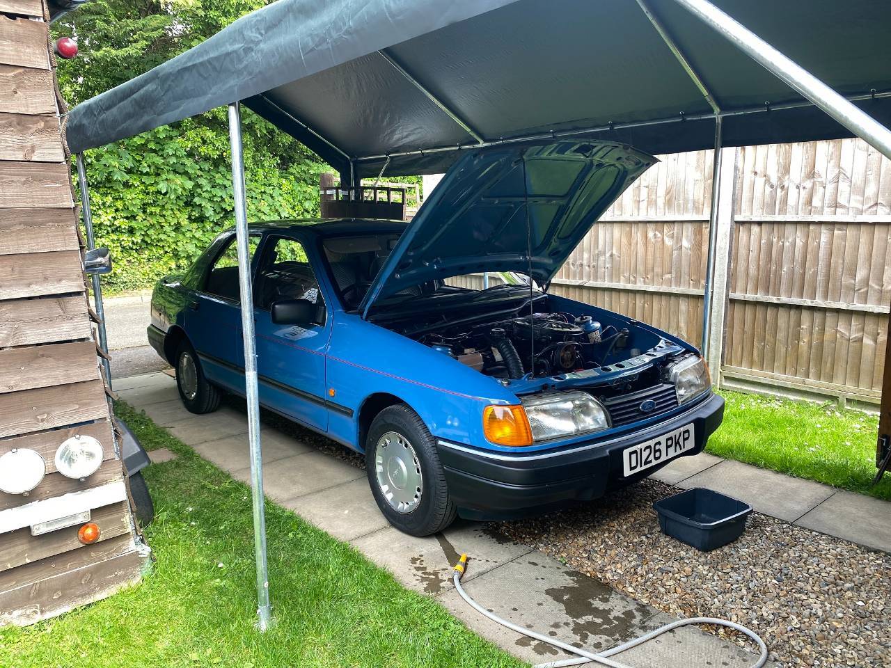

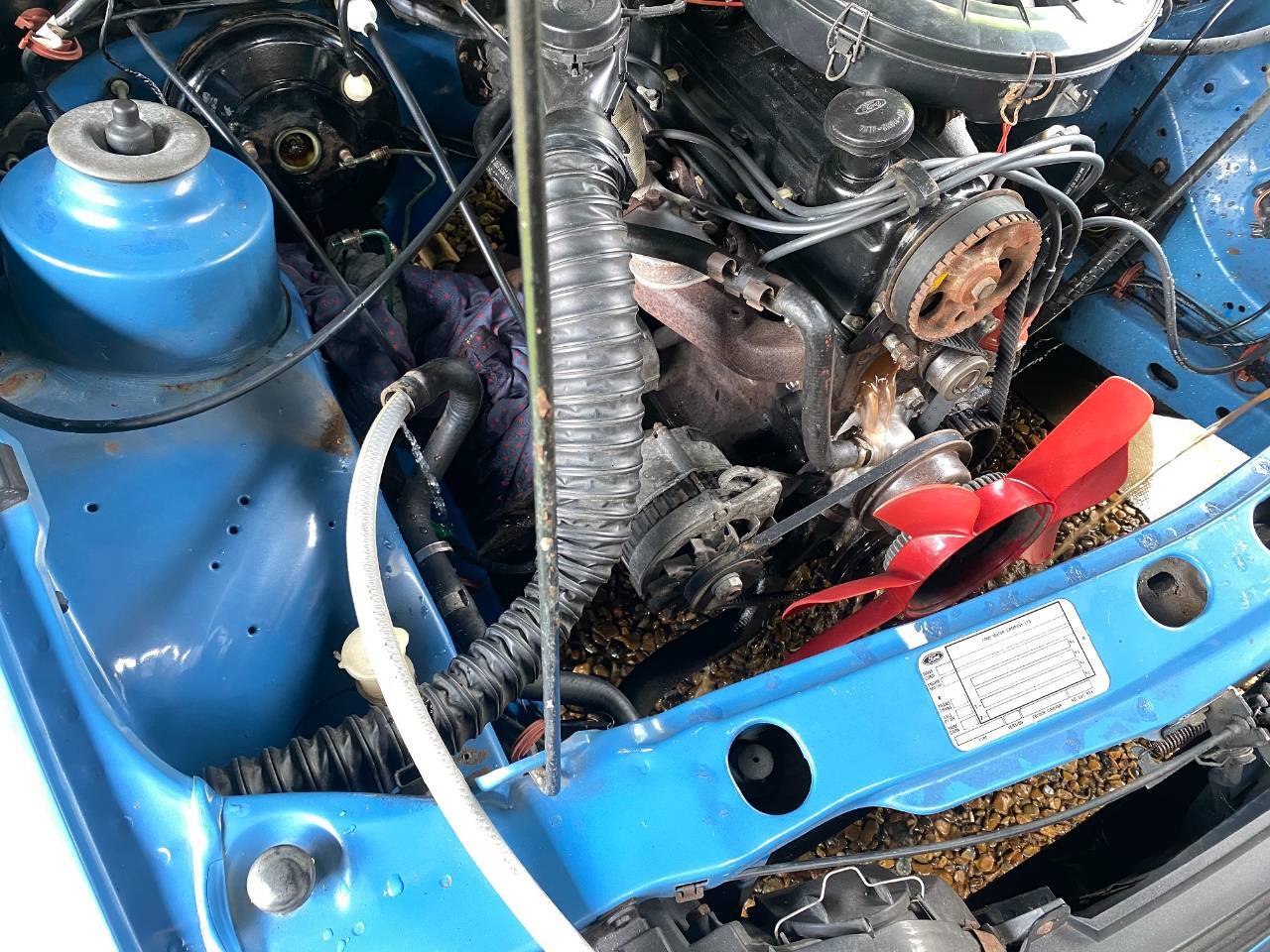

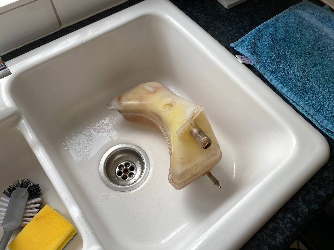

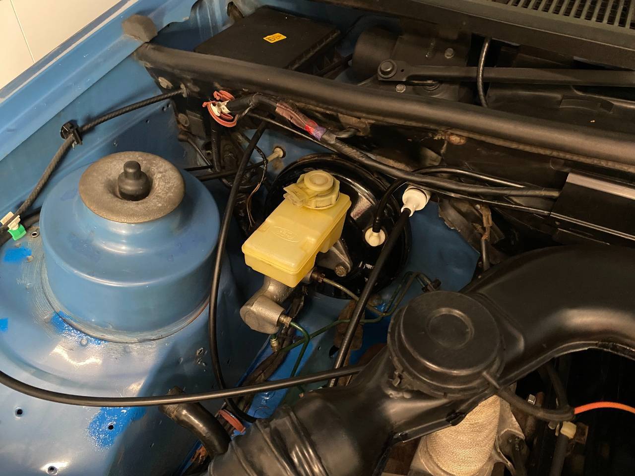

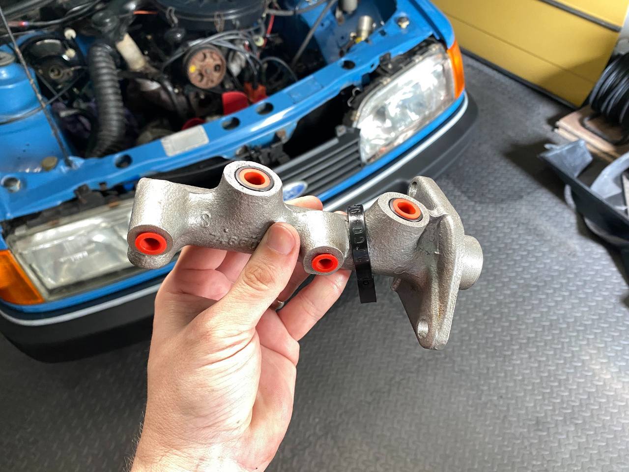

Peter C Posted May 10, 2024 Author Posted May 10, 2024 I kicked the E46 out on the road and pulled the Sierra out of the garage. The car port keeps the rain off but also provides desirable shade on sunny days like today. Plan was to flush out all the old coolant. I put a hosepipe into the top of the radiator, which caused a lot of mucky coolant to drain out from the thermostat outlet. By putting the hosepipe into the overflow pipe, more mucky stuff came out from the thermostat outlet and the top of the radiator. I repeated this process until fresh water was coming out of every orifice. The stained header tank will be soaked in vinegar overnight. Should look fresher in the morning. As our postman is taking the piss by not turning up for a third day in a row, the thermostat housing gasket hasn't arrived so I can't reassemble the cooling system. Instead, I cracked on with installation of the refurbished brake master cylinder, which arrived this morning (via a courier). Re-fitting it was a doddle. I got the Sierra up in the air and removed all four wheels and loosened all four bleed nipples. As we have friends and family over this weekend, chances are that my faithful assistant (my wife) and I will not have time to bleed the brakes until early next week. Not to worry, the weather forecast for next week is gash. tooSavvy, adw1977, Coprolalia and 13 others 16
egg Posted May 10, 2024 Posted May 10, 2024 Wow, that refurb has transformed it. Tenmil Socket, Wibble and Peter C 1 2
Peter C Posted May 10, 2024 Author Posted May 10, 2024 3 hours ago, egg said: Wow, that refurb has transformed it. £,£££ egg 1
Peter C Posted May 10, 2024 Author Posted May 10, 2024 I ❤️ my Ford. Shite Ron, Rightnider, egg and 2 others 4 1
N19 Posted May 10, 2024 Posted May 10, 2024 It's a fantastic car, really enjoying this thread. Maybe could invest in one of those one-man bleeders? I bought one as it got very boring trying to arrange for a friend or neighbour to pop down to help with bleeding bakes. Peter C 1
High Jetter Posted May 10, 2024 Posted May 10, 2024 2 hours ago, N19 said: Maybe could invest in one of those one-man bleeders He's already paying for a wife, ffs! cort1977, Peter C, GrumpiusMaximus and 6 others 9
