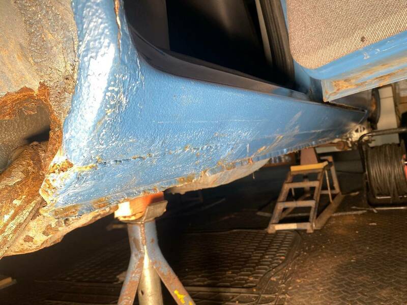

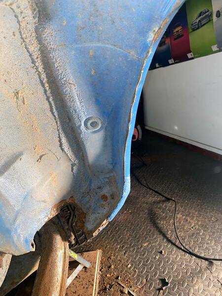

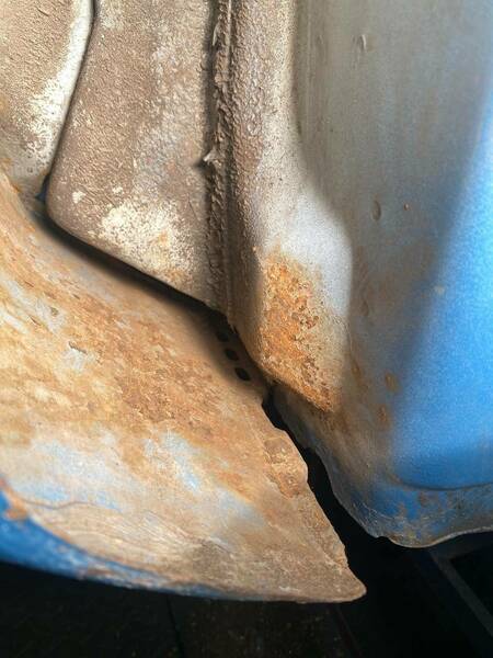

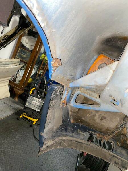

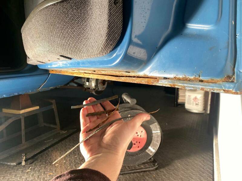

I forgot to say that in summary, the Sierra is totally solid and doesn't need any further welding. I will deal with the rust proofing and minor cosmetics, then cut and polish the paint and see what I end up with. Hopefully something that is solid and looks presentable.

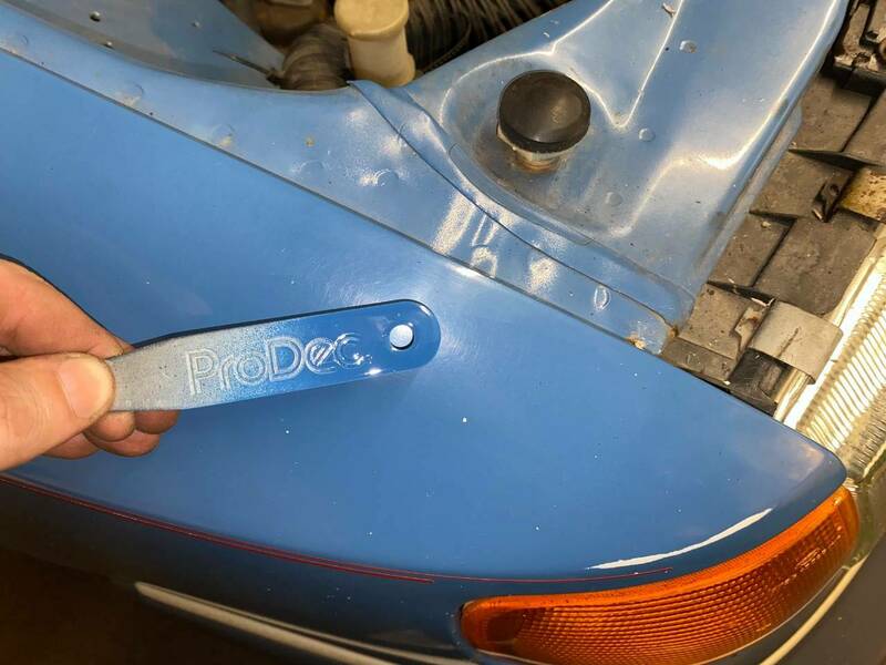

Looks a very solid car. The paint that has been worn off by the covers could be repaired by a smart repair, or you could get an air brush and have a go, lots of thin coats is the best way to blend it in.
Thinking about the paintwork,one of my customers has a neighbour who does smart repairs.He always seems to be doing quite large areas under a gazebo on his drive.This is usually with metallic paint on some quite expensive motors.If you treated the job as a collection of smart repairs,could you not do the whole car over a period of time,using those aerosols.Not sure how many you'd need,but a hundred quid would buy a dozen or more.If they're all from the same batch,no need to worry about matching or blending in.Cue comments about" rattle can resprays"! However, I've found modern aerosols to be pretty good.Sadly I'm old enough to remember when cans contained some vaguely coloured thinners that either ran or clogged.

Late last year I had to repair and respray the tailgate of a car that I was leasing and handing back. It was a dark grey metallic. I took my time and achieved a perfect finish. The guy who came to inspect and collect the car had no idea that part of the tailgate had just been rattle canned.
I wouldn’t fancy respraying a whole car with aerosols. It would take too long and cutting the paint afterwards to get a decent finish would take ages.
I am confident that I will achieve a satisfactory finish by doing localised repairs and cutting back the rest of the paint.

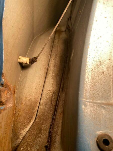

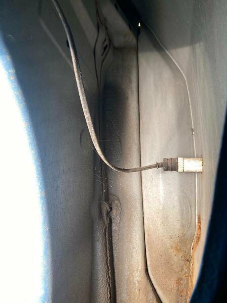

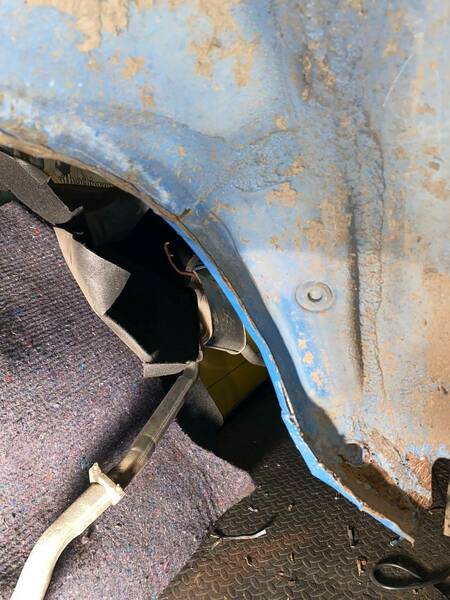

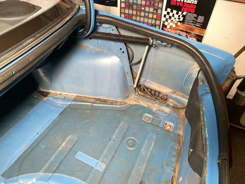

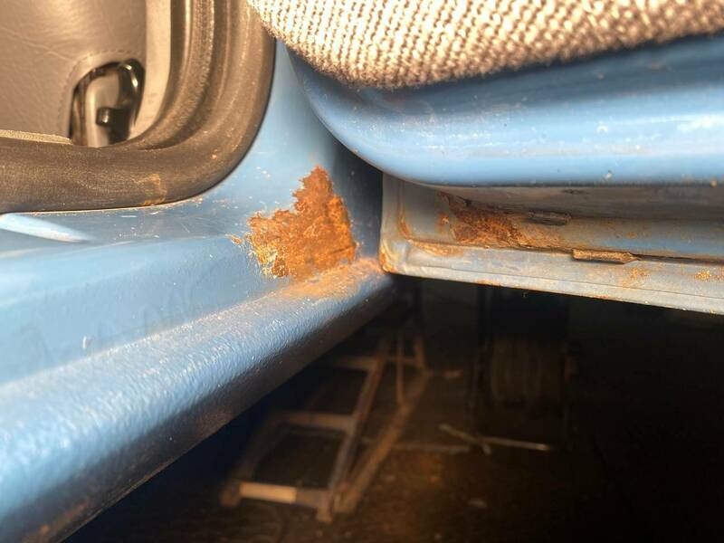

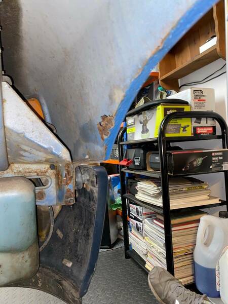

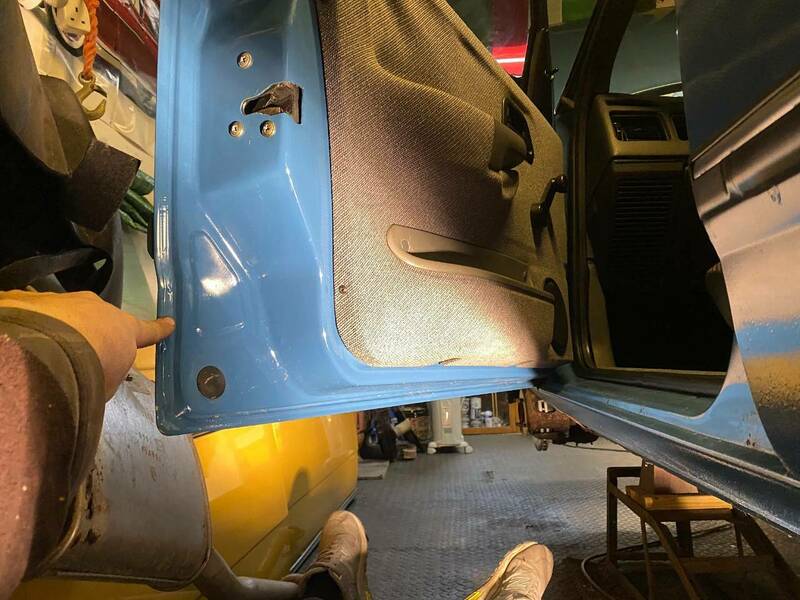

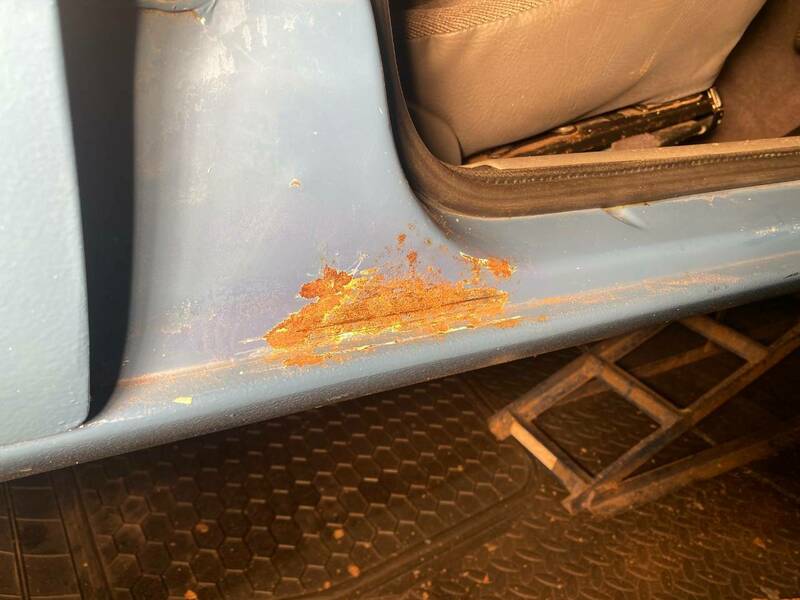

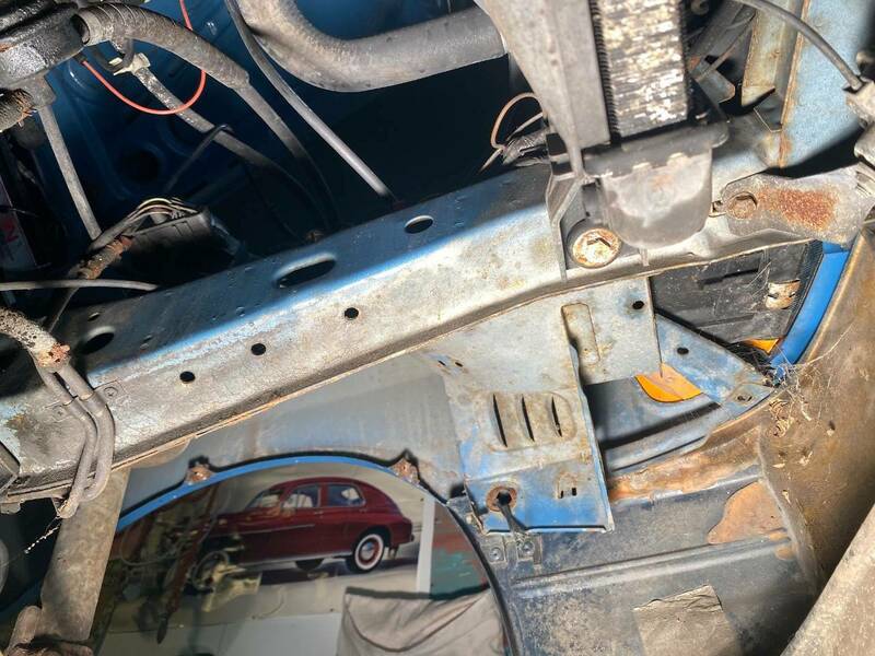

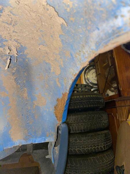

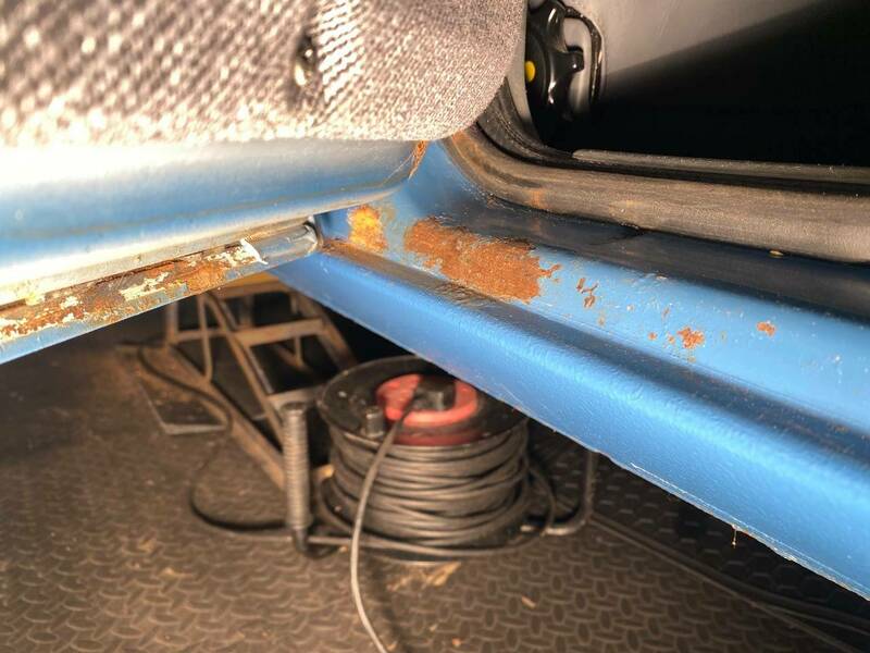

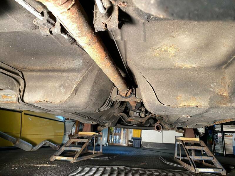

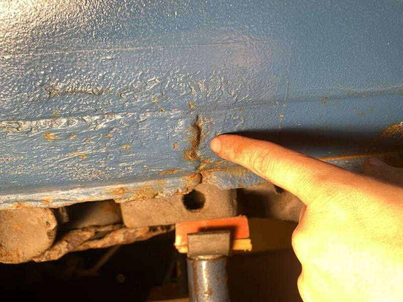

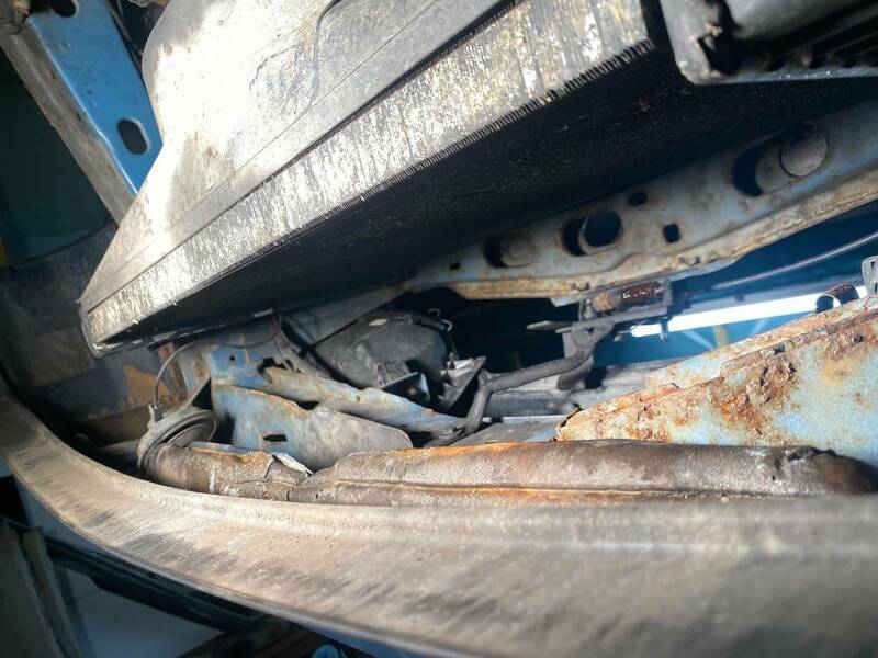

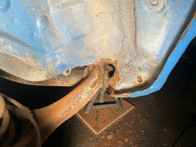

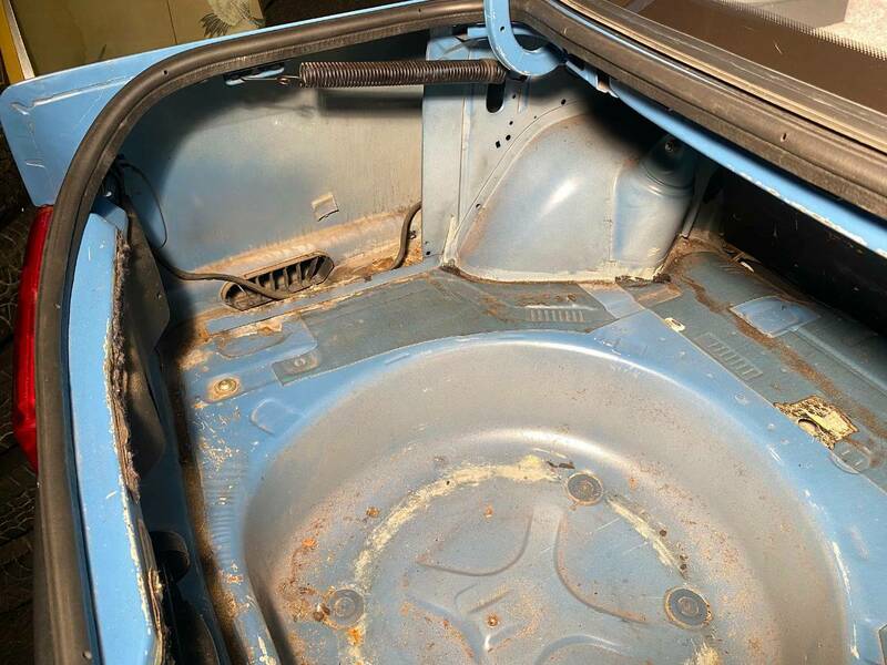

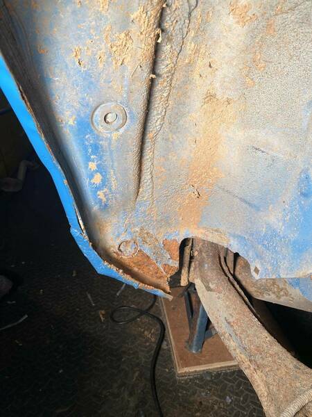

Plan for today was to have a good poke in every nook and  cranny and check for rust
Nice to see the hotel gave you a late checkout for your birthday too
23 hours ago, Peter C said:
I checked the VIN number, it's the same on the V5 as it is on the car. A matching numbers classic Ford,
After two hours of poking, all I have is one dust pan mostly full of dirt. Not bad for a Ford.
You absolute winner.
A not stolen not rotten old 4 door ford.
Good work.

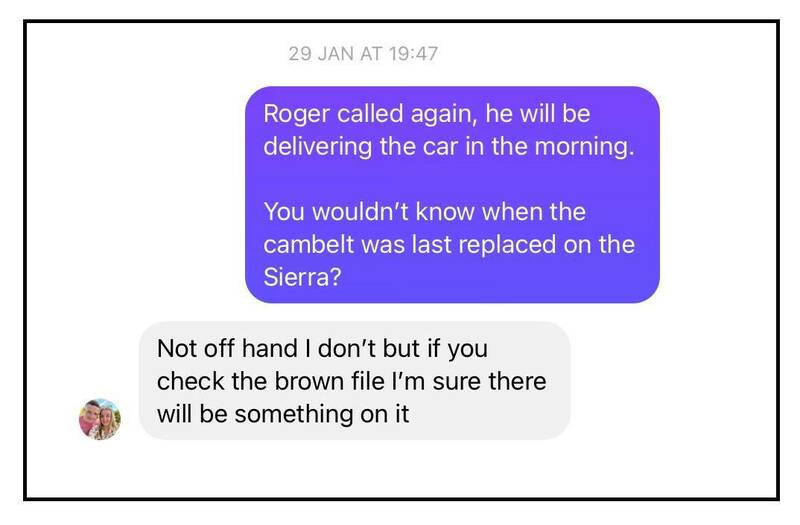

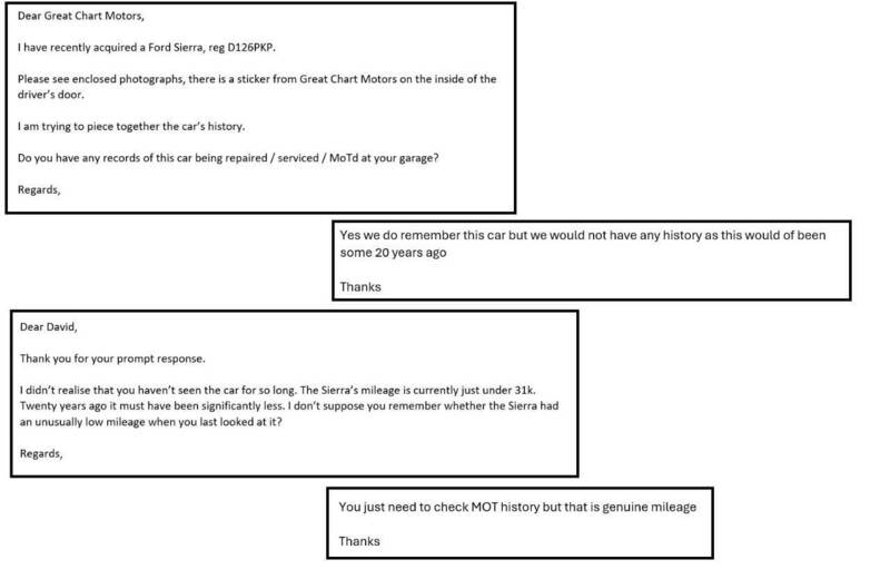

Two pointless conversations.
First, with the seller, via Messenger, dating back to before the Sierra was delivered.
Safe to say there is fuck all of value in the brown file.
The second is an email exchange between me and the garage whose name I found on the door sticker.
I'm none the wiser about the mileage but it doesn't matter now, I'm moving on.

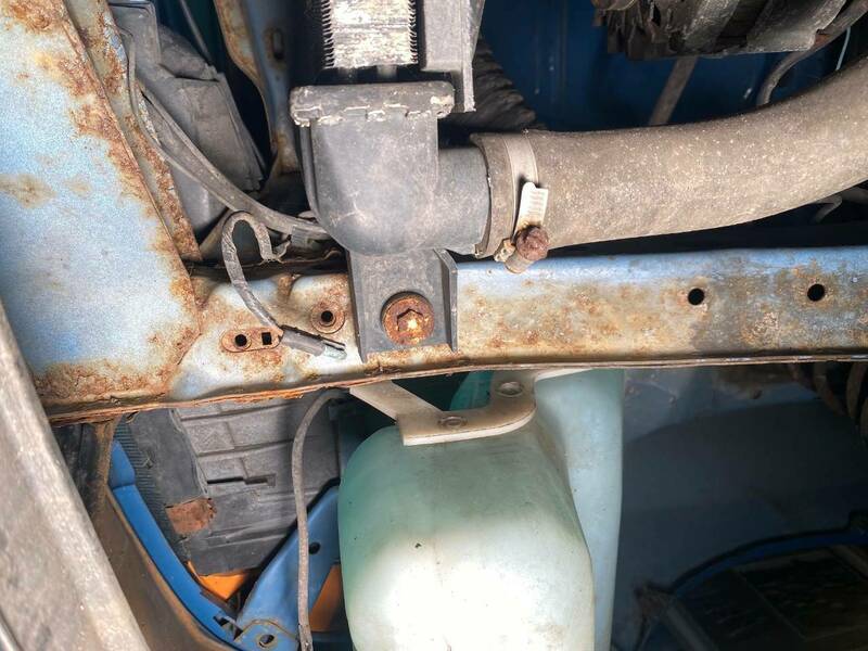

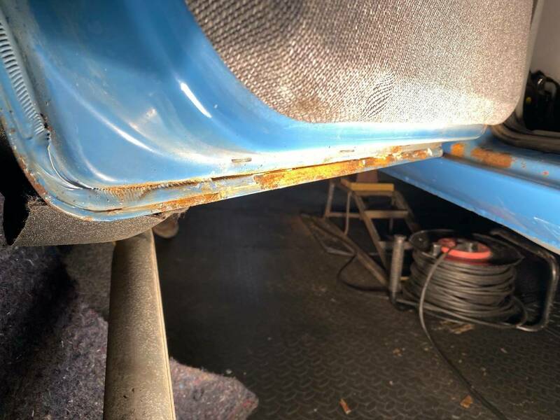

That car looks like it's got into your hands just in time. I think it probably was very clean and rust free and has been sweating under a cover for a couple of years growing surface rust on everything.
If you use fibreglass filler to cover the welding  up first it seals the pin holes int the welds a bit better and is generally more robust at keeping moisture out.
3 minutes ago, Peter C said:
It's right if the Sierra clocked up 29k miles between 1987 and 2006.
It's not impossible really.
Always reminds me of a repeat customer when my Mum worked with Arnold Clark, an old lady with a K11 Micra, who only ever used it for going to the shops (about half a mile along the road) and it went once a year 20 miles to get the MOT done.
I think what we’re all trying to prove is that the car didn’t clock up 129k miles between 1987 and 2006. (or 229k)
I’m not a betting man but knowing what I do about Fords of that era, some of that knowledge coming from bitter personal experience, I would put good money on the mileage currently displayed being entirely genuine.
I think for the money you’ve done really well there, no welding required is a proper win on a Sierra. Just plenty of enjoyable painting/derusting jobs, those sills will look much better with some Shutz applied with a proper gun.
Possibly.
Bear in mind that clocking was rife in the 1980s and 90s and I imagine that adjusting a Sierra’s odometer is a piece of piss.

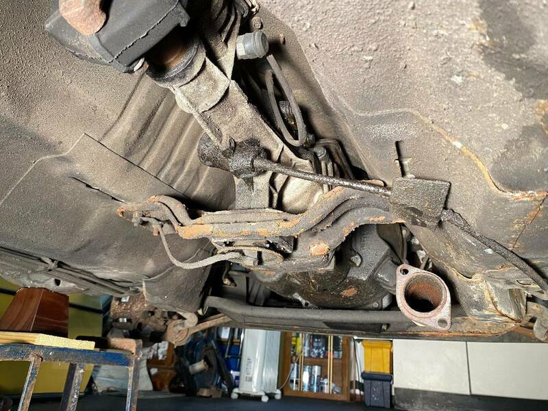

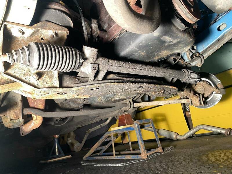

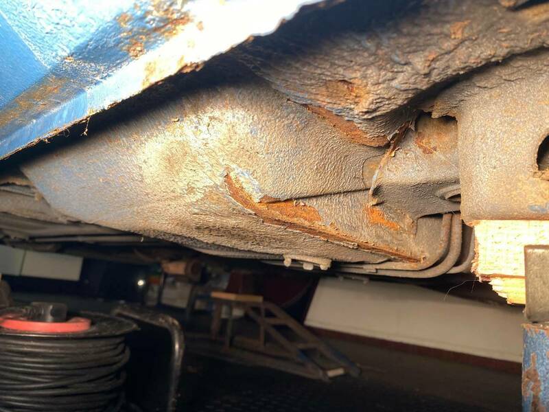

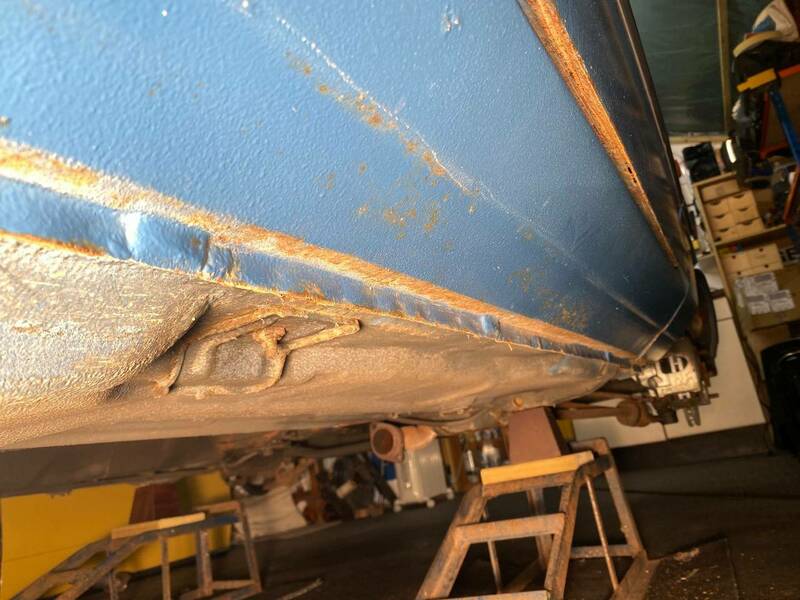

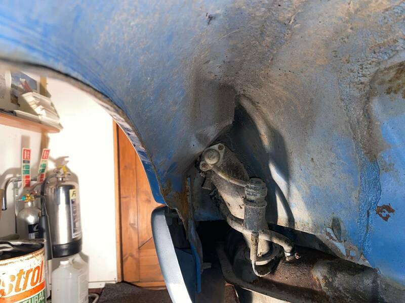

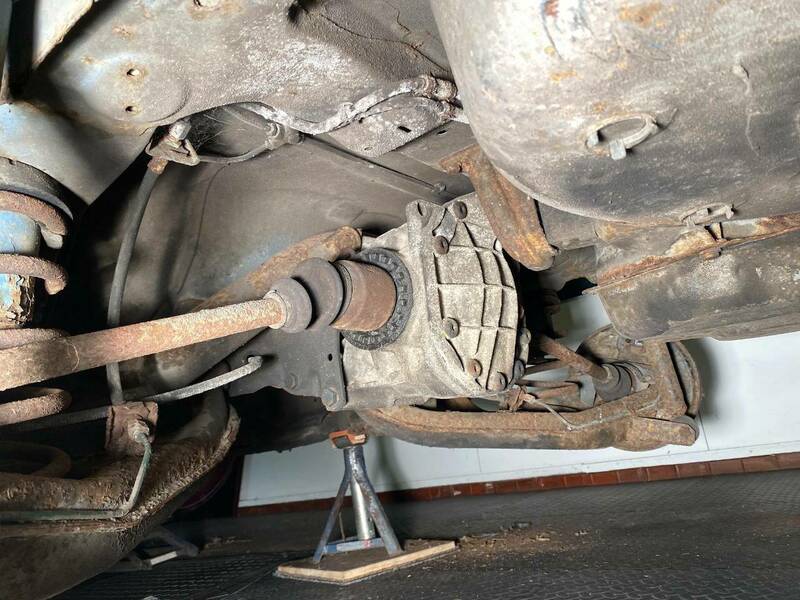

Going on the lack of rust I’d say yours sounds genuine. What are you doing the underside with? Waxoyl or similar?
Most of the underside is covered with a black sealant coating. Not sure if it is original but it is in perfect condition. In very localised areas, where the coatings have lifted, I will be applying a lick of Waxoil.
I don’t know if you’ve a compressor but it goes on eleventy million times better when it’s gunned on as opposed to those aerosols or pasting it on. Just my experience but if you can apply it on where it’s slightly dusty like yours is it seems to grip on better, that’s why I’d be inclined to not jet wash it as it will take some time for the seams to dry out.
