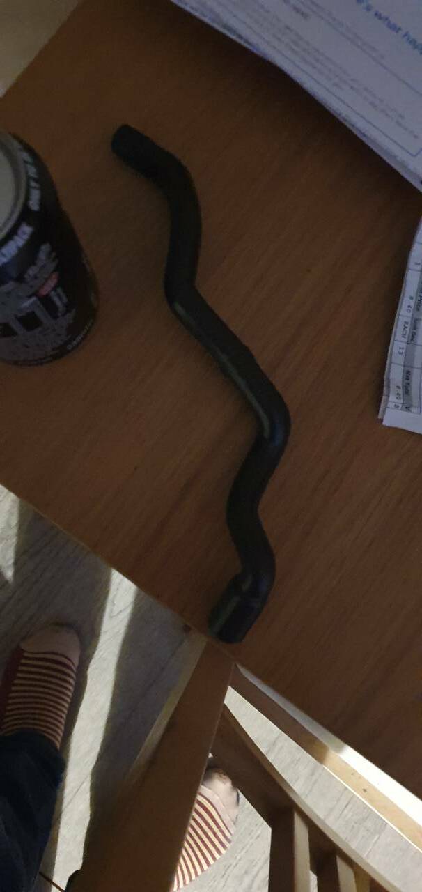

wesacosa Posted November 13, 2023 Author Posted November 13, 2023 I ordered the $12 vacuum pipe and it arrived today. I was expecting some huge pipe that ran length of engine bay but ended up with this SiC 1

SiC Posted November 15, 2023 Posted November 15, 2023 Check the part codes on the MAF but this seems common for a lot of Mercedes (including my E320) https://www.ebay.co.uk/itm/314871498387 That seller is legit genuine Bosch parts and often come up on the eBay 10%/15%/20% codes when they are around. They're a lot cheaper than ECP/GSF. The improved fuel economy from the new MAF on my TT very quickly paid for the price. wesacosa and chaseracer 2
wesacosa Posted November 15, 2023 Author Posted November 15, 2023 1 minute ago, SiC said: Check the part codes on the MAF but this seems common for a lot of Mercedes (including my E320) https://www.ebay.co.uk/itm/314871498387 That seller is legit genuine Bosch parts and often come up on the eBay 10%/15%/20% codes when they are around. They're a lot cheaper than ECP/GSF. The improved fuel economy from the new MAF on my TT very quickly paid for the price. ooh good spot thanks. I have used those guys before for other bits

SiC Posted November 16, 2023 Posted November 16, 2023 That 20% eBay code expires tonight if you did want to get a MAF anyway. Fuel trims might be going bananas with it connected and a big vac leak. Also intake temperature sensor is usually the one in the MAF and could be doohickey too. Definitely get that pipe changed before going too deep into the codes though. From the Youtube videos of it being replaced, they look to split really badly along their length making a massive vac leak. wesacosa 1
wesacosa Posted November 16, 2023 Author Posted November 16, 2023 7 minutes ago, SiC said: That 20% eBay code expires tonight if you did want to get a MAF anyway. Fuel trims might be going bananas with it connected and a big vac leak. Also intake temperature sensor is usually the one in the MAF and could be doohickey too. Definitely get that pipe changed before going too deep into the codes though. From the Youtube videos of it being replaced, they look to split really badly along their length making a massive vac leak. cheers. Yeah I think its more likely the pipe so will try that first. If not I will see if another eBay code comes along. Most of the reading suggests its much more likely the pipes
