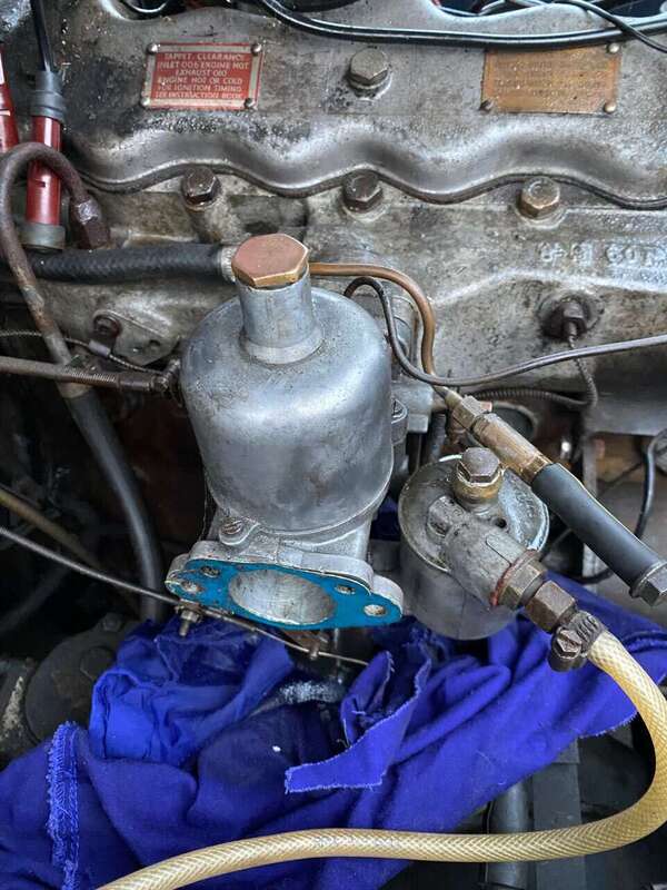

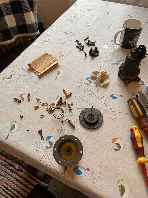

I’ve been tinkering away in this thing on and off but still haven’t got it running yet. The fuel pump was taken to bits and combined with parts from another SU pump I had in the scrap pile and retrieved after a few months sitting outside behind the garage. Amazingly I’ve ended up with a functional pump somehow. I’d never worked on these before but once you get stuck in they’re amazingly simple and have loads of YouTube guides to support any tinkering efforts.
Fitting the pump revealed the next hurdle- fuel pissing out of the carb throat. The carb as allegedly been rebuilt but hasn’t been set up and was only loosely bolted to the engine. The P4 drivers guild FB group has the general opinion that it’s probably float chamber related so that will be my next port of call, although a brief investigation seems to this the float and valve working at least to some  extent so I’ll do some more digging. Presumably the new plugs I fitted are now covered in ATF and petrol. There’s going to be a real smoke show when this thing finally fires up!

Sort the carb, clean the plugs, turn the key.
Please change that hose before putting it back on the road! That stuff is not suitable for fuel.
The floats can become damaged and let a little fuel in and thus not float properly - so take a careful look.

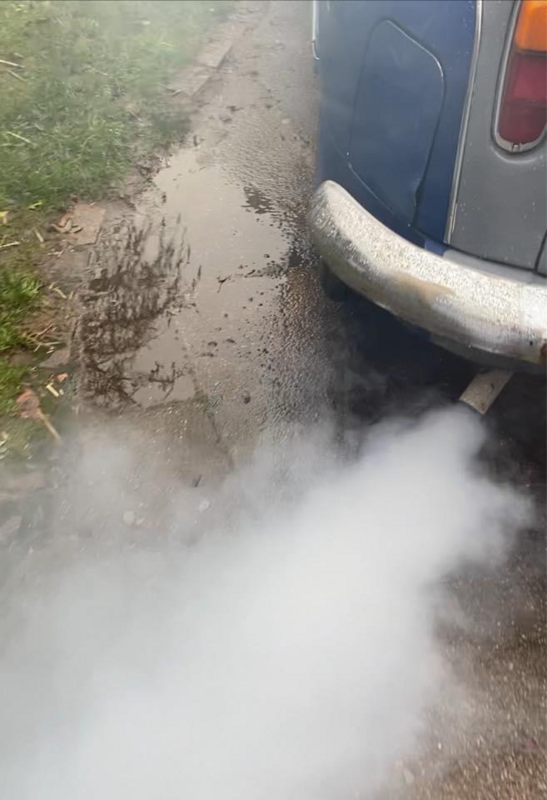

Guess what everyone? It’s only running! The valve in the float chamber was fettled and seemed to stop the issue with petrol pouring all over the place. A fully charged battery was added, the fuel system primed and after some extended cranking the engine finally burst into life!
As expected tons of oil smoke came from the exhaust, thanks to the ATF and diesel used to free off the seized engine but the smog soon cleared and it seems to be running really well.

The float chamber is still randomly over filling and spraying petrol out all over the place, I’m not sure if the float  valve is sticking open or the fuel pressure is too high or something but a tap on the float chamber with the handle of a screwdriver fixes it. Obviously this needs to be sorted before it hits the road. There’s also a coolant leak which I’m hoping is a hose clip rather than the new water pump fitted by the previous owner. I can see there being quite a bit of snagging once this old crate hits the road again.

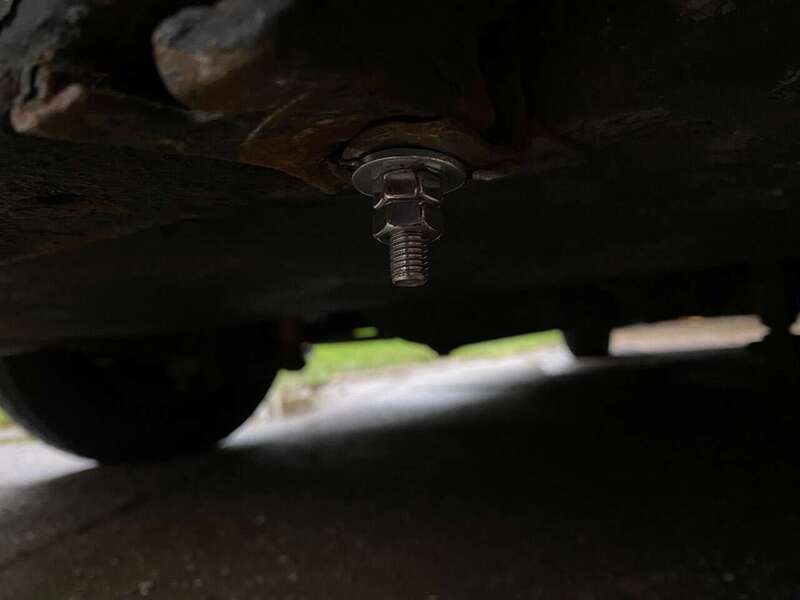

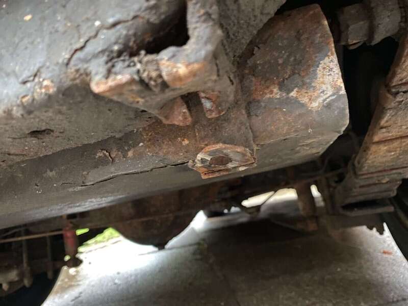

Another couple of jobs completed. The float chamber valve was removed, inspected and seems to be now working, also the rear mounts for the fuel tank were hanging off. I’m not sure what happened that resulted in this damage but both mounts were deformed and had been pulled away from the chassis, maybe someone attaching a tow rope to one of the mounts? Anyway. They were carefully hammered back into shape and new fixings added. A maiden voyage was planned on the actual road but thanks to all this bloody rain we’ve been having it’s been curtailed until a time It isn’t pissing it down. I absolutely hate the U.K. weather.
