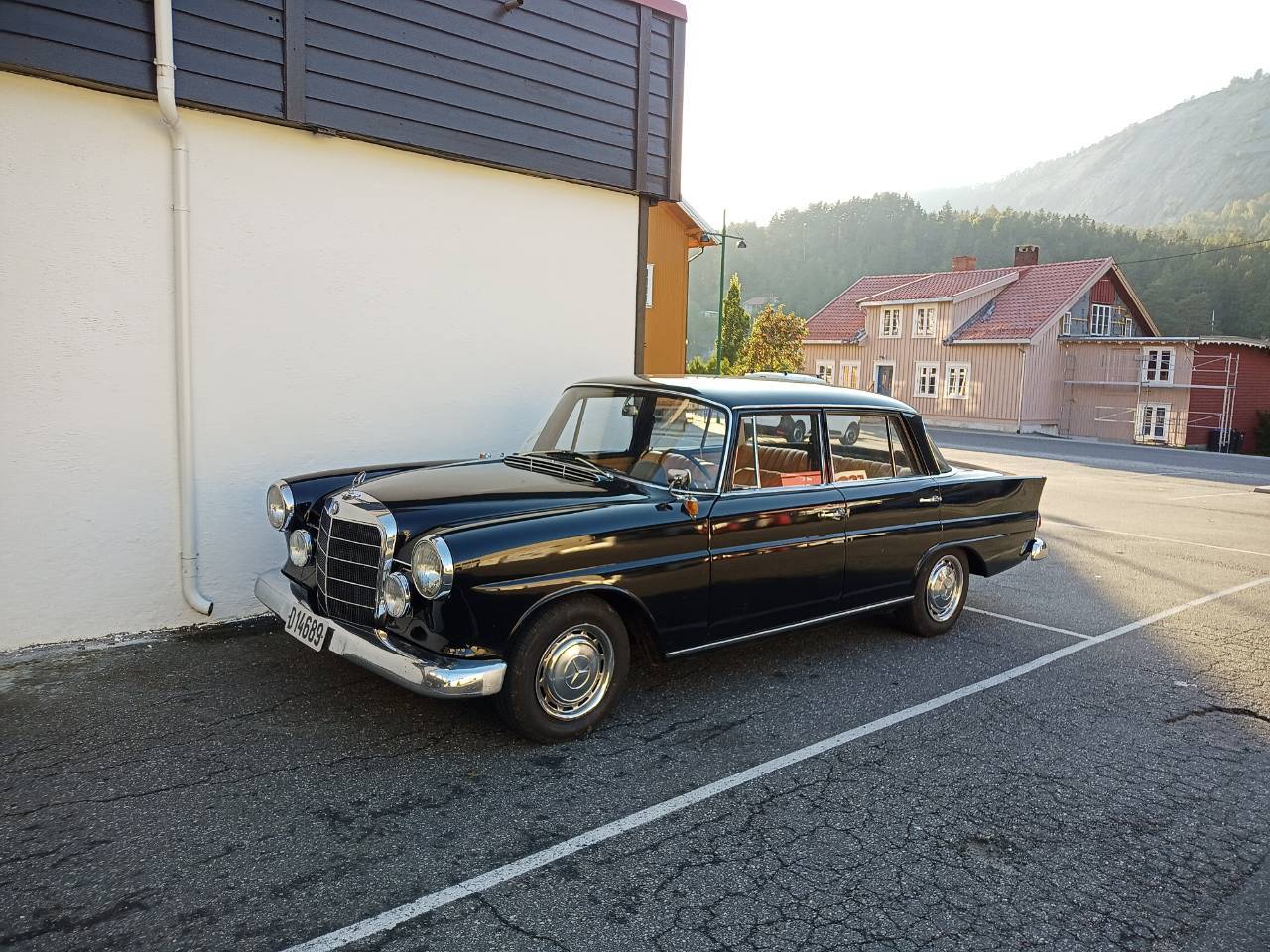

It's been a bit of a crappy week but a good drive on a Saturday night on empty roads helps make it better.
31 minutes ago, Dyslexic Viking said:
Haven't had it out in low light before so some pictures.
God that car is cool in a way (to my eyes) that only old Mercs can be.
Lovely motor.

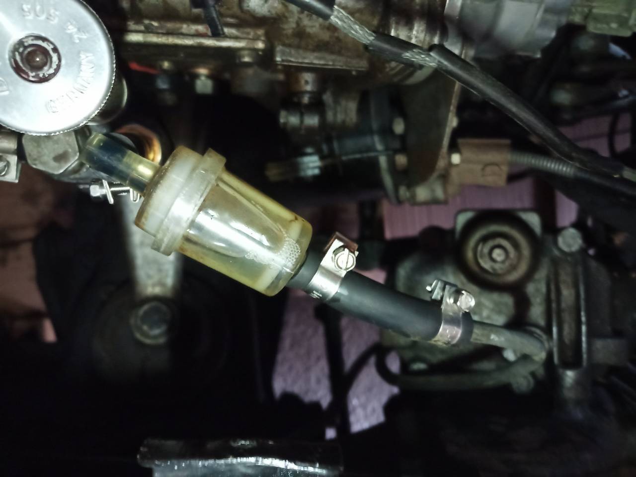

First problem of the season. I noticed yesterday that the engine was down on power so checked today and as suspected there is air in the fuel system. Don't know where it comes from but checked all hose clamps and was able to tighten some except one on the return which was replaced. But then an even bigger problem came, the bleed screw on the diesel filter snapped off but luckily I got the rest of it out.
I replaced it with a regular bolt, which doesn't work properly, but there is still air in the system and I don't understand where it is coming from, I hope it's not at the hoses at the tank, because then the tank has to be emptied and there are about 50 liters in it now.
New bleed screw is ordered and will hopefully arrive within a week as there is a maximum of 4 to 5 weeks left in the season. And when it comes, I have to try to find out where the air is coming from.
So this is down until this is fixed.

I got the new bleed screw and had the fuel system looked over yesterday. One hose clamp had loosened again which is strange, took and tightened it and put another hose clamp on and bled the system and left the engine on idle for a while and it was fine now.
Took this for a drive today and it seems that full engine power is back so the air problems seems  to be just the one hose clamp. I need to get better at checking the hose clamps more often.

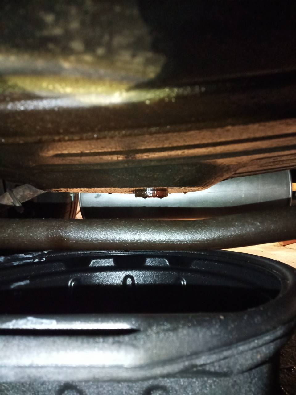

Looks like I was lucky this one went into early winter storage this year.
When I came into the garage last week it smelled of diesel and there was a big wet stain under this and after putting a container under the tank it has been confirmed now that the fuel tank is now leaking diesel. There are about 60 liters of diesel in that tank now, so the plan is to buy hoses and a 12v pump and pump the tank empty and then see what happens next but I may need a new fuel tank now.
And the drain screw is fully screwed in but I'm not sure that's where the leak is, as it could just run down and collect there.

That's good to know. I'm considering if I can take the coolant system pressure tester kit I have and use it to pressure test the tank to find leaks as this would be an easy way to do this.
I've done some research and Mercedes has done some weird things with the fuel tank on these.
What I think is a drain plug is not that it is a filter/screen thing for the fuel inlet. And the only form of gasket this has is an o-ring. So it could just be the o-ring has failed. Picture of this below.
And where this goes into the tank is even weirder. Yellow arrow is where this is screwed into the tank on the underside. The hole where the red arrow points to is where it enters the tank and is on the inside and the blue arrow looks like the pipes to the fuel outlet.
So the fuel tank on these is a lot more complicated than I thought. And I'm wondering how bad this is on the inside and especially the filter as I guess it has never been changed or cleaned. So the first thing after the tank has been emptied is to try to get it out.
