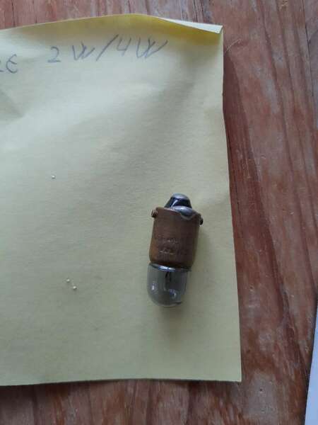

The MOT work has started
I'm glad I looked at the instrument clusters on these before i started this because I quickly found the wing nut holding it and after a bit of prying I got the instrument cluster out.
I'm very glad that Mercedes made this easy, I thought the dash board had to be disassembled.
And as suspected, the light bulb for the high beam warning light is dead. Have to get new ones and then a defect from the MOT is fixed
