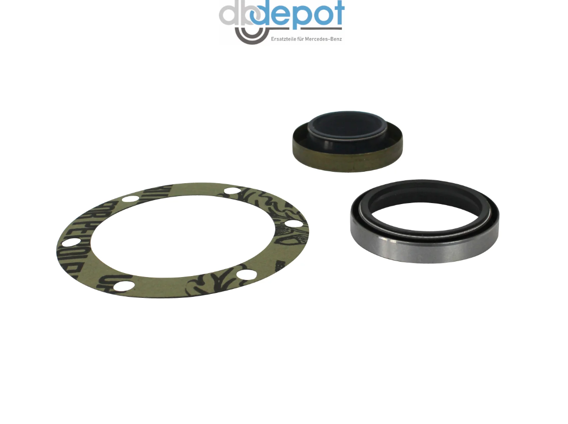

This is a seal kit on the axle against the brakes. No rope seal.
I have those gaskets and wheel bearings for both sides. And the brakes have been fine and without oil contamination last time I checked as the oil just drips out and runs down the back plate and out a drain hole and then onto the rim. But I need to do something about this and would prefer to try to get help as I hate drum brakes so much and don't have a press.
Oooo!  If they are a lip seal from new, then you can just pry the old one out and shove a new one in.  there's a good chance that the one in there is the original from new, so a new one now should last until 2089.  (63 year lifespan, clearly!)

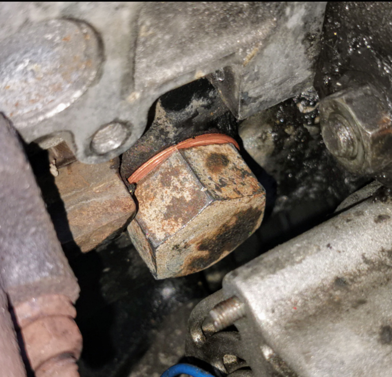

One question, has anyone here ever messed with the timing chain tensioner on an old Mercedes engine? Like W123 and older.
I let the engine idle for a bit today and noticed that the oil leak from the timing chain tensioner is bad now. And struggling to find any info on how difficult it is to take it off and put on a new gasket or o-ring. I assume the chain must be held tight while removing it but no idea how.

No idea if the diesels are different, but the chain tensioner on my S123 leaked like a sieve after I'd had it apart during a head change.  Originally they had a soft metal (aluminium?) washer behind it, which I nicked when reassembling it.
Couldn't find the part at the time anywhere - so went to my local hydraulics place and grabbed a copper washer with near as dammit the same internal diameter and thickness - worked perfectly.
If it's the same design removing the outer cap isn't a problem as the internals have a ratcheting mechanism so the tensioner itself can't move backwards even when the spring (which bears on that cap) is removed.  Backing the tension off requires the whole thing to be unthreaded from the block with a giant Allen key and dismantled.
The plunger is removed from the engine side and reinserted from the other end.  The mech only allows it to travel in one direction.
Caveat is I'm working on memories from 2022 here!  Also I've no idea if the same tensioner setup was used across petrol and diesel engines - and there's a 20+ year age gap.  Though Merc did seem to be fans of the "if it ain't broke, don't fix it" approach back then.

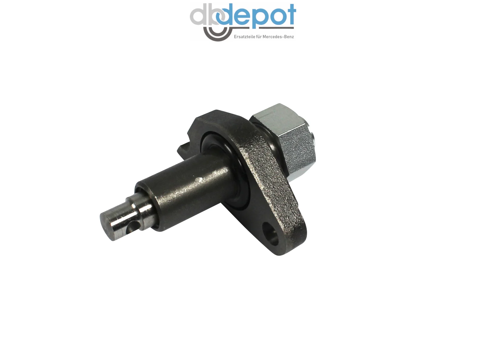

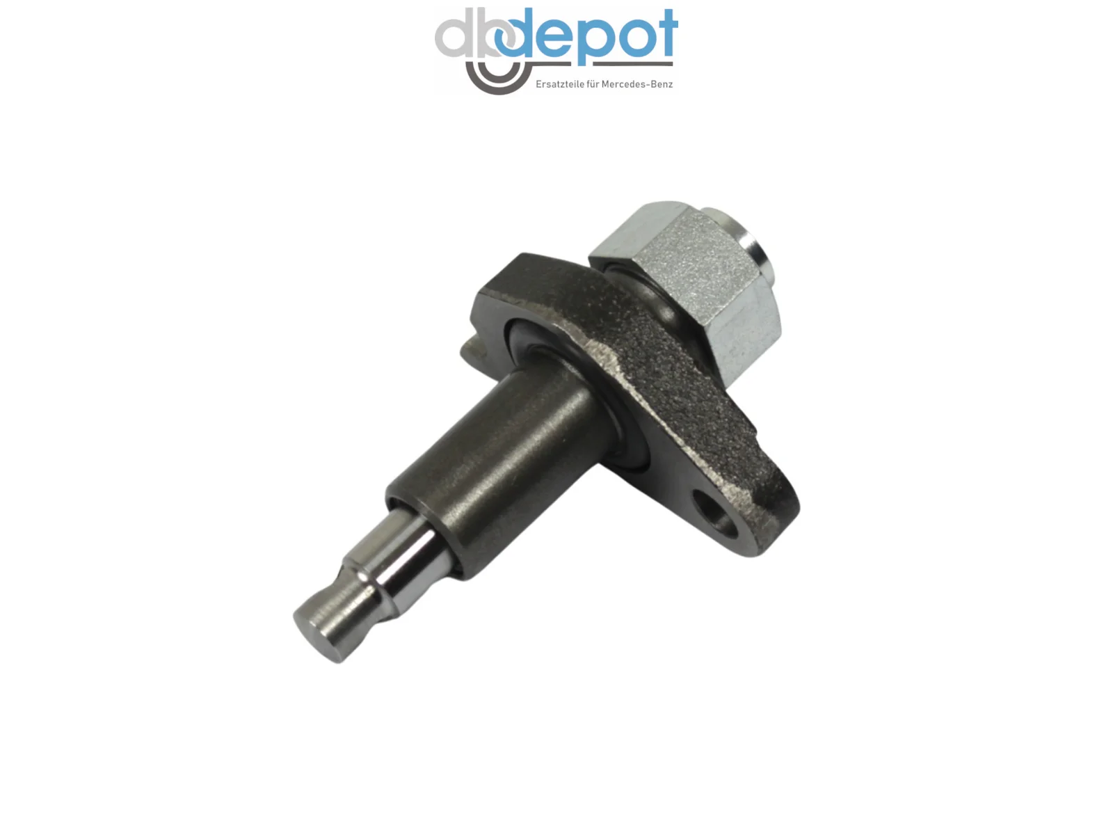

Thanks @Zelandeth that's good info, but unfortunately the timing chain tensioner on these is different.
Early version.
Later version.
And I have no idea what it has but I think the engine is newer than the car but I could be wrong. And I'm struggling to find any information on these on this. So I'm struggling a bit with what to do and I don't dare to disassemble anything here without knowing what I'm doing. But I'm going to study the timing chain tensioner on the car and see if I can see where it's leaking from.
Looks like both the older and nerwer version you have shown have an O-ring to seal them. Might be as simple as pulling it off and putting a new o-ring on. (fingers crossed anyway)
Yes they have but I'm so unsure about removing this as I would assume removing tension on the timing chain will lead to bad things happening.
Maybe there is a way to keep the timing chain tight while removing the tensioner, but I haven't found it yet.

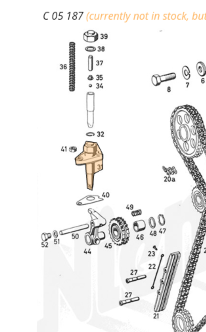

Looks like this might be your part.
https://www.niemoeller.de/en/ponton/w121-mercedes-190D-ponton/B110/050401/c05187-chain-adjusters
Or at least very similar.
Diagram gives a bit of a better view of how things fit together than just a photo in isolation.
https://www.niemoeller.de/en/ponton/w121-mercedes-190D-ponton/B110/050401#map-list
