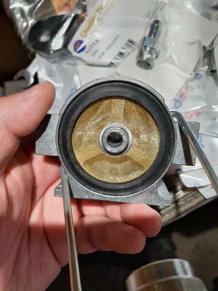

Got the water separator today and am very pleased, it is heavy and seems to be of good quality.
I bought with extra glass and 2 gaskets and a nice surprise is that these 2 are identical to the Volvo tractor that is here, which will make spare parts in the future easier.
This also has a screen/mesh which means that it will also work well as a coarse filter so I can then remove the plastic filter I use now. I can also take this out and clean it. The diesel enters through the hole in the middle and exits into a hole  to the right of it.

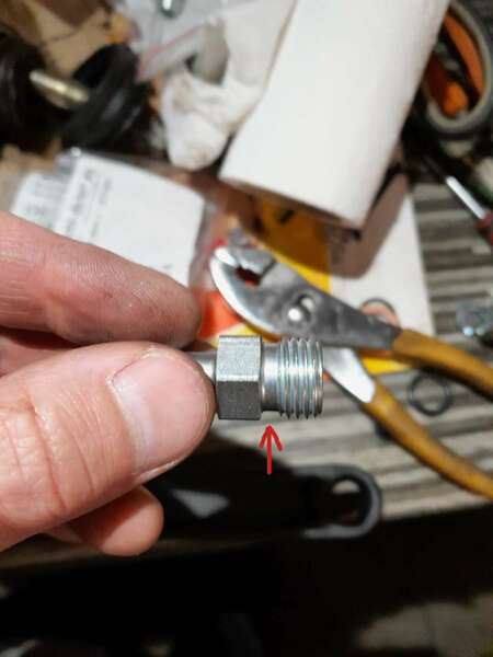

The only thing I don't like are the hose nipples I bought with it. There are some problems using copper washers with them.
And without copper washers, one can clearly see how little this covers the hole.
And the problem with these hose couplings is that they are not the same thickness all the way in the thraded part. In the center where the arrow points, there is a dump and this causes the copper washer to move too much and seal poorly.
So I want a hose connector where the threaded part is the same thickness all the way and maybe I have found some and they are ordered. The problem has been finding some as the water separator has M14 threads and it is most common with NPT on things like this so it has been difficult to find some.

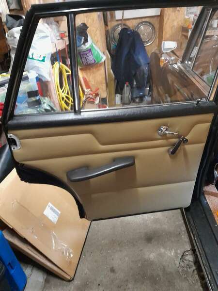

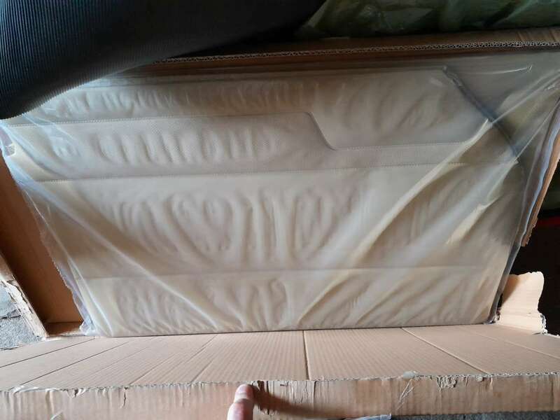

Got the new door panel/card today and they were lighter in color than what I got the impression of.
And they are a bit brighter than the seats.
So not completely happy with this, but probably just have to install them and live with it.

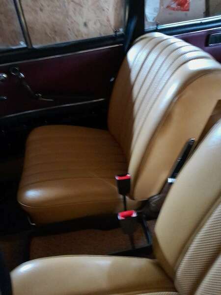

I probably should have put this off for another day, but I really wanted to get this done. I fitted the new door cards and the color was lighter than I thought when I bought them but it wasn't too bad. The car now has 4 colors inside and will get better and more pictures taken later as I  just came in and is worn out.
And am very happy with these door cards, they had a good fit and the holes in the back plate were already made so I could easily cut out the holes I needed in the fabric and the price was reasonable. Attaching a link to the seller think they have for other cars as well.      https://www.ebay.com/str/bamboliltd

As promised some better pictures.
Wish they were a little darker in color but I'm happy with it.

Well done mate, the interior looks fantastic. You've really done the car proud.
I think the difference in colour between the door cards and seats looks fine, as it's enough to look deliberate and so it isn't jarring. I think it would be impossible to get an exact match, and would actually have been worse if they were very close but not matching; at least to my eye!

Once you've enjoyed it for a while you could always change the colour of the door cards.
https://www.kolorbond.co.uk/vinylkote-paint-leather-vinyl/
I think the door card colour looks good. Similar to the seats/carpets it doesn't look out of place but different enough it's not a sea of a single shade.
