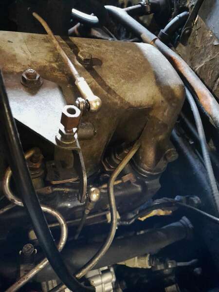

I received a package yesterday with new ball joints for the throttle linkages as the old ones are worn out. They were changed today.
The wear on this is extreme below is a picture of part of the throttle, this is the upper spring mount and over the years the springs have worn almost halfway through the mount.
Several parts in the throttle linkages are worn out and have a lot of slack in them, but it works.

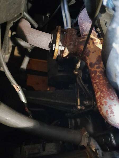

I also had to change the gasket on the air cleaner as the old one has disintegrated. I got the new one in the picture below, but I don't understand how they thought this would fit.
So I have to find a gasket that fits better. Pictures below of the air cleaner in case anyone knows of any gaskets that might fit.

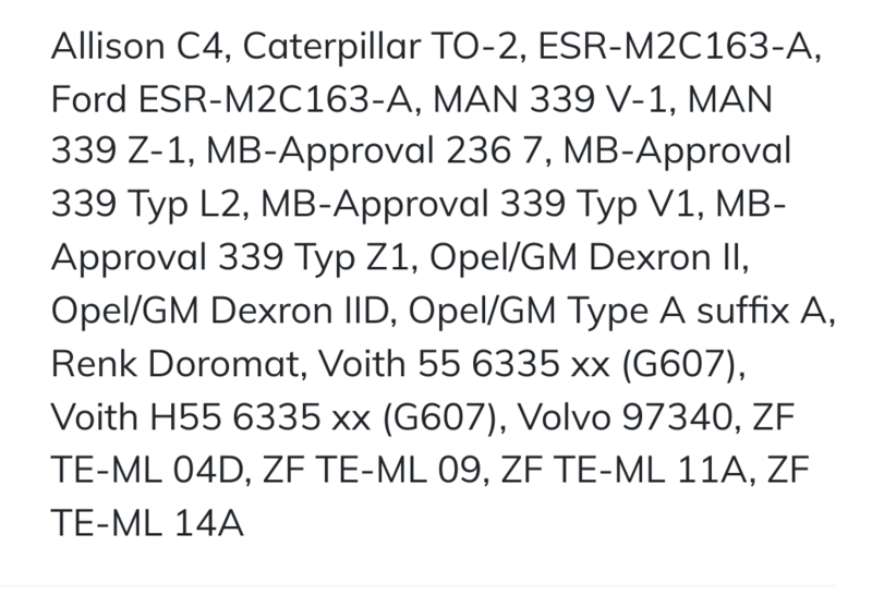

Thanks this was very helpful. I struggle to find the oils in that list at Mercedes and when I search for MB 236.2 at my Norwegian parts dealer I can't find anything on this either. So I think I will do as you say and go for DEXRON-III, it will probably work just fine.
But when I say that, when I searched for these oils I see that I can easily and cheaply get hold of Mobil ATF 220 which meets Dexron II and various newer Mercedes numbers so I think this would work well?
It also says that it can be used in manual gearboxes, so this seems promising.
