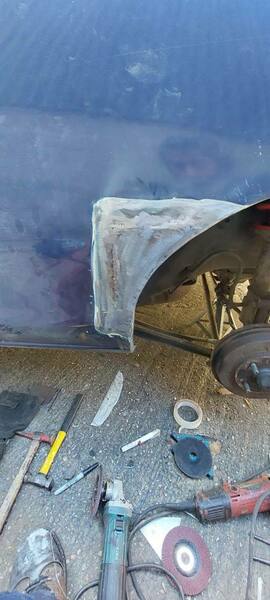

Well, I'm done.
Replaced the welding torch, and using co2/argon gas (which ran out really quickly!), 0.6mm wire - I just can't get the welder to behave. Spitting everywhere no matter what setting.
Put gaffer tape over the hole for now and will offer it up as an unfinished project, if anyone wants to take it on.
Will be 500 quid.
Or will offer someone money to come and do the welding for me!

Whereabouts are you based mate? Looks like you've done the ball ache part of making the patch panels up, seems a shame to bin it off over the welder. I'm in East Sussex and I have a spare welder that works well enough for this sort of thing, if that's conveniently close for you then you're welcome to a lend of it.
Southend, Essex.
Thing is, I can't tell if it really is the welder, or I'm just that shit.
It might be worth me trying back on the 0.8mm wire, but I've just lost faith in myself tbh.

If you could do it once then you can do it again. It's just a wobble

Deep breath fella - even keeping the same welder, settings and wire of 0.8I still have those type of days where it just won't go well.......you're outside too right? Wind not in a different direction or anything like that?
Walk away - sleep on it and come back after a cooling down period. It'll be reet
Have a little break and come back at it fresh. I tend to use 0.6mm on bodywork because 0.8mm has a habit of burning through too easily, so if you were getting on fine with .8 it's probably worth going back to that if you can.  I did have issues with some welding tips a few years ago that were supposed to be .6mm, gave up with them and bought some more because of spitting, poor wire feed, and the fact they seemed to clog up really fast so that might be what you're getting as an issue here.
It could also just be that your welder is being a tart, they do be like that.

Get some fresh clean metal to try a few runs and get the settings dialed back in again. I presume you've not accidentally changed the polarity?
Have you changed the tip to take 0.6mm?
Usually requires a different tip and roller. My roller you turn the other way around to change between 0.6mm and 0.8mm.
^ WOT he says. Have you tried watching the reel of wire to make sure it's moving  consistently while you are arcing it up?

Also keep the torch lead reasonably straight with no sharp bends.
Don't do like I did and get crap welds until I realised I was standing on the lead. 🤦‍♂️

That's the problem, I've never had it perfect.
Feed is fine, it's just the the settings are 1 or 2 on one switch, and Min and Max on the other. 1/Min and 2/Min don't penetrate. 2/Max blows holes and/or spatters. 1/Max is ok but it's hit and miss if it penetrates. There's no happy medium.
Plus I've run out of gas again and I'm not paying out another 15 quid for a gas bottle that lasts only a few minutes.
You can have my gas I bought by mistake. I keep meaning to bring it over, just not been out your way in a while.
