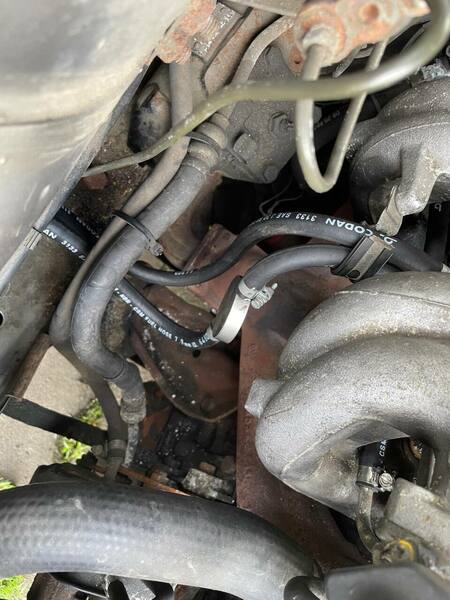

Not much had happened today. I did have some spare fuel pipe in stock, but it’s external wall is slightly thicker than the original stuff, therefore the original jubilee clips won’t grasp the girth of the new pipe… so I’ll be heading to Autohose in the morning (only round the corner) to get some fresh hose and a fist full of stainless jubilees to match.

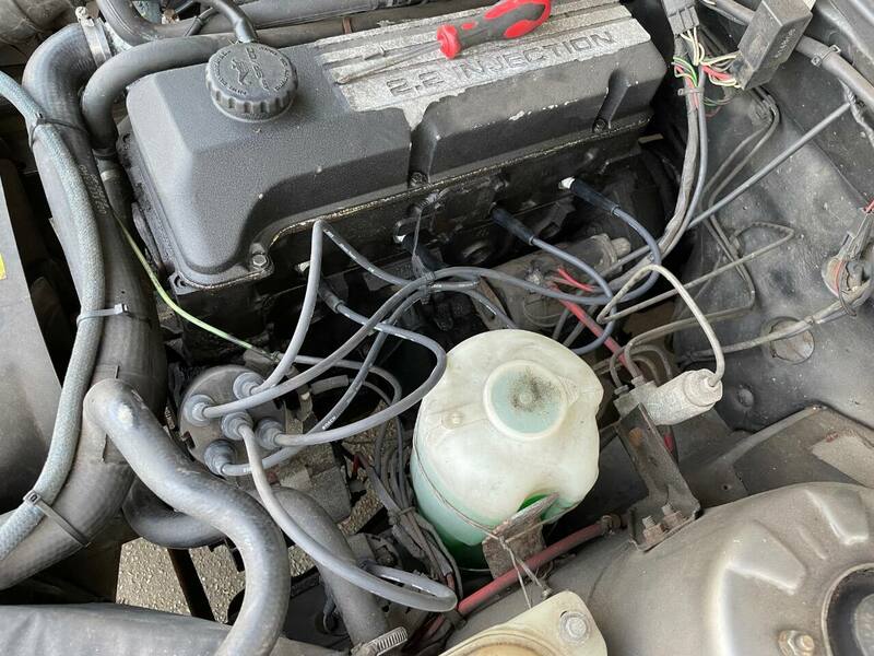

while feeling let down that today has been unproductive, I fitted new plugs, leads, and took the dizzy cap off to inspect the condition. Not too bad but cleaned up with some wet n dry. Will order new once I know it runs.
A word of advice - my 2.5 senator dripped fuel even when the pipes and clips had been renewed. I, like various garages had used generic 8mm hose.
I went to the vauxhall dealer and got some from them - theirs was 7.3 mm internal diameter, not 8. No more leaks.

I’ve got 7.9 ID that I’ve used before on these engines and it’s fine. Got a dozen stainless steel jubilee clips at the same time as 2 metres of pipe. Wasn’t cheap but I don’t buy cheap when it comes to fuel.
So. 4x injection pipes replaced
2x feed + return pipes replaced.
next up is two pipes underneath.
But need to get it up in the air to check over metal fuel pipes.
the old ones were definitely toast.

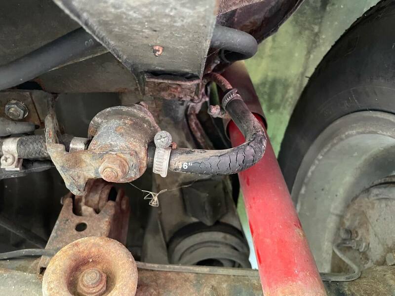

Pulling more fuel pipes off today, the pipes around the fuel pump are definitely buggered. The metal pipes are rusty but it just looks surfacey at the moment. They will probably clean up and be greased.
fuel filter last replaced at…. 2004. Should be able to get a replacement off that number.
Mmmm crumbly.

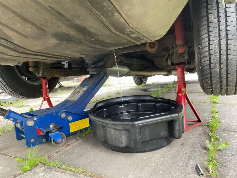

I took the main tank to pump pipe off, and about 15 litres drained out. Shame it’s stale, it’d be worth a fortune 🤣
