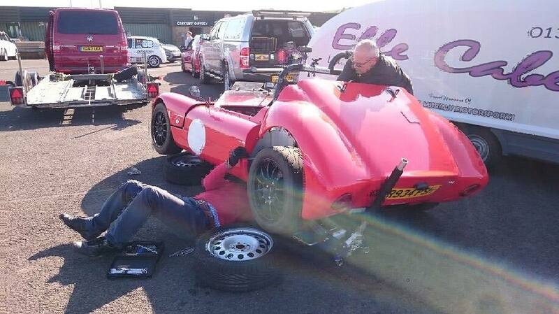

here we are fixing a throttle linkage at knockhill

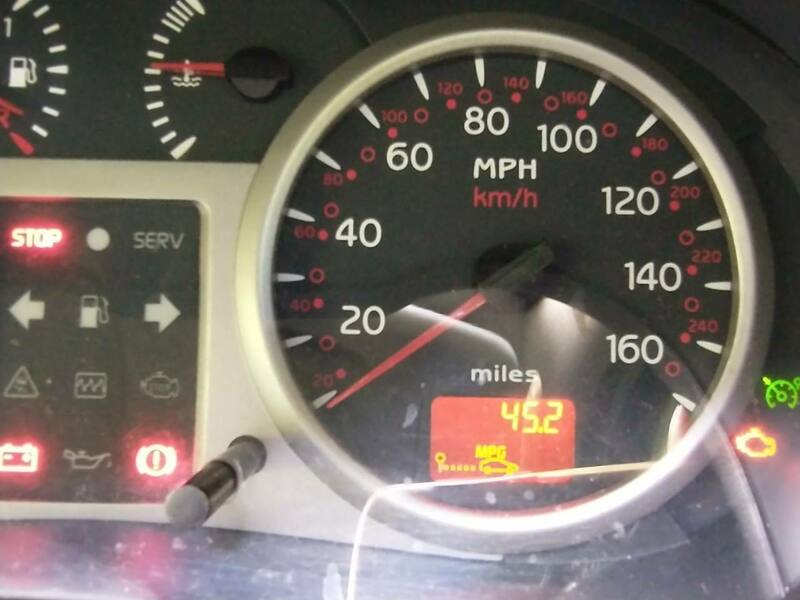

1. The OBC reads 42.2mpg after 100 miles on this tank. I wonder if pulling all my tools out helped?

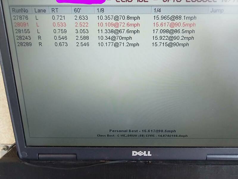

First competitive outing for this today - up to the almighty Crail for some Drag racing.
I say drag racing, but it was more a meeting of mates interspersed with Going Like Fuck ..
Firstly, scran was procured from a fine establishment
Others were met and a sedate run to the track meant that I arrived with decent MPG for the tank so far.
I'd covered a fair few miles (and added a further 20L to the tank in anticipation of the trip today)IMG_20220515_102448108.thumb.jpg.f824b228ab4bd2fa1463544d789c35a9.jpg
I reset the trip mpg to see how bad it was. Happily, over all the runs and returns back to the queue, it managed 13.6mpg. Pretty decent really.
With the exception of 1 run, where I launched at 3000 rpm and triggered the traction control (so the car cut power and bogged) I found 2500 and careful with the clutch got reasonable launches without the threat of damage to the driveline.
the best time of the day was 15.615 @90.5mph.
As you can see, my reaction times ain't great, but at least I am consistently in the 15s

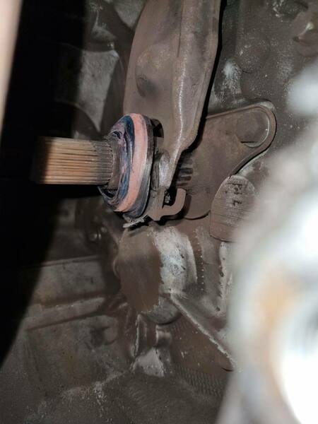

Prepare for Carnage...
From initially noticing the rattle of the release bearing until it was parked at Clio Stu's last night, the car has done about 600 miles..
Initially it doesn't look great ..
Peel back for more buggeredness
I'd say that is forked..
Zoom and enhance on the release bearing:
IMG-20220609-WA0022.thumb.jpg.4961363b4c0bf7214e9f7fc80ff9375b.jpgIMG-20220609-WA0023.thumb.jpg.6310b2e9e30bf4417d2320d54322990a.jpg
there was at least some friction material left.

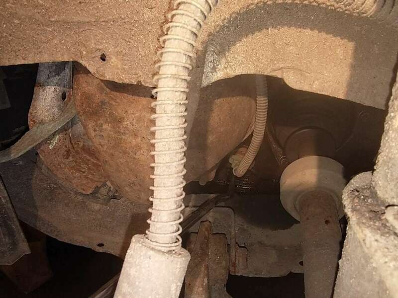

Right rear bearing is howling like a banshee, so it's new discs time (rear discs have the bearings pressed in).
Not the worst job but as usual, time n money..

Tell me you have a fucked rear bearing without telling me... Spacer washer fucked too, will order spacers and discs now. A spare disc is on and grumbling gone. Technical success.

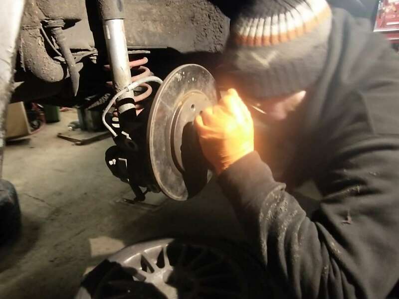

I took it up to Clio Stu for a going over - he has a 2 post lift, so we could get right in about it.

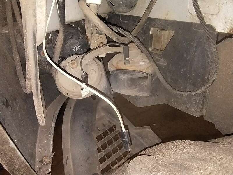

A few things were sorted:
Horn terminals cleaned so it worked again
(Yes, that is directly in the way of all the road shite, great design)
The lack of reverse lights was resolved by fitting a replacement reverse switch to the gearbox - relatively easy to get to between the gearbox end cover and the LH driveshaft.
A new* set of rear discs and pads was installed. The right rear bearing had munched the disc spacer - so we had to replace that too.
After fitting and torquing it all up (175nm if you want to know), we reinstalled the pad carriers and set up the handbrake for a satisfying 3 clicks.

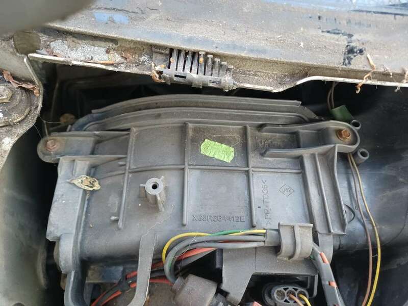

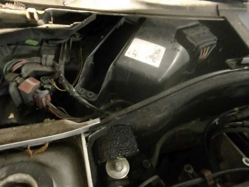

The morning after, the blower motor stopped blowing. Obviously, this was most helpful in -6 at 7.30am.
Handily, the motor and wiring is easily accessible - just under the scuttle near to the pollen filter.
2 6mm bolts and some plug wiggling got it pulled out
With the fan speed whacked up to full (to bypass the resistor), there was no life at the fan. I imagine most folk here have had a car with a failed resistor - so you can just run at full until you can fix it.
Fuse was ok, had 12v at the power points on the plugs. Dead motor. Has to be.
Time to head back up to Clio Stu today and see what's what. I left the wiring unhooked so I could plug in another motor to test.
43miles later in -5 temps. And I made it there ok. Luckily most of the run ia A road/motorway or dual carriageway, so enough airflow to draw in some heat.
We plugged in a motor. No dice.
We swapped the resistor for another.
All fan speeds, and original motor working perfectly.
So there you go. Typical ClioLYFE. The resistor failed so there was too much resistance, and the motor wouldn't turn. The exact opposite of every other car I have had with resistor issues.
I drove home warmer😁
