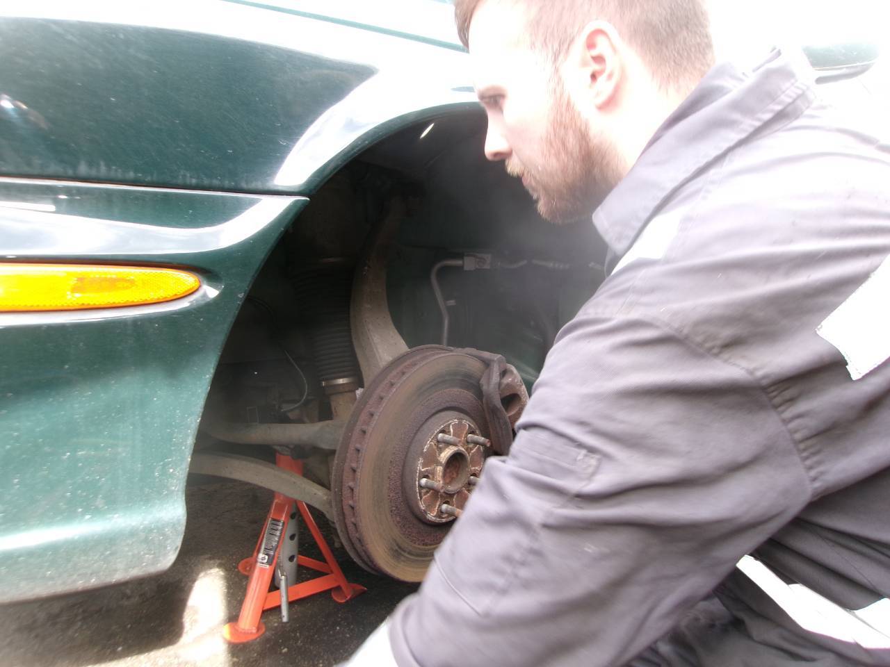

I had a visitor today.  Regular readers will remember @DirtyDaily offering to come and rebuild the suspension pump for me.  Today it happened.
Here we are, all set up at my back gate.  Listening for leaks...

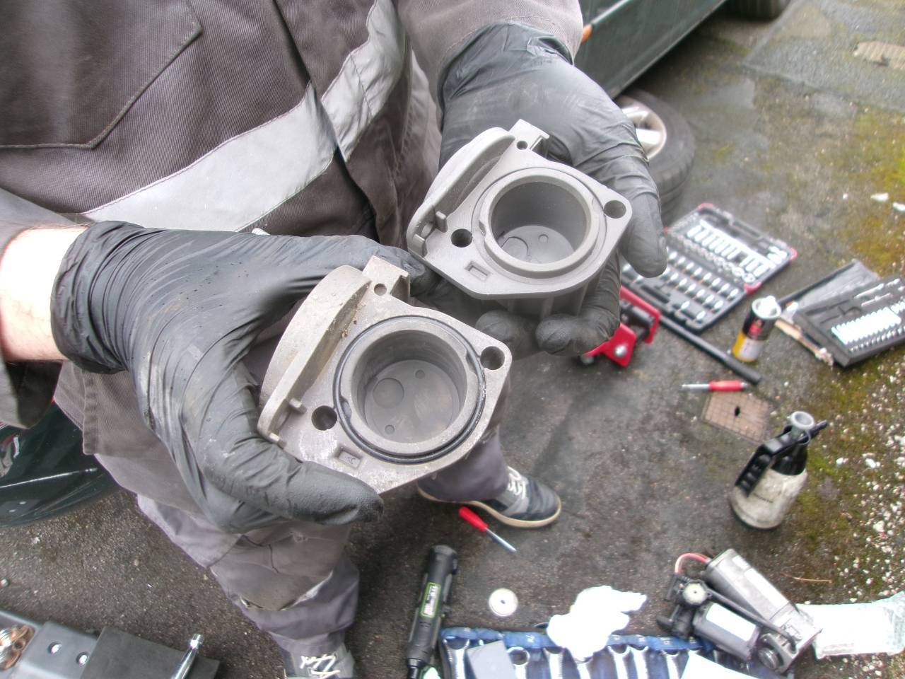

And the techy stuff begins...
New housing that was part of the rebuild kit is at the top, in his left hand.
What you can't see here is how the lovely new housing broke as DD was tightening the bolts.  We had to re-use the old one.  Fortunately it cleaned up well enough.

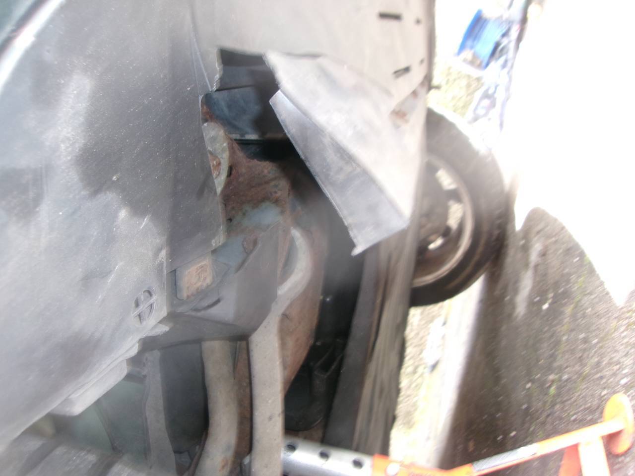

And then he reattached this front undertray that had somehow come adrift.  So we went for a test drive.
