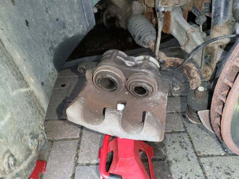

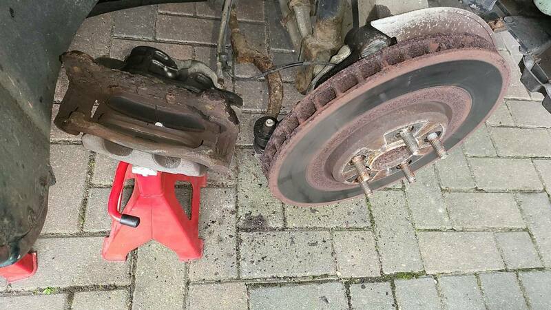

PrinceRupert Posted January 29, 2022 Author Posted January 29, 2022 Got it out on a longer drive today. Noticeable drivetrain vibration, very noticeable at motorway speeds, and significant when braking at motorway speeds (but not so at lower speeds). Front right disc is too hot to touch when front left is fine so suspect binding caliper.
Bear Posted January 29, 2022 Posted January 29, 2022 That's the bit I meant about the brakes needing a service. Up here I'd get about 20-30 miles then vibration - and it's been stood. Sliders off, clean up and grease (or new slider kit) should deal with it. I'm guessing that around busier areas with more braking needed it doesn't go as far before binding?
horriblemercedes Posted January 29, 2022 Posted January 29, 2022 I don't know if these have the same brake calipers as a 52 plate 3.0 litre S-Type (seems quite possible) but if so, I have a set of front brake pads that you can have. I bought them, forgot, got rid of the car and they turned up in a garage tidy up recently Wgl2019 1

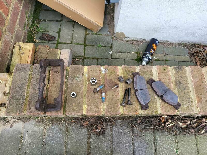

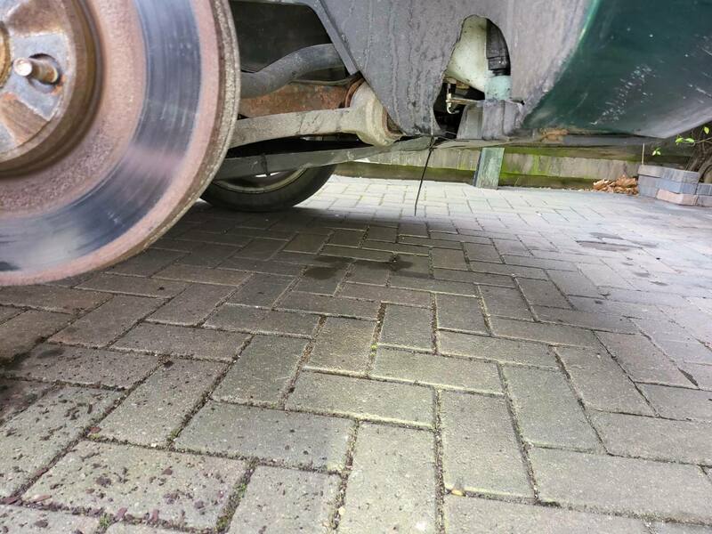

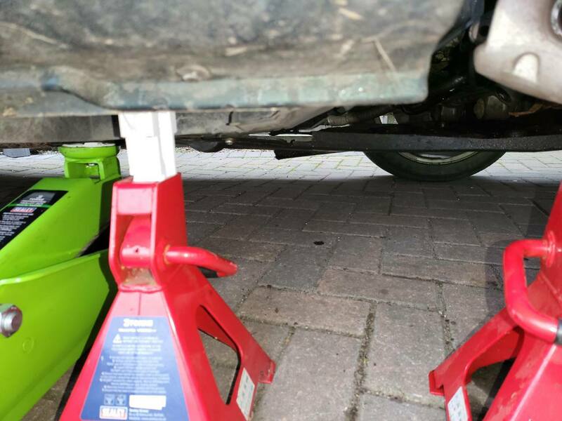

PrinceRupert Posted January 29, 2022 Author Posted January 29, 2022 Calipers and discs definitely a bit crispy. Might get a set of sliders etc only six quid a side on ebay. A 10mm bolt from the shed and two cable ties got the undertray not hanging down quite as badly though which is good. tooSavvy, dome, Dan_ZTT and 3 others 6
DirtyDaily Posted January 29, 2022 Posted January 29, 2022 I think I have a caliper and disc in my shed... tooSavvy and PrinceRupert 2
PrinceRupert Posted January 30, 2022 Author Posted January 30, 2022 Newbie question: how do I know if the pistons are seized in the caliper? Have the carrier off and pads out and have cleaned and greased the pins and greased the rubber bits but there is no obvious way to move the pistons in and out to see if they are seized.
wesacosa Posted January 30, 2022 Posted January 30, 2022 not sure you can easily. Its much more likely that the sliders will be the problem rather than the pistons, especially it the dust covers look in tact and no obvious signs of rust etc. You could try pushing them back with a piece of wood and a G cramp don't be tempted to push the pedal to see if they move out !!! maybe easier just to assume its the sliders and put it back together and give it a drive PrinceRupert 1
DirtyDaily Posted January 30, 2022 Posted January 30, 2022 not sure you can easily. Its much more likely that the sliders will be the problem rather than the pistons, especially it the dust covers look in tact and no obvious signs of rust etc. You could try pushing them back with a piece of wood and a G cramp don't be tempted to push the pedal to see if they move out !!! maybe easier just to assume its the sliders and put it back together and give it a driveI would concur. If you need a good caliper let me know. PrinceRupert 1
Bear Posted January 30, 2022 Posted January 30, 2022 If you want to check the pistons, clamp a block of wood in the caliper between the pistons and the caliper iself, that leaves just a few mm for them to move. Think "pad thickness + disc". Then you can give the pedal a gentle push. But there will be pad wear reflected in their current position, so get a clamp or a piston wind back tool and they should retract. When cold the car would drive and pull up straight and then drive off, so I don't think the pistons are a problem. It felt like reluctant sliders and grabbing/binding.
PrinceRupert Posted January 30, 2022 Author Posted January 30, 2022 Seems a bit better but not fixed.@DirtyDaily might take you up on that offer of a caliper

PrinceRupert Posted January 30, 2022 Author Posted January 30, 2022 Turns out tyre pressures are all far too low and imbalanced across the front axle - 19 front right and 25 front left. Pumped them up to their proper levels (32/34) and will take it for another spin next weekend to see if it might have contributed to some of the vibration/fidgetiness. The brakes are definitely improved but is still some vibration and get hotter on right front than left front, but they don't get absolutely cooking. Might as wes says just need a bit of exercise. Replaced the rear left door actuator today and now have four locking doors, result. Not too difficult a task, lots of screws and a little fiddly but only took an hour or so. Key fob is now doing absolutely nothing though. Ive replaced the battery and followed the instructions to progam it to no effect. Got quoted 144 quid for a new key ... wesacosa and Bear 2
DirtyDaily Posted January 30, 2022 Posted January 30, 2022 Turns out tyre pressures are all far too low and imbalanced across the front axle - 19 front right and 25 front left. Pumped them up to their proper levels (32/34) and will take it for another spin next weekend to see if it might have contributed to some of the vibration/fidgetiness. The brakes are definitely improved but is still some vibration and get hotter on right front than left front, but they don't get absolutely cooking. Might as wes says just need a bit of exercise. Replaced the rear left door actuator today and now have four locking doors, result. Not too difficult a task, lots of screws and a little fiddly but only took an hour or so. Key fob is now doing absolutely nothing though. Ive replaced the battery and followed the instructions to progam it to no effect. Got quoted 144 quid for a new key and ideally need two... May or May not be related. When I purchased my xj it had a VERY strange thing with the door locks. It would work once unlocking and locking but it would need like 10 minutes for it to work again unless you put the key in the ignition. If you locked the car and forgot something in it you wouldn't be able to use the key you had to put it in the door. I had no idea how to fix this so I just put up with it. One day after working on it I left the ignition on and killed the battery. Jumped it and from then on it worked fine. I'd be tempted to remove the battery again.ETA- I think ultimately it was either an alarm/immobiliser issue or a drivers door module issue

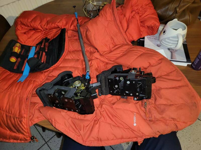

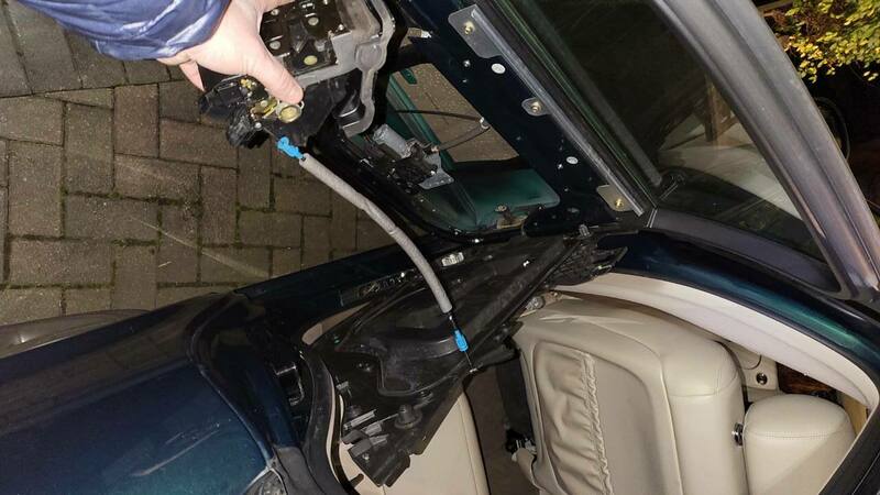

Timewaster Posted January 30, 2022 Posted January 30, 2022 1 hour ago, PrinceRupert said: Replaced the rear left door actuator today and now have four locking doors, result. Not too difficult a task, lots of screws and a little fiddly but only took an hour or so. 20 odd years ago I had a mate who drove a shabby xj40 Sovereign. Not bad for a 23 Yr old! We stripped the rh rear door to sort non functioning central locking. We got the actuator out and took it down to the local scrappy to find a replacement. The scrappy pulled out a big box of assorted actuators for us to hunt through. We found one identical to the original, turned it over and in traditional scrap yard yellow paint was scrawled the word "Montego". I did not take the piss, for weeks. Honest. dome, AnnoyingPentium, Lacquer Peel and 1 other 4
