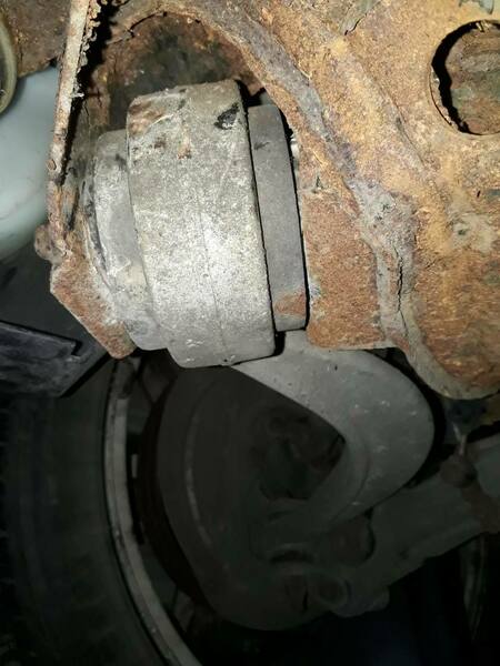

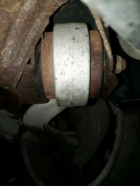

DirtyDaily Posted March 16, 2022 Posted March 16, 2022 They drive very well on completely knackered bushes. I've driven 5 with knackered bushes and whilst you can tell the difference when you replace them (I've done it 2 times on my own and once on someone elses) you'd be surprised how bad they can be before you really notice it.https://cloud.tapatalk.com/s/6231bed7ae3c2/20211002_151858.mp4That video wasn't the worst either. Just the latest one I've done.

PrinceRupert Posted March 16, 2022 Author Posted March 16, 2022 They certainly don't look brand new and could do with replacement but "dangerous" I am not convinced. VID-20220316-WA0012.mp4
