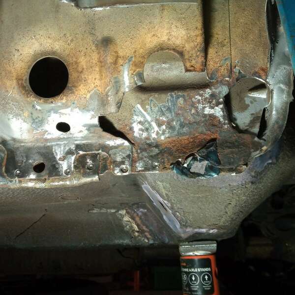

Another update.....,In a break from painting bits of house, I decided to have a look at the crusty sill end. As is always the case the hole was bigger than I remembered and when I started prodding the lower section of  the wheel arch sort of broke up....
Its a tad manky, so at this point I got busy with a wire wheel on the grinder and went on the attack...
Okay its not pretty but its all fixable, I have started with the cardboard templates but at that point pretty much ran out of time, so its business as usual crap photos and little progress.  I might do some proper metal work next weekend.

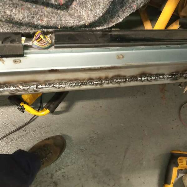

So by April I had acquired a pair of sills from the Rover 800 owners club. I slowly took the drivers side sill apart, replacing sections of membrane as I went and then tackled the bottom of the B pillar which had become properly crusty. None of these panels are available so it was case of so your best with sheet steel a vice and a bit of ingenuity.
The B pillar repair was tricky not helped by the original metal seeming to be quite thin even by Rover standards! I created a kind of over engineered triangular bracket which I fitted in place of the missing section. and then sealed up the sides (only the first part of the process shown).
Eventually I worked my way down the sill and also repaired the bottom of the A pillar..
At this point I checked the calendar and it was about June, so time to fit an actual sill!
The sills supplied are not full size you have to seem weld them into the remnants of the original top sill which is a bear but do able.. It didn't help that the welder broke part way through this process. Something went wrong with the torch so when it got hot it stopped passing gas (rather crucial for a good weld). this took a while to figure out and not being a modern Euro type it was fairly involved replacing the torch.

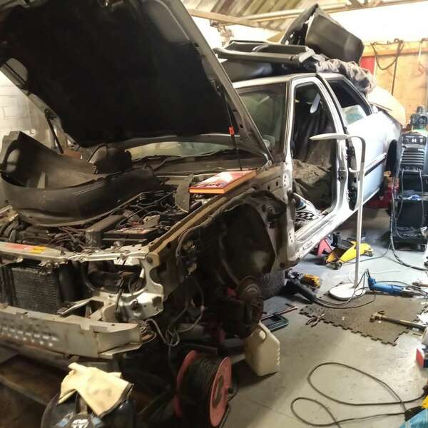

So now its about August so I started on the other side Yay! (this was supposed to be a quick and dirty get her on the road kinda project but hey ho.........)   I will save you a repeat but it was pretty much the same on the other side.  So here is the other side nearly finished....
Obviously the welder broke down for a second time, this time the wire feed..... I am so tempted to get a nice shiny new one and give up on fixing my old Clarke but realistically the repairs have come in at less than £70 quid so far, which is a lot less than a decent new one....

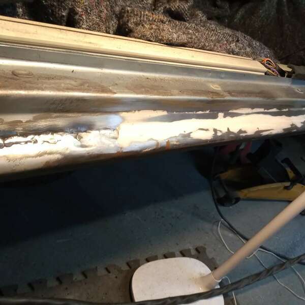

As you can see late November/early December has been fillering time, to try and make it look presentable .
As ever there is another snag, the passenger side rear wheel arch is crustier than Crusty the clown, you cannot seemingly buy a Rover 800 wheel arch, in theory a Montego one is the correct shape, cant find any of those for sale at the mo either.
