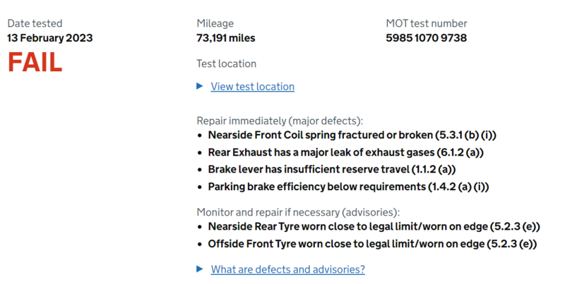

As of 0827 hours this morning, the Scabia was deposited at the garage for the MOT test.
Time to spam F5 on the laptop... reg is X444RKB if you're nosey.
Not a terrible fail tbh!
Aye I'm not too bitter about it! I knew the spring was broken, and the exhaust was a bit fruitier than before too, and the handbrake was and still is a bit shite! I'll sort it out, it's still one up on the Punto from before. :lol:
That'll do. Pasted above for those unable to see it on the site. :)
The exhaust gas leak may also be causinhg the fueling error. If its leaking out somwhere near the o2 sensor it'll be pulling in air and showing lean even if the mix in the engine is fine. So your MOT might fix the issue😆
I can only hope! Although it did have the front section replaced a wee while back, this seems to be the rear section unfortunately.
  • AnnoyingPentium changed the title to AnnoyingPentium's Adventures - Fabia MOT Fail!
The car is back home now. New top mounts sorted the creaking over bumps, and it's had an NSF spring and shock done... among the other things in the image below. Labour exceeded parts costs, with the combined total being £585.
One issue left, the car ejected a balancing weight and now shakes like a shitting dog. Beyond that. We're all good!
