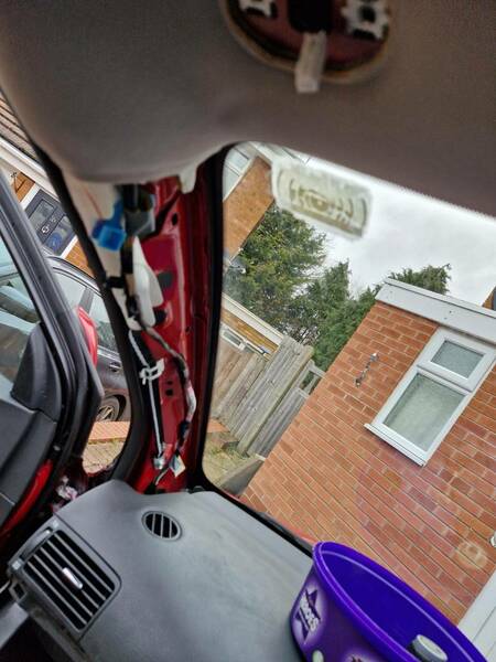

Pulled out the radio from the Avensis, ably assisted by a couple of YouTube videos. I'm sure I could have worked it out but watching someone else do it just saves so much time and 'broken clip heartache'.
The plan is to route a USB supply up RHS A pillar for the dashcam, and the DAB antenna and microphone up the LHS A-pillar.

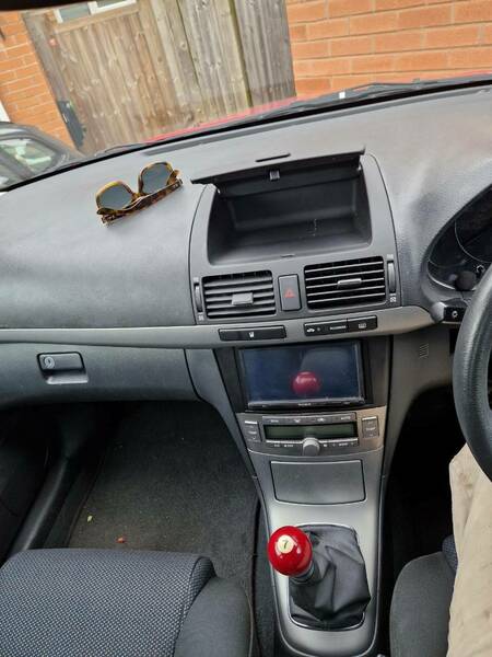

I wired the Sony unit to 12v and it fired up straight away. And the dodgy looking USB socket even works too.
Android Auto is quite swish, isn't it? Well impressed with that.
I had to get a bit creative to get the Sony unit mounted in the OEM brackets but it's nothing that a drill and some self tappers couldn't fix. It actually looks alright with the surround fitted, although it was a bit of a logic puzzle getting it to go together.

I'm sure it's possible to route these wires tidily but it gets to a point where you just have to stuff it in and hope for the best.

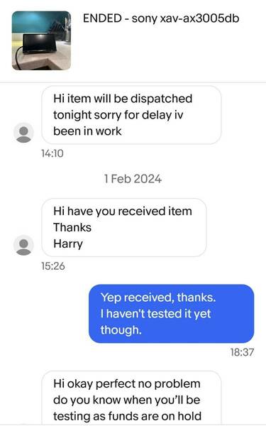

I discovered the s/h Sony unit sold by a moron on ebay is slightly defective. The top left of the touch screen is unresponsive. It's possible to get around this by pressing one of the hard buttons but I'm in two minds about returning it. I would accept a partial refund I think.

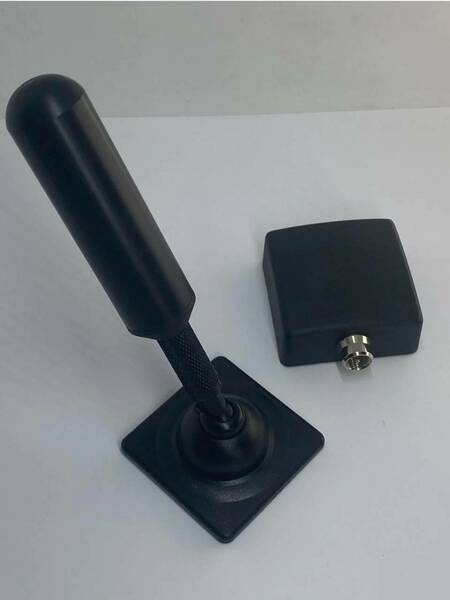

On the plus side I got FM and DAB reception so my cheapo antenna works.

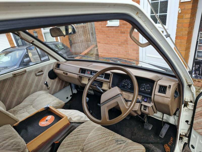

Works are on hold awaiting the bottom inspection of a 1989 Nissan Vannette... Watch this space.
Carly brought her Vanette round for a thorough examination. I had a reasonably thorough gander at it, the verdict is: Structurally sound with crispy bits. Needs a new clutch and battery but I'd happily bomb about in this for the summer. Also possible coolant leak somewhere, the rad swallowed 2 litres before it was full.
Engine is sweet, I think it's a 1.5 so performance is sedate.
I have recommended shiter's rust treatment - wire wheel, rust juice and primer/matt black. It may well have a tide mark soon.

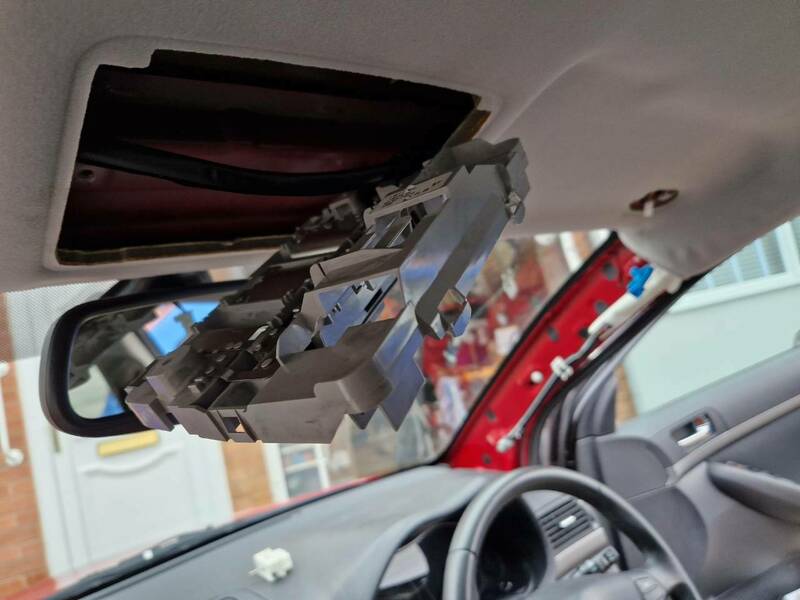

Unfortunately as I feared, the dashcam is interfering with the DAB reception. It's a bit hard to judge how much of a problem this is until I get out on the road. On my driveway it's a crap reception area with tall(ish) buildings in a slight valley, so I only get 1 out of 3 bars reception according to the Sony. Which promptly disappears to 0/3 when I plug the dashcam in.

@grogee like you I had a right faff with my Caddy's DAB signal due to dashcam interference, no matter were I mounted the dashcam or DAB aerial or which way I routed the cables the bloody thing was awful, several ferrite cores marginally improved it, bit the bullet and ordered one of these roof mounted FM/DAB boosted antenna https://www.ebay.co.uk/itm/363133838825
I needed a couple of extra plugs/adapters to make it fit the back of my stereo but it was a proper game changer mate - no interference and no signal dropping out.
I've done probably a dozen DAB installs and yes, roof mount is always best.
When I did it in my Saab there was already a factory roof mount shark fin thing so I re-purposed the hole for an antenna a bit like yours. It worked really well.
What also works well are the magnetic roof mount ones. I've even got one in Stores but I decided against fitting it because routing the cable through the rear tailgate seal is always a bit shonky.
I also don't want to drill a hole in the roof if I can help it.
The only brand of dash cam I have found to consistently not interfere with DAB is Thinkware, they're not cheap but they are very good. I basically gave up fitting anything else, especially customer supplied eBay specials as you just knew they wouldn't have a shred of DAB reception afterwards which would some how be your fault.

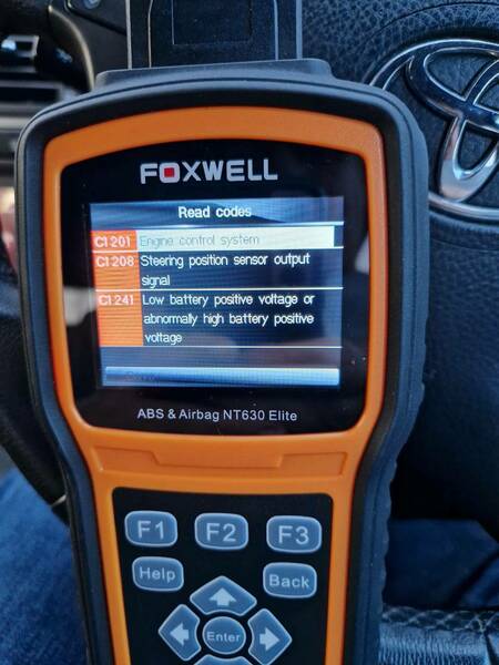

The Avensis has rewarded me for its stereo spruce up by giving me all three cherries on the dashboard fruit machine: TCS, VSC and EML.
Pretty sure TSC and VSC are the same warning light (unless you've switched one or the other off) but basically equivalent to ABS warning light.
Anyway there we were overtaking something, 4th gear WOT and it went into limp mode and threw the light.
Limp mode is interesting, max 60mph on the motorway and supertanker levels of acceleration. But not too terrible compared to some.

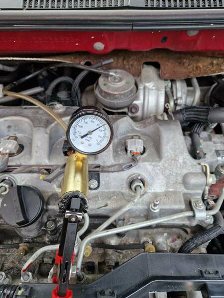

Plugged in the OBD sniffer and it's returned a boost fault: P1251, there are various Google results telling me what this is but the most likely is boost level too low, which would explain the sedate performance (before the limp mode).
I have a few parts darts options but the first will be the vacuum valve that I broke, I bought another s/h one so I'll throw that on first. But realistically this is telling me I'm down on boost so I think a new turbo may be in order. I may try the MAF if it's not expensive although I bet it's fine.
The VSC thing thinks there's a steering angle sensor problem along with some other BS which I'm ignoring. The low battery voltage is probably from when I disconnected battery to do the stereo.
  • grogee changed the title to Grogee's spannering (Puma, Maestro , Corsa & Avensis). TOYOTA 3 CHERRIES JACKPOT
A bit more research seems to suggest it's the problem I already knew about: stuck VGT vanes.
The ECU measures air pressure at the intake and post turbo. If the delta is too high, it commands the VGT actuator (vacuum solenoid operated) to move which has the effect of reducing boost.
In my case the vanes are stuck so it can't move them and presumably this has thrown the P1251 'overboost' code. It's a bit counter-intuitive because I'm suffering from a lack of performance rather than too much, but I'm thinking that the ECU is also regulating the fuel flow so it'll wind injector duration back if it thinks things are going too mental.
All this means that I'm sticking with Plan A, which was to pull the cat off the turbo and squirt in some Mr. Muscle to clean off the carbon deposits and try to free off the VGT.
If that doesn't work, Plan B is a new turbo. I could chance a second hand one but I bet it'll be just as fucked. A recon one is £250 from the usual scumbags, I don't know what sort of warranty this includes.
Alternatively £750 from ECP - yeah, fuck that.

Identical problem a few years back on an HDi - it would go into limp* mode with an overboost code with pre-limp lack of power.🤔
Actuator was stuck/immovable - the vanes were jammed. No idea what position they were jammed in though - would that make a difference here?
(It  also looked like a turbo 'cassette' had been dropped in as a remedy by previous owner but lack of DPF fluid had killed that too)
Sorted the DPF problem + new turbo sorted the thing out but it was not £750 :-(
Steering angle sensor: did you do full lock to full lock to centre after reconnecting the battery?

@RichardK no I didn't do lock-to-lock after reconnecting the battery. I didn't even know that was A Thing! I'll give it a go today, thanks.
It isn't always a thing, but it's quite common for EPAS/traction control systems that have a steering angle sensor involved!
Yep, my Golf has that. Scared me to Bejesus when it first happened but a few metres driven solved it!
Toyota news. I've been awarded a day's tinkering for good behaviour. So I started the Great Wire Marathon:
Glass mount DAB antenna on tailgate glass. Wire to run above headlining and down LH A pillar.
Amp wiring to boot area. Power from battery through bulkhead through left hand sill to boot. Earth in boot area to quick-connect thing.
You're supposed to route power down one side of the car and signal on opposite side; I couldn't be arsed. It'll probably only end up being a subwoofer anyway.
Quite a bit of faffing but I sort of enjoy the self-flagellation.
I've now got a little bellend on my tailgate glass which is the aerial, it seems to work OK.
Last week I un-soldered the socket that was supplied with the antenna and wired in a co-ax to SMB wire to suit DAB units.
Next on the menu is to fit a (used) turbo. A closer inspection of the £250 recon turbos revealed there's a £150 surcharge on top, returnable when they get your old turbo. Yeah, naah.
My thinking is that I can inspect (and if necessary fettle) the s/h turbo on my bench before fitting it to make sure the VGT vanes are good. Then, once the old one is out, I can do the same and flog it back on ebay as a working unit or keep as a spare.
