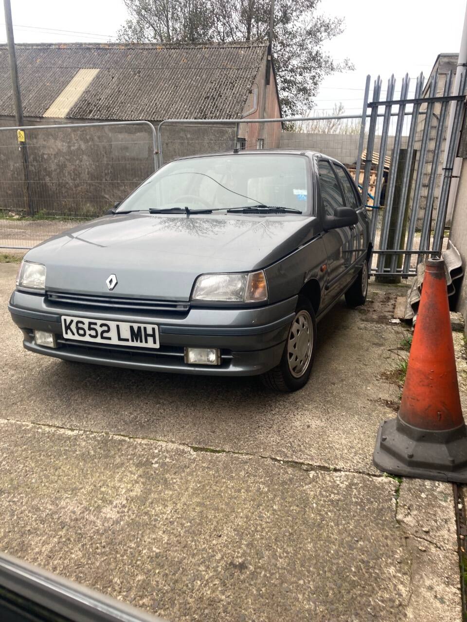

The beast that is Kiltox’s Mk1 Clio was delivered this morning after paying more than the purchase cost to have it moved ( I believe that’s a theme with this car )
Its a little honey !
Initial diagnosis shows a misfire on no1 (or no4 in non french ) and a vac pipe /t piece loose and leaking .

It’s single point injection ( maybe dual - not looked that closely yet )
Ah.. looked too fancy in the pic to be just SPi ! Rules out anything fuel related then..
