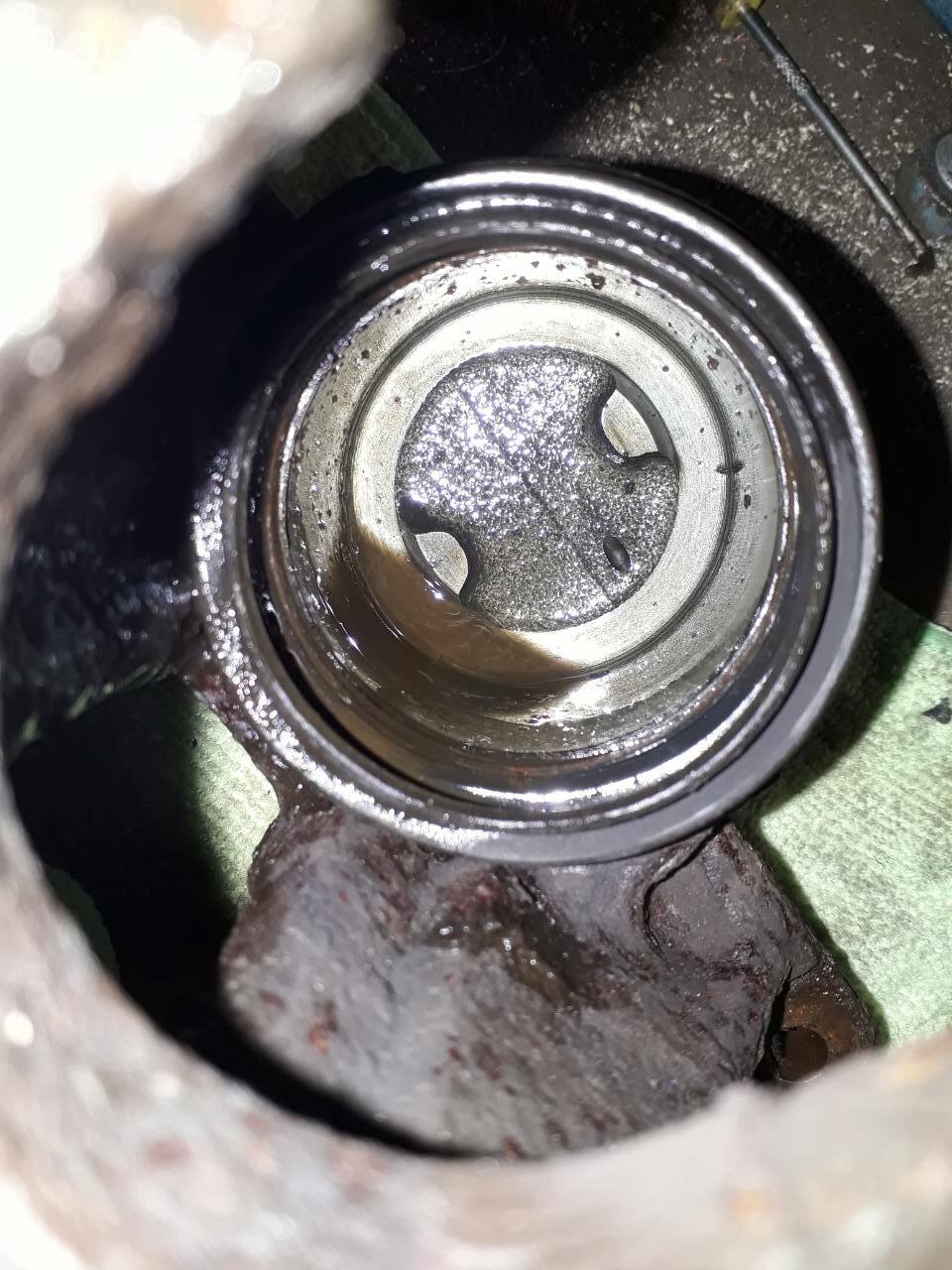

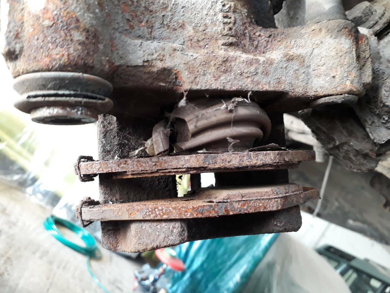

O.S caliper piston popped out and the good news is that it should be good to go again after a bit of a clean and lube.

It's a right of passage, don't worry about it Andyrew.
Who am I kidding, it's an ungrateful old bastard. Give it a thwack with a hammer to make it humble. As you were.
The snapped bleed screw was drilled out i was as carefull as i could be but the threads did take a beating my main target was not to drill into the sealing taper at the base so i drilled untill the base of the threads and pushed the tip out via the hole in the piston bore.
Caliper was cleaned up and put back together. Bleed nipple from the n.s was used and done up tight enough but it doesnt seem to want to seal. Will try a new nipple as a last chance as that was certainly a bit tired looking. If not new caliper time. Booo!
Discs got cleaned up with the wizzy woo and a DA for now. Carriers cleaned up aswell, just need the n.s to turn up now.

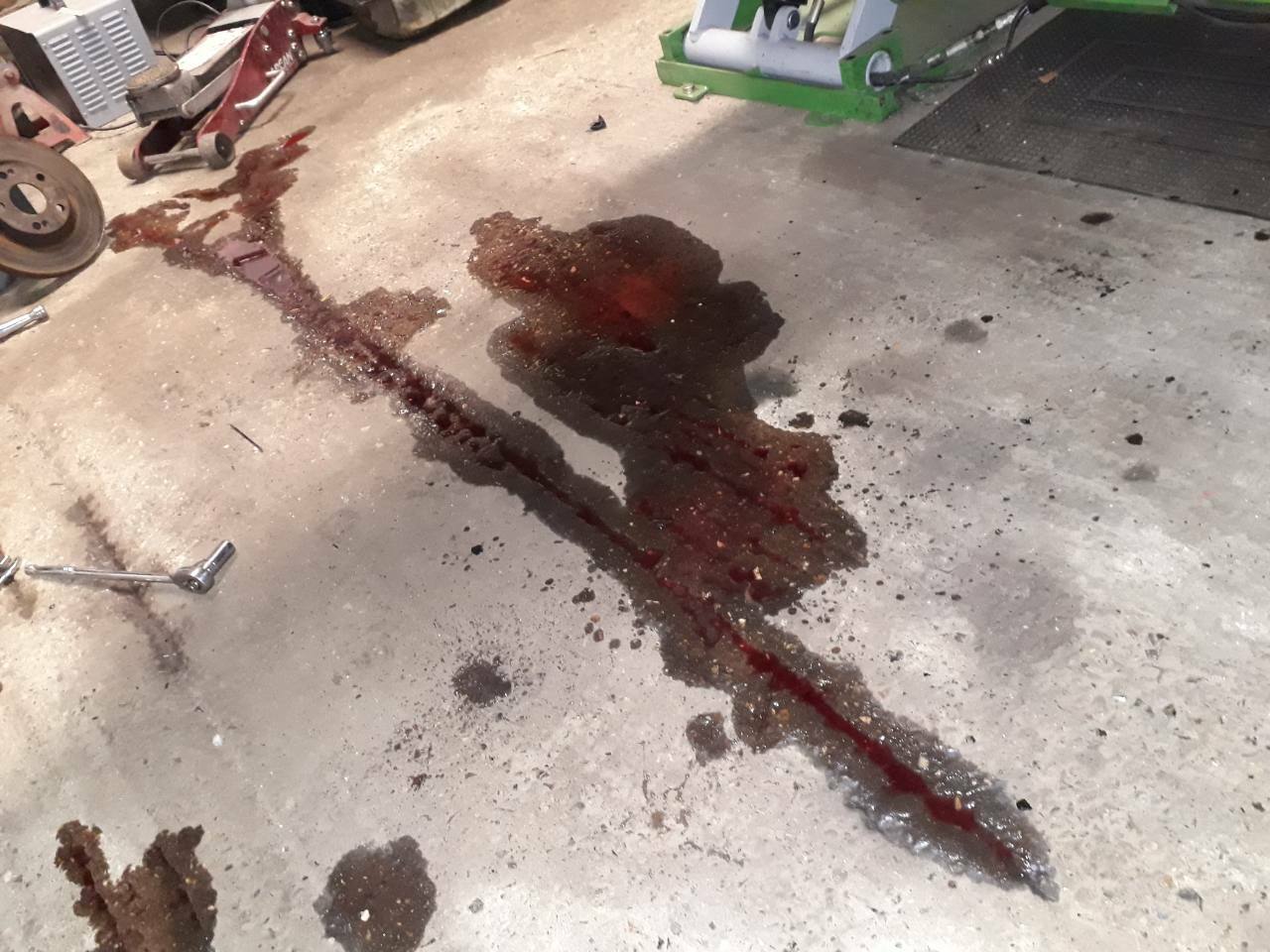

Steering then, we have a wee leak.  Up and kicking its shoes off reveals the volume of said leak
Oop err!
Now the undertray was busted at the rear causing it to channel fluid down to one point.  I could see the leak that was at the front near the rad but there was also alot of fluid below the reservior.
Tray off , i cleaned the shit out the the pulley area and topped up the fluid to check for leaks.
It stayed nice and dry but the other leak was dripping away. Without the engine running the flow was a drip every 20 seconds or so.

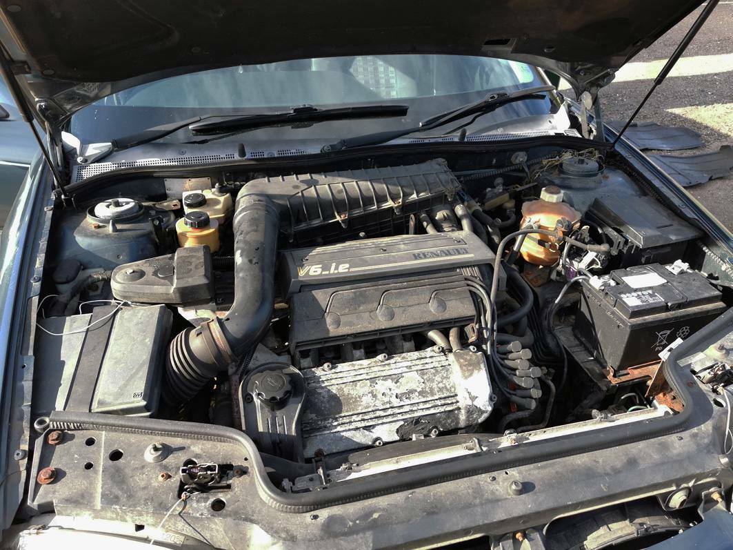

The V6, when it fired up it sounded like an absolute bag of bollocks.  Like a ford ohv lump was under there! Pulleys noisey, tappets a bit drained out and old oil.
We fired it up today and it hadnt got better, a few cycles got the p.s pump to shut up as the air came out. One tensioner is very dry so my friend popped the side of the bearing and gave it a squirt of oil that shut that up.
The already mentioned lazy tappet clacking away. A smidge of heat build got things a bit better but id heard enough and it had proven the pipe fix had work so we decided to drop the oil and check for any sparkles.
Renault and the bloody square drive sump plug see an old 3/8 extension ground down to suit.
Oil drained. No sparkles but smelt quite a bit of fuel. I assume all the unburnt from missfiring.
No sparkles thankfully, some clouding from a bit of moisture and it was rather old and thin.
Ptfe on the sump plug threads had turned to a goop hanging down. Cleaned this out.

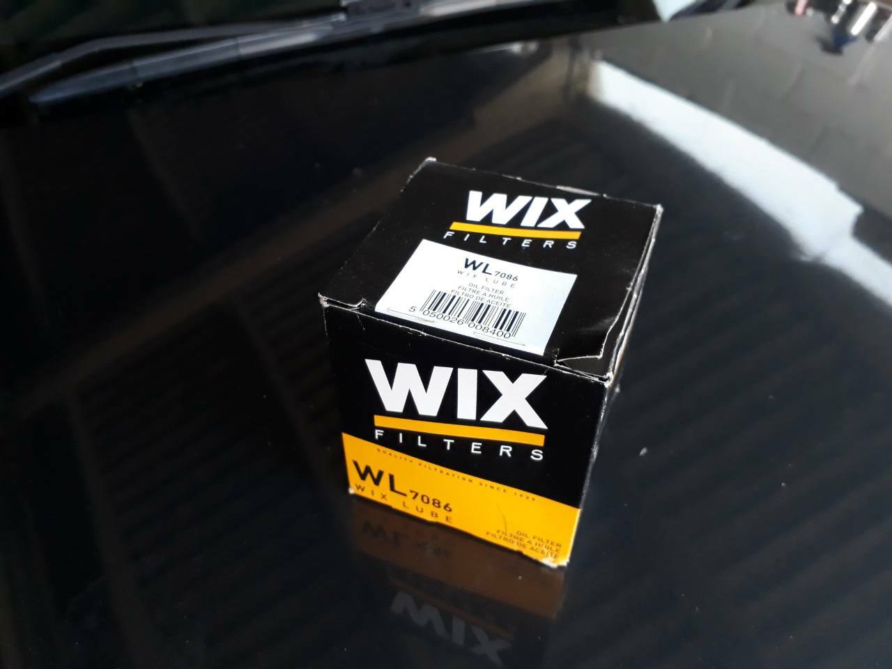

Filter, VGG approved.
On and fresh mannol 10w40 in (7 litres!)
Fired up and after a bit of running and a few revs everything shut up and sounds much more like it should.
Its no busso! But still. (Video was later on after it had been running multiple times for a good amount of time)
Id like to add the p.s pump still had air in it in the video, cycled left to right on the floor forced the rest out and levels topped up sees it happy.

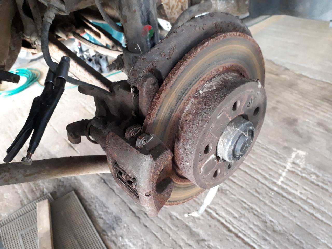

The rear brakes.
O.S seemed okay. The N.S cant be that bad then.

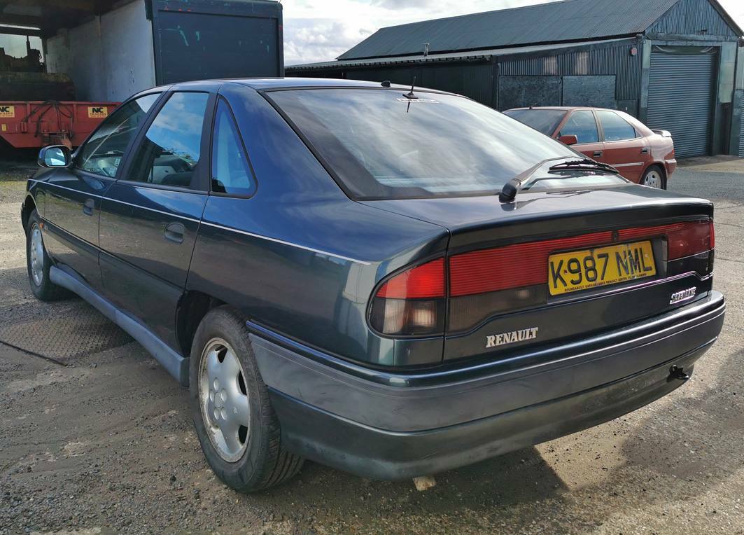

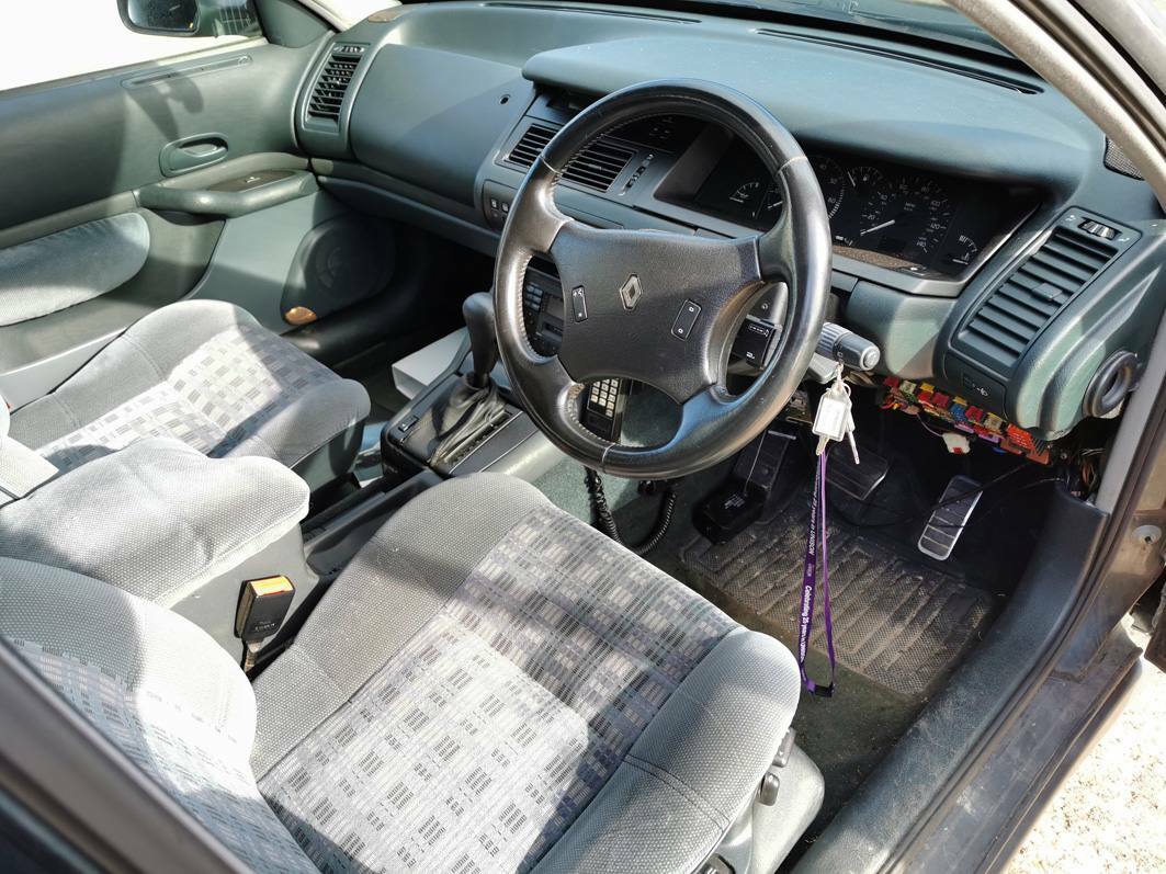

What Andyrew has shown you are the horror photos!
I went over today and took some glamour shots!
Andy has to be congratulated for his enthusiasm and vigour to save this car.

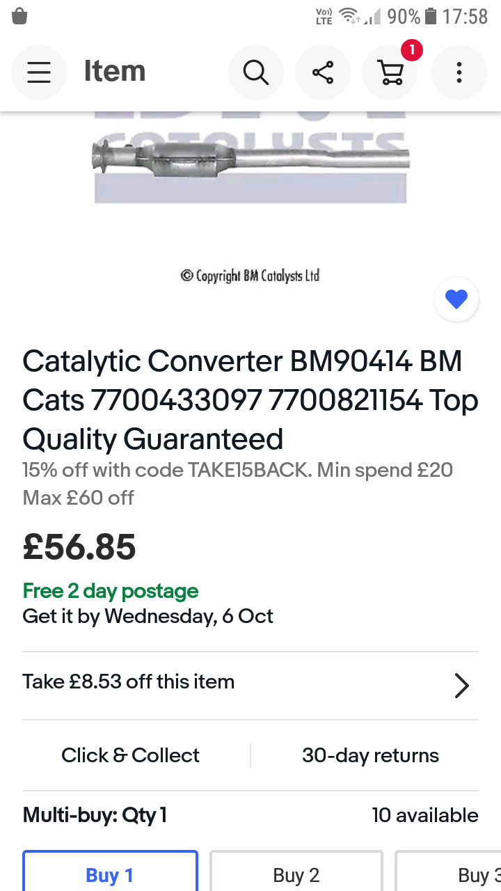

The CAT is an absolute monster of a thing. Which is a concern to me as i could see it going walkies,
Could take it off for now (after MOT pass) and put a cheap aftermarket/universal one on it? Pre-2001 cars don't have to be Type Approved iirc.
Could take it off for now (after MOT pass) and put a side exit exhaust on it
Hot Rodders won't be expecting that, but could hear you coming
So with the discount code 48 quid. Might get some numbers off the cat and get it valued via the company that bought the Mx5 cat.
Just make sure it passes an emissions test with the cheap cat first before flogging the original. Cheap cats are renound for barely getting though a test.
There's a reason why old cats fetch so much money for scrap. You don't get much in the way of precious metals for less than £60.
