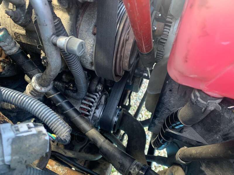

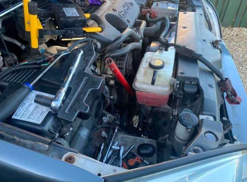

So here is the update, and I will try and show you why I cannot be fucked tracing wiring.
Through the front arch is the only decent access. Please note if you will that the grey plastic cap above it is loose. The screw here was loose as well. So vibration, or it working itself loose, and the water zapped it most likely.
Alternator came off very easily given it hadn't been there for long. Took it to a few places to see who did alternator testing and found one out in Wombourne. He tested it and said it's fine. Diode pack is sound, it's all good.
I've reattached it, added thread locker to the nut under the cap - could not give a fuck if this is a good or bad thing, don't tell me either - tightened it as much as i'd dare for fear of it snapping.
Above you can see if I take the battery out, I have that much access.
From above you can see how much room I have for that alternator and literally everything else. Remember the thermostat lives behind the alternator and behind the turbo elbow joint.
That is the gap you have between the chassis arm and alternator.
That is as far as I can go from above because of the space. All I can reach here are the cable and terminal that go in the back of the alternator.
Amazon will arrive later tonight with the fuse. I'm not going to fuck around with a dummy fuse as something beyond it will fry itself. And then that's ££££'s more than the current £££'s it's swallowed.
Shall reconvene tomorrow with a hangover, hopefully. From booze, not the car.
What a tedious PoS.

2 minutes ago, RichardK said:
Thing is if the batteries were charged up and then reconnected, and the fuse blew, it would still run for a decent amount of time I think, and other systems would be protected by their respective fuses? It has to be alternator, battery or starter live circuit to take out the 140A and not the others, surely?
Without knowing exactly where the fuse is in the system it's impossible to say, hence diagram needed.
