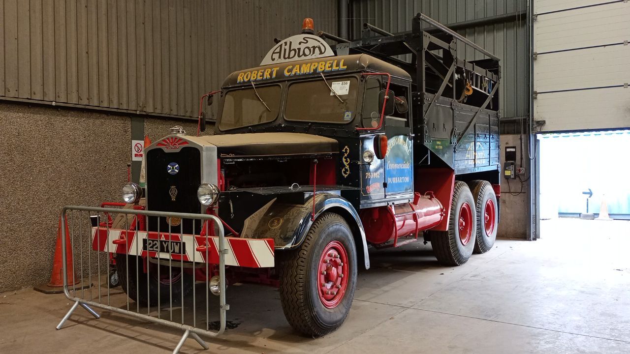

I had a good poke around in both the Scania and the Albion.
The photo doesn't do the scale of the Albion justice. The tops of tyres were level with my chest. The whole thing resembled a building more than a vehicle. For a sense of size, the sidewall on each tyre was 15" tall.

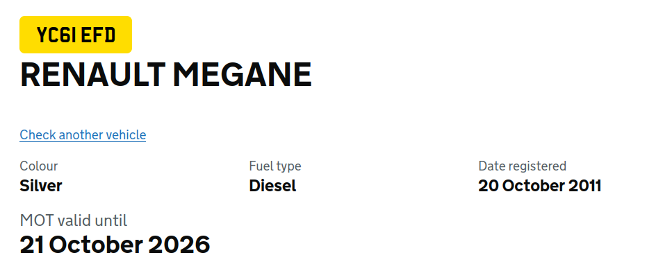

The centre brake light has stopped working, though. Just an advisory but I'm still curious about it.
My mechanic even just said "It's nae testable though, don't worry about it!"

I've just ordered a replacement high level brake light as it was an MOT advisory. Only one LED still works. Admittedly it's the one closest to the plug. I wonder if they're wired in series and a bit of soldering would bring them back...

The replacement third brake light for the Megane arrived yesterday.
It doesn't work.
Bollocks.
I put the original back in, which had one LED working before. It's totally dead now too.
Double bollocks.
I remember reading something somewhere about how it's not just a case of the car sending 12v to it. Because French it's something like the BCM not detecting exactly the voltage or resistance it wants to see so it goes NON.
The temptation to just patch a 12V feed from one of the other brake lights is high.
It just reminds me of when @dome had one of these, bought new glow plugs and tested them by hooking them up to 12V and they went pop. It turned out they operated at something stupid like 7V for some reason. Which of course involved various control modules stepping down the voltage etc
Update: here's the thread I saw before https://www.renaultforums.co.uk/threads/megane-mk3-high-level-brake-light-issue-solved.605472/
I guess it's time to get the multimeter out!
So it seems more like the shitty aftermarket brake light I bought for the Megane was DOA. Surprise, surprise. Also, the pins in it seem to be too short to contact the plug on the car.
Genuine high level brake light units, even second hand, are £stupid.
So what's to stop me from gutting the original housing and wiring one of these in? https://www.ebay.co.uk/itm/317234110068

Nothing, but it didn't work on my Scenic until the negative was run to a new earth on the car body. It might be worth trying a new earth on the cheap light, unless you already sent it back.
