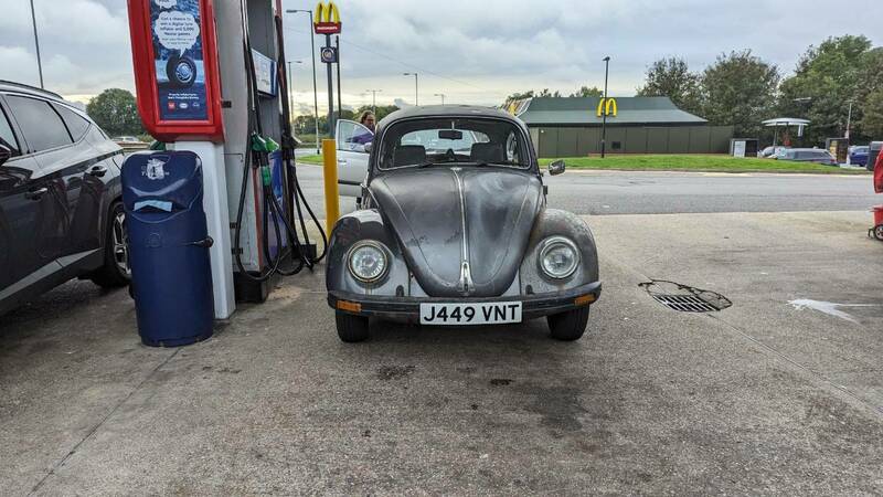

First stop on the way home for fuel. Wipers are a bit pants and right hand indicators don't work but that's not enough to stop me!

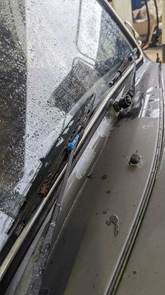

Wiper repairs: 5. Currently held together with cable ties and hope. The wipers worked, then they didn't, then I found the blade on the drives side wasn't clearing anything, then when I swapped them and they nearly fell off. Now I have something resembling a wiper on the drivers side which is useful given the ongoing rain. Passenger side may as well not be there

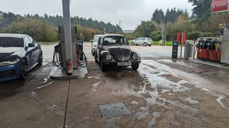

Nearly home. About 30 mins away. Wasn't sure on fuel so stopped again. It's done about 35mpg.

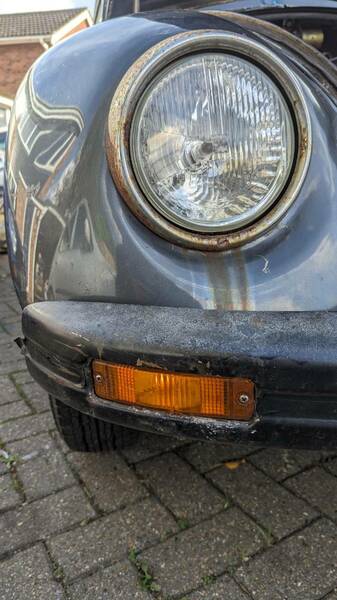

Decided to fix some issues on the Bug. Right hand indicators being one. Front and rear where bad earths. Wing was missing the earth wire completely. Bit of a pain soldering a new wire on but didn't fancy replacing the whole unit.
Now have working indicators

Also fixed the wipers more permanently. Still haven't got new wiper blades but they sweep across the whole screen now rather than just half and the washers work now

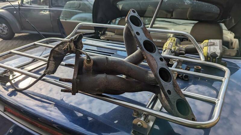

Also tried to get the MGF running properly. Fitted a new lambda sensor and a new catalytic converter. It was easier to take the exhaust manifold off to change the lambda sensor as it's tucked between the block and the manifold. A really stupid place. Catalytic converter that came off is one of the budget ones. I fitted another budget one 😅 Also it still runs like shit despite my effort. I'm *this* close to torching the damn thing. The scanning tool seems to imply it's not running as rich as it was but the new lambda isn't giving any voltage variations and it's still throwing sensor faults. I cheaped out on this lambda so I've bought a Bosch unit and will try again...

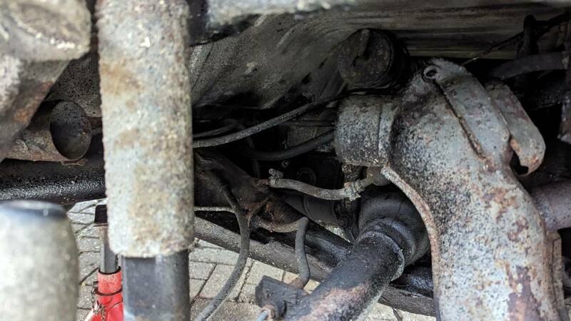

Found out why the heater doesn't work too...
For those that don't know I'm missing the ducting from the heat exchangers to the heater channels.

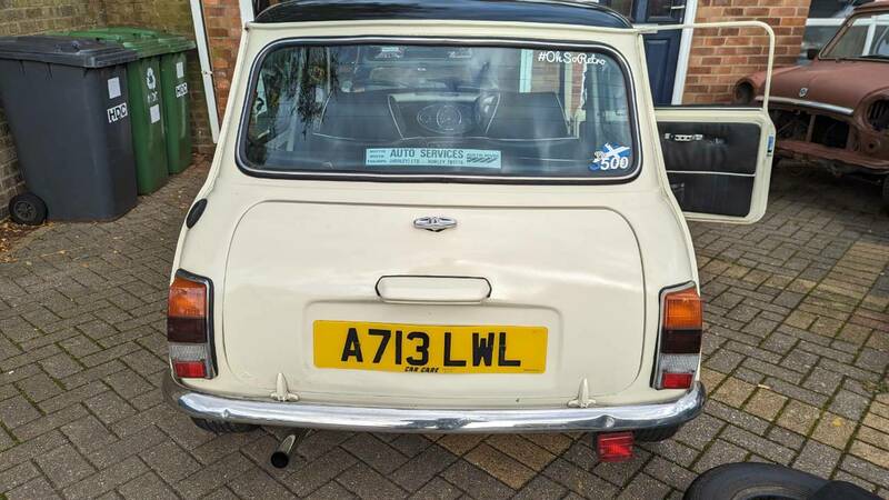

Lastly I decided to do some wiring on one of my Minis. I've been meaning to fit these MK2 tail lights for a long time. They look so much better on this car than the MK4 lights. I've gone for a kind of 70s look on this car so it really suits it

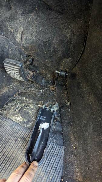

The Beetle continues to be fettled. I fitted luxuries such as a throttle pedal and new brake pads.
New pads means I've been able to adjust the brake pedal so there's the mandated 5mm of travel before the brake master engages rather than the previous 50mm. It was like doing a masonic dance trying to operate the brakes before. Now with a throttle pedal rather than the previous knub I actually feel comfortable driving it! See said knub below...

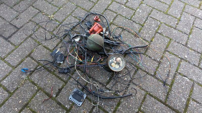

Once I had my radio going I wasted well over an hour removing all this redundant wiring from the engine bay! I haven't even got to the front yet! Also found a dizzy cap and an empty tin of hard boil sweets. So disappointing...
