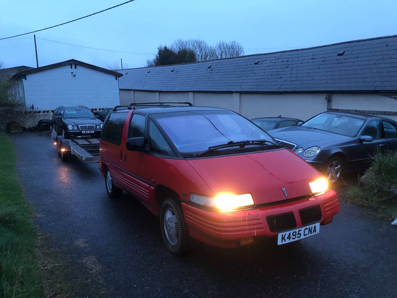

The Lada needed to be in the courtyard. This space was 3 cars deep in shite with flat batteries, which is actually a better situation than normal. Everything moved out the way ok, although I realised that I left the window open on the Trans Sport last time I was in it 😢
The marks on the headliner were already there, as the roof gets really damp from condensation when not used - incredibly, the interior below the window was fairly dry. I think the fence saved me a bit there.
I've also found out exactly where the gauge reads before the Pontiac cuts out:
Luckily that happened just as I got it to where I was parking it.

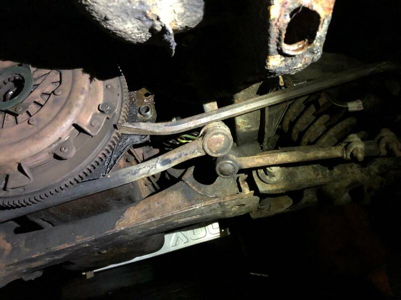

Nothing too exciting to report tonight, I didn’t have much time.
However, I have removed the old clutch.
Official flywheel holding tool:
Flywheel:
hopefully that cleans up alright.
I found these inside it:
fuck knows what they are/were.

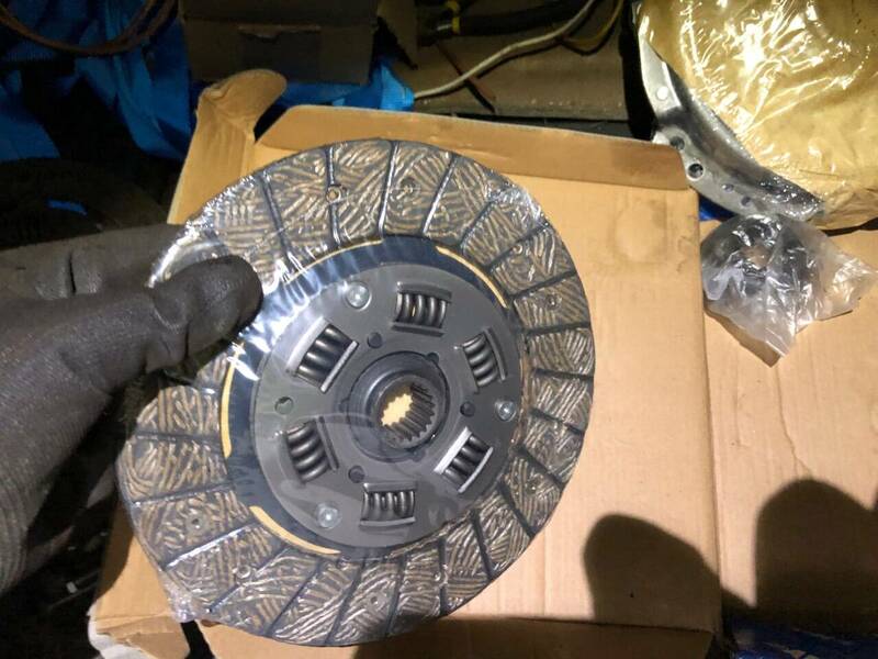

The old clutch disc wasn’t as fucked as I expected:
But the new one does have more meat on it:

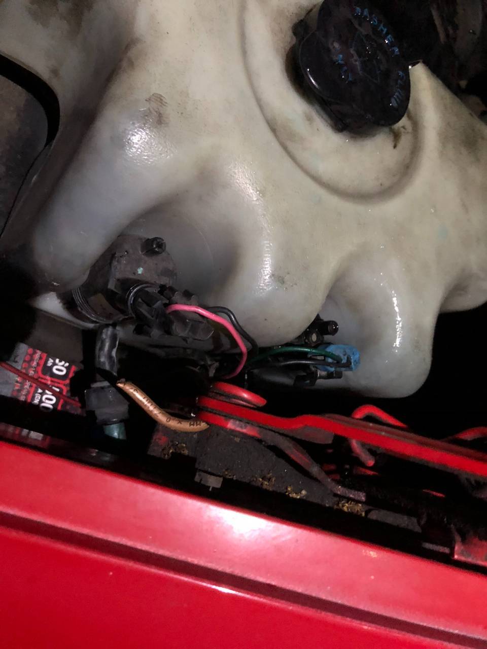

I also definitely wasn’t running it without a working windscreen washer system. However, here is a plastic bladder that I installed to contain washer fluid.

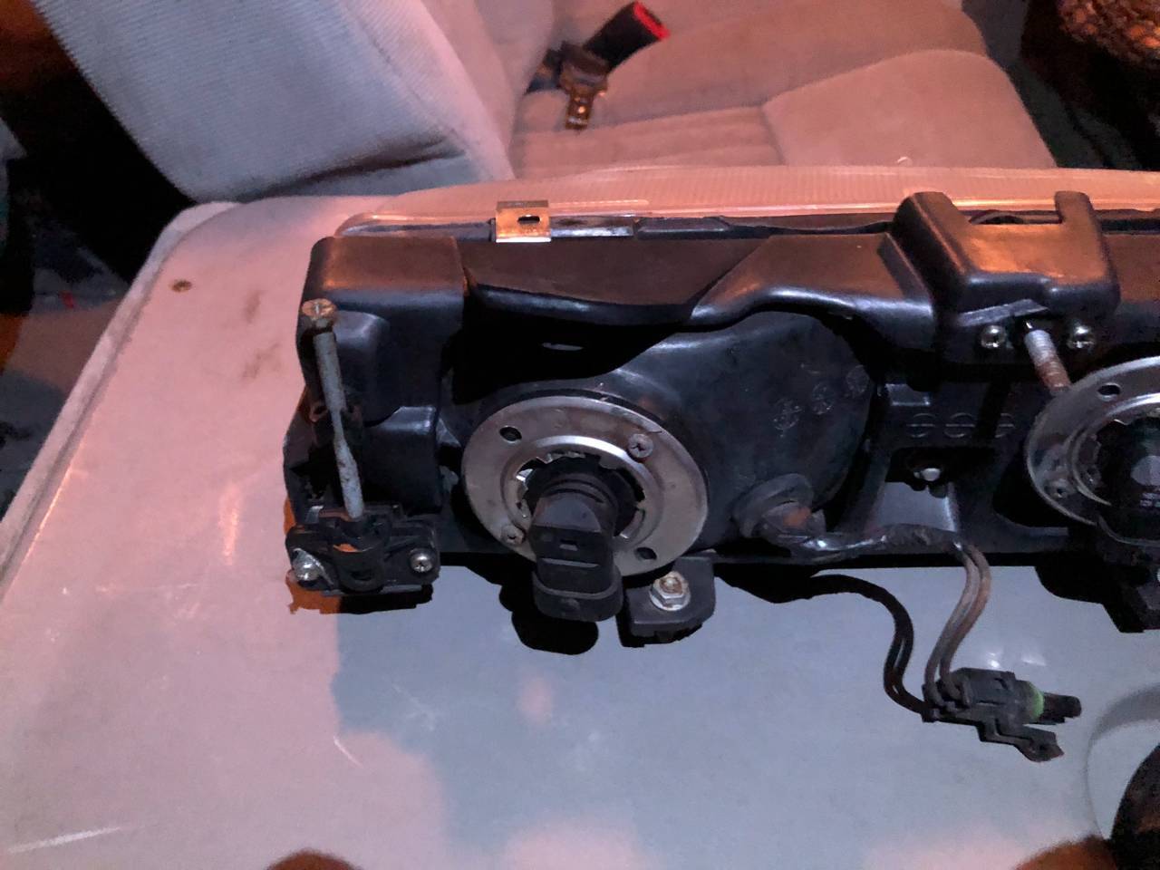

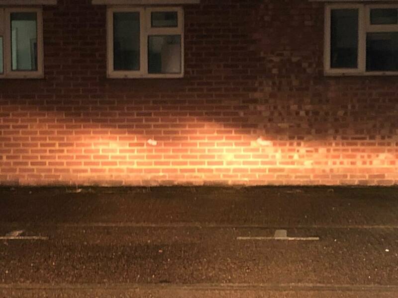

It was rewarded with a carpark special headlight alignment
Theres always time to do it right the second time.

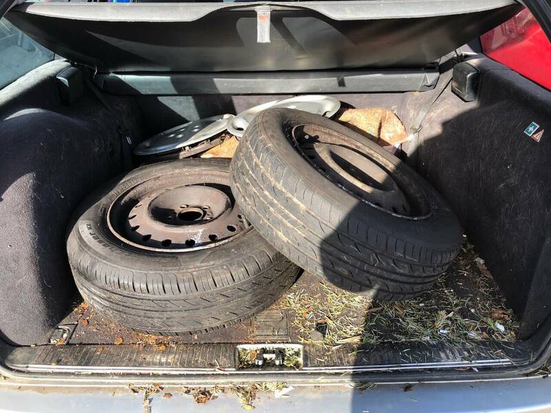

I then liberated the front wheels
And had them shod with the finest pair of part worns that £45 could buy
These were then thrown on the car
And after a short test drive, it was confirmed that a) the ABS was behaving now, b) I need to fit the rear ABS sensor (balls) and c) XM’s are handsome bastards even if they are constantly broken

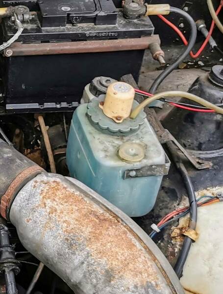

I've got a bunch of Trabant washer bottles here (seriously, I think I must have half a dozen of them) which wouldn't look out of place there if you want one.
Happy to punt one your direction gratis if you let me know where to send it.

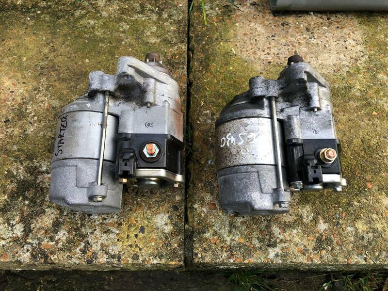

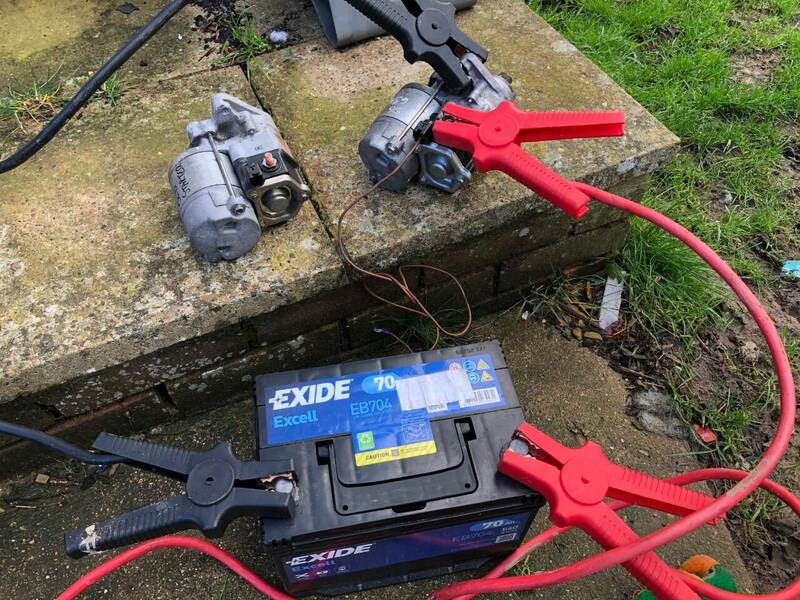

Between now and my last post I removed the old starter and tested both.
So it turns out the solenoid on the old one was bad, it only throws a couple of mm. I’ll take it apart at some point and have a look at its guts to see if it can be brought back to life.
The new* starter then went in.

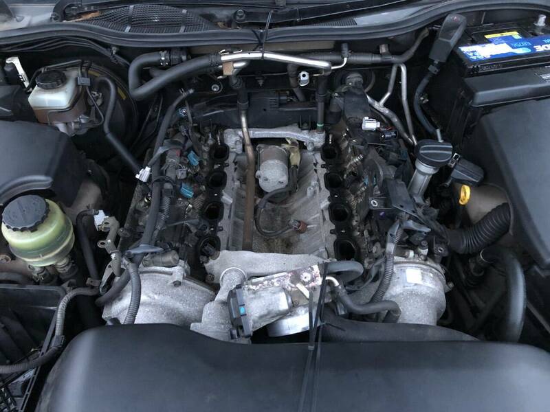

In hindsight, life would’ve been much easier if I had of taken the coolant cross pipe off. I didn’t though, and I endured misery for the sake of saving draining a bit of coolant and buying two gaskets. Possibly a poor life choice, but here we are.

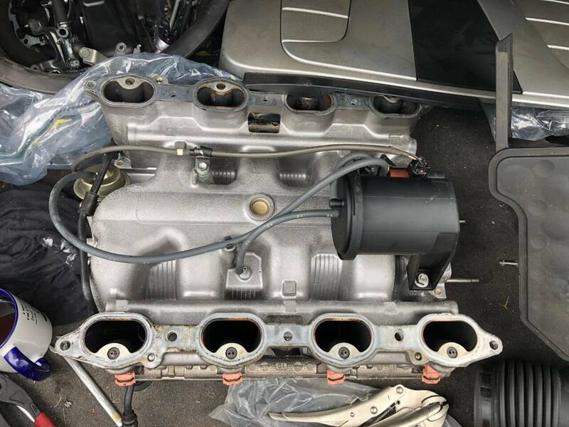

Whilst I was in here I decided to take a look at the non functioning inlet butterfly thingies. The car was showing the check engine light due to a fault on these. The vacuum gubbins below control them.
Some testing with a pump and a power probe showed that this solenoid was fuckulated.
I ordered China’s finest* £20 replacement and waited, then fitted it once it landed. It verks!
I then spent about 50 million pounds on a pair of inlet gaskets.
This brings us up to today, where I put everything back together. In true Haynes spirit, refitting was the reverse of removal. Luckily* I took no photos as I took it apart, and removal happened weeks ago and my memory is shit. Fortunately, Japanese cars seem to be put together fairly logically, and I managed to put it back together by basically playing Lego. At the end I had no fasteners left over, and I didn’t put anything together in the wrong order which was a bit of a shock.

To wrap up, this job was a bit of a slog but definitely worthwhile. I’m glad to have the car back in operation again, as despite being a V8 barge it’s actually very practical and more importantly it’s really enjoyable to drive. I’m looking forward to being able to use it again!
The only downside to finishing this is that now I have no excuse not to crack on with finishing the XM and the Lada…

Excellent work on that starter, I know how intimidating that job feels at first but going through all of it step by step it it really isn't too bad in the end, plenty of opportunities to fix other stuff you'd never bother with otherwise as well. Fingers crossed the Chinese solenoid will last a while.
Glad you got the inlet butterfly thingies sorted too. The guy I bought this from at the Yoda/Lex garage said TADTS and it’s why the warning light was on… My philosophy was to just say “ok, Bob” and have no intention of doing anything about it, so it’s nice that a) it was all truths and 2) you got it fixed ok.
I’m quite lazy, so as you say it’s the amount of time it takes to undo everything that is the bulk of the job and what was putting me off 🤣 there’s nothing very technically challenging to do. Probably the worst bit was how fiddly the starter bolts were due to me leaving the cross pipe in place, but it still wasn’t that miserable.
Yeah I’m hoping the cheaper solenoid has some sort of lifespan to it. I couldn’t get the proper Toyota part in a reasonable timescale so compromised for the sake of getting the job done.
9 hours ago, rob88h said:
Glad you got the inlet butterfly thingies sorted too. The guy I bought this from at the Yoda/Lex garage said TADTS and it’s why the warning light was on… My philosophy was to just say “ok, Bob” and have no intention of doing anything about is so it’s nice that a) it was all truths and 2) you got it fixed ok.
I dimly remember scanning the code when I got the car and the code that came up supported his diagnosis, and as you say it’s a really common fault on them. The old solenoid had gone open circuit which the ECU must have been able to detect. So the job was on the cards before MOT, so I guess the starter failure was serendipitous.

The car hesitates and bogs down badly at wide open throttle. I thought it was just me, but yesterday I used it at motorway speed for the first time since it got put back together, and it literally cannot accelerate with the throttle to the floor. If you back off the pedal to about 50% or less then it resumes accelerating. This is definitely not correct.
The check engine light has come back on, but helpfully it appears to be unrelated. Possibly/hopefully. Because the code is for poor efficiency of both cats. The exhaust blows and apparently cracked Y pipes are a common cause of these codes on the LS430. It would suck if it has collapsed cats though as that's probably a fair chunk of money to sort.
I have a few lines of enquiry to go through with it, but it feels like the issues are just one after the other on this car at present. It is not endearing itself to me much at the moment, and the only thing that keeps me motivated is the thought of how good it should be once the running problems are sorted, as it should absolutely fly along.

No updates on the Lexus, it's still useable as long as you avoid full throttle so we've just been driving around the problem. I'm all ears to anyone's suggestions though - to recap, it's massively down on power when you open the throttle fully, and if you do it whilst rolling (for example to overtake, or speed up after someone else manoeuvres) then it bogs down completely, there's a massive backfire and then it springs to life again 😥

13 minutes ago, tooSavvy said:
TPS.. 🤔
It's definitely on my hit list to check it as there's a possibility it was disturbed when I removed the throttle body recently. I've managed to dig out the relevant readings from the service manual which I can check with my diagnostic kit hopefully.
Sticky butterflies or now stuck again but more closed? Previously it was broken open allowing it to gobble all the air, but now they’re a restriction?
(Legal disclaimer: I have no idea how this system works)
I think I can check without removing the manifold - I should be able to get a power probe on to the plug for the solenoid with it all in situ. I tested it before I fitted it using a vac pump and power probe and it worked perfectly, it was down on power from the first start however.
For what it is worth I can find loads of forum threads online describing the exact same symptoms, so it must be something common to these cars - there's just not really any useful conclusions on line though... I definitely want to get to the bottom of it as I love the car (despite my despondent posts of late 😂) and I know it'll be brilliant once the niggles are sorted.

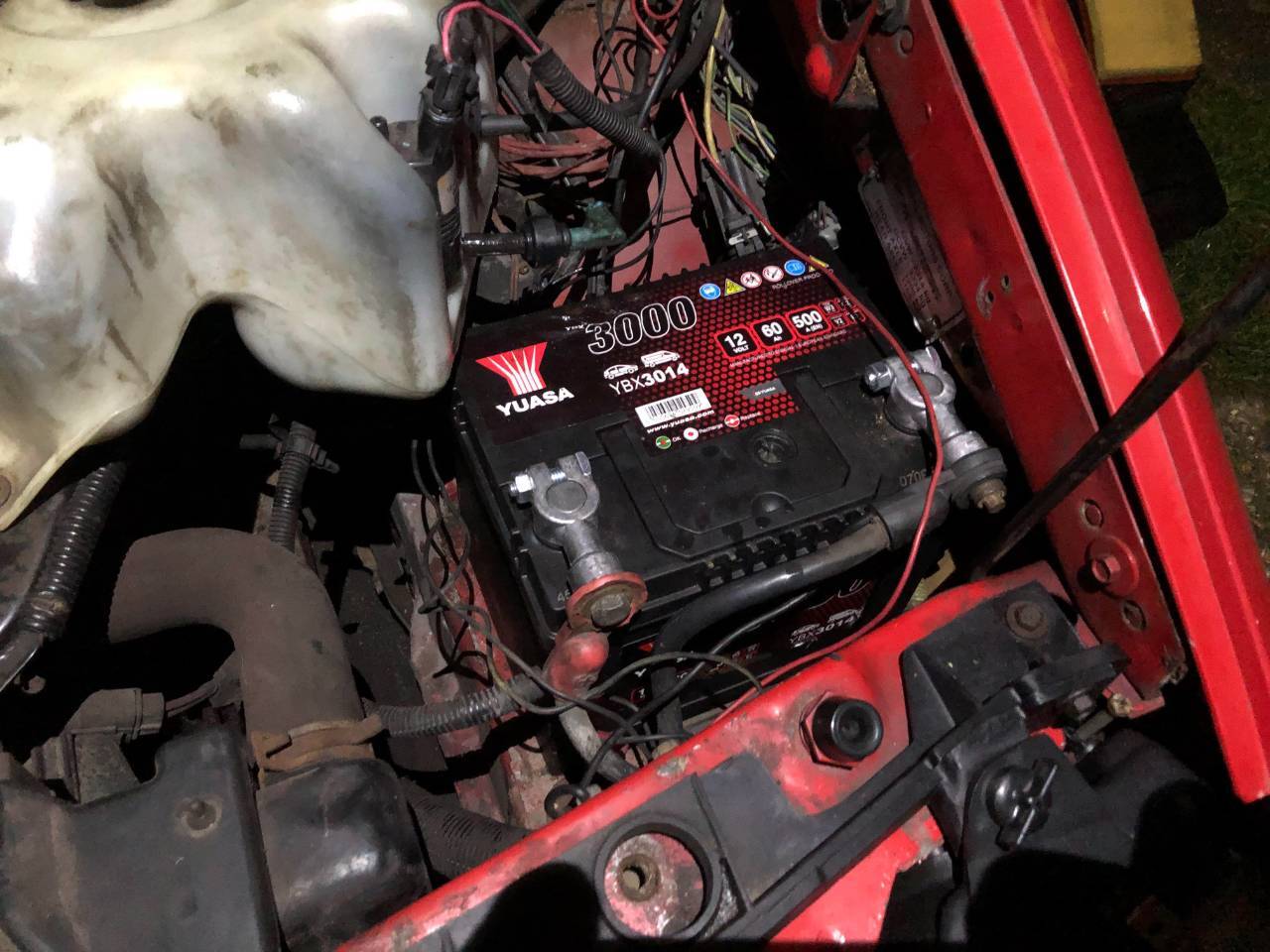

The battery adapters worked, although the only battery I had with the terminals the correct way round was the one in the Proton, so I've nicked the battery from that for now.
Of course, this battery was too big for the factory tie down to work, and was also so tall that I was worried about shorting out the positive terminal on the cross brace.
Copper brake line and the dust boot from a Lexus air strut to the rescue:
I came up with a better/more secure routing for the copper pipe, and put everything back together.
I definitely* will put the right battery in at some point. There's no fix more permanent than a temporary one etc...

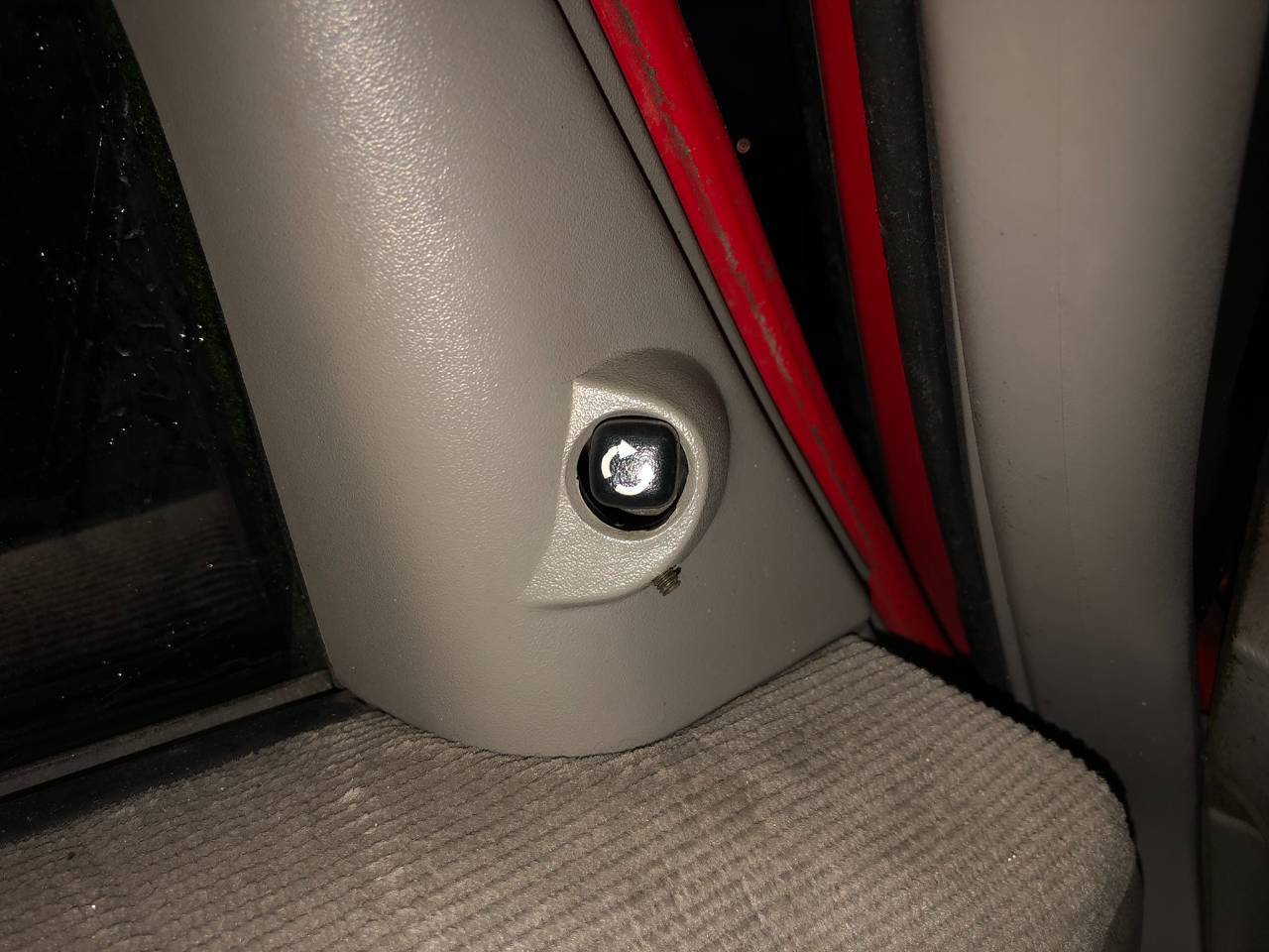

Whilst procrastinating over the larger jobs, I started sorting the small ones. One thing that jarred me was my rusty nuts.
I could see them from the driver's seat, and so this had* to be sorted. I designed and printed these at work:
Sorted:
No idea how long the PLA will last, but I can just make more if needed. It looks much better from in the cab and outside.

This meant I had to use the Pontiac to move the car trailer (this was what I was getting the Mitsubishi out for).
It looks cool, but even though it's not that heavy a trailer you do notice it behind you. I wouldn't be mad keen on pulling it on the road. The mirrors are absolutely wank for reversing also.

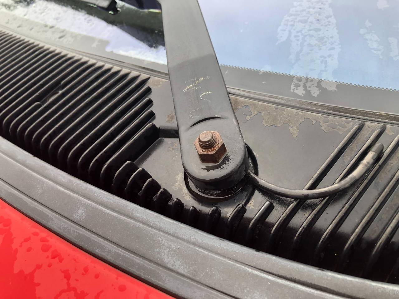

Speaking of which, this was winding me up something chronic:
It's possibly not very clear, but the mirror adjuster stalk was pushed in flush with the trim around it preventing it being used. In this pic I've discovered and wound out the retaining grub screw. I then prised out the trim, pushed the switch back into place and tightened up the grub screw.
Sorted, we now have working wing mirror adjustment.
Next up was the non-working wash/wipe function. It used to work, but now it wasn't spraying out any windscreen wash. Turns out some fucking idiot (me) had connected the front hose to the rear pump, and left the rear hose dangling into The Void. Plugging things back into the right pumps sorted that out nicely.
The last major niggle was the headlight aim. It was like the car was cross-eyed and constantly staring at its shoes.
The headlights are easy to remove, one of the adjusters had been moved too far and needed taking apart and winding back on manually:
I then roughly dialled them in on the side of a beach hut.
It's not perfect but it lights the road up much better now. At some point, I'll need to obscure the LHD kick up for reasons of MOT obtaining.
