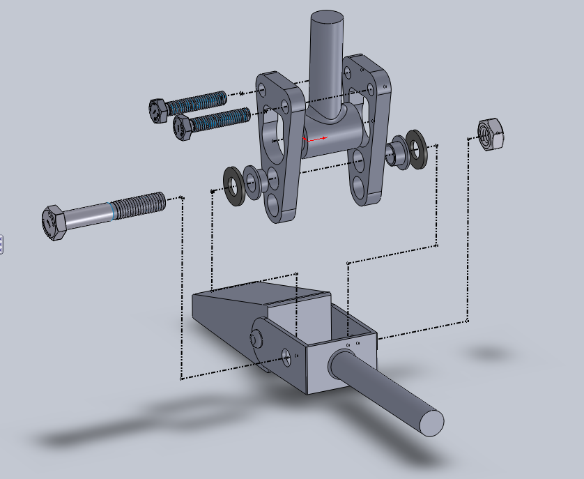

I got a short shifter kit for a pg1:
exploded_1080x.png?v=1588070387
Did not get any photos of it, but made some adjustments and the gear change is far better.
